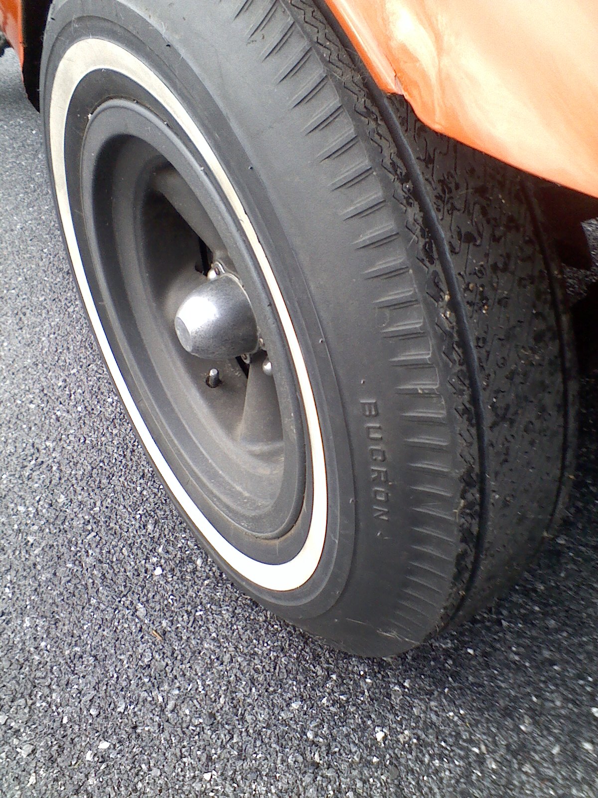

    This thread shouldn’t go on without mentioning good ol Bucrons. Not to easy to come by these days : 151B7C4C-DAAD-47B6-85CB-FE905CF0C0EC.jpeg
