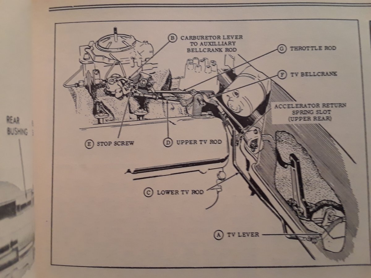

    Hey all, I just bought a 61 Olds with a Slim Jim Roto Hydramatic. It has a Holley carb on the stock 394 now, but the TV linkage is definitely not adjusted properly. It's giving me a tire-chirping, neck snapping shift from 1-2, even under light throttle, and then an indiscernible shift from 2-3. It will not kick down at WOT in cruising speed. Since I just got the car and don't have the factory linkage to cross reference, I'm trying to make rhyme or reason of it. I don't even know if it's pushing or pulling in the right direction. Does anyone have any pictures of a stock, 1961 Olds throttle linkage and TV linkage mount? If I know what came from the factory I can recreate it on this Holley.

    Here is a pic from a Motor Manual from 1969, that only goes back to 1963, maybe it can be of help. 20190425_214201.jpg
    57JoeFoMoPar likes this.

    That's actually a huge help, thanks so much for posting that. It should be the same setup as the 61
