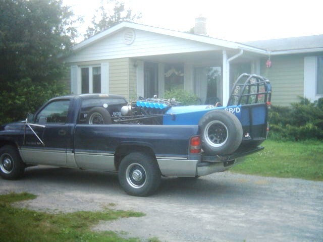

  3. The front axle is suspended by a single 1/4 eliphtic spring. I put the spring over the axle tube first then made the axle afterwards. It works well. I think there are some pictures of it on my website which shows at the bottom. This picture was resized and lost some perspctive in the resizing. This picture makes it look wider than it is.
    The rad is from a Dodge minivan and it runs just above 160 F .
    With the mild street engine but 6 snowmobile carbs it ran 8.40s 1/8th mile. It was simialr with the fourbarrel but I havent had a serious pass on the new setup quite yet as the last race where I was scheduled to attend was scrubbed for me due to a family deal. I will have to wait for next year. I have not yet shifted it but let it run with the auto doing the shifting. I was too chicken to take my hand off the hand brake. I spent days training myself to drive it with my brake hand so I could shift and then didnt get to go racing anyway. I can give you a better answer next year. I believe it should at least do 11s in the 1/4 and that is my goal for next season. After that? Well you know!
    It handles well and sure is fun to drive. Fans love it and i often have to wait wile they get pics before i can get out to load it. It is a wonderful toy for a wornout old racer.

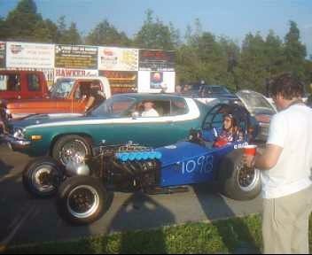

  9. I get a lot of talk from newbies about the car being that short but it really runs straight as you can see from the video. Not needing a trailer is wonderful BTW. I can load it all by myself in about 5 minutes with a small cheap winch although I usually have a big bunch of folks helping me which i find wonderful. They seem to find the old style 6 cyl car interesting. They chauffer me around the pits in their golf carts. Push me up the staging lanes, help me load and unload. Get my time tickets while I sip on a Barqs Root beer. It makes the whole deal a lot of fun. One Alky racer even hooked up his battery charger to my car while i rested, all on his own accord ,just trying to look after "this ol guy". Old friends (and new ones) an old style car, wind in my face once more and not a lot of $ spent. I am sure yours will give you the same experience. All the best in your build. Should you want to ask anything feel free although I am sure you already know what you are going to build and how.

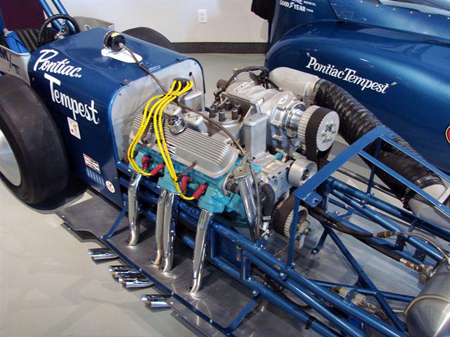

    I'm glad that someone brought up the Pontiac Trophy 4. I started out planning to do a HA/GR powered by one of those little rascals but due to a couple of recent developments, changed over to the concept of doing the same power plant in a Chassis Research TE-440. The biggest problem, as someone mentioned earlier, is getting that chassis to be remotely safe by today's standards while keeping the vintage vibe. Pontiac offers more advantages than most makes for the vintage 4 and 6 cylinder crowds because just about all of the V-8 speed parts bolt in the 195, V-8 cranks, rods, pistons, heads, intakes (with a little fab work) etc., the choices are many. It only takes about 325 HP in this type of car to run 10.00, and can be done on a reasonable budget.
    I think there is a growing trend to do exactly what this thread is all about and I'm glad to see it. There will always be the hardcore racers, but many people are getting tired of spending ridiculous amounts of money to go fast. I like to race, but I like to eat, too. You can build one of these style dragsters with your own signature on it, for relatively minimal coin, and still have fun. And that's what it's all about.
