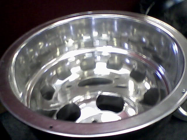

    I knew they made 14" wide slots, didnt know they 15" wide ones. But when I seen these slots on ebay a 1 yr agao I had to have them. They measure 17" wide and have a 4" backspaceing. Iwas told Eric Vaugn of real wheel made them around 20yrs ago. They have ansen casted in the back and say 15x ? They do not have the other number.

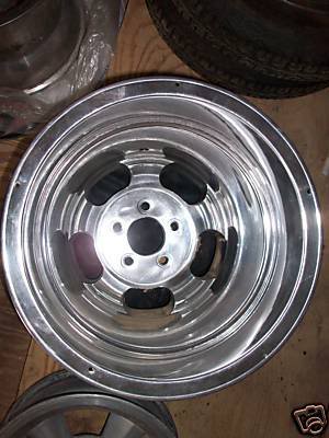

    Does anyone know what type of wheel this is?
    I can't find anything on the ones with 6 slots instead of 5.
    I'm also looking for a set of slotted mags if anyone knows of any around.
    15x10 5/4.5
    15x7 5/4.75
    Thanks,
    KK
  30. swade41
    Joined: Apr 6, 2004
    Posts: 14,462
    swade41
    from Buffalo,NY
    Those are American Dragmasters, usualy you find those in a 14 X 7 width but they did make a 15 inch version too.
