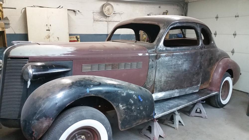

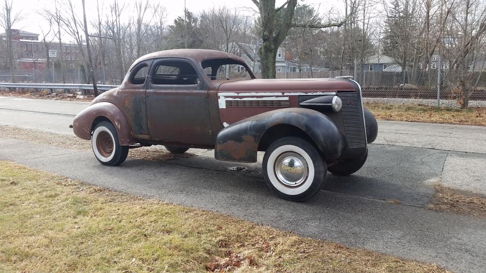

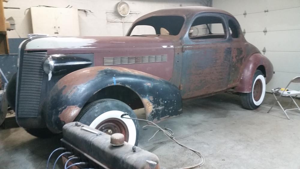

    Longtime Lurker and infrequent poster, but Im starting to get a little bit underway on my '37 Buick Century so I figure I would start a thread so I can guess my way through my first HAMB friendly car, (though I have worked on a few that fit). Picked it up a few months ago while I was finishing up an off topic 5yr every-piece-of-the-puzzle changed truck, and adamant that the next project would be a complete, maybe even driver that just needed to be cleaned up a bit. Instead I bought a completely blown apart and stripped '37 Buick Century coupe that was missing the engine, transmission, wiring, plumbing, brakes, interior, etc. Just a body on a ch***is, but wasn't too rusty and had a M***achusetts ***le and was located in upstate New York.

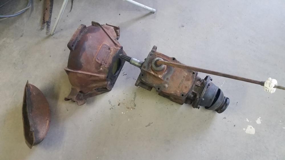

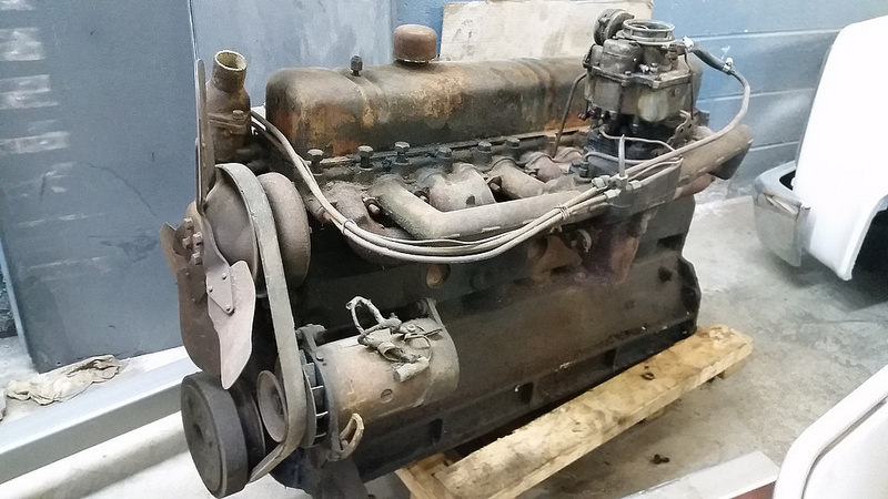

    I have since found a running 320 straight 8 out of a '47 Roadmaster and a Buick big series 6 bolt transmission out of another '37. Plans are 4 Stromberg 97's, a sweeping homemade header, some black paint and black wheels, black wall tires, and probably not much of an interior.

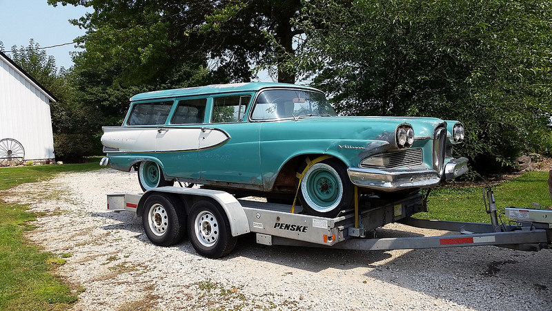

    Theres also a '58 Edsel Villager station wagon project with a buddy of mine that we picked up in Iowa back in September. that will be mostly rust repairs and shoehorning a 460 big block with a C6 for use as a family hauler and dog mover. I am also finishing up metal work on a slightly off topic '66 GTO for someone
    Folding chair next to the rear wheel for size reference. 126" wheel base and without the weight of the engine and trans, the roof is right around 6ft

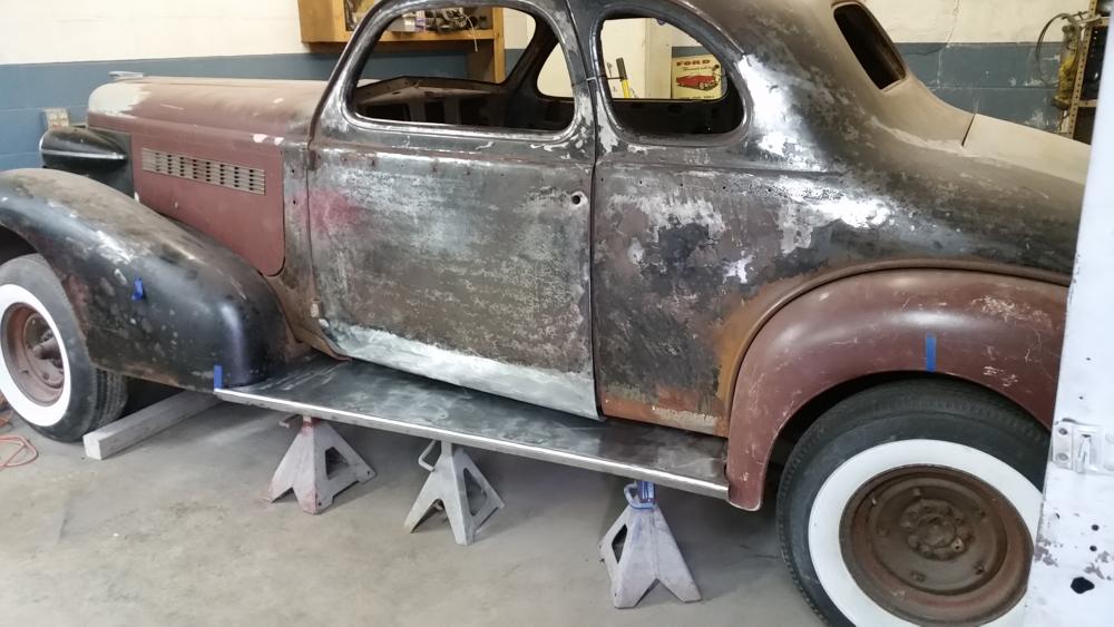

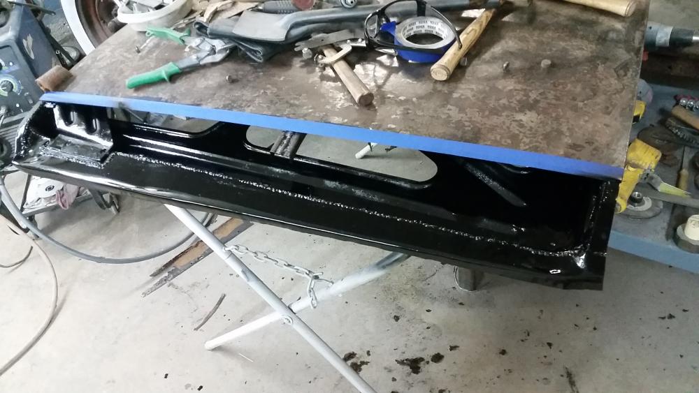

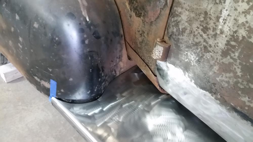

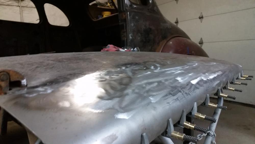

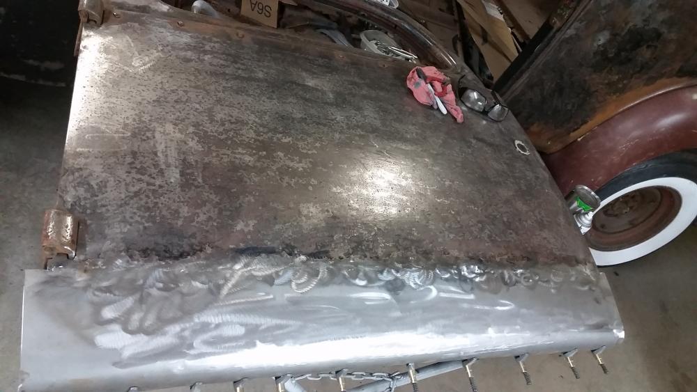

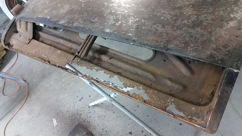

    Getting started on the body,its in pretty good shape overall, but the door bottoms, some sections of the door sills on the body and a decent section of the floor are going to need to be repaired. I've been working on sanding back and removing all of the crust, surface rust and old paint from the car, and started working on the driver side door. I don't think theres much out there for patch panels for this car, but I didn't really look too hard either, but I started making an outer lower skin and inner structure with some hammers and dollies and it turned out alright I think.

    Yes interesting project for sure!The car looks like they grafted a large sedan front clip to a business coupe.Probably to accomodate the long straight eight.
  5. Came from the factory that way. The length of the front had nothing to do with being a sedan or coupe...had to do with whether it was the standard sized Buick Special, (and later, the Super) that used the smaller straight eight...or the Century such as Stooge has that uses a longer front end to accommodate the larger engine...or the Roadmaster that uses the LONGEST front end and also uses the larger engine.
  6. The Century was considered to be the "factory hot rod" of the three, because it had the highest power/weight ratio.

    Yes that torque tube instead of a normal driveshaft can be a problem too.

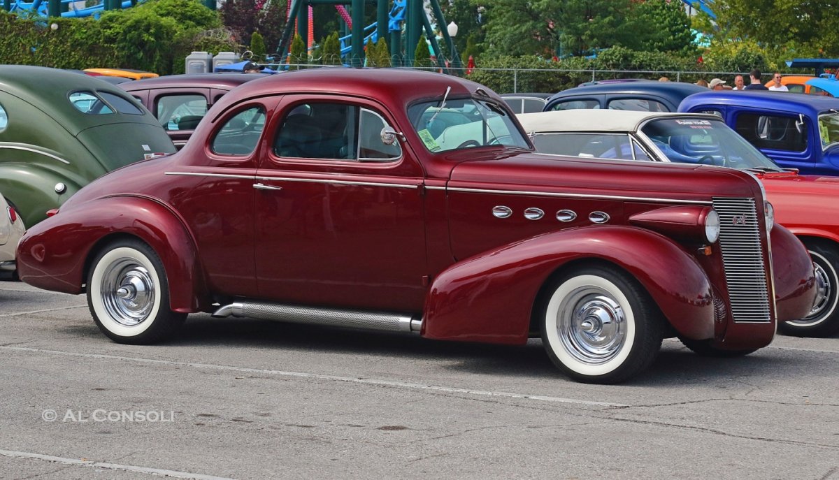

    I must say that the front end does look longer than mine, but it must be an optical illusion because I know they were all the same.

    Agreed. Thee are only two front end lengths in that era, the shorter Special and longer Century/Roadmaster/Limited.....and they only differ by 4 to 5 inches to accommodate the 320 length. The interesting thing is, it’s only the hood that is longer...the front fenders are the same length, but mounted farther forward on the cowl. There is a slight modification of the fender flange at it’s interface with the cowl, but otherwise the same.

    I haven't weighed any of it yet, but supposedly a fully dressed engine and trans is right around 1000-1100lbs so it should bring the stance of it down quite a bit. its a coil spring front IFS and rear leafsprings, but im going to get the engine and trans in before I decide on lowering it, but it will probably be fairly mild.
    I bought the engine for $500, and have since sold off the intake, carb, choke stove and the unbroken parts of the exhaust manifold for right around $400. I believe the rings inside the intake ports were used for aligning them at the factory as well as some sort of seal as there was no gasket in place, although I will be using something for them when I make up my intake runners. im thinking 1 runner for each of the 4 intake ports on a 90* round elbow with a Stromberg 97. im not sure if I will need to add some sort of equalizer/ plenum between them, that's something i'll have to look into a bit more. A company called Hells Gate Hot Rods sells the intake and exhaust flanges so i'll be using them when I get to that point.

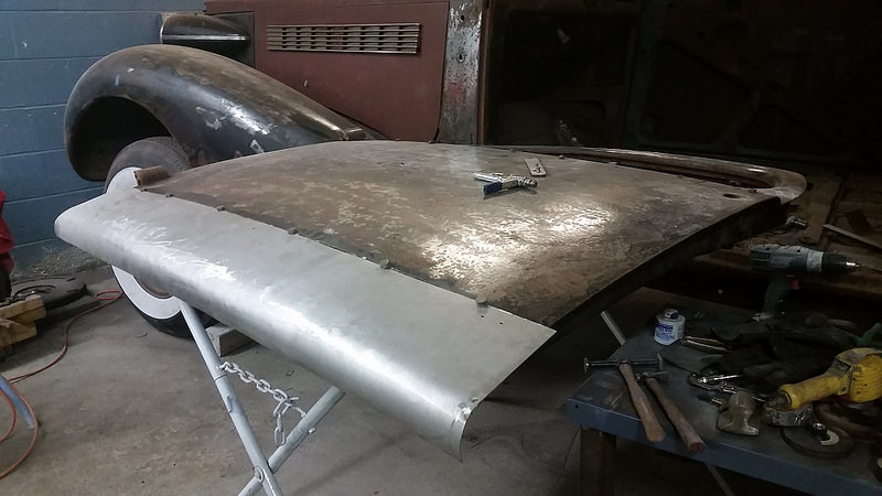

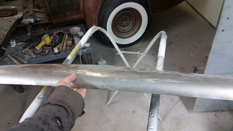

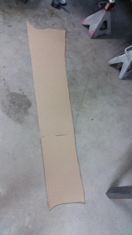

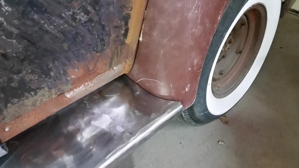

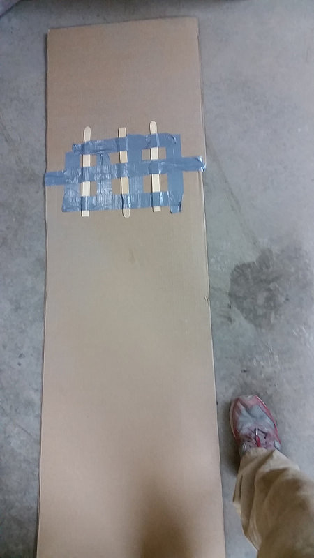

    Over the weekend, and before I start breaking the body down for some more body repairs, I wanted to get the running boards started. the car didn't come with either side, nevermind a junky pair I could just repair. Temporarily hung the door, broke out the cardboard and went from there. 5 1/2ft of running boards meant I had to tape my stupid pieces of cardboard together :cool:
    And over onto some s**** sheet metal I had been hanging onto. a few modifications and I had a nice rounded edge and a folded square edge underneath to add a little rigidity. I need to find or make some brackets to mount and align them, as well as add a little more structure underneath to make them stronger.
    Funny how they can make a big car look even bigger!

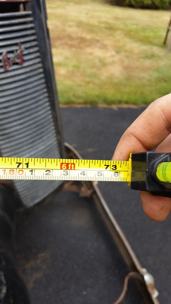

    I know for sure (I think...lol) that the Roadmasters had a longer wheelbase than the Century. And you seem to know your Buicks, so it sounds like the longer wheelbase of the Roadmaster was due not to a longer hood, but the further forward position of the fenders and front axle. Ok...sounds right. Makes sense that there was no need for a difference in hood length between the Century and Roadmaster since they both used the same engine.
    It doesn't really serve Stooge much, but since we're on the subject...I'm guessing that the Limited (limo) used the Roadmaster front end, and the additional wheelbase was simply due to the additional length of the body.
    I agree that Stooge's car looks longer in the front than yours. Gee...I wonder if he accidentally got himself a Roadmaster coupe.

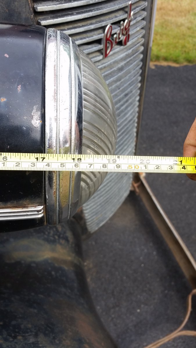

    Hey Stooge...measure your wheelbase.
    I looked up the wheelbases for 1937.
    Special 122
    Century 26
    Roadmaster 31
    Limited 38

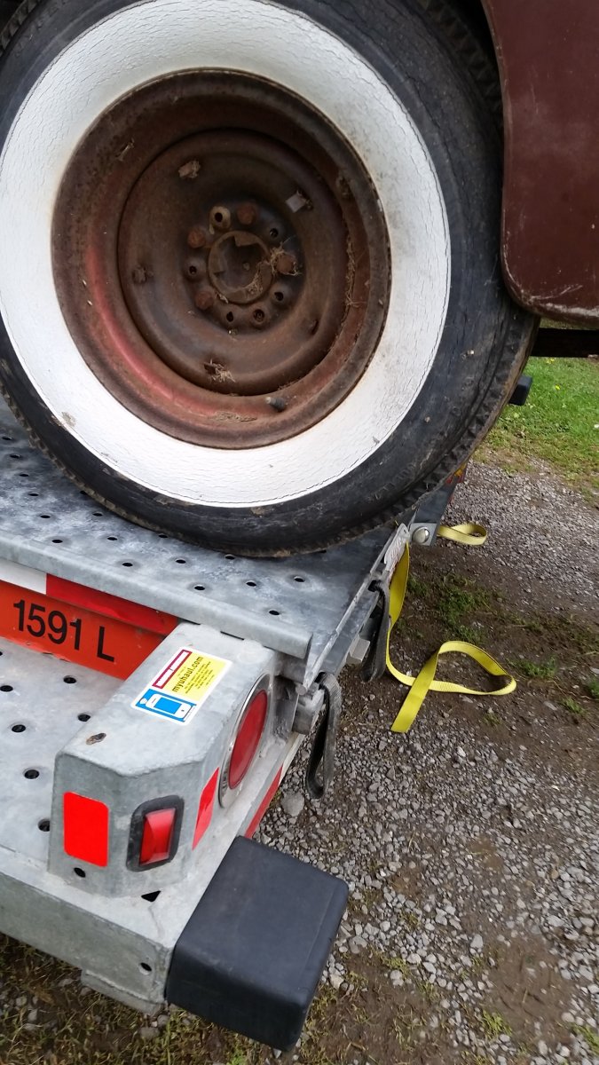

    I could very well be wrong on the gear ratio, I thought that's what I had heard, but like you said, it could be worse and should be fine for me! swapping out the rear ends TO '37 century rears seemed to be 'a thing' as it was the more desirable gear ratio.
    I haven't got out and measured yet, but from my research, what I was told, and what was written on the hood in paint pen, was it is 126" wheel base and the ***le and the trim are both pointing to Century. Maybe its just the angle of the picture? from cowl to grille is 6ft and for some perspective, the headlights are 19" long. the long wheelbase made for an interesting drive home in the pouring rain in the poorly lit highway through the mountains
    Not much breathing room on the fullsize uhaul trailer!

    What gauge steel is strong enough for the running boards,and now many supports that attach to the frame are required?
  25. Stooge
    Joined: Sep 9, 2015
    Posts: 594
    Stooge
    The running board sheet metal I am using is 16gauge, and were new take offs of industrial shelving, and already had the rounded edge. they were getting tossed at work and im always open to inherit whatever s**** sheet metal is getting s****ped. they were too short by about 8 inches so I had to get a little creative and section part of one of them to add on to another. Stock there would be 2 supports and 2 runners going down the length of the board underneath so i'll do the same. they will be mostly for aesthetics but should be more than stout enough when done. I am also adding a lip around the front and rear fender facing edges to stiffen them up a bit, this was just roughly done as I still need to trim them back a bit to fit properly.

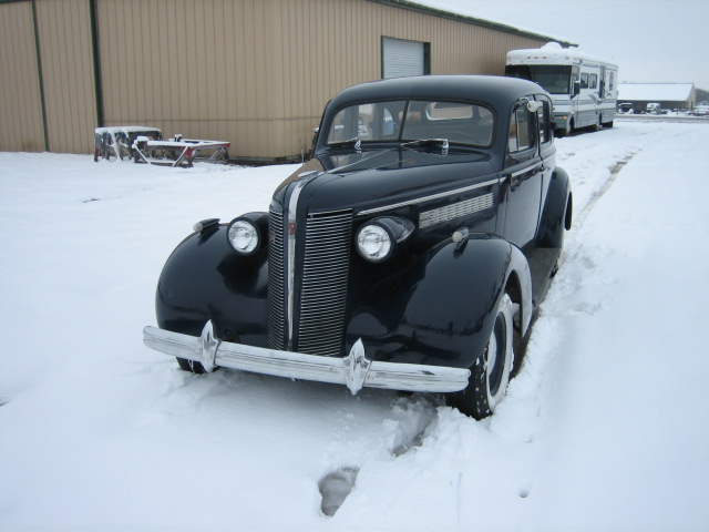

    On my 37 Special I used the 263 straight eight, 2004R OD trans, open 70 El Camino rear end with 4.11 gears (gives a 2.88 final in OD), tube shocks all 4 corners, 12v, p/s, p/b, and of course a/c. Looks completely factory stock and has been all over the U.S. trouble free. A fun car that drives great, rides super, and stops just decently so always allow a little extra room. You'll not regret this project.

    I think ive seem that car somewhere on the internet before, doesnt it have a gm tilt column as well? Really like what you did with it and it looks great! I've had a few ideas of upgrading atleast the manual master cylinder while keeping in the stock under floor position, but thats awhile away yet
