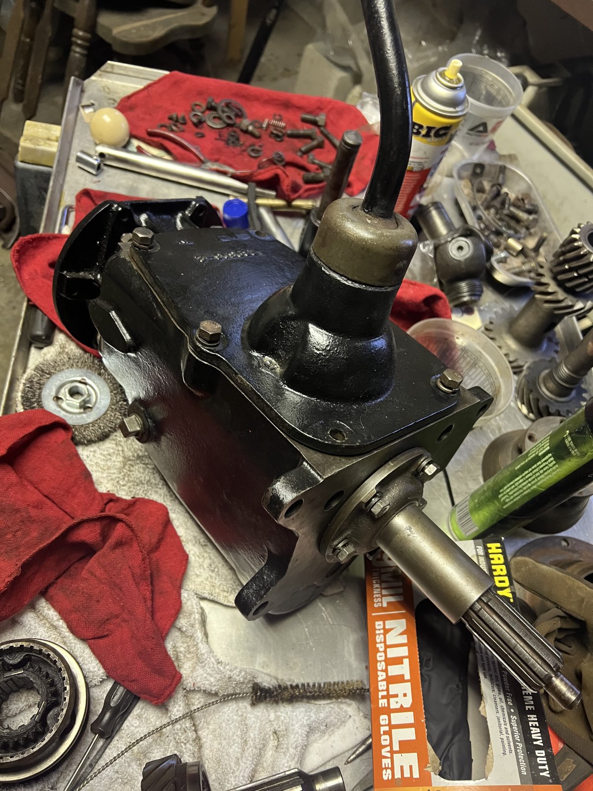

    Lets see, where were we! :rolleyes:
    Finally got my engine back from rebuild at the end of last year, that both took awhile (14months) and was very expensive but atleast it looks cool!
    Since i didnt have an engine for a long time, i couldnt finish the intake and exhaust until i got it back and got it installed, but ive been plugging away at it making it nice and pretty and smoothing out all of the welds before it all gets ceramic coated. The gas pedal and manual choke rod are both made up, i tried to use the stock pedal but it didnt make sense and used an under floor one from speedway and it seems like it should keep things pretty trouble free. Stromberg Big 97 primary carbs with a direct, non progressive linkage.
    Fuel/ vacuum pump rebuilt, generator rebuilt, distributor rebuilt and starter and solenoid rebuilt, but that one took some doing to get the solenoid working and had to piece it together, but stupid me wanted to keep it 6v just because
    I dont really remember where i left off with this. I'll dig through some pictures on the phone and add them later

    One of the main goals of this car has been to be able to take it on some 'good' length roadtrips, in the thousand'ish mile range, while still being an old 6volt, points, manual trans, manual drums, manual steering car, so this is something i was a little more excited about than probably needed to be over. When i was putting together the trunk area, im keeping a space for a spare, the little trunk shelf, spare for a small jack, and a dedicated slot for a toolbox. Found an old Kennedy cantilever that couldnt have fit better
    I havent bought tires yet, because im still not so close to being on the road, but i did buy the wheels and caps from Wheelsmith, 5 of them so i had a spare, though i only bought 4 sets of caps and rings. Their Hollywood flipper caps, trim rings, and 15x5.5 (or 15x5, i dont remember off the top of my head). Planning on blackwall 7.00x15 Diamondback Auburn deluxe tires when the times comes
    And just some pictures from the day the engine went in. It was a h***le, things went together and came apart a bunch of times, some hardware that had fit previously, didnt fit any longer (flywheel bolts now contacted the block through the crank flange?) but its in and shouldnt have to come back out. I was trying to think why it was so much easier last time it went in, but remembered the body was off, so swinging around probably over 6ft of engine was a little easier
