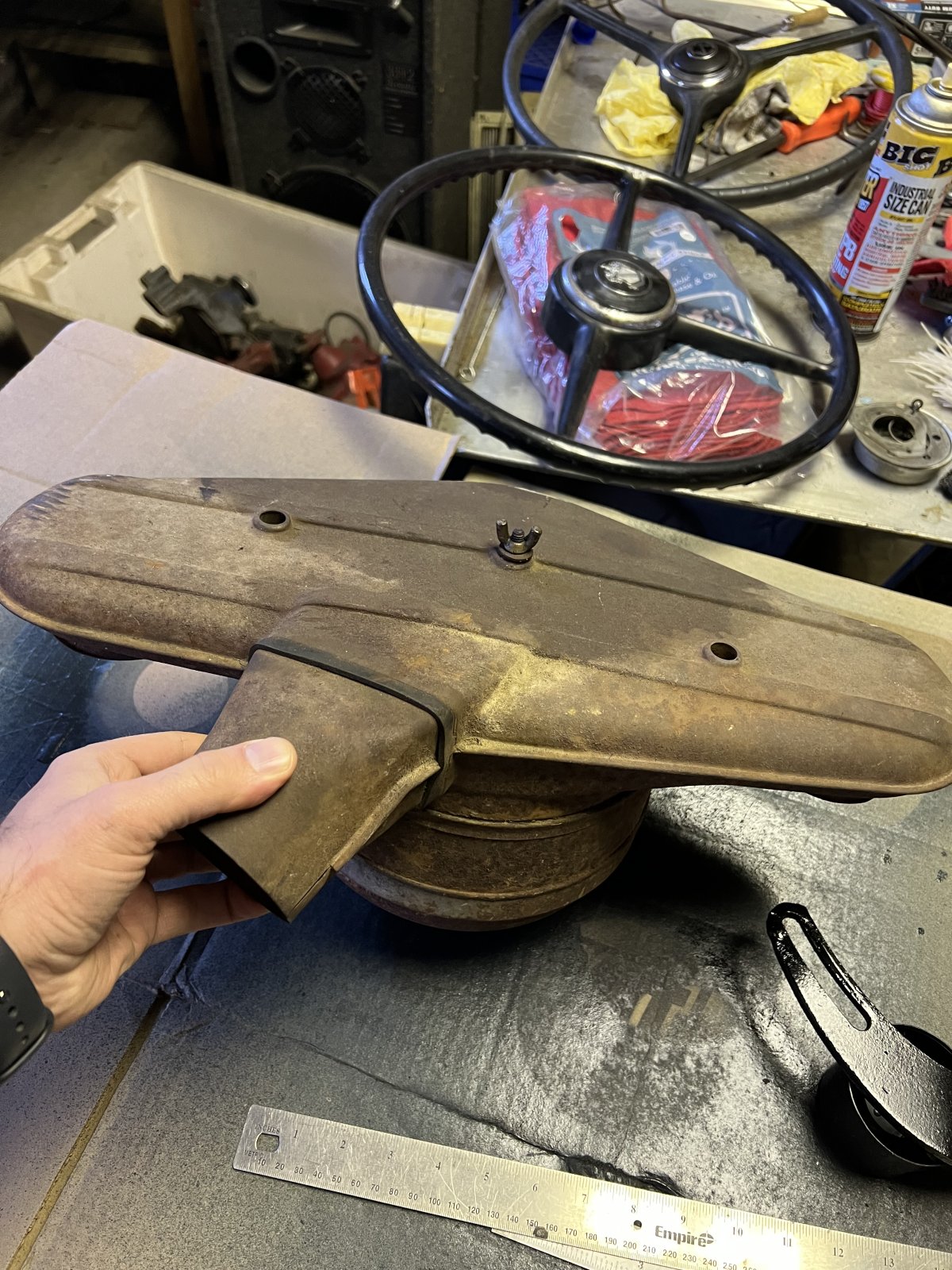

  5. Those intakes are a rare find and to have two of them is even more so. I have most of a 248 that I am contemplating for the second coupe, going Nailhead in the first one.

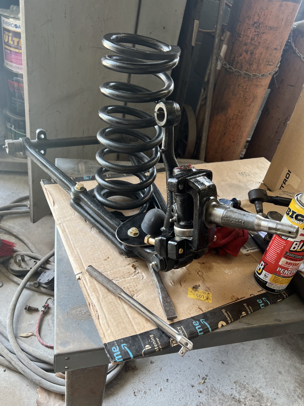

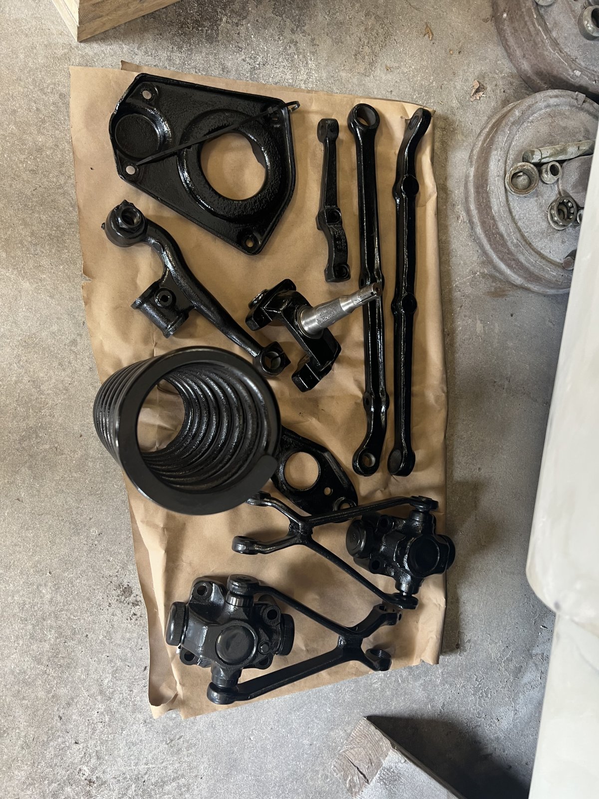

    Sent out the front Delco Lovejoy shocks to be rebuilt and got them back within a couple of weeks from Apply Hydraulics so i was able to put the front end back together on the Buick and get it on it's wheels for the first time in atleast a year. I still need new inner tie rod ends and to freshen up the front sway bar, but good to see it on the ground again IMG-3523.jpg

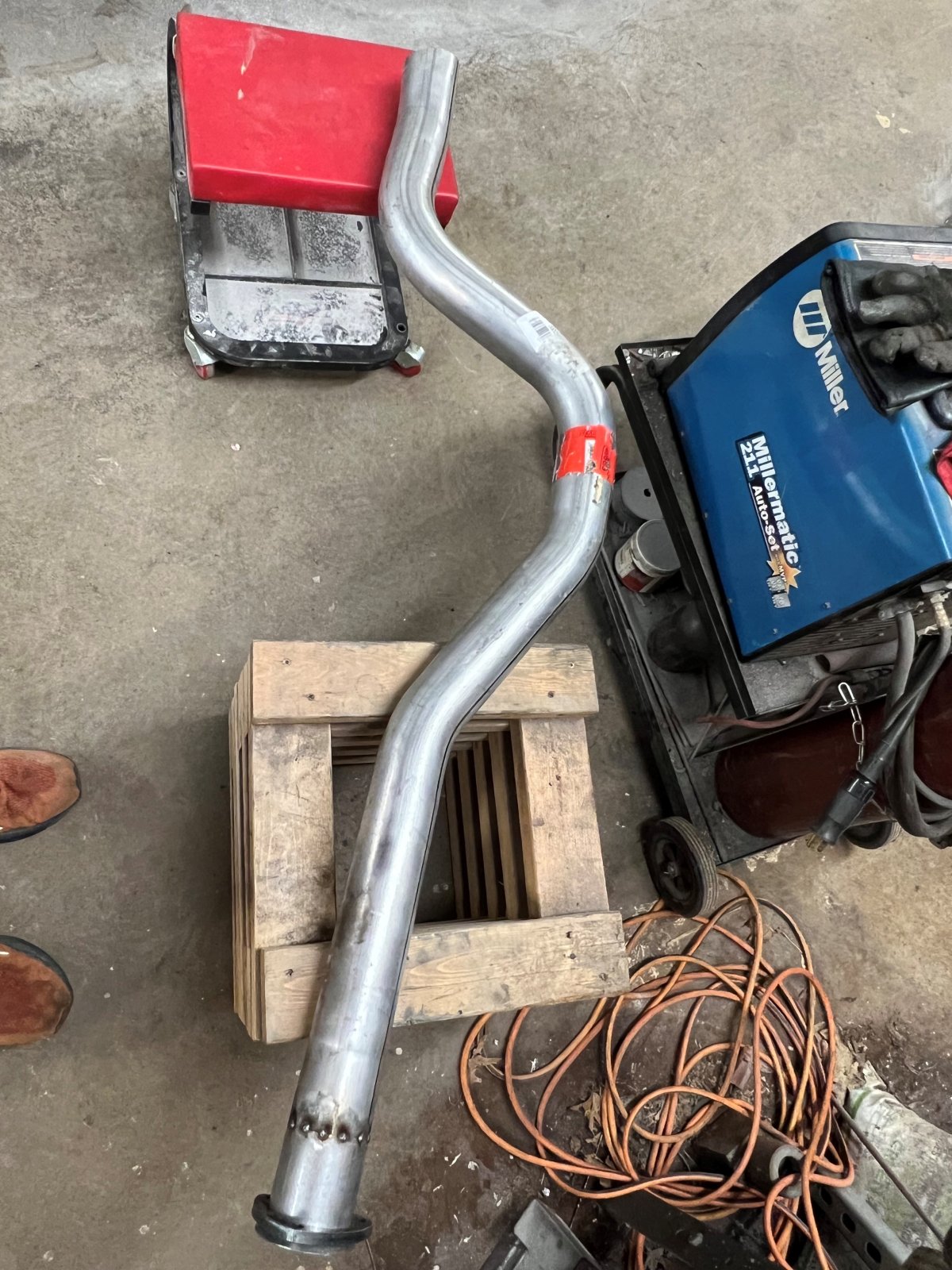

    Got the Edsel back up on stands to finish the exhaust, its a little tight trying to fit a 3" pipe around the leaf springs and gas tank back there, but it will eventually fit with some futzing around. Its just about done from the manifolds back, tucked up pretty tight to the floor since the wagon sits so low and for being so big, theres not a ton of space to play with underneath with how low the rear floor footwells go down

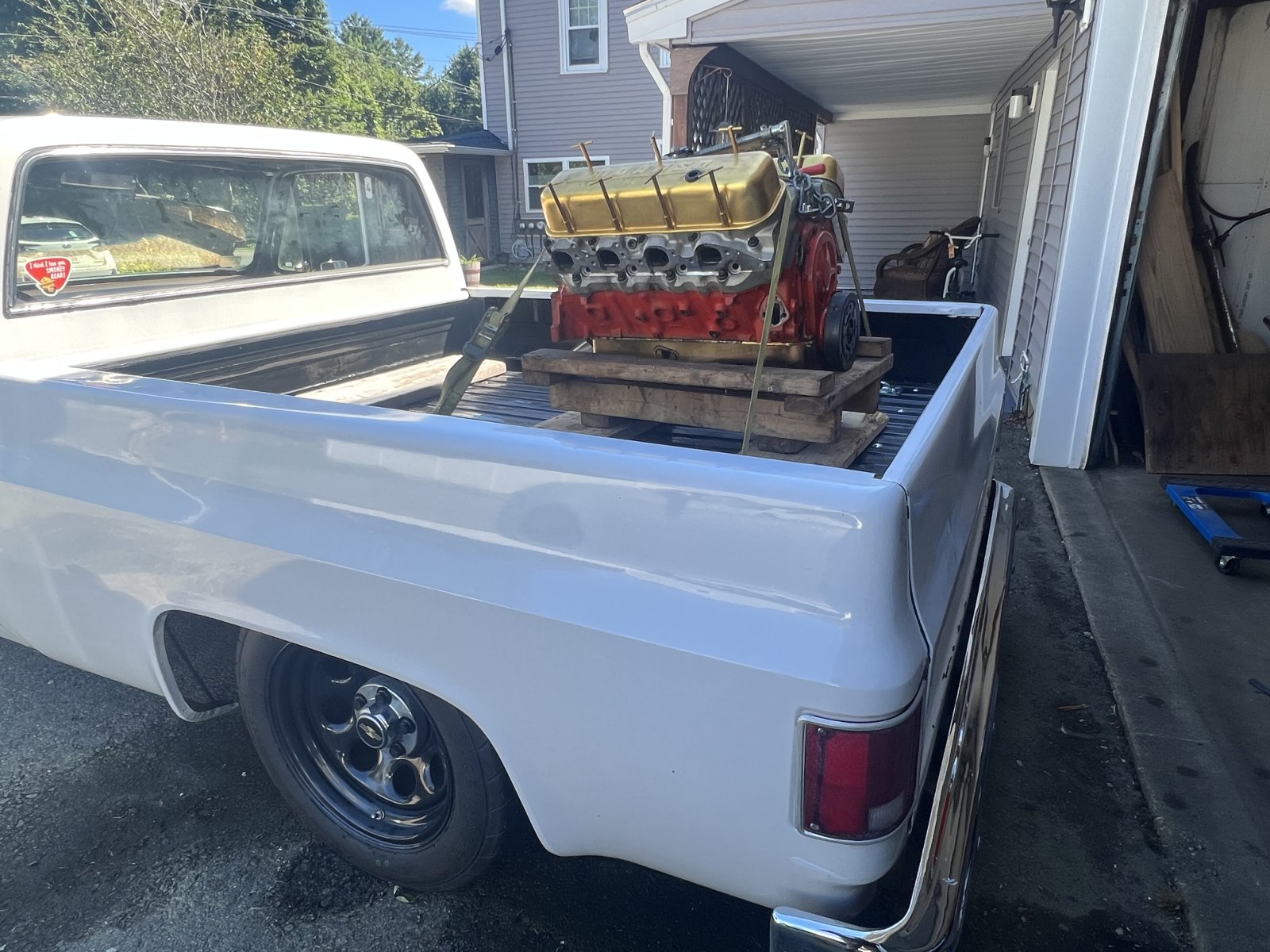

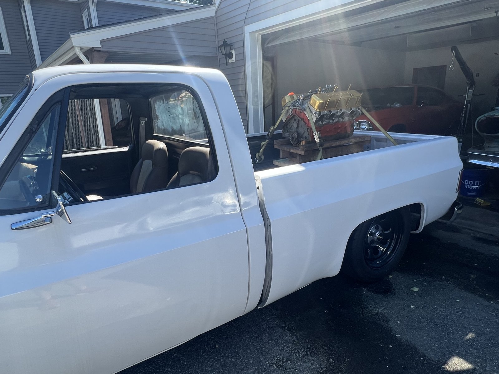

    Put my little C10 that i built years ago to work moving the big block for the Chevelle im doing for a friend of mine, to the machine shop. It's in good hands, he's a long time engine builder and also has several nostalgia nitro cars and a 12k horsepower funny car they finished building last year and have started campaigning this year
    Raised bed floor and a very low truck makes the 396 look huge!

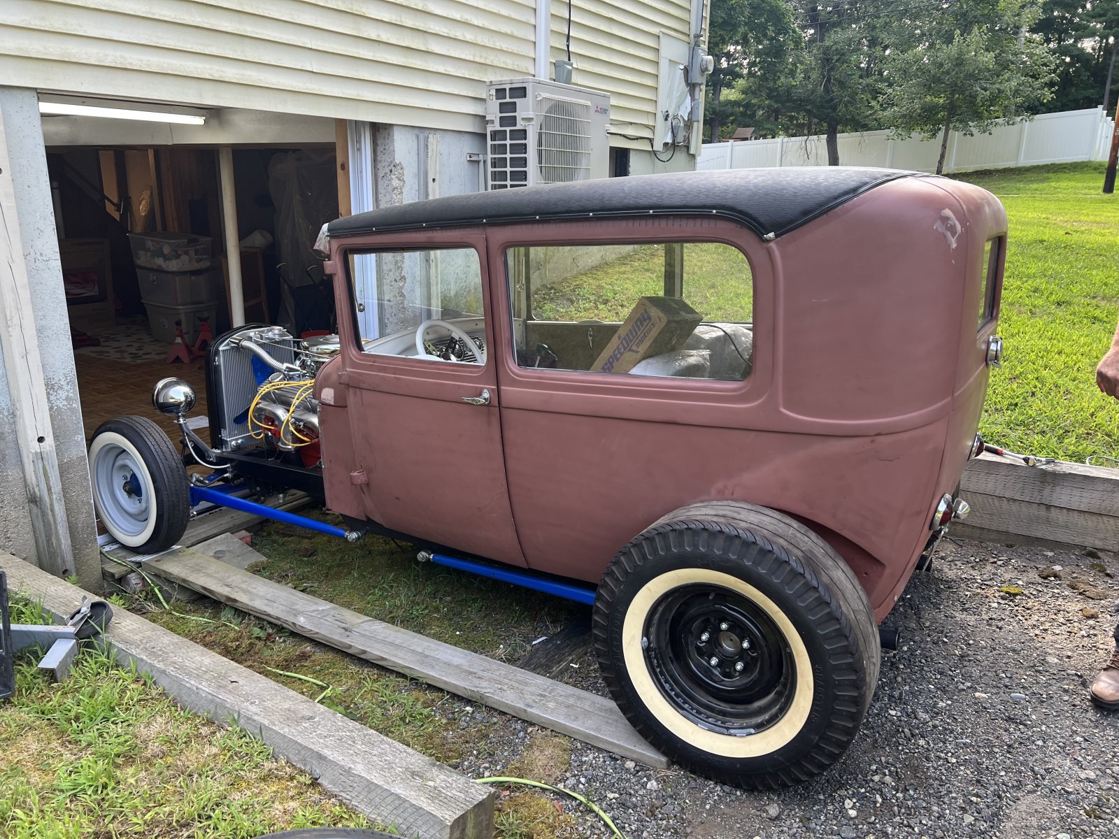

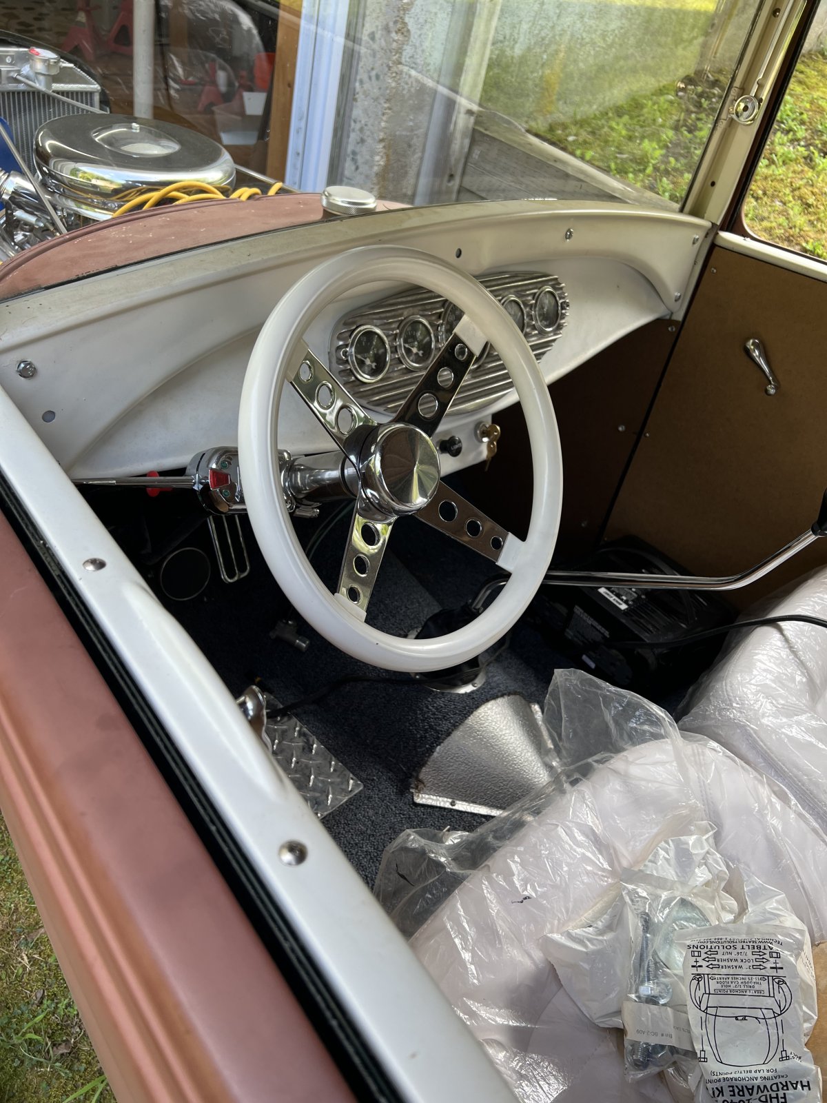

    A buddy's cousin unfortunately p***ed earlier this year, both are long time hot rodders, and as such, he's been tasked with cleaning out the horde, as well as being gifted the last car the cousin was building, a 28/29 tudor sedan. It was in the ba*****t, and had yard drove at some point, still has some finishing up details, but a very cool car. Im not a Ford/ Model A expert so i dont know what the suspension and steering is from, but got it back to the garage and tucked it in the corner.
    Im really digging the all white interior

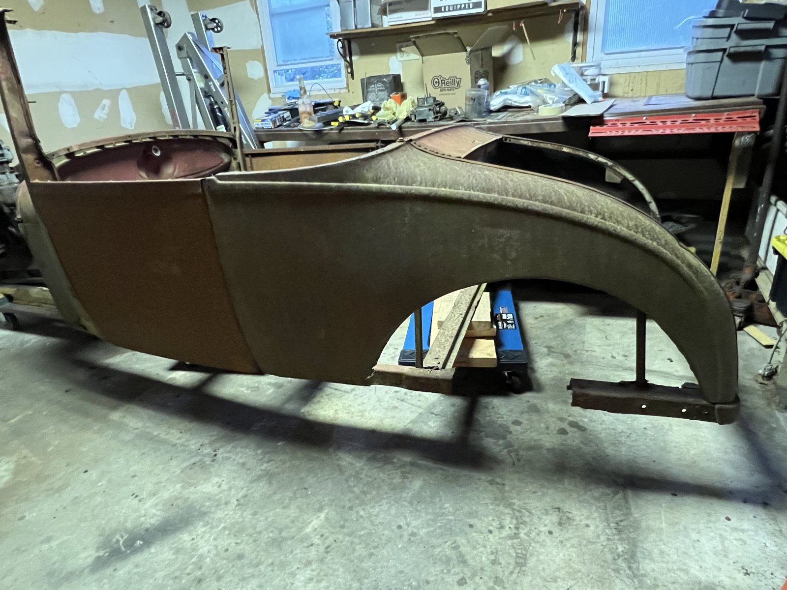

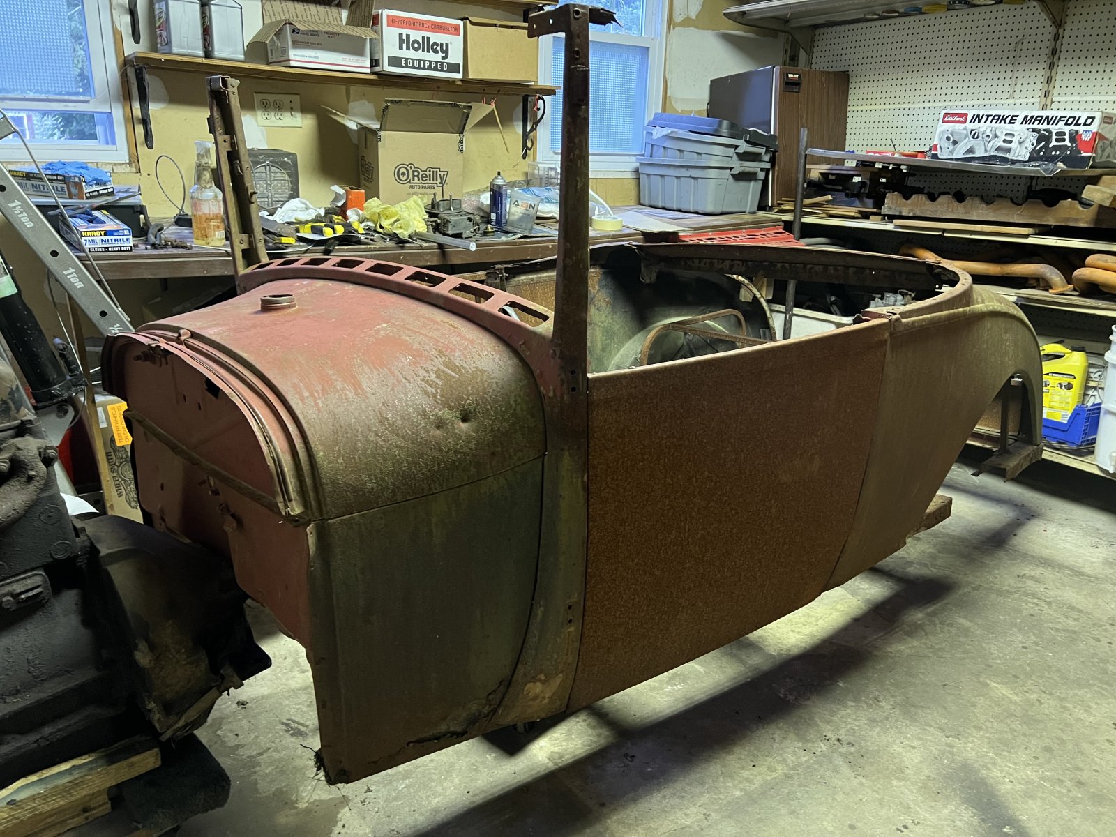

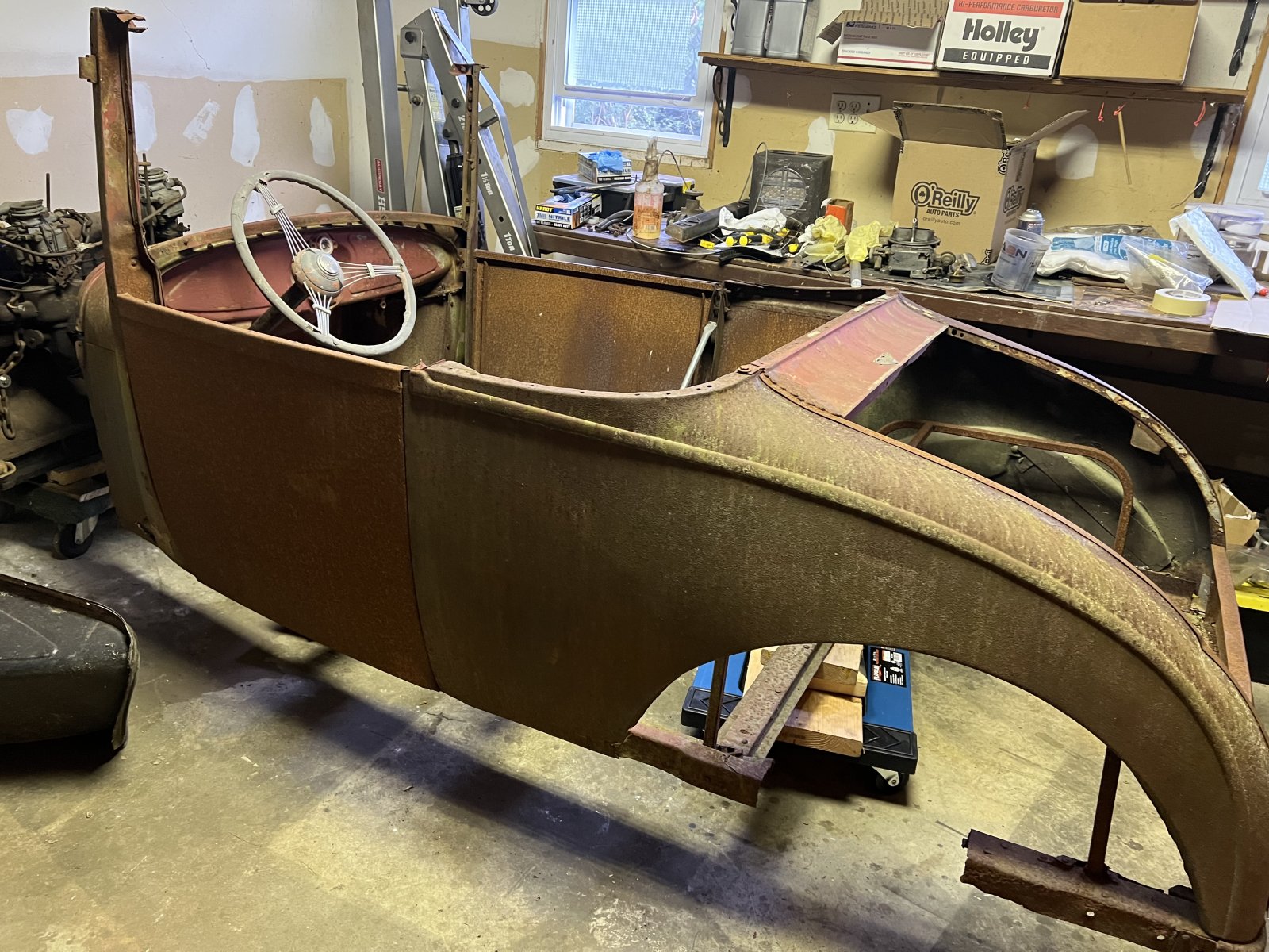

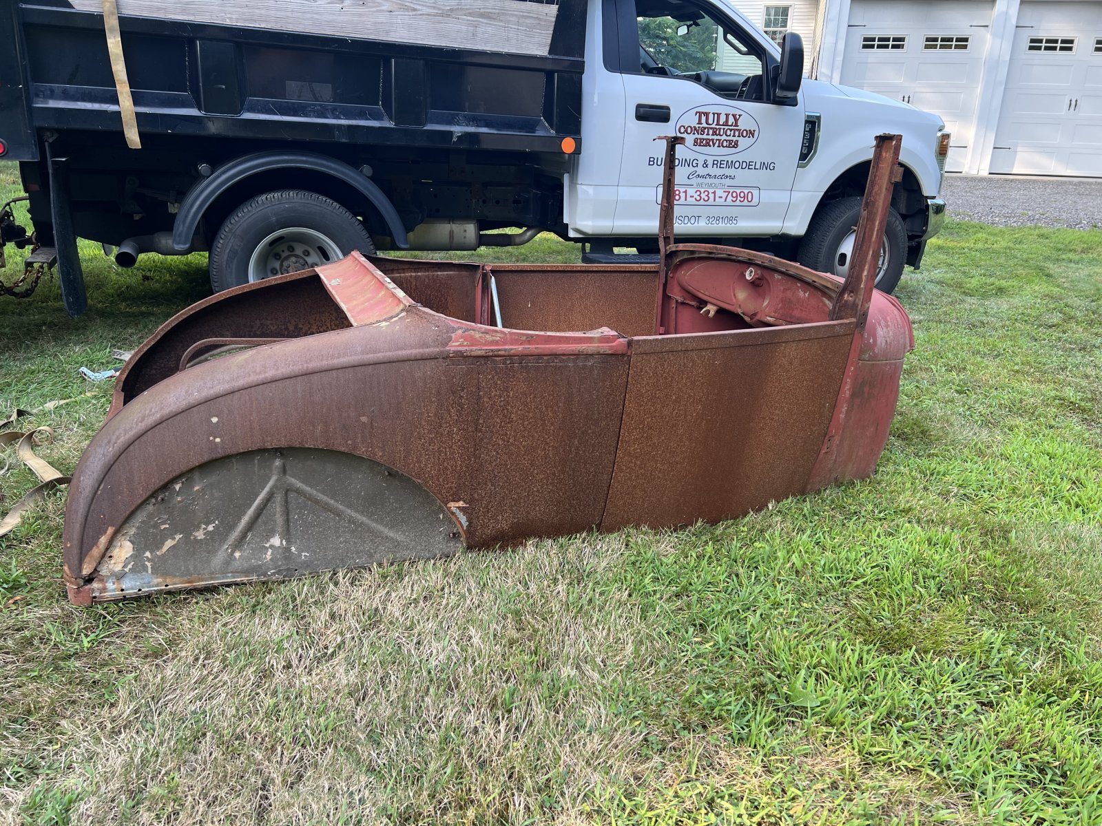

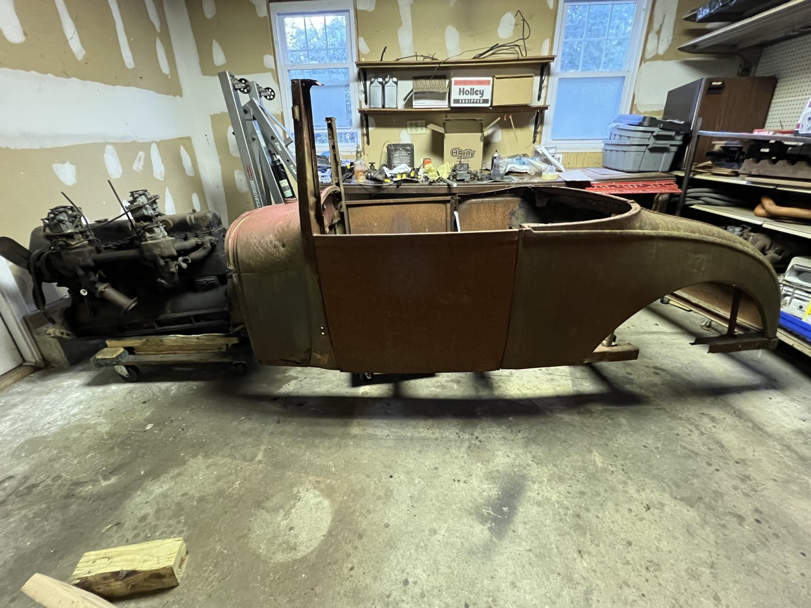

    And to do my part in helping clean up the property, i took home a 28/29 roadster body. There is all the parts to do a complete'ish car, but the frame that was there is a little janky, plus i have plans, but there is a complete rear axle and transverse leafs, several front ends, a 59a-b flathead and trans, some banjo wheels/ columns, a bunch of solid front axles, and a shed full of cowl gas tanks and what looks like a 1937 ford truck all dis***embled.
    got the body home last night and into the backroom of the home garage and started imagining!

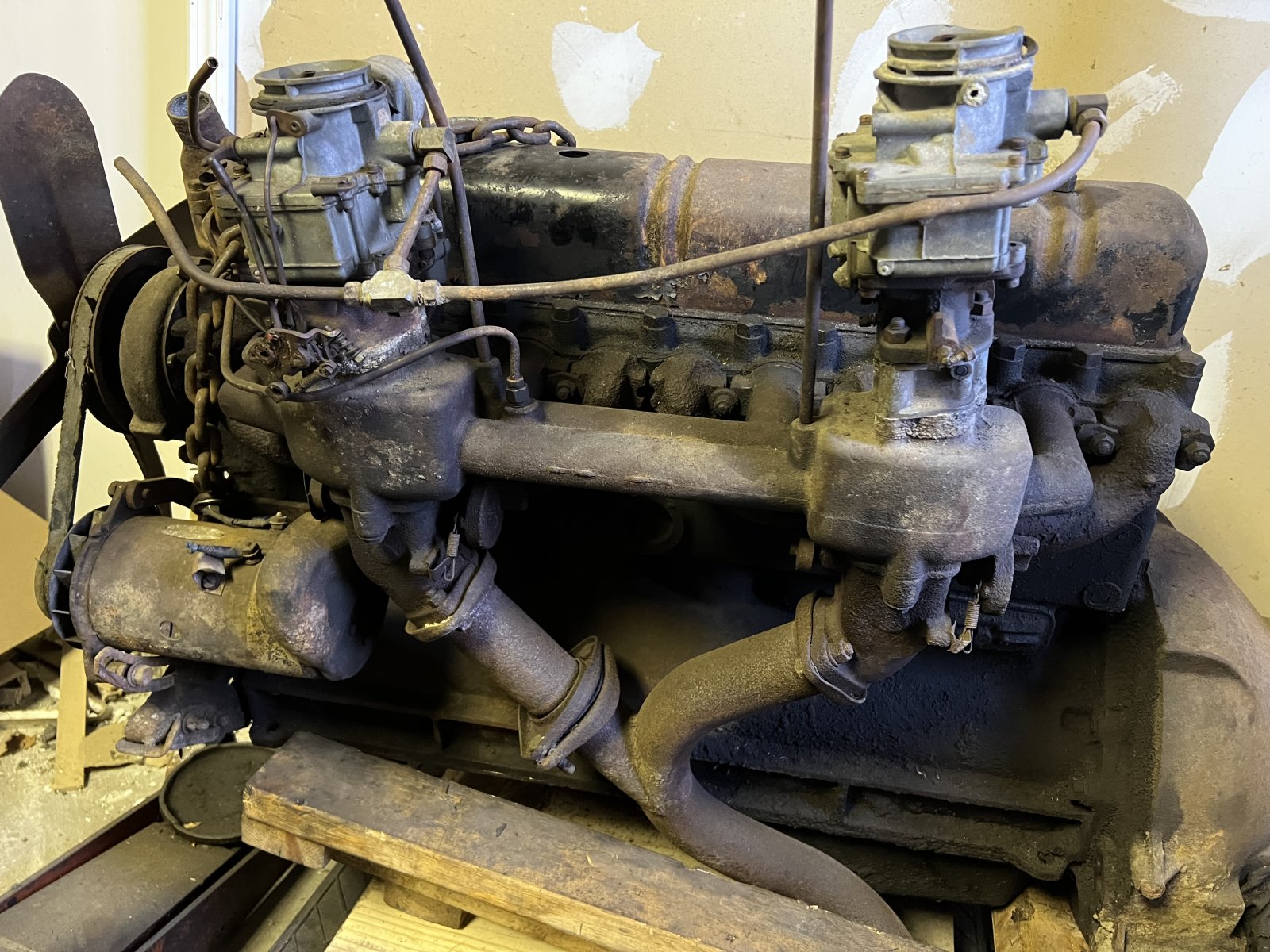

    I always thought a big straight 6 would be cool in a roadster, so by that rational, a free dual carb straight 8 is even cooler? theres a handful of projects i need to finish before i can start doing anything with this, but its never too early to start collecting parts! Possibly a T5 to adapt to the baby buick 248 straight 8, and i've always thought quarter elipticals were cool, and i need some front suspension to handle the weight. Im going to try and keep this pretty low buck, and so far a free body, free engine, and atleast free rear suspension is off to a good start

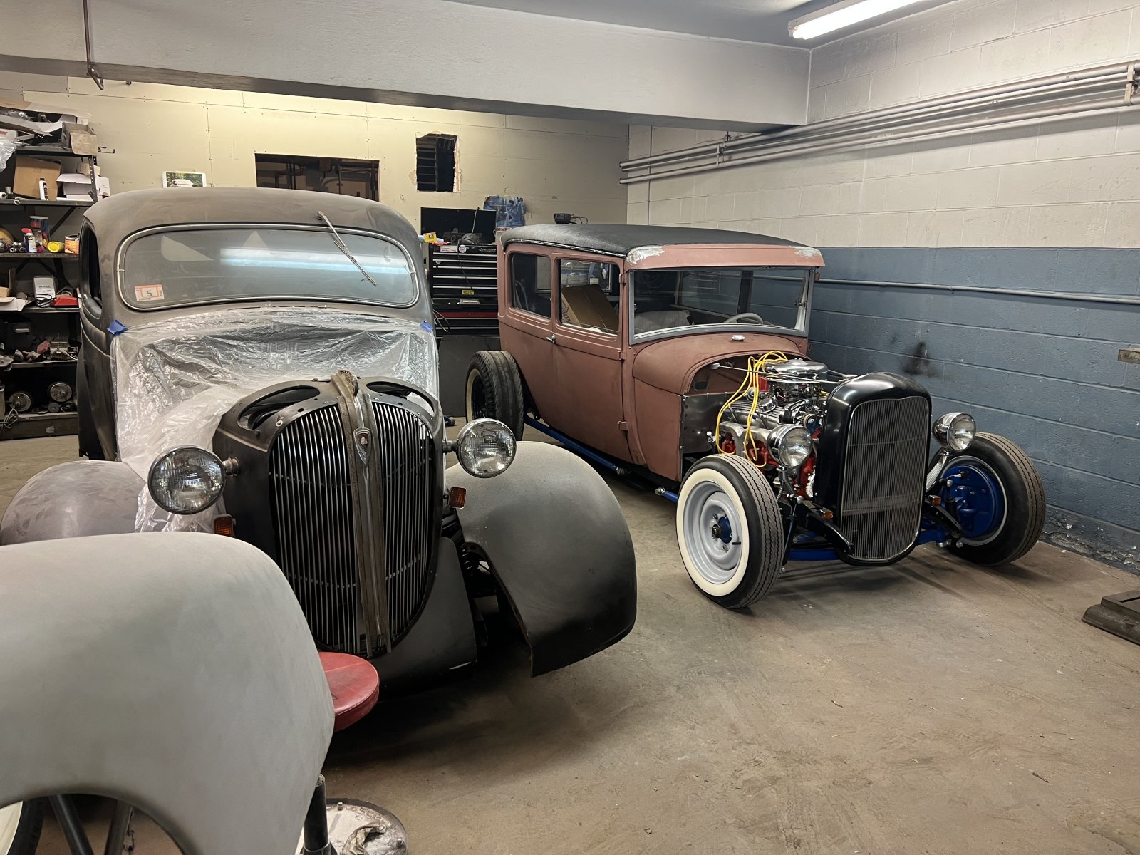

    That is not a roadster cowl. Lots of cool stuff, love the header on the Buick!
  8. See Jonathan W, on You Tube , for inspiration.
    Also, with a little work to the bell housing the T 5 will bolt up.
    Ben

    At first i was thinking it was a cut down coupe, but the rear belt line/ lip didnt look right, but the windshield stanchions and the rectangular holes, didnt look like other roadster cowls i had seen either. Im fine with cutting/ reworking the holes and windshield posts if i dont come across the correct cowl
    Yeah, thats what i was thinking with the T5. Bendtsens/ speedgems has an adapter for late 80s/ early 90s S10 t5's, so injust need to find one with a cable driven speedometer instead of the electronic ones. I need to get some other projects finished before i really start anything on this, but doesnt hurt to start keeping your eyes peeled for parts
    dana barlow and BJR like this.

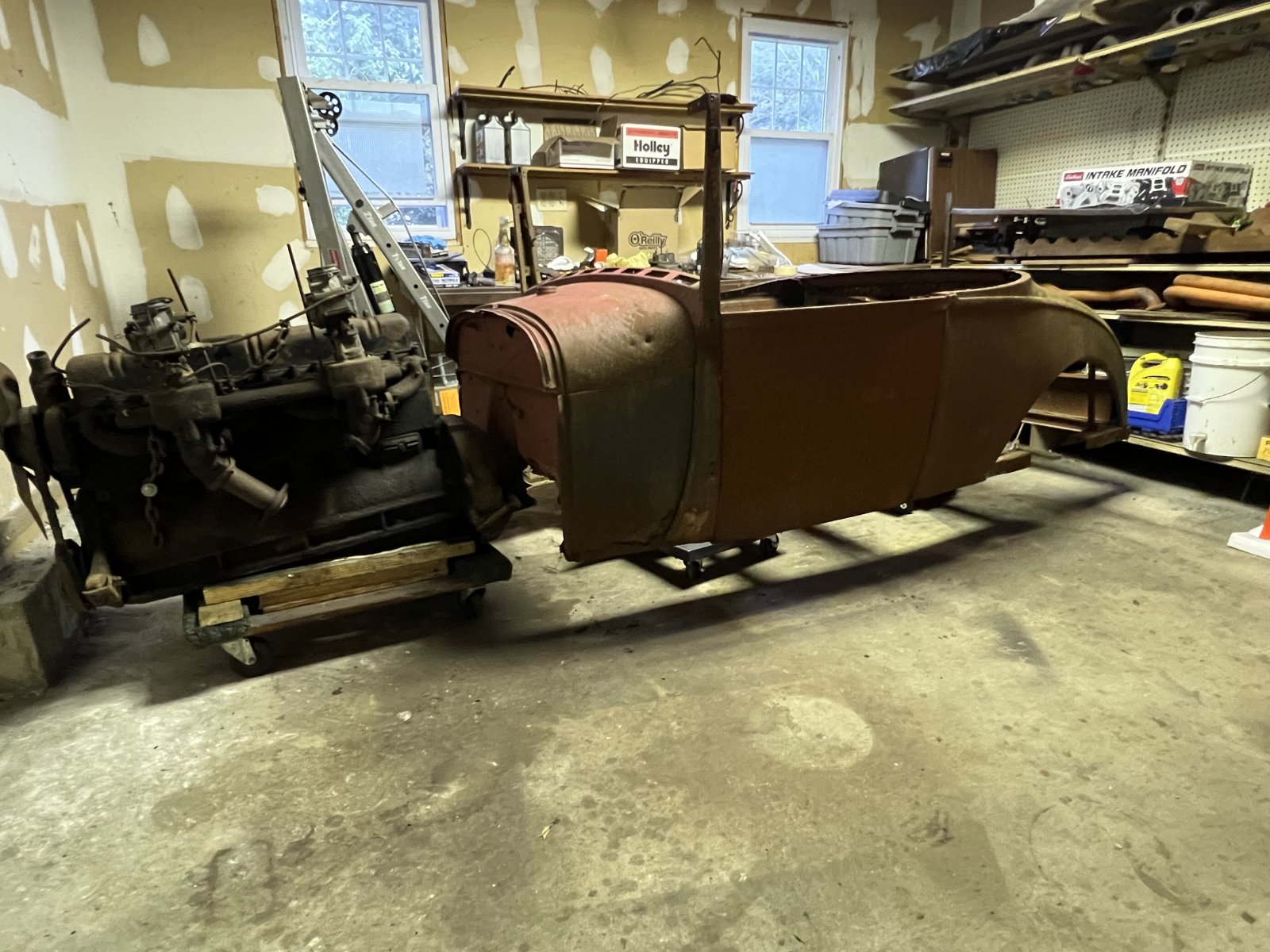

    after a few days of thinking it over, i've wanted a full fendered roadster for years now, and full fenders and hood means flathead V8, so i trucked home a 59A-B and transmission yesterday morning. I still need to drag the front and rear axles, with the wishbones, springs, steering, etc. but i wanted to get the engine home since that would be the biggest thing to move first. This might not be the engine i end up using, but for free, it will be fine atleast for mockup when i start doing anything serious with this project.

    of course i had to roll it over infront of the body when i got home to get the imagination going!

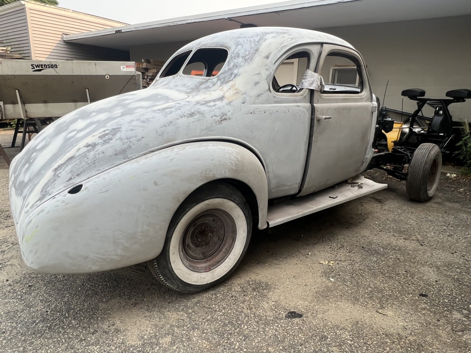

    Also wrestled the fenders back on to the Buick, both to free up some floor space, and figure out a spacing/ alignment. Not the funnest thing to do without an extra set of hands, but its on. i need to figure out what to use for a radiator support. When i brought it home, there was an old alternator pulley acting as the spacer, so i put that back in saturday, but i'd like to think of a more permanent solution.

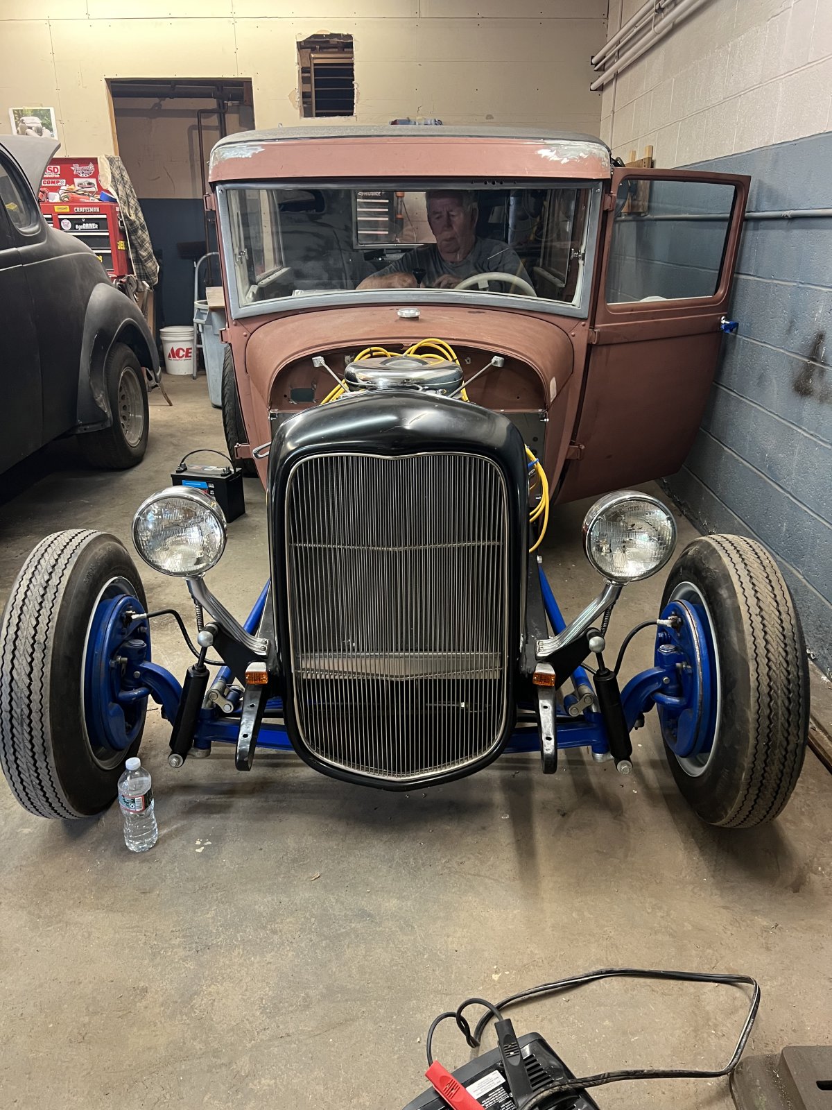

    And got the Tudor running! it sounds like it had been a few years since it was last started, but just drained the gas and replaced with some fresh stuff, new battery and fired right off. Sounded good, i think its a pair of cherry bombs/ some other red gl***packs under there. The oil pressure gauge wasnt reading anything, theres definitely oil, but add it to the list of things to look into, and give it a good once over.

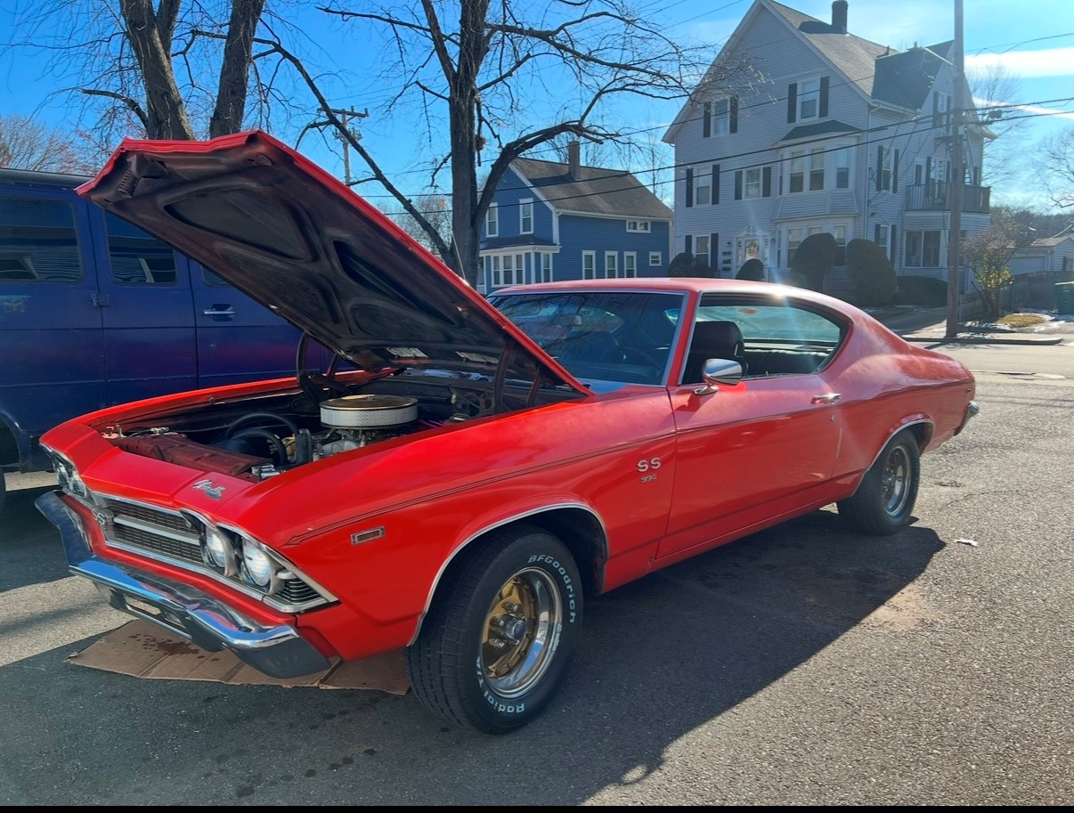

    I've been keeping busy, i freshened up a '69 Chevelle SS 396 for a friend of mine, who inherited it when her dad p***ed away in 2023, but he had owned the car since he was a teenager in the 70s. It had been off the road for 20+ yrs with a wiped out cam. Engine rebuilt, (not by me), new gas tank, carb, distributor i stole off one of my other cars, fuel lines, trans lines, fuel pump, radiator, inner fenders, cleaned up wiring, new shocks, some new brakes, sway bar bushings and links and probably a bunch more, but got it starting driving and stopping for them.
    Plugging away on the Buick and Edsel and freshening up my C10 since it sat most of the year and started running a little rich. Carb look ok, but there was a bunch of junk in the inlet port so im guessing some stuff got pushed through and gummed things up. i had a new one on the shelf i tossed that on and will rebuild the other one when i get the chance.

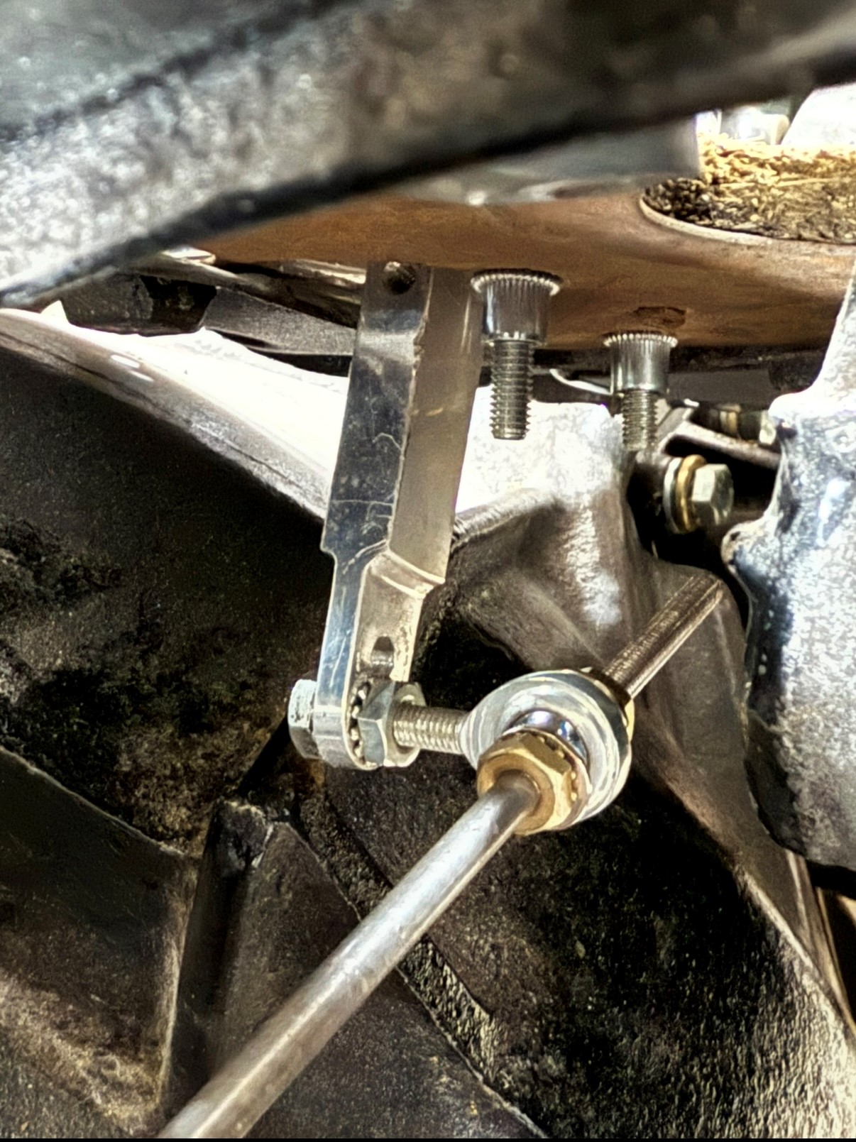

    Working on getting the pedal to work a little smoother with the dual carbs on the straight 8. Cut up a Summit aluminum underfloor pedal and adapted it to work with a 3/16 rod and used a heim joint at the pedal instead of the cable. It was kind of herky jerky, but i removed the return springs off of the Strombergs and that made it a little more fluid, but i still need a return spring, so i might cobble something together at the pedal end of things. Also found some banjo fuel fittings from Nystrom Performance that solve my issue of the fuel lines occupying the same space as the hood sides, and still use 5/16 hardline.
    I'll figure out a way to attach a more stock looking pedal in place of the cut up aluminum chunk there now

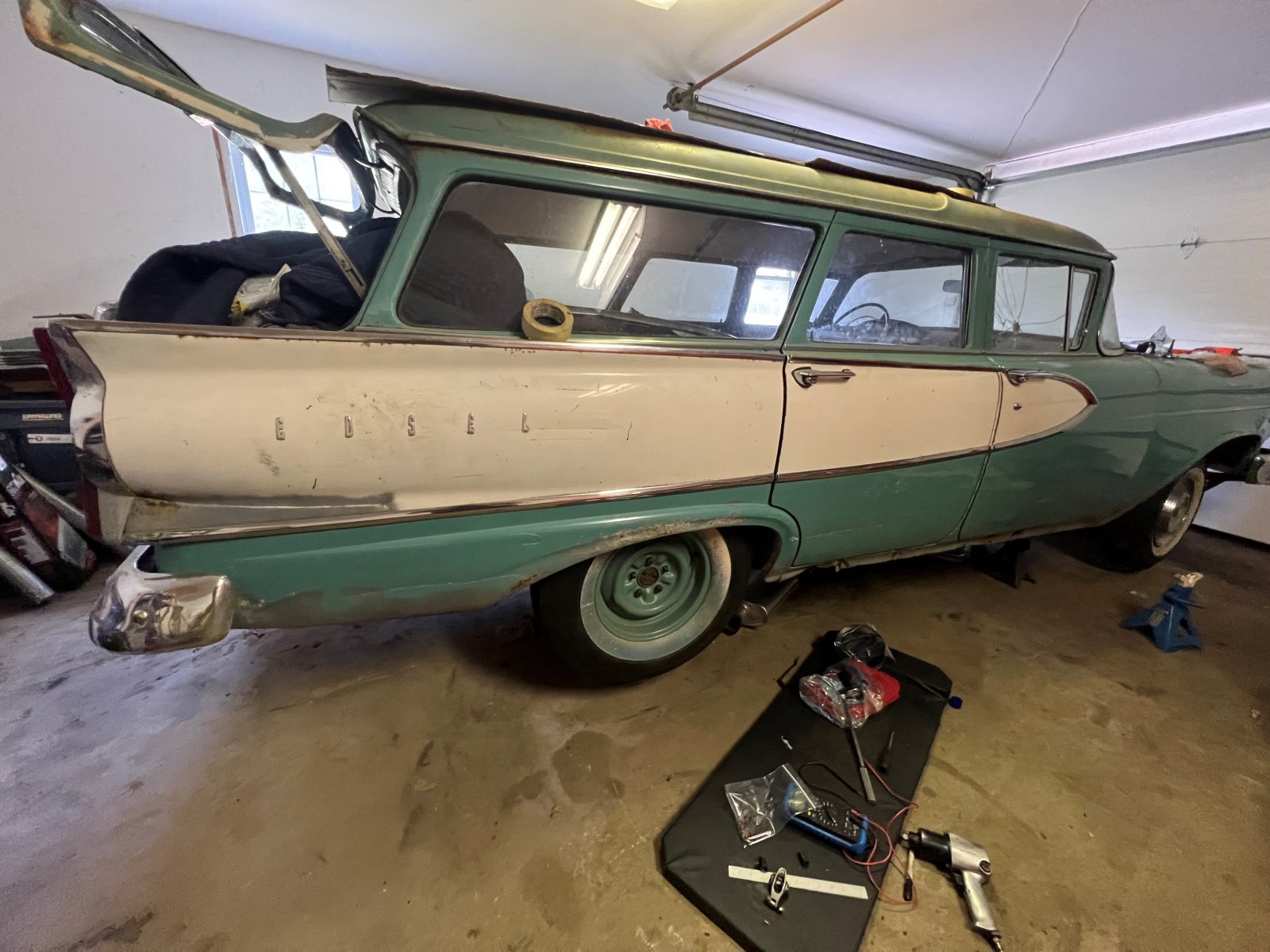

    Getting the stock Edsel pedal to work with the later 460 big block is going easier than i was expecting. i had to weld shut and redrill one of the pedal bracket holes to fit the intake mounts, and then just bent and threaded a short piece of 3/16 and found some quick release ball joints. I have a set of pulleys for the crank, waterpump and alternator coming in tomorrow after ****ing around with old pulleys i had scavenged around. CVF Racing had a set of scratch & dent ones on their ebay page for a little over $100 for the 3 piece single groove pulley set, so i grabbed those. Next will be pulling the exhaust back out to fully weld up and make a few hangers, then start figuring out what changes with the wiring need to happen with the 1 wire alternator and pertronix distributor. Ive read a few posts on here about it, but need to go and map it out with the car infront of me
    I havent hooked up the original kickdown rod yet to see if that will fit the C6, but hopefully thats not too far off that something cant be micky moused together

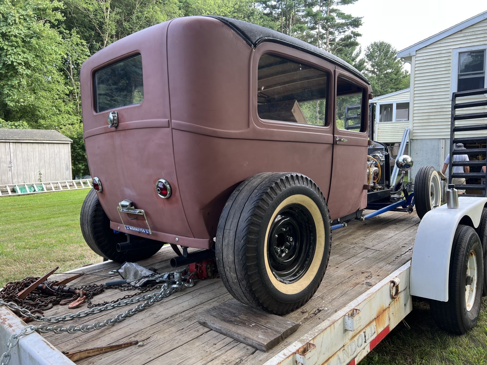

    The other '29 tudor sedan seems to have a problem with the rear end so that will get pulled and theres a handful of other things that need a good once over.

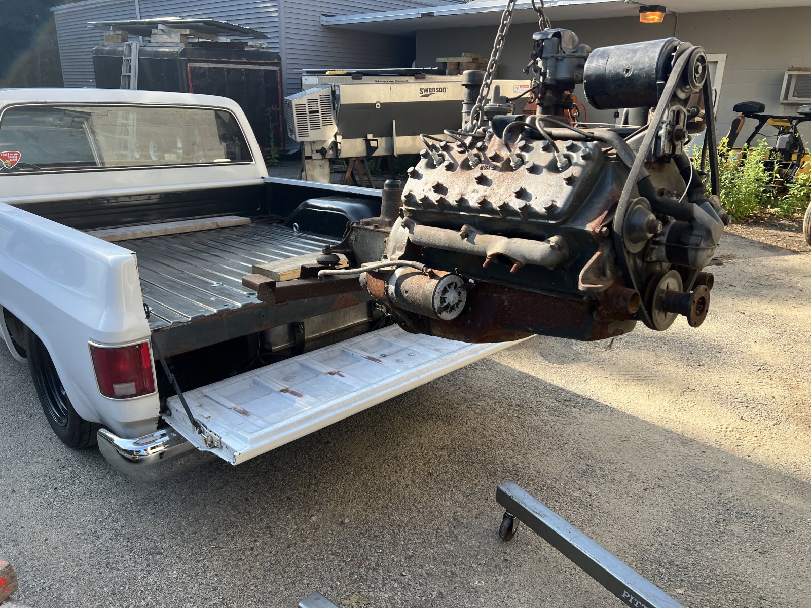

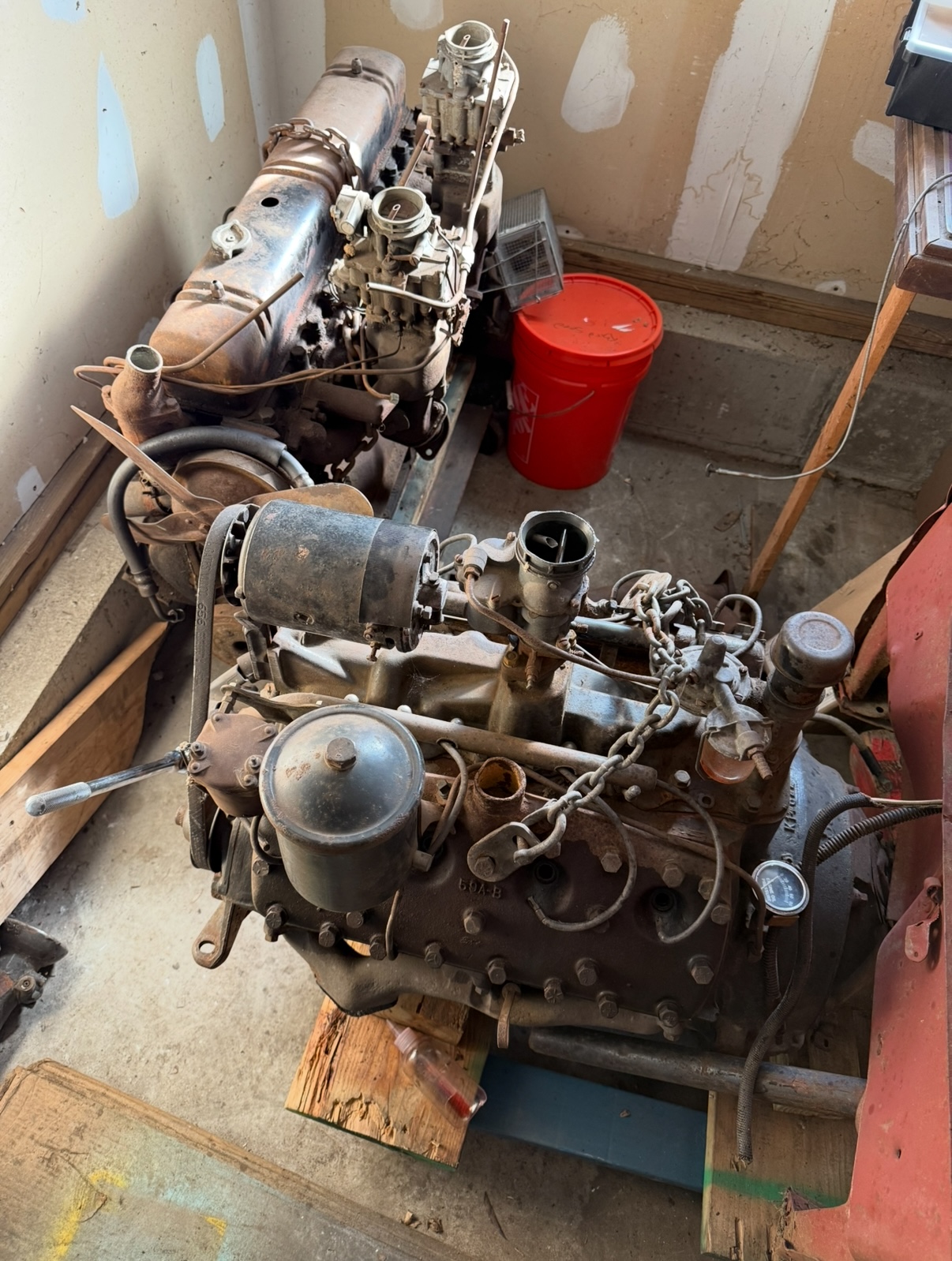

    Ive had the flathead since the summer, i got it for free with the model a stuff, but was taped shut under a tarp, under a porch. Supposedly was a good running engine at the time that my friend's cousin got in trade, but ive been avoiding it. Pulled the plugs friday night, no rust and came out easy, and dumped some marvel mystery down the cylinders. Saturday it spun over first try with a ratchet on the crank and goes really easy. I'll pull the heads and pan at some point, but im staying optimistic since its atleast not frozen. I cant do another expensive full engine rebuild after the buick's engine, so if i can get away with a cleaning and regasket, replace as needed, would be good for this car's plans
    I havent really looked up the casting numbers, but 59A-B, rebuilt at some point Holley 94
    IMG_1844.jpeg IMG_1845.jpeg IMG_1846.jpeg IMG_1847.jpeg IMG_1852.jpeg IMG_1853.jpeg

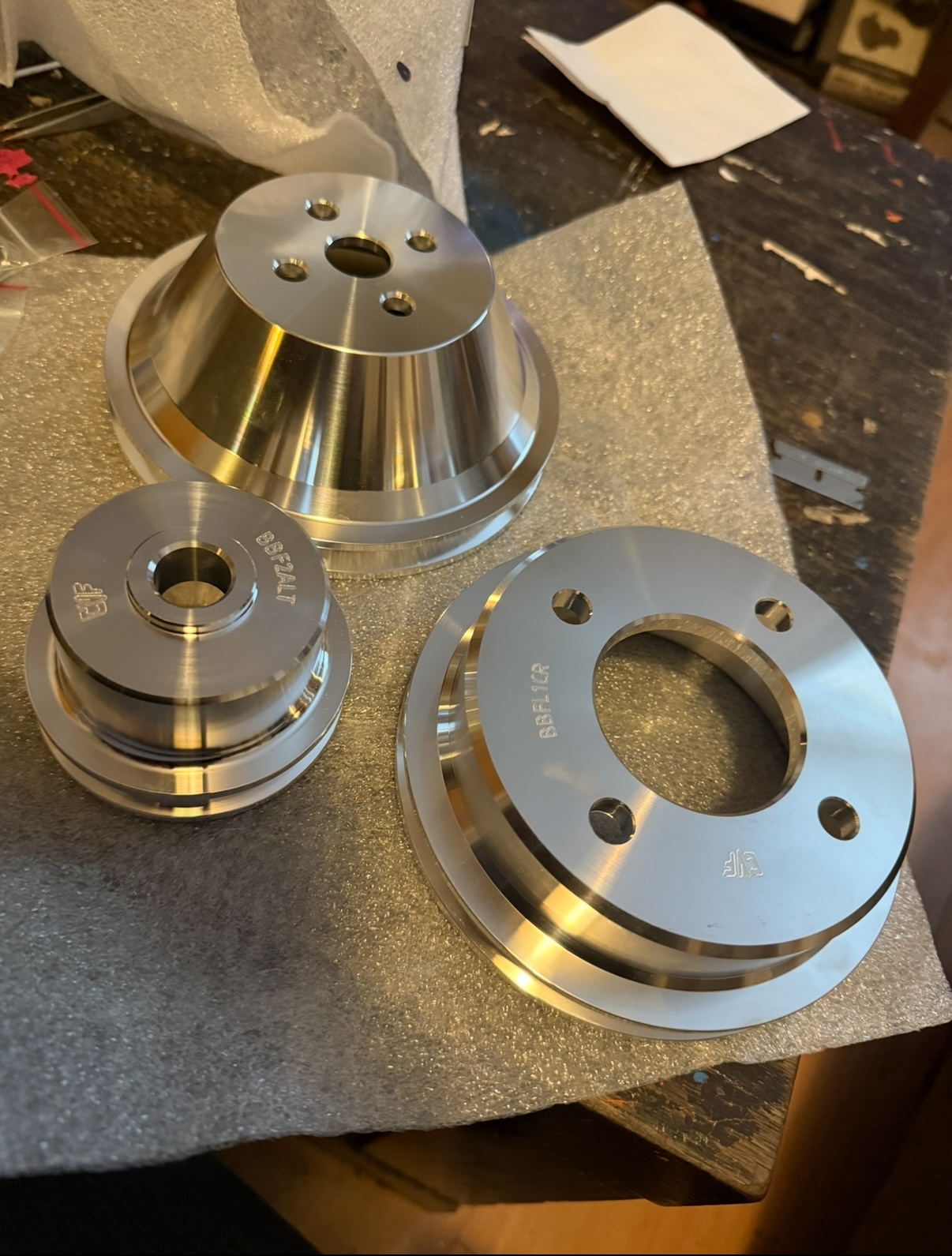

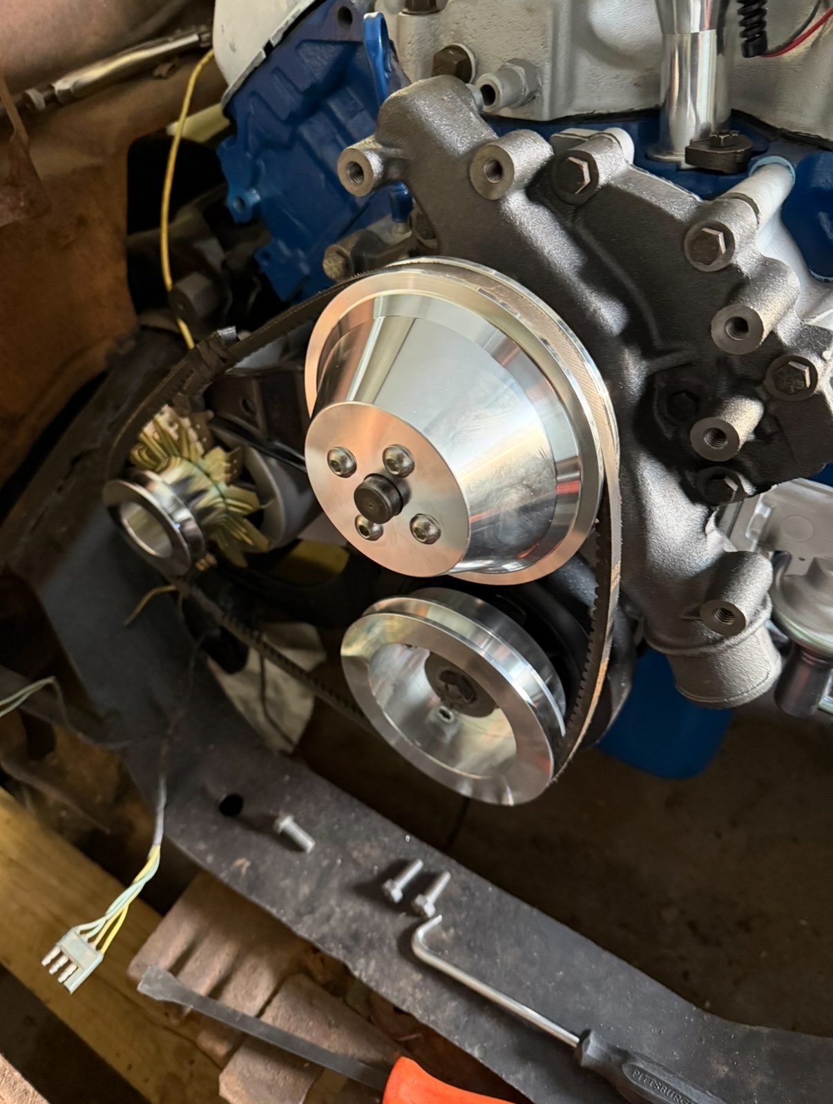

    Got in a set of pulleys from CVF Racing for thr 460 in the '58 Edsel wagon. Ive bought from them a few times before, and they have some good budget minded sets and made in the USA. I had been trying to put a set together out of stuff i was coming across, but then the set i was looking for popped up on their ebay store as scratch and dent for $119 and they look perfect
    just an old belt i cut and taped to make sure the belt lined up and i'll use it to measure for a new one

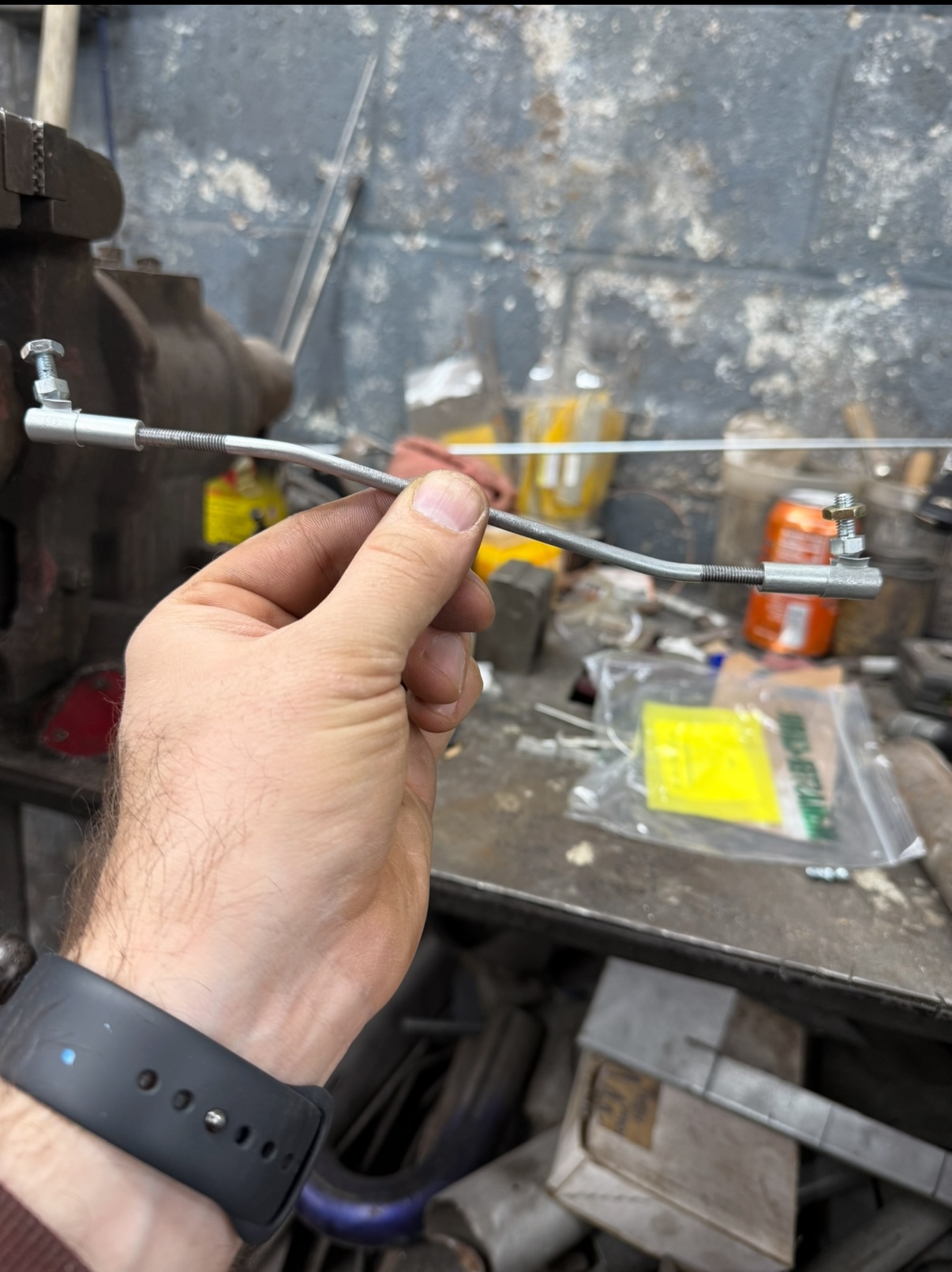

    And cut some length off of the throttle rod in the Buick, swapped out the heim joint for a shackle clevis and made a little threaded piece to mount it just to prove the idea. I'll make it a little nicer/ more permanent next. Some adjusting to get it right and its working just how it should now. Put the stromberg arm springs back in so i didnt have to reinvent a throttle return set up and its all nice and snappy. I want to remake the stock flat plate that i mounted the pedal to, and that the clutch and brake pedals go through. Maybe make the new one out of 1/8 or 3/16 plate and try and use the stock threaded holes in the floor.

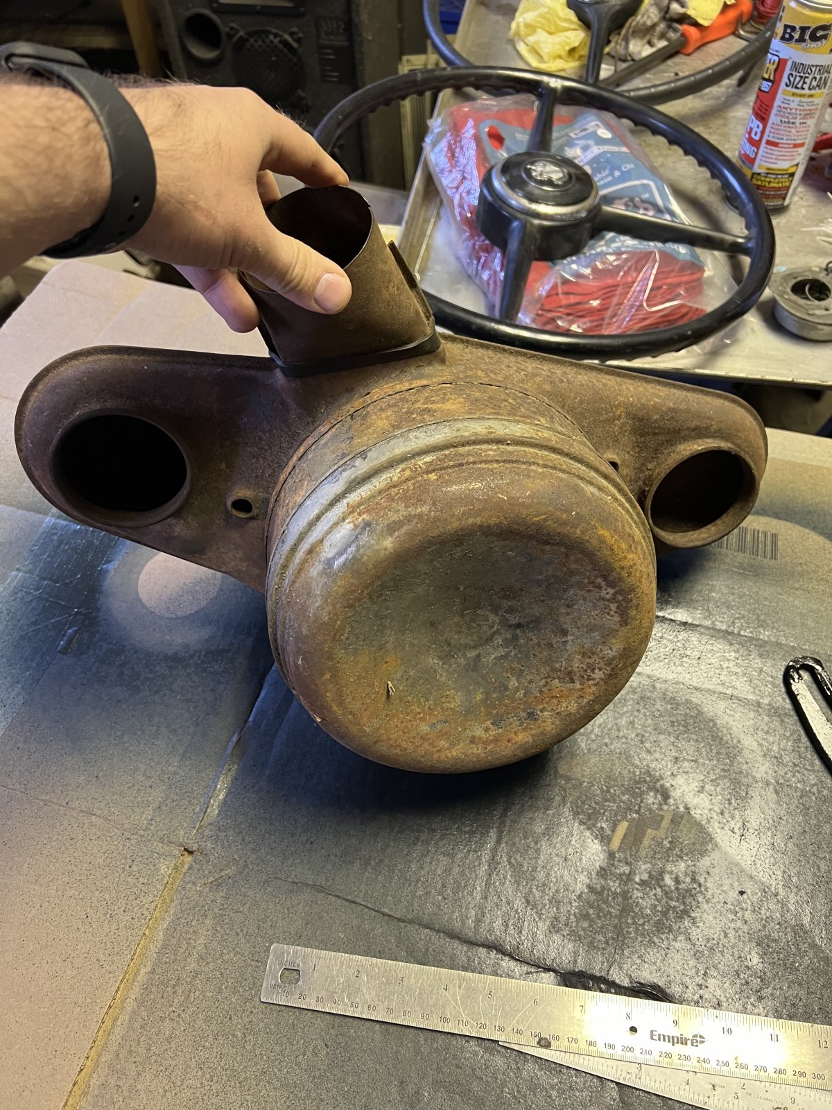

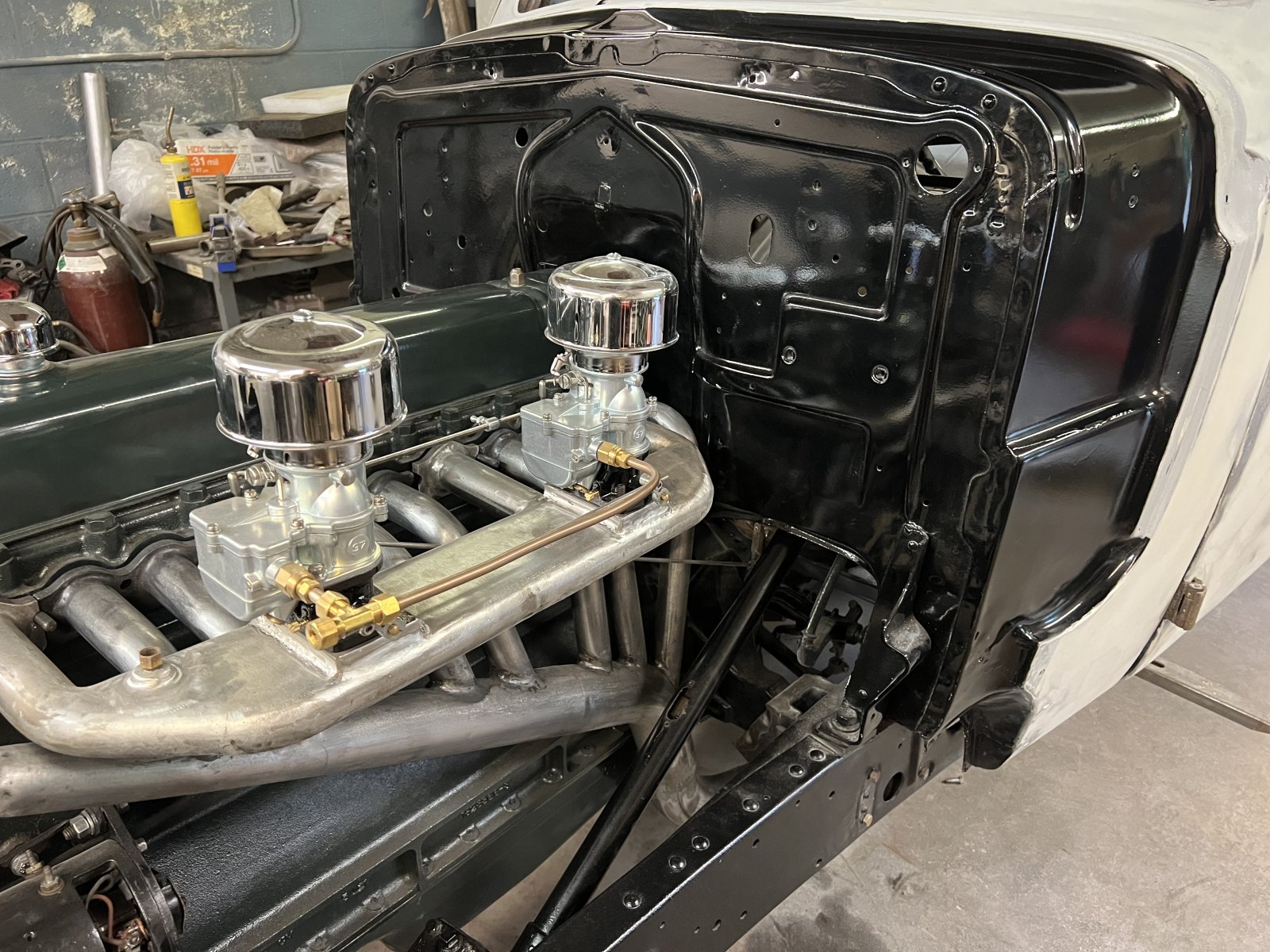

    Im not a super genius when it comes to intake plenum volume and things like that, but it did seem like the intake as i made it, maybe had a bit too much interior volume and that was kind of stewing in the back of my head for a bit, so i decided i'd try and reduce that a bit and seperate the carburetors a little while still allowing the sides of the new recess to act as balance/ equalizer tubes
    Start with a chunk of square tubing and cut it all up
    And Mickey Mouse'd a way to test that it was air tight, (there were a few pinholes around where the intake runners connect to the main body) using some expandable freeze plugs and a coolant leak pump

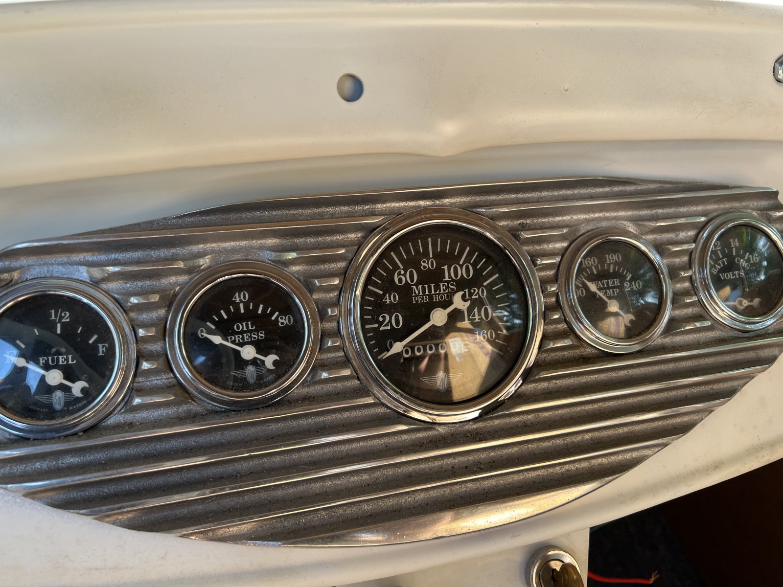

    Has WesTach make me a 6 volt tach to match the dash, atleast in color

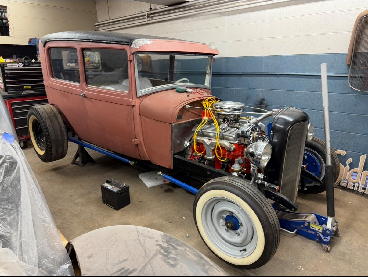

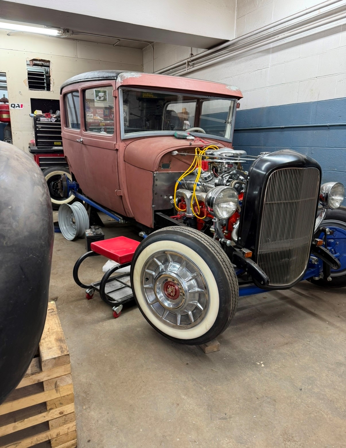

    And even got the '29 Tudor fired up

    Volume on multi carb setups isn't necessarily a bad thing. It actually helps the gas and air mixture as fuel flows to various cylinders. The less volume the less mixing the fuel/air does.
    Stooge likes this.

    Yup, this is an experiment/ hoping for the best, loosely based on some old intakes i've gotten to fondle and wanted to try and make one. The shape is similar to the old Edmund's Custom ones, but where those are cast aluminum, and i made mine out of plate, the inner walls are obviously much different, thats what was sort of pushing for making a recess to reduce interior volume. There was just alot of space in there, and now there is just slightly less, but with alot of space on either side of the recess to act as balancer/ equalizer tubes. The stock 1941 dual carburetor intakes i have for the smaller engines, are really just 2 cast tubes running along side each other, and even one of the versions of the Edmunds ones ive seen, almost seem entirely seperated, while others are connected, but still have a smaller interior volume because of the casting.
    In theory, it "should" work, but i guess we will see in a few weeks hopefully!

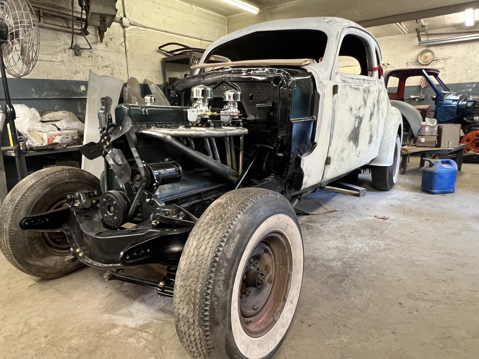

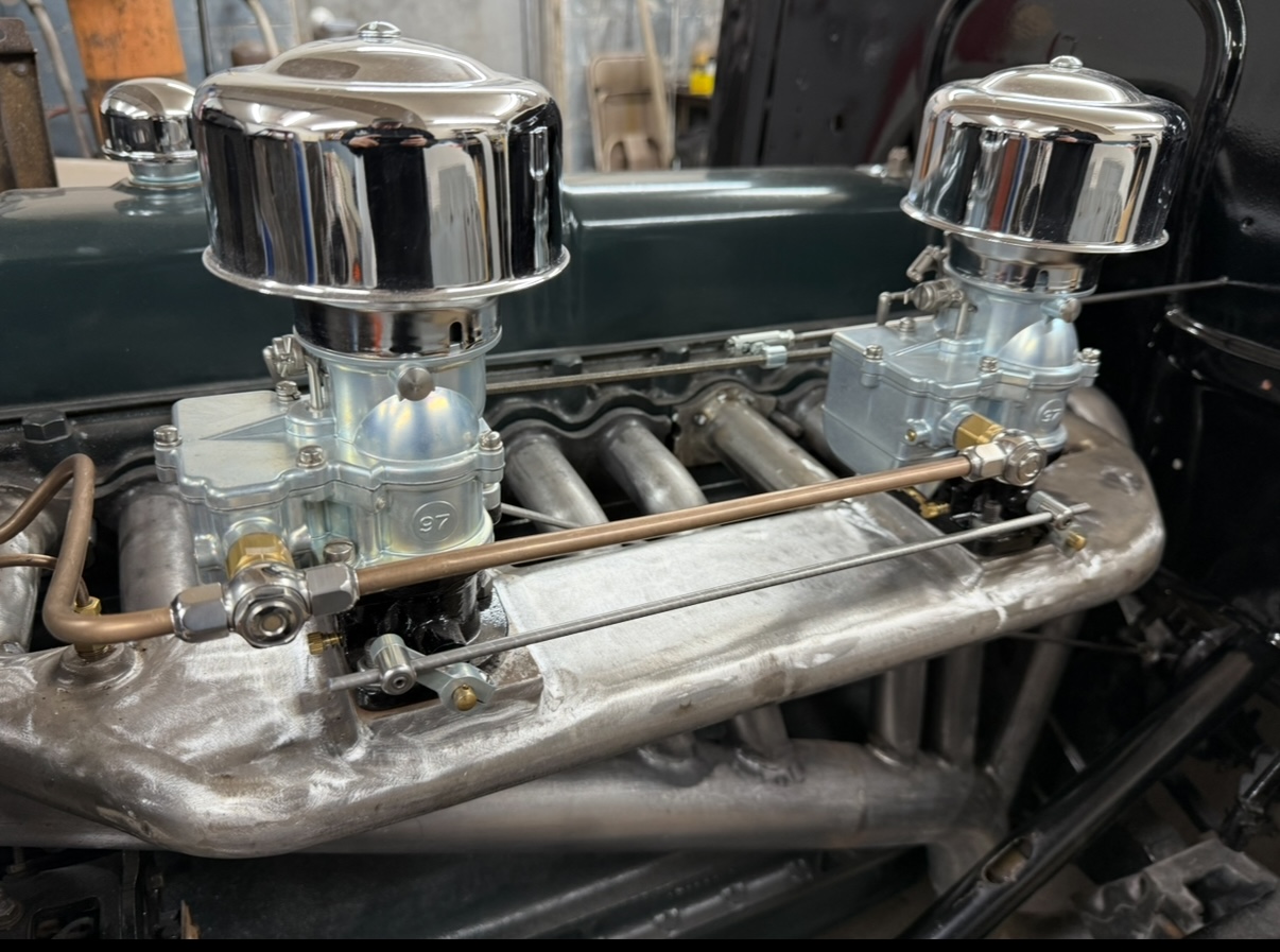

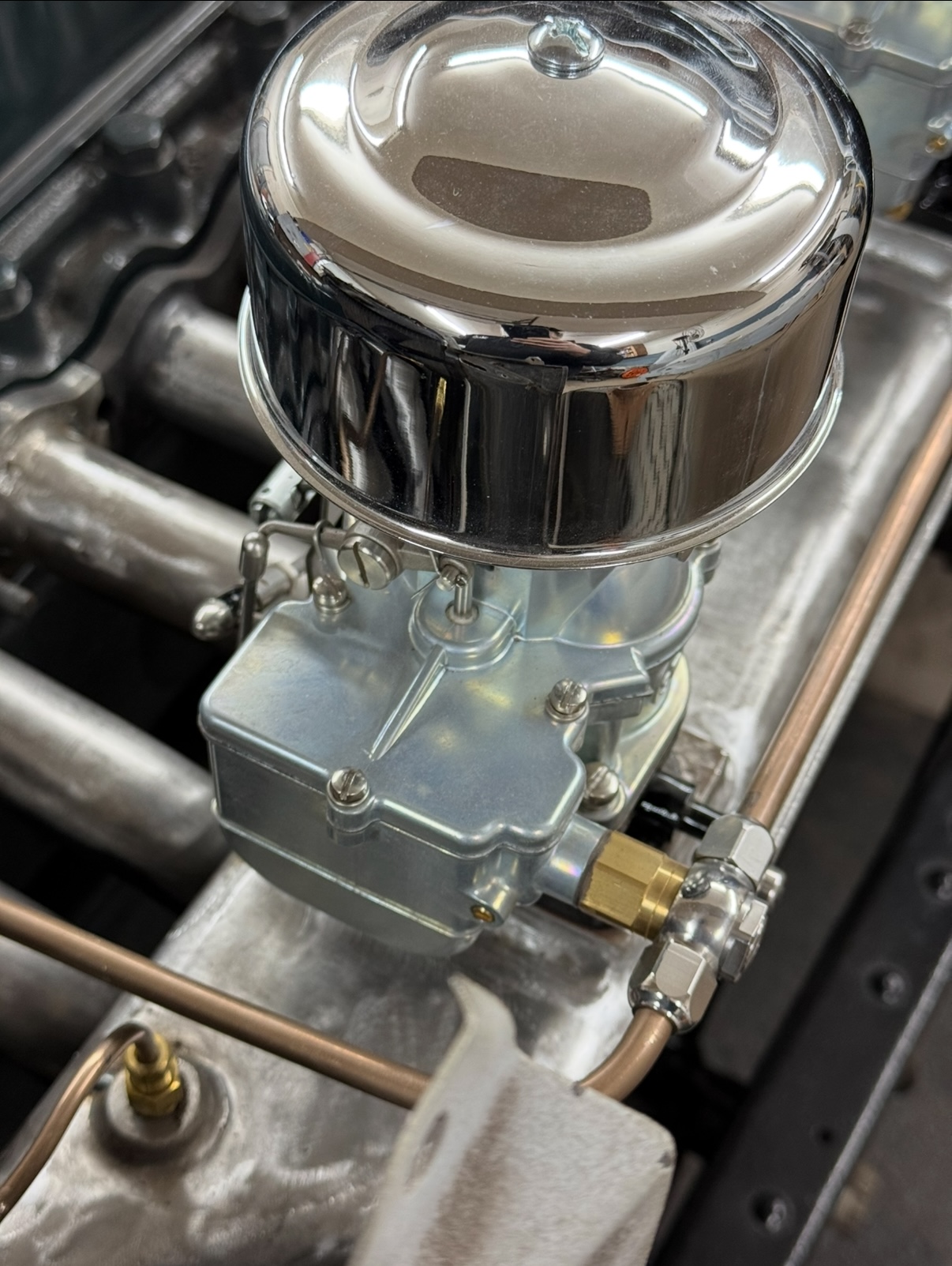

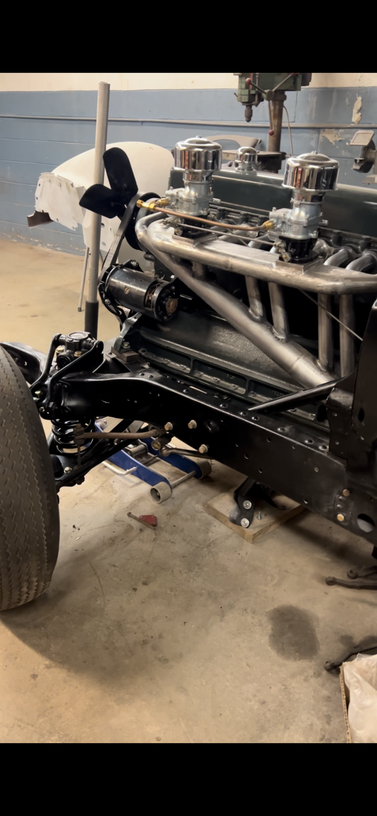

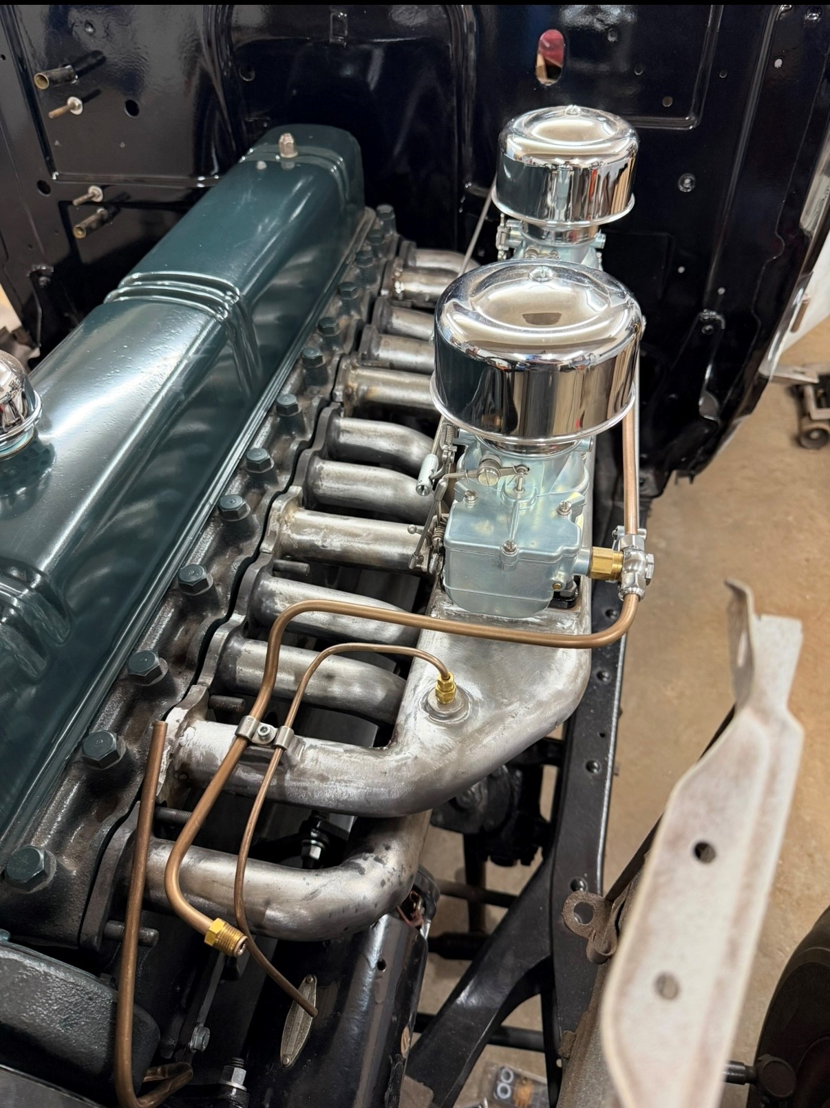

    Plugging away and getting dangerously close to starting the straight 8, a little nervous just with how much time and money i have into this thing and i dont want to potentially damage something, but its gotta happen sometime!
    Fuel line from the pump to the carburetors is plumbed, along with the vacuum pump to manifold. theres still another vacuum port from the pump that i need to do something with in the interim, but the inlet for the pump will just be a barb fitting to a jug since i dont want to put gas in the tank just yet.
    Ni-Copp lines, and Nystrom performance 5/16 compression fittings on the Stromberg Big 97s. To say its tight around the fuel pump on the outlet side would be an understatement. i dont know how it would have been stock, but i just did a 90* and up. i was planning on trying to snake it through behind the fan and belt and around the generator, but it would have been impossible to ever get to/ service once the front sheet metal is all on, and im trying to keep things on this somewhat accessible since its going on some road trips.
    going to add a little support bracket off of the road draft tube housing for the oil line that loops behind the coil
    Was really kicking myself for not putting the torque ball stuff on the transmission when it was out of the car. Trying to get to the top mounting studs, around the frame X member was a real pain, and of course that last, least accessible one was stuck. Ran a die over it after it was out, but something was still giving me grief, but its on and i;ll be buying a special wrench just for this job incase it was to come back out. I need to recruit an extra set of hands to get the torque tube rear end jostled around to meet the torque ball flange, but im hoping the hard part is done.
    I bought a shim/ repacking kit from Bob's Automobilia, ive never done anything with a torque ball/ torque tube, but it seems to be working as per the directions, and i cant think of how else it is supposed to work. i did replace the C clips in the U-joint with some i got from McMaster Carr, but it probably wasnt really necessary, but its done.
    Still need to install the crossmember, but after wrestling with this stuff all afternoon, i called it a day.
    I also punched out the inner rod/ oil pump drive of an extra distributor to make an oil priming tool. I had to buy 10 quarts (2 jugs) of break in oil for this thing so i wanted to make sure the oil gets pushed all throughout the p***ages.
    a little work on the Edsel, got the pump to carb fuel line made up, did all of the sealing for the waterpump/ timing cover and bolts. Need to find a belt, and a few little things, along with figuring out some bracketry for the kickdown cable to attach to the throttle linkage. Im using the stock pedal and manifold bracket and made a threaded rod for that, but because the stock big block ford kickdown rod doesnt fit, i bought a cable, but now have to figure that out. Theres a bracket i think will work, i'll throw it in the cart for the next time i order from Summit to give it a try.
    im not a fan of these premade spark plug wires, and may grab a set to make them to length as its bothering me that they dont neatly organize them how i want.
    i had to grind away some of the fins on the exhaust manifold, and just sprayed them with a rustoleum high temp that ive used before. Hoping they heat cycle ok, but this project is on a budget, so it is what it is.
    Also, found a cheap grill shroud at the New England dragway swap meet last weekend to add to the parts pile Model A i have a direction i like, low and full fendered, flathead v8, and keeping it fairly low buck since i have all of about $200 into this so far, with body, hood, '40'ish ford front and rear axles/ suspension, 59A and transmission, some extra steering columns, an extra cowl, milkcrate full of headlights and misc other stuff, a pair of 40'ish for wheels and a pair of 16" wires. This is all just sitting on dollies. Going to start keeping an eye open for a frame/ ch***is to stick under it over the winter/ spring.
    And this is the direction im looking for, maybe not color wise or as pretty, but full fendered and how it sits. If anyone knows this car, and can point me in the direction of what it has for underpinnings, it would be appreciated!

    Getting dangerously close to hearing this car make noise for the first time in many many decades. Pressure tested the intake with a mickey moused set up of a radiator pressure pump, some expandable rubber freeze plugs and some sheets of rubber and heavy metal plates clamped down to block off the carburetor flange openings. Held pressure well, there were a few pinholes i had to weld up, but i was happy enough to send it out to my buddy to be Cerakoted, in "Satin Aluminum" finish, since i couldnt get it a shiny polish type finish, i figured i would go with having it look closer to cast aluminum.
    Definitely shows every little imperfection in the metal, but it doesnt have to be perfect, it was something i made.
    Found some old copper gasket sets
    I have a shrinking list of stuff to get done, but i have next week off from work to burn up the last of my vacation time by the end of the year, so im really hoping everything goes smoothly and i'll be hearing this think make some noise that week!
  29. What's not to like??
    I was not successful with those manifold gaskets. I now use Rem-Flex from Summit Racing.
