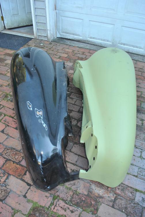

    These arent mine, but belong to someone over on the buick club/aaca site whos body swapping a special body onto a century ch***is to make it a century. Primered fender is off of the Century and the black painted one is from a special, close but fairly different mounting edge and pattern DSC_0753.thumb.JPG.71f7b2f3284c3d3ec64384bbe2e236ab.JPG DSC_0754.thumb.JPG.3b6fa7fd3351354051e3c4d918cb9b1a.JPG DSC_0755.thumb.JPG.9aa27ba249df97f39f96cda9f04b9620.JPG

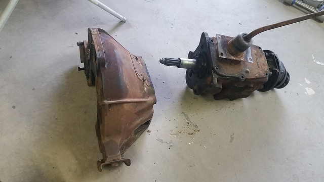

    No, it's all stock inside with factory column. The steering gear was worn out so sent it to Lare's for a rebuild and now with every moving part in the front suspension replaced it drives really well. Even back in 1937 a Buick was known as a long distance road car and many like your coupe were bought by salesmen as they had a huge trunk and secure behind the seat storage.
  11. vtwhead
    Joined: Oct 20, 2008
    Posts: 5,312
    vtwhead
    Interested in what mods have taken place on the top of that shifter for the ******. I have had several of those large boxes and none came thru looking like that. I have a source for parts for Buicks but it is in the mid west fwiw.

    Well I may not be very pe***e, but I think im probably tall enough to be able to get in and out with out them! :rolleyes: they should be fine, as said they were actually meant for heavy industrial shelving with only side supports. so having 2 full length runners around the perimeter, im thinking maybe some C channel or 1/8" wall 1x2 or 1x3 rectangular tubing , (I think I already have a few sticks of it around here somewhere) with the mounting brackets welded to them to attach to the frame mounts.
    Im probably just misremembering about the steering column. whats strange is my car came with a steering wheel, horn ring and ****on, but no steering column or box, so that's one of the next vital things I've been looking for, although I may have a line on someone with a few of them.
    As far as a long distance driver, that's one of the plans for the coupe. a buddy down in Alabama has asked me to make the trip down to the Pigeon Forge Shades of the Past show in Tennessee a few times. Its just about 1000miles each way from, and making the trip in the Buick is the goal. I'd like to make it for September 2019, both so I don't get go and spend another 5 or 6yrs building this car to the point that I don't care about it anymore like I did my truck, and to keep it a little more budget oriented if I have some sort of goal and timeline in mind. I think if I can get the buick painted this year, I should be able to make it but we'll see!
    As far as I know its a stock transmission, although partially dis***embled as I need a new counter cluster gear and the top cover is not bolted down and may not be orientated right in the picture. there is a little separate top plate that is not attached to anything that is sitting around the shifter stick itself, but I ***umed it was something ***ociated with the securing the boot to the floor? the rear torque tube joint is also on backwards but I think that was to do with shipping. the case number is the correct number for it as well. I believe in '39 they were moved to a side shifter mechanism to accommodate a column shift, but the 37 atleast was a top shifter.

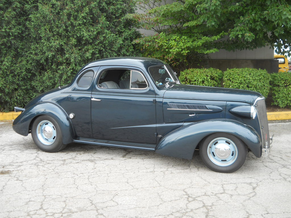

    ^^^I 2nd this idea,...here's a 37 Chev with abbreviated boards, a good look...

    I always did like thst character line on 37 Chevies.Makes it easy to I'd the year.

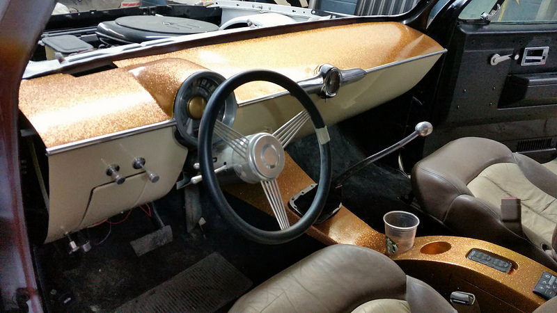

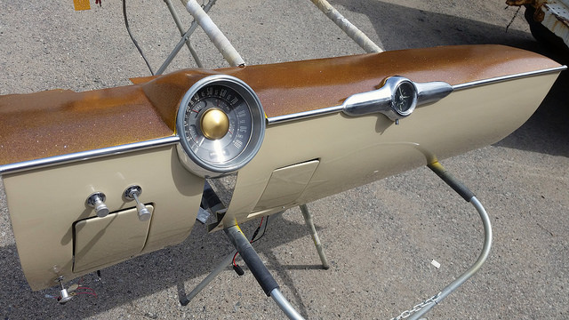

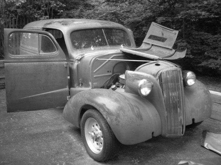

    A 37 Chevy panel truck that a buddy owns was the first prewar car I had worked on, unfortunately/ fortunately, he started a paint and refinishing company and moved the car to his shop and its sat pretty dormant since. Also the first set of doors I started to rebuild
    Camaro clip and sbc
    sitting off in the corner is '37 Plymouth with air ride and a mustang front clip, that is being put back to front coilovers and rear leaf springs plymouth.jpg

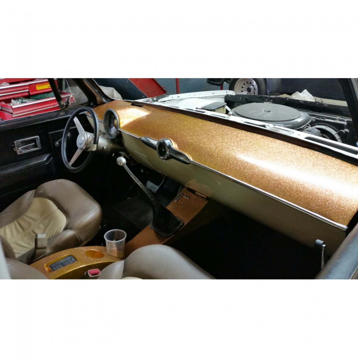

    And although its an off topic chevy truck so I wont post pictures of the outside of it, the dash of my truck I finished up last year. Scratch built sheet metal dash and center console using 49/50 Ford Gauge cluster and clock painted in a heavy metal flake.

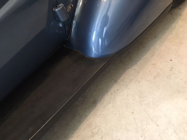

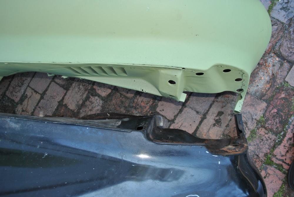

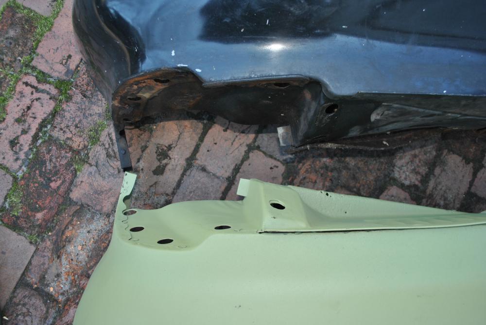

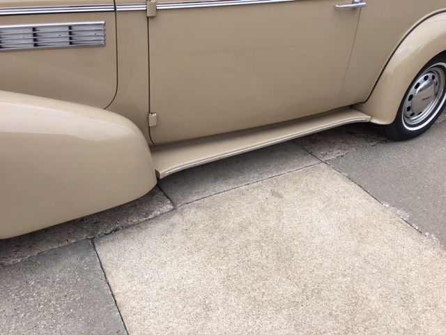

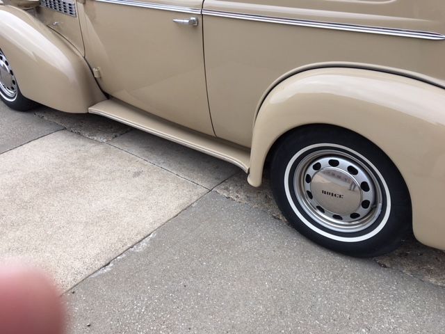

    My pal, Rich, has a '37 Chevy Coupe and thought he would like a narrowed running board and asked if I would do the work. We discussed various options and decided to narrow the leading section little (not much there anyway) then following the front fender curve, narrowed the running board a couple of inches and then did similar at the rear
    fender. I'll try to get a pic and post it today or tomorrow.
    The Buick fender doesn't have the running board extension along the front fender lower skirt, but would still lend itself to contouring the front of the running board to maintain the original intersection of board and fender.
    Another close friend, Bob, Has two '38 Buicks and built his own running boards and they too are contoured. I get pics of those too, and post them just to illustrate the variations of an appealing theme. Chevy 1.JPG Chevy 2.JPG Chevy 3.JPG Buick 1.JPG Buick 2.JPG

    ^^^^^^^^^^^Got the pics I promised uploaded..........

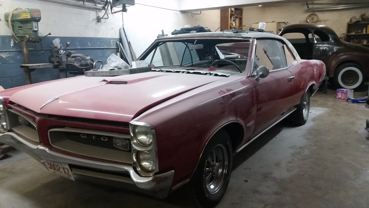

    Its going and its going slow! My clumsy *** slipped down some icy stairs last weekend and ive been dog sitting most of this week, i did manage to get some stuff done yesterday!....then accidentally deleted any of the interesting work pictures:(

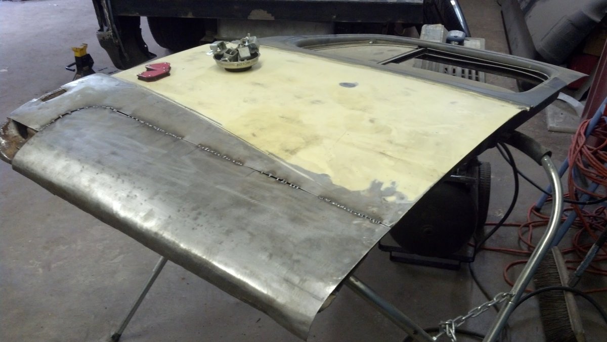

    Finished up the driver side door, and the edges trimmed and folded over and welded to look stock, just needs a good sanding before i start bodyworking it.
    Trimmed 1.5" off of thr frame side of the running board, .75" off the rear side and an inch or so and reshaped the front side a bit so it didnt curve around the fender as much, of course the only picture i dint delete doesnt show any of this. Pretty happy with it so ill retrofit the cardboard to the metal one so i can make a matching one for the p***enger side.

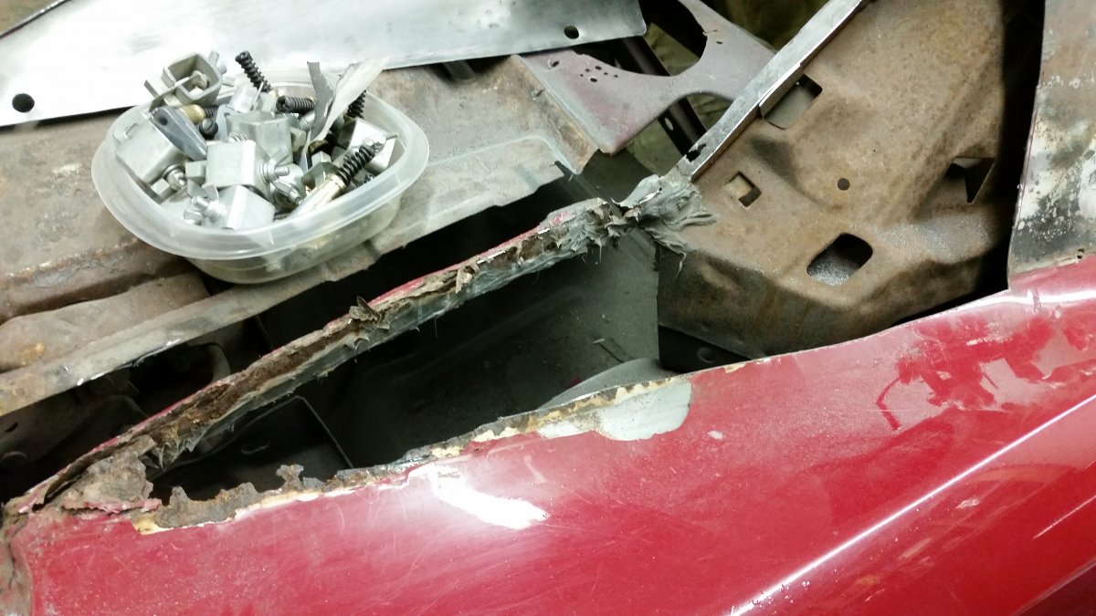

    And a year too new for the hamb, but the last bits of exterior metal work before cutting out the front floors out of the '66 GTO

    There was a time i was half trying to convince the owner to make it a roadster of sorts...but mostly because it was mostly rust
