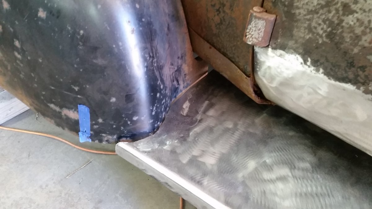

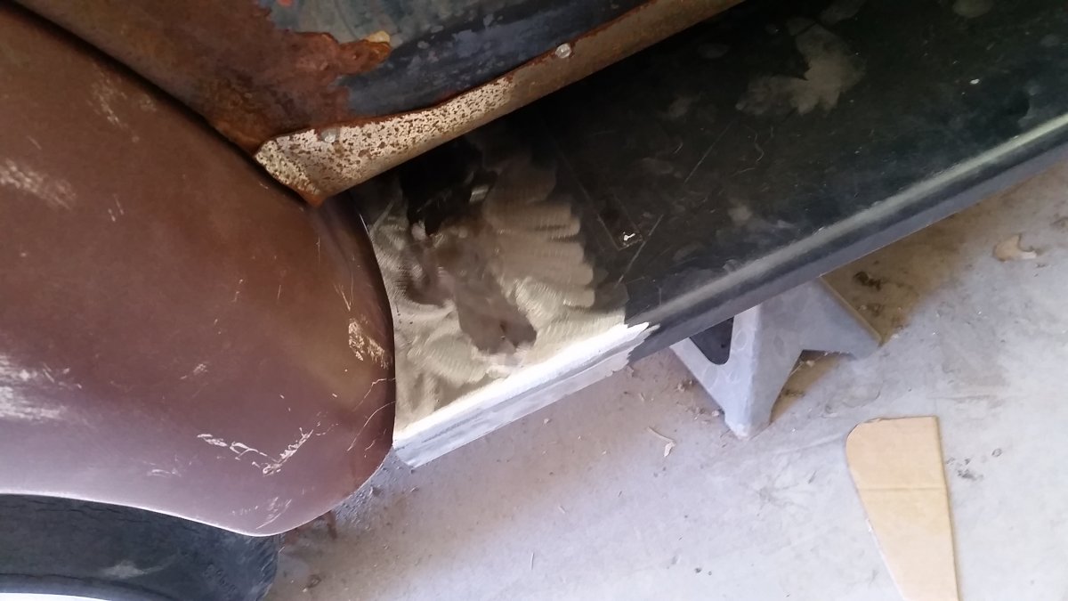

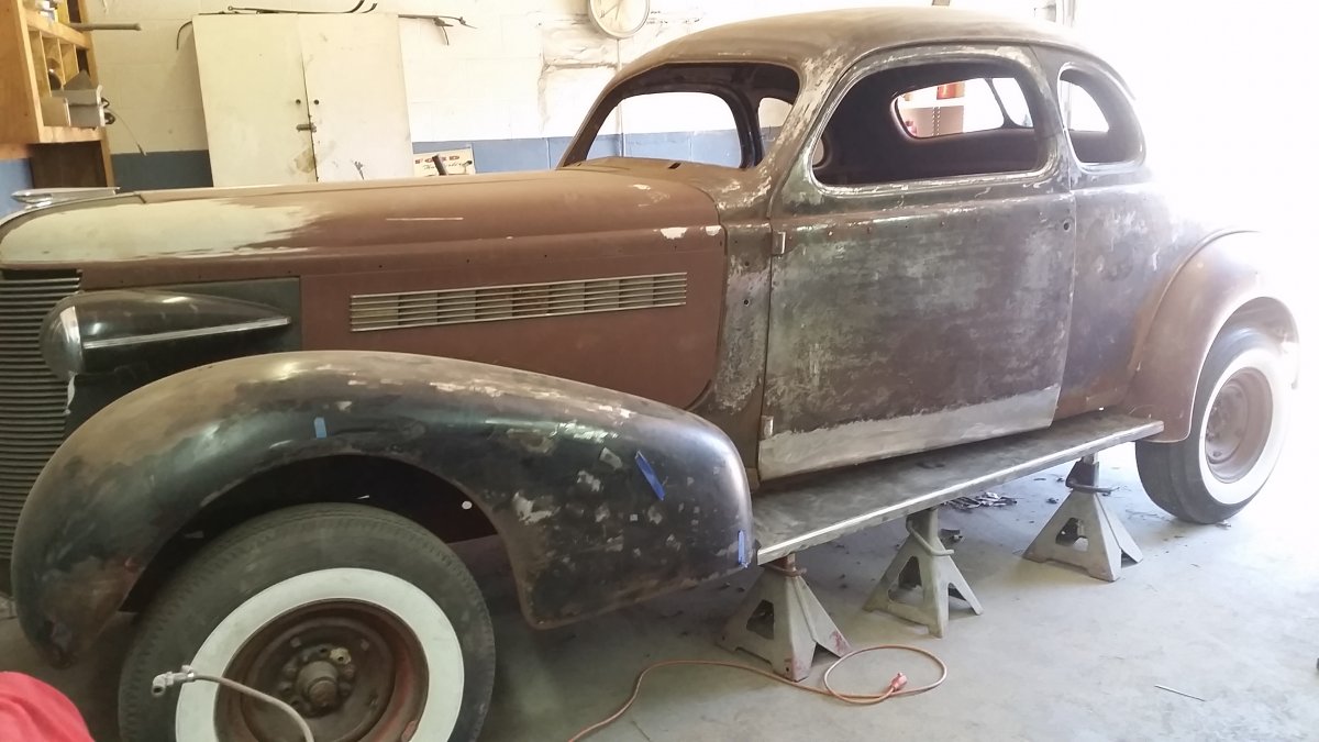

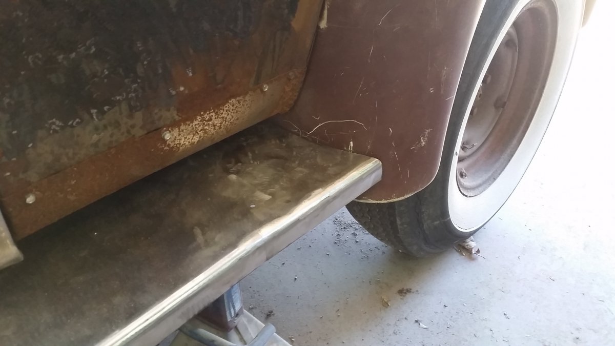

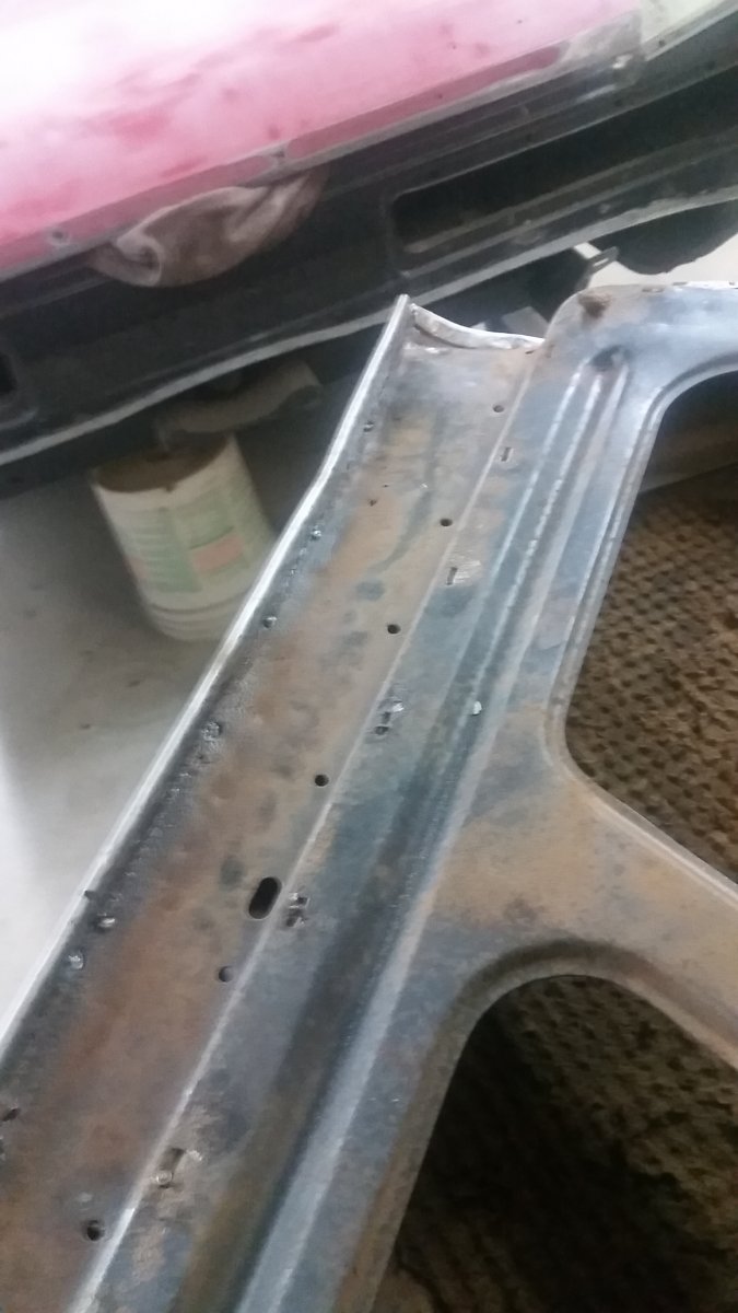

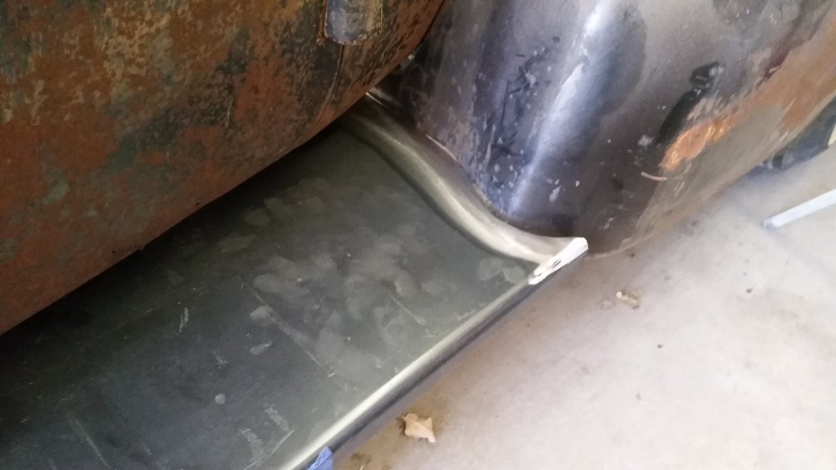

    Made some final changes and fittings with the driver side running board so i could make the template to make a copy of for the p***enger side. Pretty happy with the fit, so i started and finished the sheet metal of the p*** side, alot easier the second time around and didnt have to guess as much, still took awhile without a brake or anything, and the big pieces of my s**** pile were a little short so i had to add a few pieces together for the 5.5 feet of board. still a little adjusting that will have to wait until i put some rubber body shims/mounts in and straighten out the body as it is off center of the frame by about 3/4". Also pulled the p***enger side door off so i can start making the new lower skin for that. The outer looks worse than the other one, but i might be able to get away with using the inner section that i had to make on the driver side. Doesnt seem to be any holes or rot in it, but i'll see when i get th outer cut out, but it should save quite a bit of work if i can use it.
    The p***enger side sticks out a little more thn the driver side, but after the body is aligned on the frame, they will match and are the same distances from the frame right now.
    20180331_132049.jpg 20180331_132102.jpg 20180331_132054.jpg 20180331_132925.jpg 20180331_132939.jpg

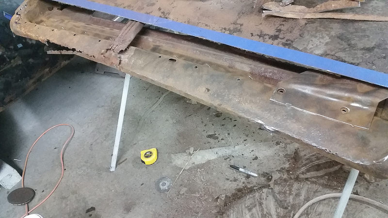

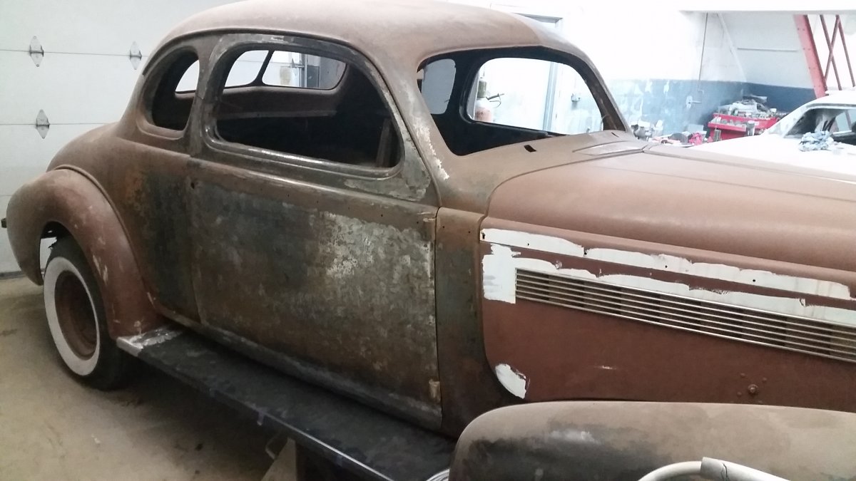

    And cleaned up some of the heavy crust and paint to make it easir to reference mark for making the new panel

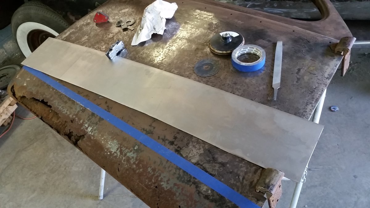

    45" x 6.5" piece cut for the new piece, started adding a little shape but didnt get far today.

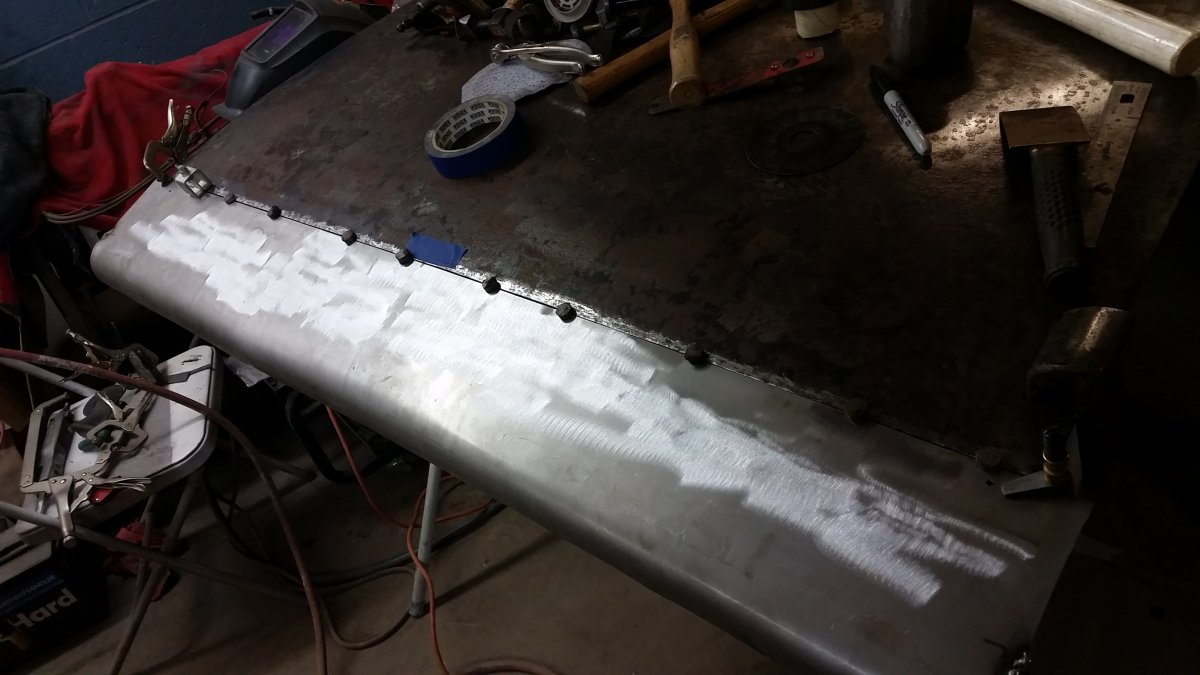

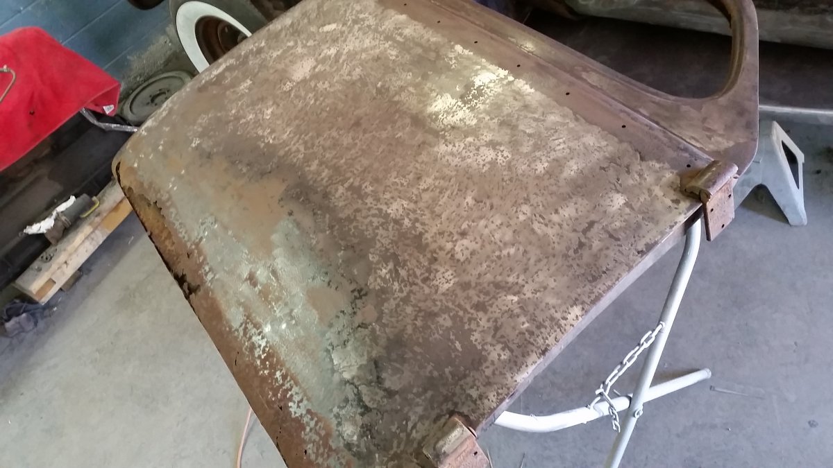

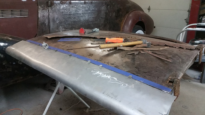

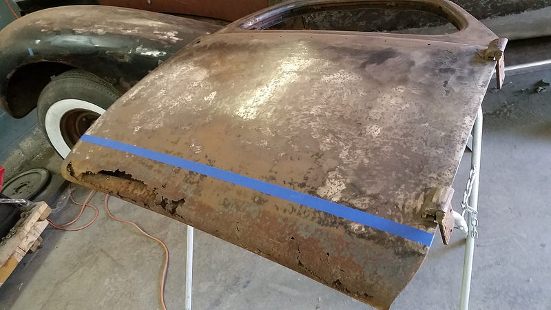

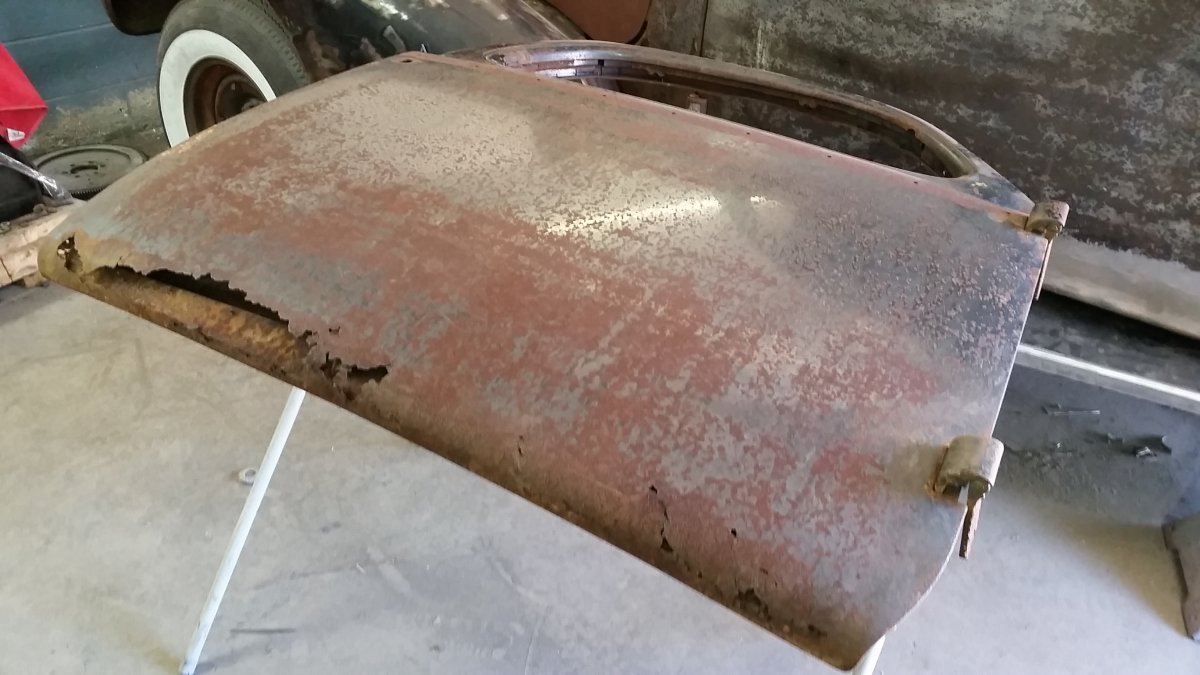

    Baby steps on the door last night, Shades of the Past 2019 in Tennessee is creeping up, so I gotta get my *** in gear if I want to drive this thing 1000 miles each way. After the doors are done, I can start on fixing the floor areas and start body work

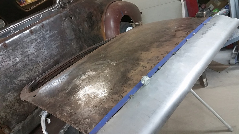

    Starting to add some shape to it, I cut it longer than I needed as the sides will get trimmed but also folded over and crimped to the door structure as they are from the factory, so there is some unshaped edge that gives off a bad profile, but that is just the last inch or so on either side.
    the outer skin of the door was in worse shape on the p***enger side than the driver's side, but the inner sill structure was in much better shape on the p***enger side. I'm going to just try and repair the offending areas rather than make a whole new piece like I did on the driver side. even with having to repair it, it will still be a lot less work and a lot less risk of it losing some shape or having a fitment issue with the body.
    Pretty happy with the shape of the new panel, a little m***aging here and there but not a million miles off

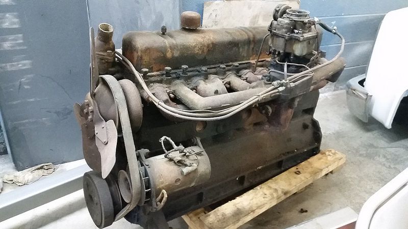

    Thanks! im glad I went with the straight 8 rather than throwing a nailhead and a Muncie in like I was tempted to at first. Trying to keep an eye on Stromberg 97's for sale that have been/ can be rebuilt, although I did procrastinate a few hrs the other night and missed out on 3 basically new ones here in the cl***ifieds that were going for $450 for the 3 of them, somebody got a great deal! adding an equalizer balance tube between the runners makes sense to me, but I've heard some conflicting ideas behind the pros and cons of it. the few set ups like this that I've seen with individual runners, seemed to have a small tube connecting them.

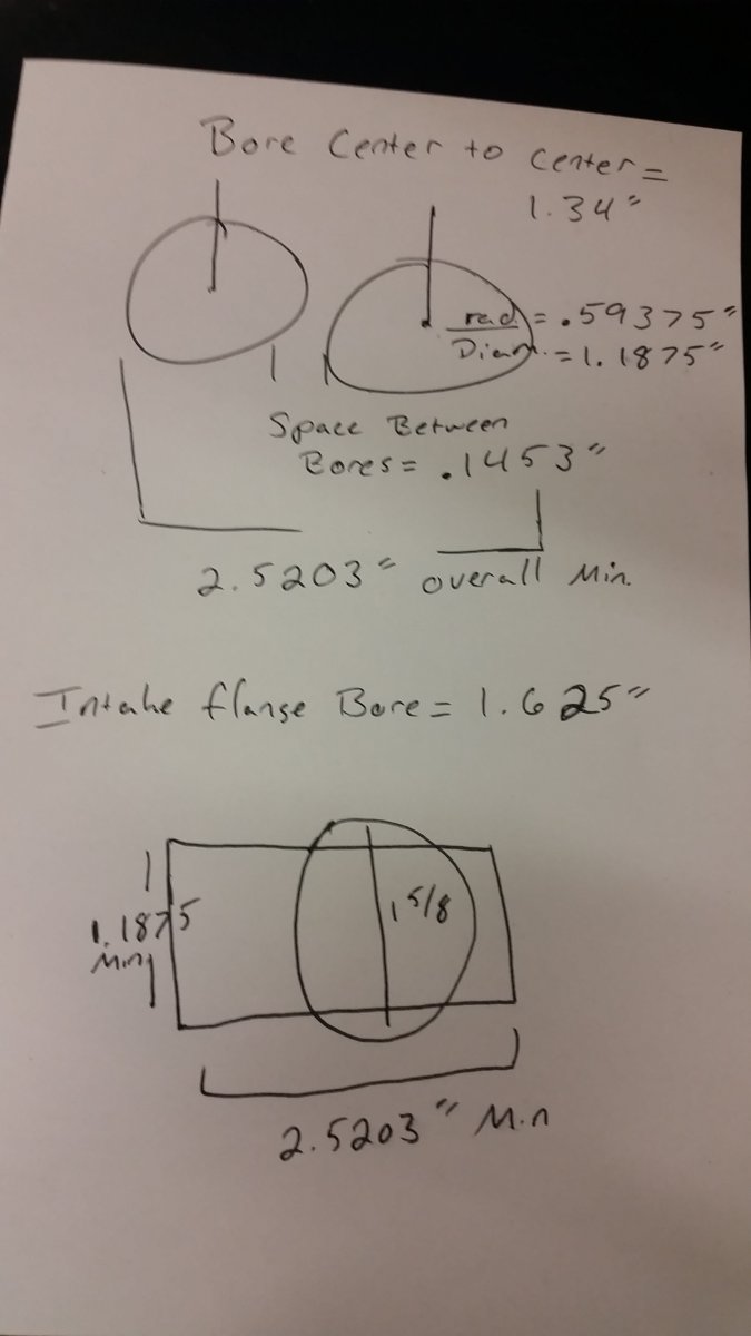

    The thing I'm trying to figure out now is how to get from the 1 5/8 intake bore flange, to the larger rectangular/ oval shape that I need to fit the 2 barrel Stromberg flange , flowing nicely and without having it look too hacked together and cheesy. I have a sort of idea, but I need to bite the bullet and buy some parts to test out the idea, but so far its this, (forgive the chicken scratch maths paper!). Hell's gate hot rods intake flanges for 1 5/8 bore tube, (complete 4 piece intake flange set, $35), and their Stromberg 2 barrel carb flange that they sell ($7 a piece), they also sell the exhaust flange that i'll end up buying , and 1 5/8 mandrel bent 90* 11ga tube from Columbia river mandrel ($14), 1.5"-5" transition cone from a race car parts vendor ($10 a piece), open up the small inlet side to 1 5/8 to fit the mandrel bent intake runner and press/ flatten/ trim back the larger open end to make at minimum the 2.5203" x 1.1875". i'll probably make some sort of little form/ box and maybe a wooden insert for the correct dimension to make pressing it easier, then weld all the pieces together.
    thoughts? better ideas? much easier would just be threading the flange holes and making the flange end of the runner round so it doesn't matter where the bolt holes end up rather than trying to squeeze a rectangular opening onto the flange and welding that together, but im not a big fan of that idea.
    carb flange bore measurements
    the picture from the flange vendor is slightly off center, but there may be small corners that overhang but im not worried about closing those up as they will be minimal.

    A picture of what you're trying to adapt the Stromberg pattern to would help a lot. Your parts list seems a bit big, specific, and expensive without that context.

    Have you consider using two 90* elbows under the carb base with them blended into one outlet....much the same idea as seen on headers when individual runners are tapered into the collector.

    Actually that hadn't even crossed my mind, interesting idea though! Maybe cutouts the entire length of the elbows and weld them together, or separate and at a little bit of an angle so they can be merged into the single 1 5/8 intake flange.

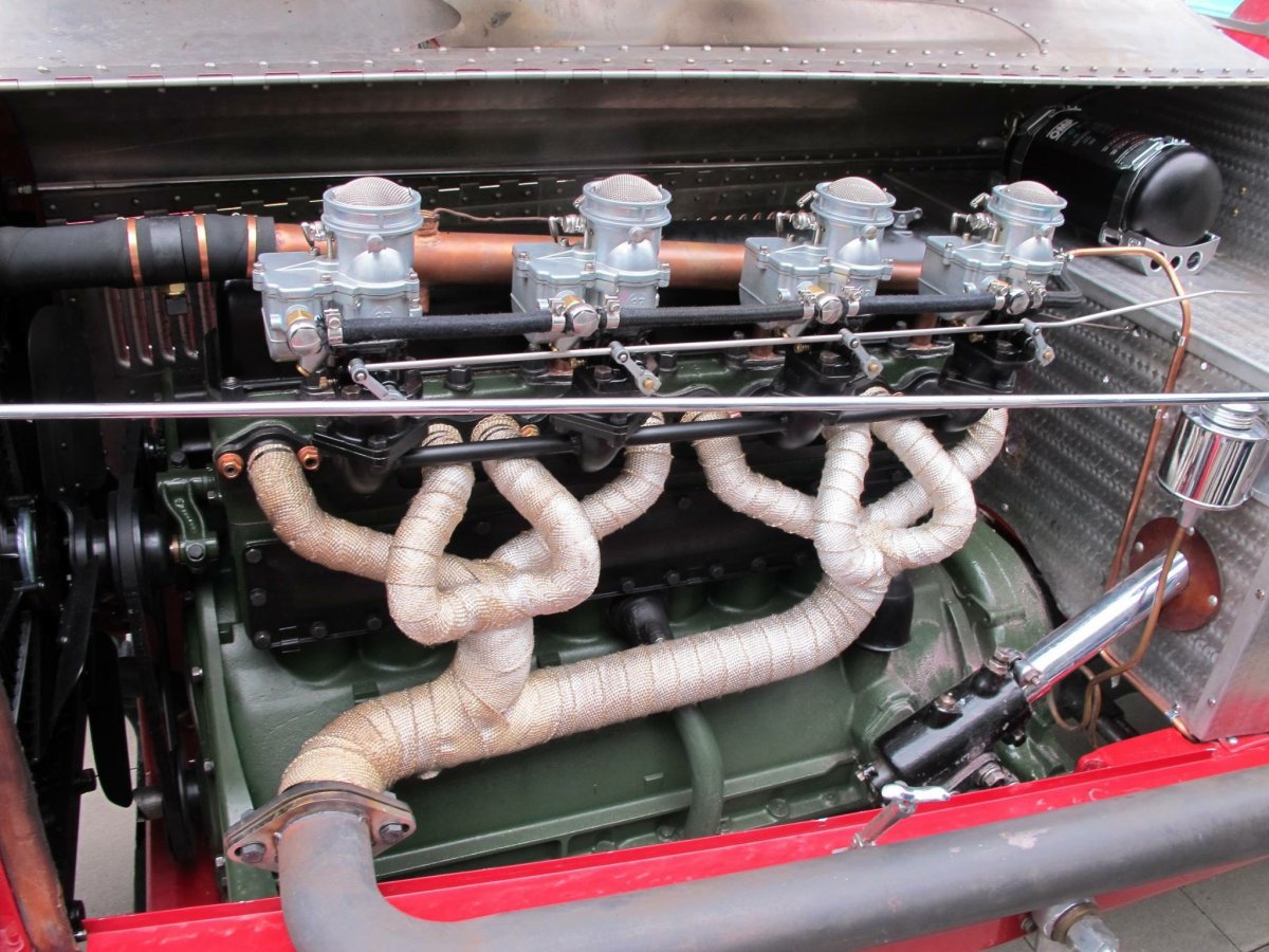

    Will you wrap the exhaust manifold with thermal tape like was shown with the four carb set up?
  14. Stooge
    Joined: Sep 9, 2015
    Posts: 589
    Stooge
    Not sure about that yet, I am planning on making a swept/ log style header, and probably having it powdercoated, as I am the intake runners. Not sure what the tape sort of trapping heat would do to the longevity of the powdercoat, but nothing is definite yet.

    Have you considered building a log intake out of box tubing?
    It would simplify things quite a bit. You just drill the rectangular tubing to take however many carbs you want wherever you want them and run tubes out the side to the ports.

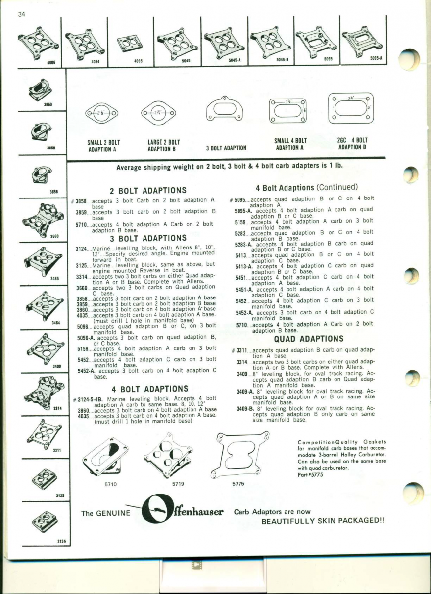

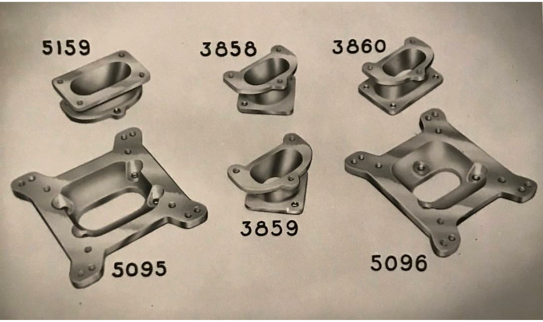

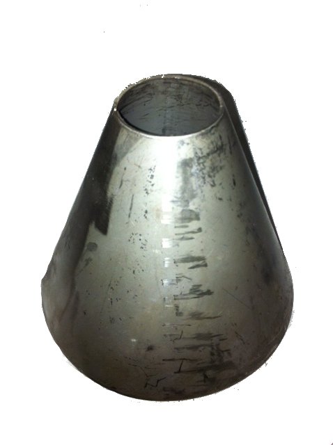

    Well, I think they make adapters for St4romberg to 1bbl that might be the ticket to making a rig like you have pictured with much easier fab work than you're heading for with the cones. The one in the picture has the strombergs sitting on what looks like 4 bolt 1bbl adapters from what I can tell. The Trans Dapt 2025 appears to be the place to start. Also look for Offenhauser 3858 and 3859 adapters, as well as the Thickstun Carburetor Adapter which might be correct.
    Also, can you step uo to 1.75" tube and grind a smooth transition into the head?
    Stooge likes this.

    Geeze, Im an idiot! that had never even crossed my mind and I had actually looked up a carb adapter for someone else a week or 2 ago! the Offenhauser 3858 or 3859 look to be the ticket! that's going to be a hell of a lot easier and cleaner than trying to mickey mouse something together with flattening out a cone piece. Hard to decipher the old offenhauser catalog, but looks to be the the 3858 is for a 2 3/8 bolt spacing and the 3859 is for a 2 15/16 spacing, although i am not sure of the bore size.
    I don't see why I wouldn't be able to m***age an 1/8 of an inch out of the intake ports in the head/ intake flange if need be as I am pulled the heads off anyways to fit a 1.75" tube . I haven't taken calipers to them yet, and i might be thinking of just the exhaust ports, but there were alignment sleeves in the head in place of a gasket that i may be able to just pull out and gain the 1/8 there.
    thanks again!
    patmanta likes this.

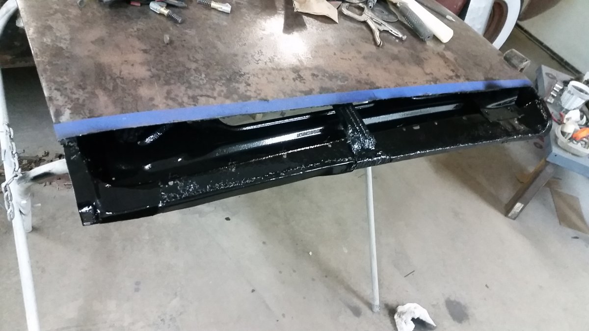

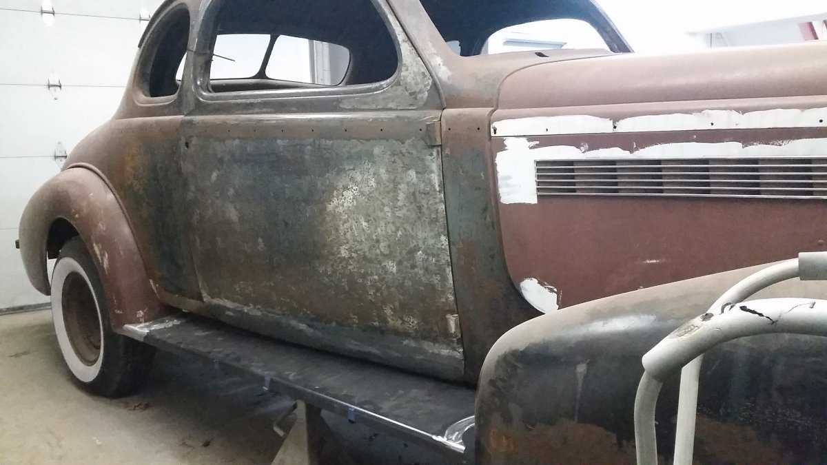

    About as much as i can get done on the doors and running boards until i align the body/get some rubber body mounts in there and find some brackets for the runing board mounts.
    This was cleaed up more after this but i didnt take many pictures. Along with the corner puece, i made a new lip piece to replace the rotted one.
    Rust treated and a quick spray bomb
    Few areas to tidy up, but most of its welded up and the edges are all spot welded, folded and "crimped"

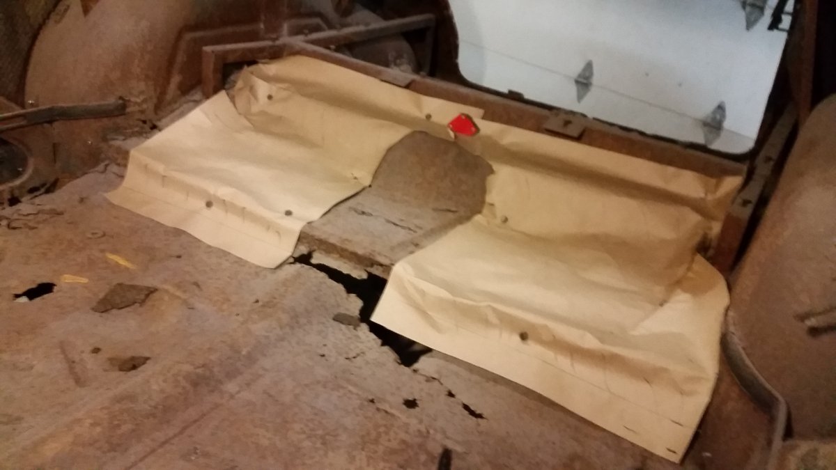

    And atarted planning out the panels to fix the swiss cheese floor sections. Its worse than i was imagining so its going to be more involved aroubd the area where it meets the door sills but ill figure something out

    Regarding adapting the carbs ... how about starting with tubing the size that you need for the port, split it on the carb end and much of the length, and splay it open to the width you need for the carb. Fill the opening with a pie-shaped piece of metal, so the whole thing transitions from oval under the carb flange to round at the port?

    that was originally one of the ideas I had about trying to adapt right to the Stromberg flange, which eventually led into the idea of putting the cone on the end of the tube and pressing that into the usable shape, as it would have looked a little cleaner and been a little less work than pie cutting the end of a tube. The plan right now is to go with one of the offenhauser carb adapters that go from a 1 barrel port to the 2 barrel Stromberg style opening. there are 2 different sized ones, 3858 and 3859 that should work, I just need to figure out what the bore opening of them are before buying them.

    If I understand your posts properly, you have a size 3 SINGLE BARREL intake ( 1 5/8 round) that you are trying to adapt to a size 1 TWO-BARREL (the Stromberg EE-1 97).
    Just in the for what its worth category, the size 3 single barrel will outperform the size 1 2-barrel with the adapter by quite a bit.
