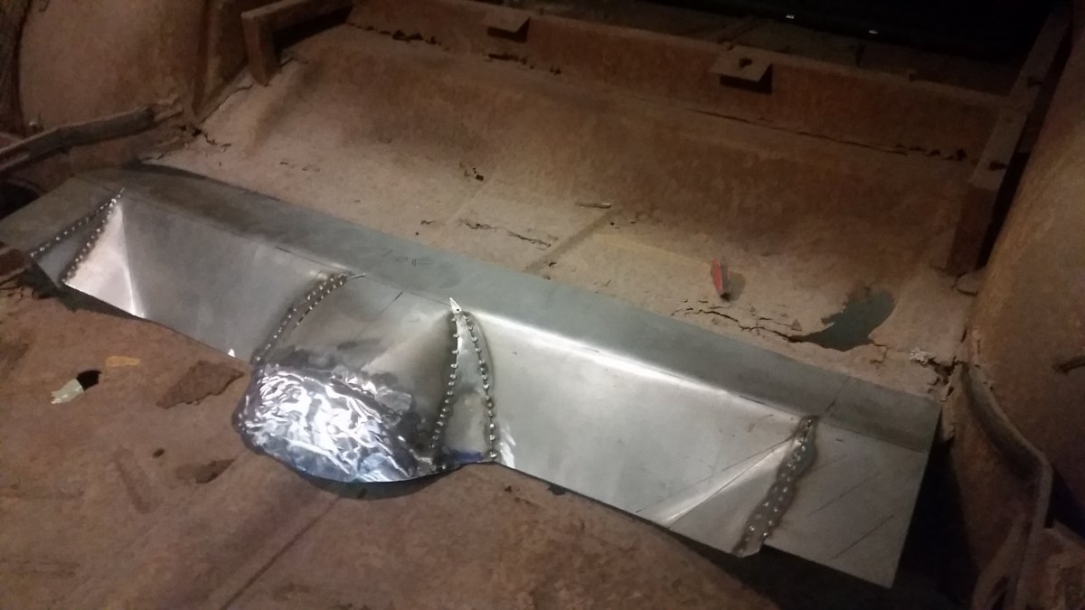

    @carbking Jon, thank you for some of your insight, it is very appreciated and that is a very generous offer to help me make some decisions. I had favored 2 barrel strombergs mostly for the fact that I am more familiar with those over most of the other non 4 barrel carbs, but I do like learning and figuring things out, so I am quite open to ideas. I had been planning on having an interconnection/ tube piece connecting the runners to each other, but had not gotten to the point of determining size of connection. My main points for what I am looking for are reliability, ease of use in regards to drivability as well as tuning, and relative accessibility as far as obtaining matching carbs and parts...and vainly i would like it to look cool :oops: i do have some room to play with under the hood, not a ton, but some as far as how much area the runners can take up. Looks like I have some things to mull over! thanks again, I really do appreciate you taking the time to try and steer me in the right direction as a lot of this arena is new to me.

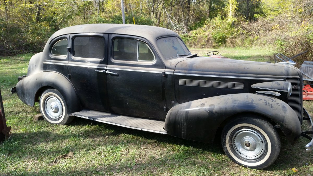

    this obviously isn't mine, but for an idea of space, another '37 century
    And a little of a project I started on last night, along with some not so interesting gto work, I made some very early starting pieces for the floor. I haven't started cutting any of the existing floor out yet, still need to grab some smaller steel tubing to brace the inside of the body, as well as keep the floor as a template to copy a bit.

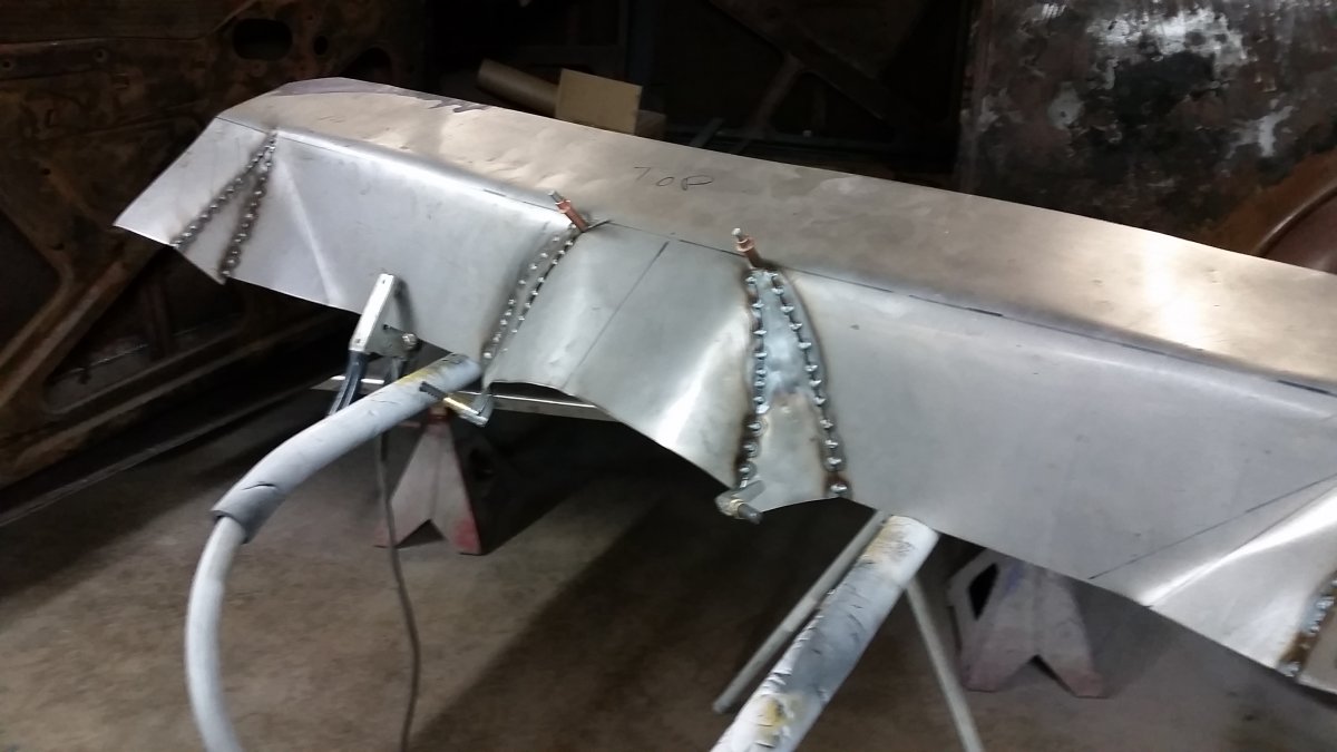

    here is some of the "poor" from slow and poor. I don't have a sheet metal brake, but even if I did, it probably wouldn't be wide enough to fit the 49" area between the wheel tubs for the axle and differential clearance. worked relatively well to bend the 18ga, not ideal, but it worked, although I could have at the least spent a few minutes cleaning and used my longer table
    Not much to look at now, still need to make a handful of filler pieces for around the differential recess and tie in the sides that support the square tubing for the trunk tray/ false floor and connect to the wheel tubs. but its a start.

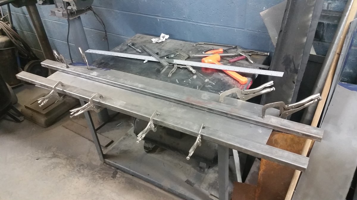

    You can make a brake with a couple good pieces of angle iron and a couple sturdy hinges. I'd like to at some point to do long stuff but the HF 30" brake gets most jobs done and can't be beat for the price. I got mine on sale for like $35 but they're under $50 with a 20% off coupon.
    Stooge likes this.

    I had made a little brake a few years ago to make some brackets for another car, but it was fairly small and the parts for it had long since been cannibalized for other projects. For the simple angle I needed for, this worked enough, wouldn't really want to do it again and it was probably a little harder since the metal was a little thicker, but I got the piece I needed. This could be a good time to buy one of those cheap bead rollers to stiffen up a few of the floor panels and make it look a little more professional, as well as make some flanged edges to fit some of the pieces together better.
    patmanta likes this.

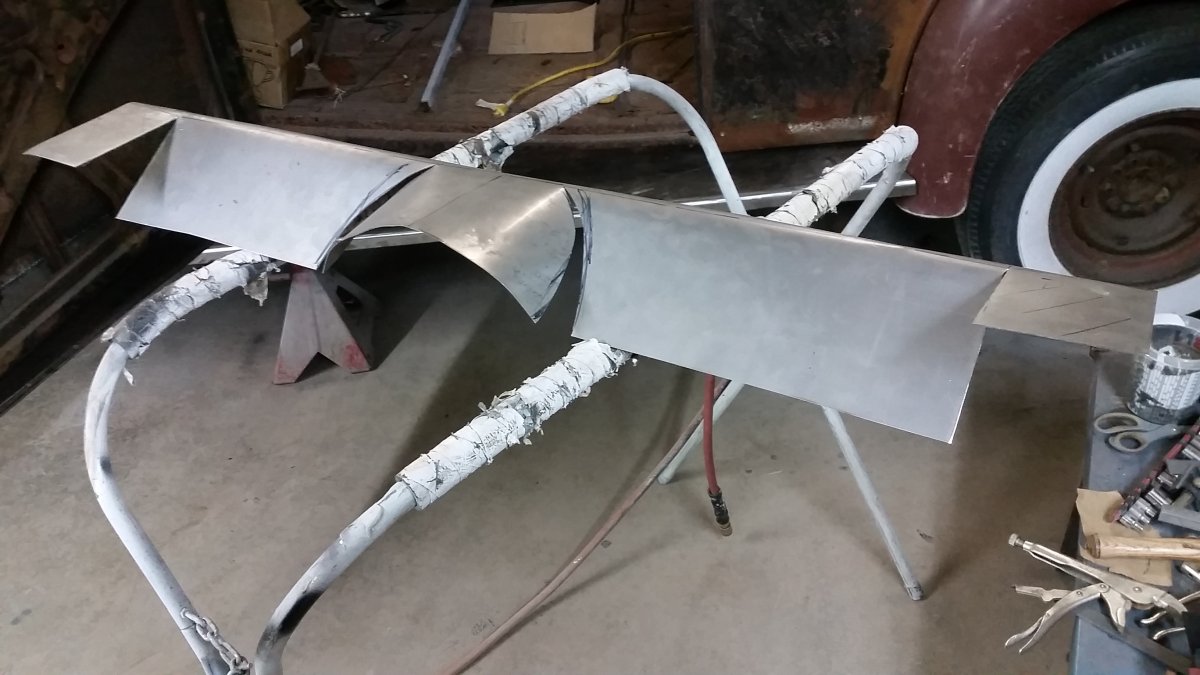

    more has been done to this and the differential recess is flush with the rest of it, except for the sides that follow a different plane where it ****s up against the wheel tubs.

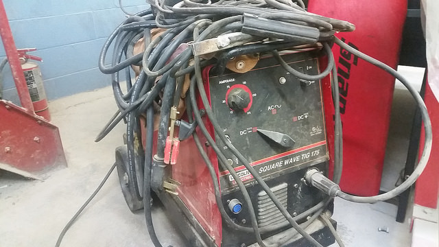

    Also inherited a new to me TIG welder, Lincoln squarewave 175. I had been looking for a TIG machine for awhile but they were a little cost prohibitive for what I do, but free fits the budget pretty well. still need to pick up a tank for it, some consumables and filler rods, but looking forward to playing with it. its been awhile since I've done any tig welding so i'll probably be pretty rusty, but im hoping the muscle memory is still buried in there somewhere!

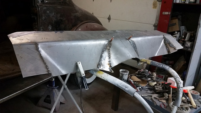

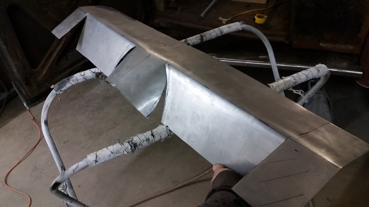

    Semi productive day after getting an off topic truck i have started for the first time this year, i tried to make some progress on the floor of the buick, sort of starting to look like something, sort of.
    20180410_183201.jpg 20180410_184023.jpg 20180410_191455.jpg 20180410_193713.jpg 20180416_193303.jpg 20180421_125631.jpg
    This probably would have been a good job for a step die on a bead roller, but instead i used a chisel tip stretching hammer, a big chunk of aluminum bracket and a bunch of clamps
    20180421_133921.jpg 20180421_150429.jpg 20180421_145813.jpg 20180421_145727.jpg 20180421_145945.jpg
    Maybe not an exact match, but close enough and seems like it shpild be plenty sturdy. Still need to make some filler pieces, trim a few places here and thre, weld it all and clean it up a bit
