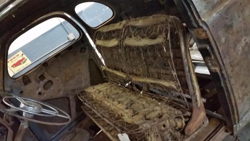

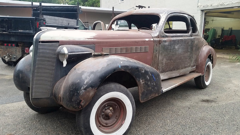

    Things should start picking up a bit, few little stalls between an irritated nerve in my leg from falling down some stairs, summer heat, working on a few other projects for people, and trying to track down some parts that were holding me up. the last big puzzle piece that's been holding up finishing the floor, a split bench seat that fit my price range. I knew I was going to have to have it reupholstered, so I had to figure that into the budget, but I am pretty happy with it. It will stay bare for the time being since its a ways away from being really needed and I would hate to mess up a freshly done seat while im still heavy into metal and body work. Getting this is allowing me to finally ****on up the floor, as I didn't want to finish it, and have to go back over it and change what I had already done.
    out of a late 30's Cadillac Lasalle, fits the car and my budget perfectly, picked it up late last week

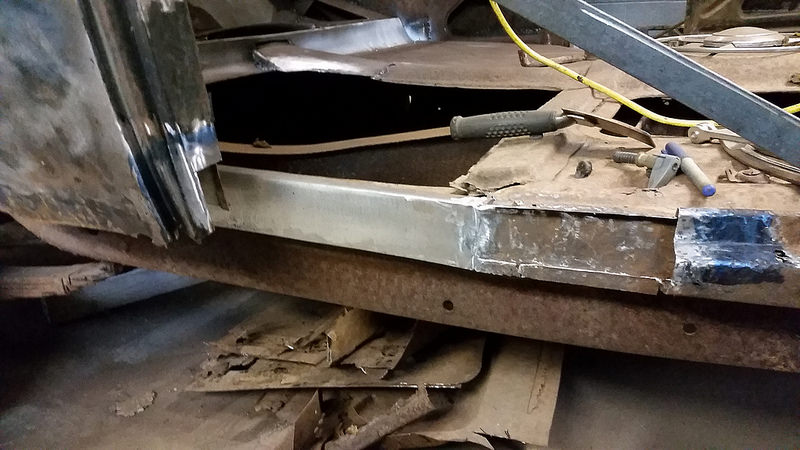

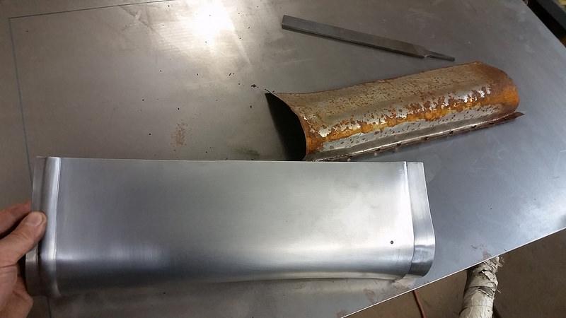

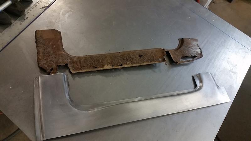

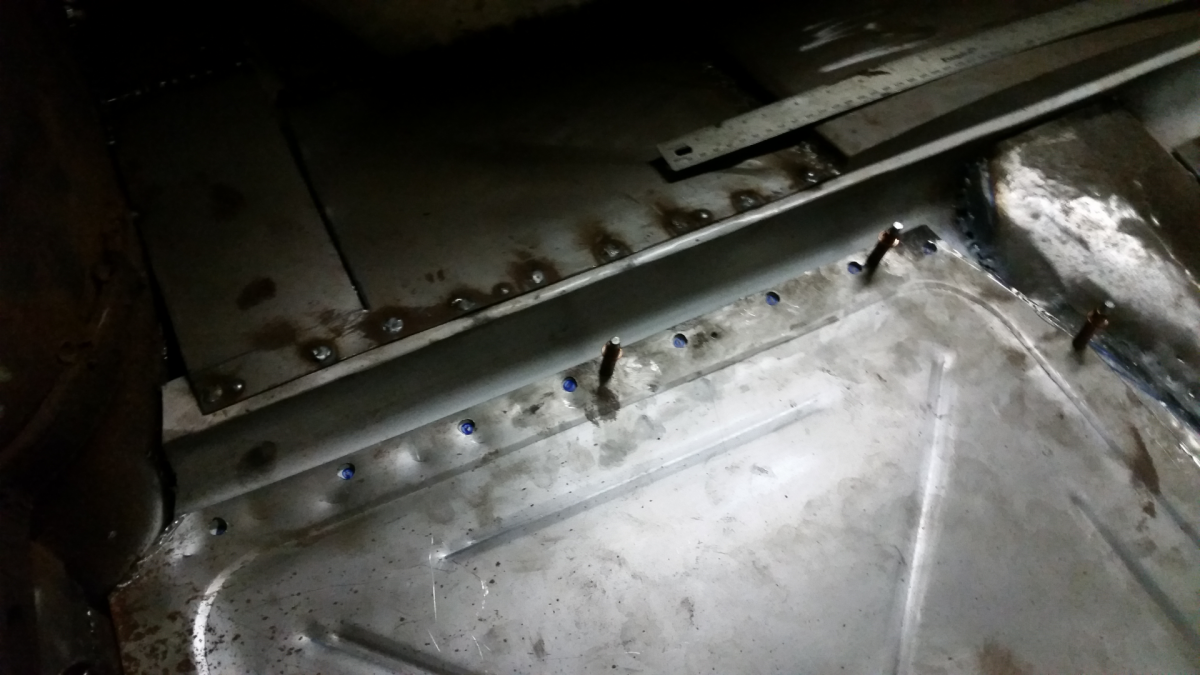

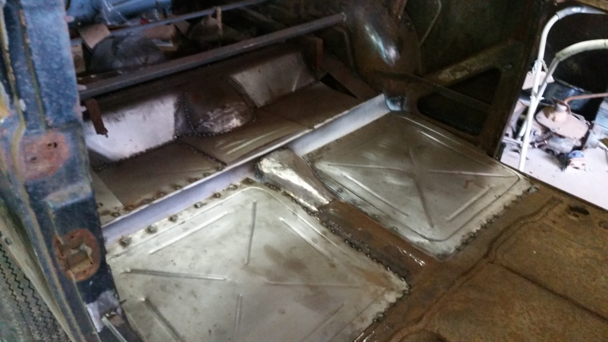

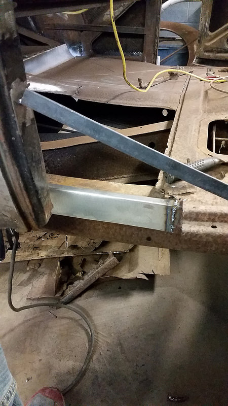

    a few parts to make that I've been putting off. First tacked in the driver side floor pan, rear and inner divider facing edges overlap, and the forward and side facing edges are **** welded. Overlapping edges are primed and painted on the sandwiched edges, drilled holes in the top piece, and the marked off on the lower piece accordingly, kissed with a carbide bit to remove the paint from the lower for a poor man's spot weld.

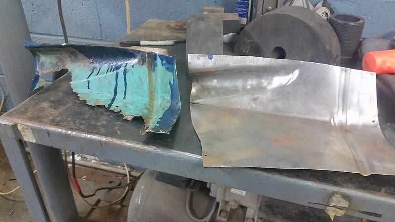

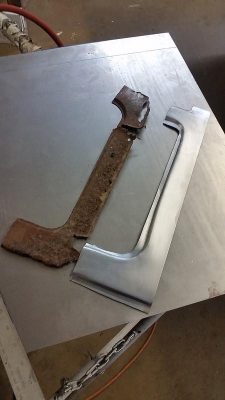

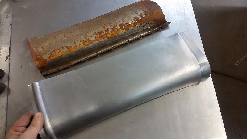

    First was making a new rear outer rocker, same way I did the driver side rocker so I had a better starting idea. Left out the door sill steps on this one and will make them in a separate piece to make it a little neater, lesson learned from making it out of one piece on the driver side. Replaces the panel a previous owner made with a lot of pie cuts to make the body line rib and held in with a dozen self tapping screws. Looked to be made from galvanized.

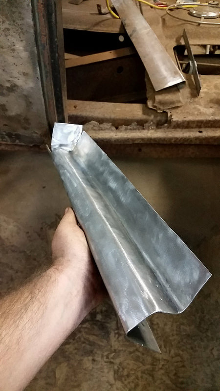

    Next was making a replacement piece of the inner body structure that's affixed to the side of the floor pan. Seems a lot easier to replace this piece and get it and the inner and outer rockers welded in before the floor pan just from an accessibility standpoint. Driver side piece was in good shape and didn't require making a new piece.

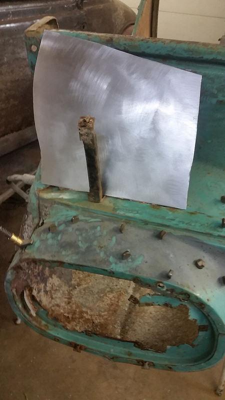

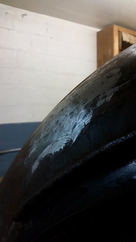

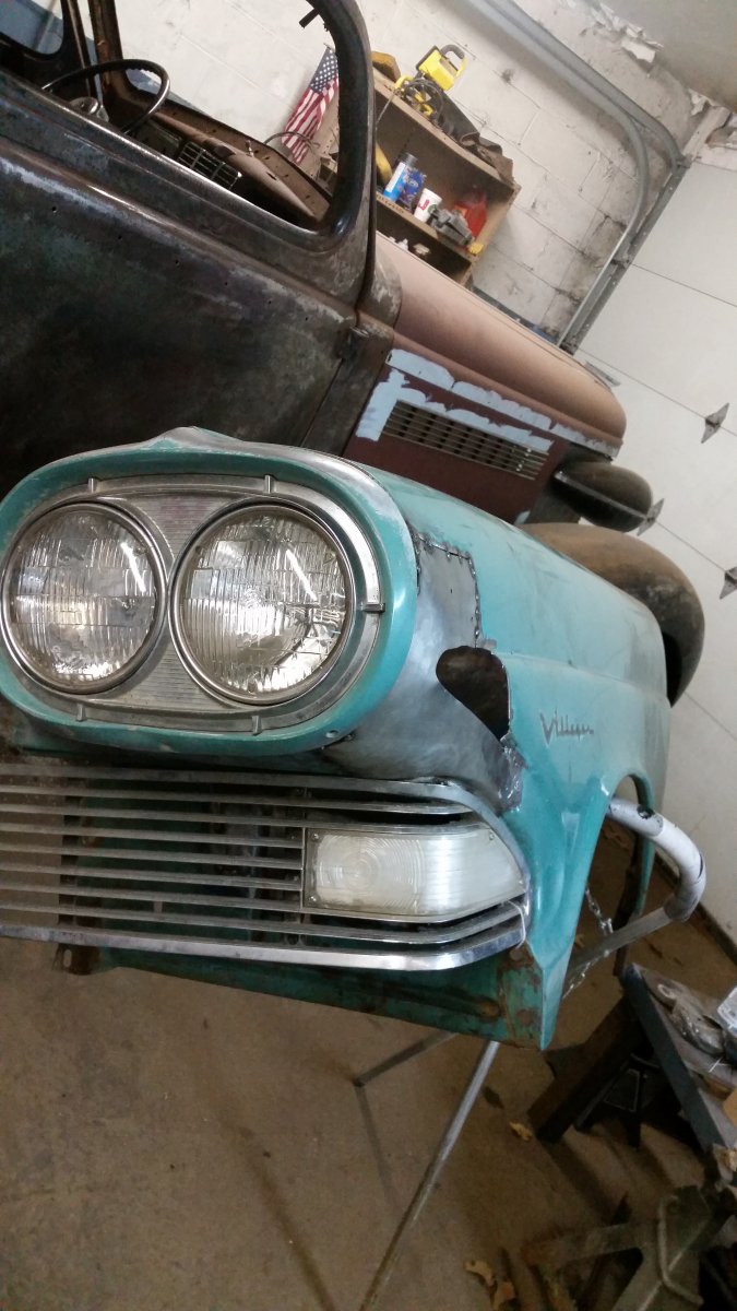

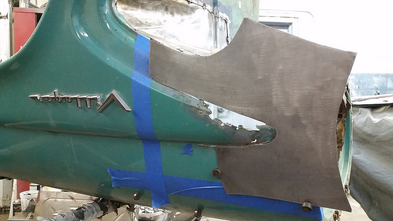

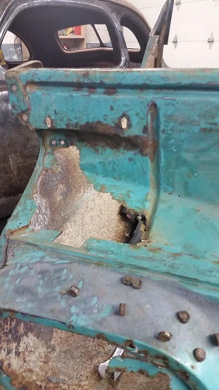

    and so you guys to think im too lazy, a few more of the '58 Edsel fender that im trying to save. this time going at the big hole in the 'cavity' behind the driver side grill insert, (fender is upside down on the stand in these pictures)

    Hnstray

    ^^^^^^Really NICE metal fabrication......two thumbs up!!

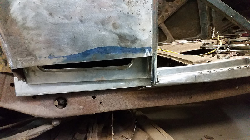

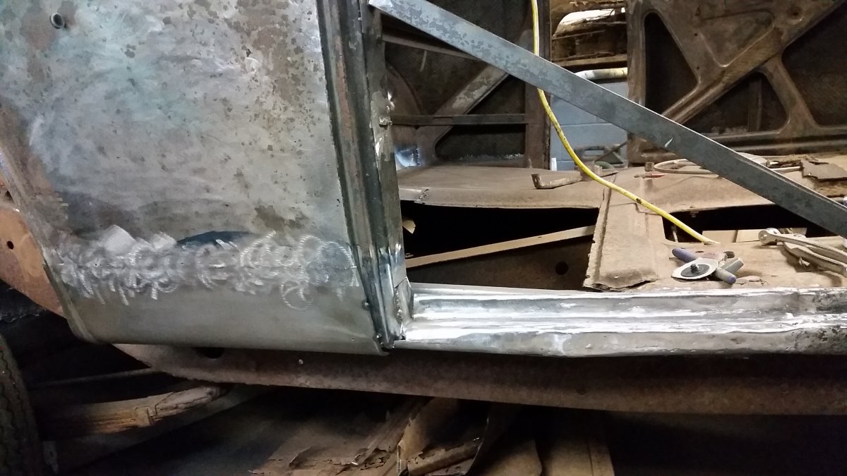

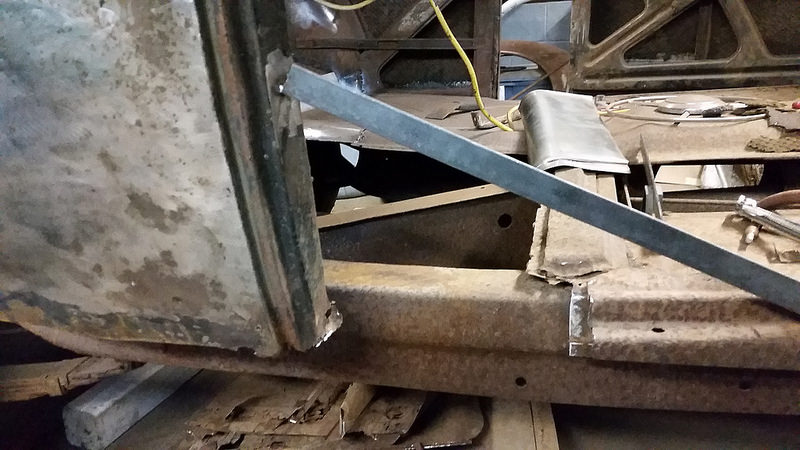

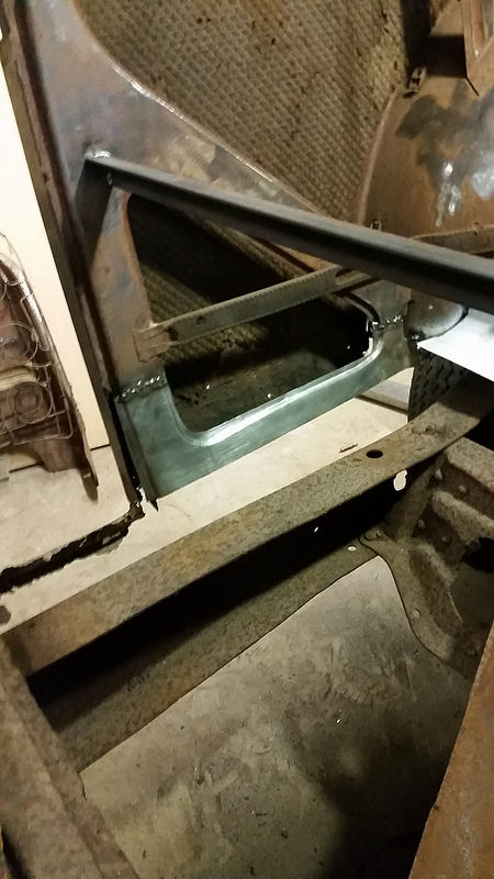

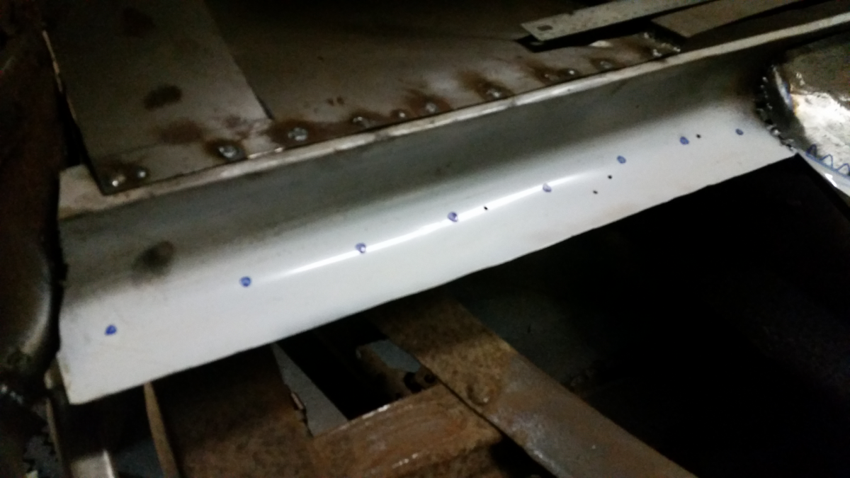

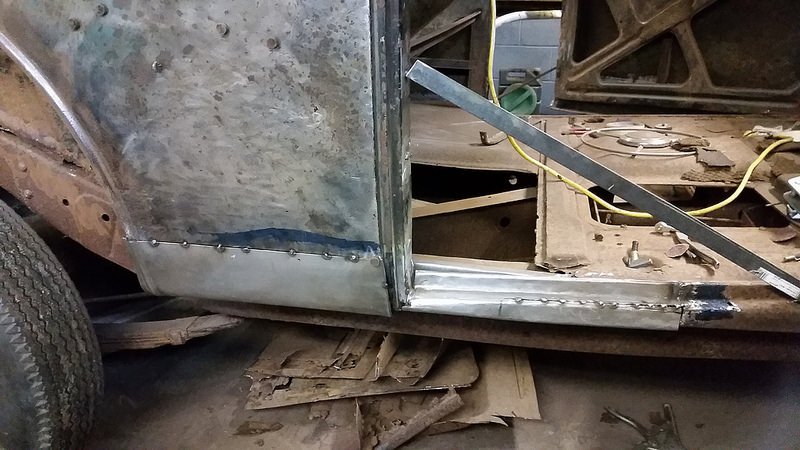

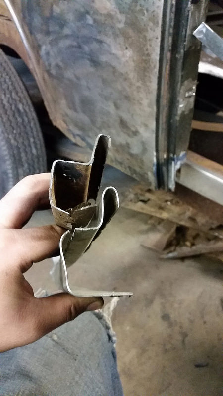

    And started cutting out the p***enger side door sill/ rocker areas. Had to make a handful of pieces, including the inner body structure, the inner rocker rail, a new outer rocker skin, and a new outer door sill piece, and have been busy getting those in and looking right, still have some m***aging to do with the sill, and I ended up pie cutting most of the length of it to make for a better fit, so it looks a little askew but will look right when done, as the sill corner isn't welded in yet, and the bottom of the sill hasn't been welded to the inner rocker so its just sort of hanging there.
    Not the prettiest of welds, just slowly tacked into place, but was cleaned up later
    Start of making the new door sill
    Added the weather stripping channel to the top, not a million miles off, just the front facing edge came out a little bigger than anticipated which later required some cutting and refitting, but not bad for the side of a table and some stuff I've collected over the years to hammer metal over
    First p*** cleaning up the joining edges of the new and old outer rocker, still a few more p***es to clean it up, but that's about where I am with it,

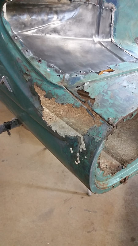

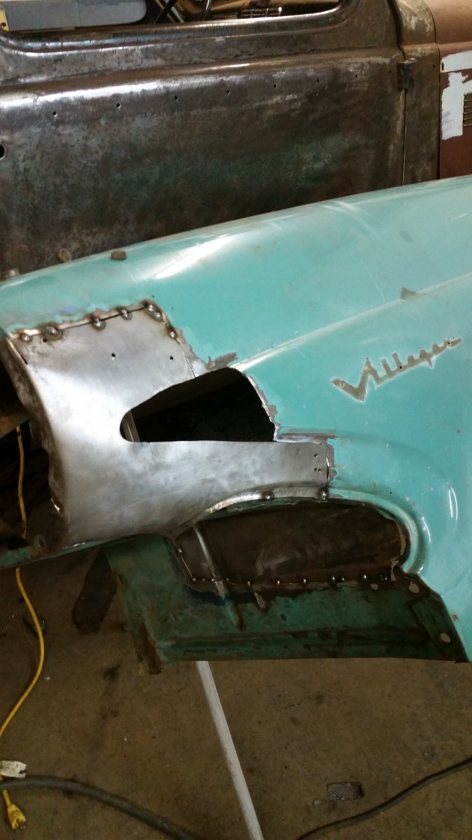

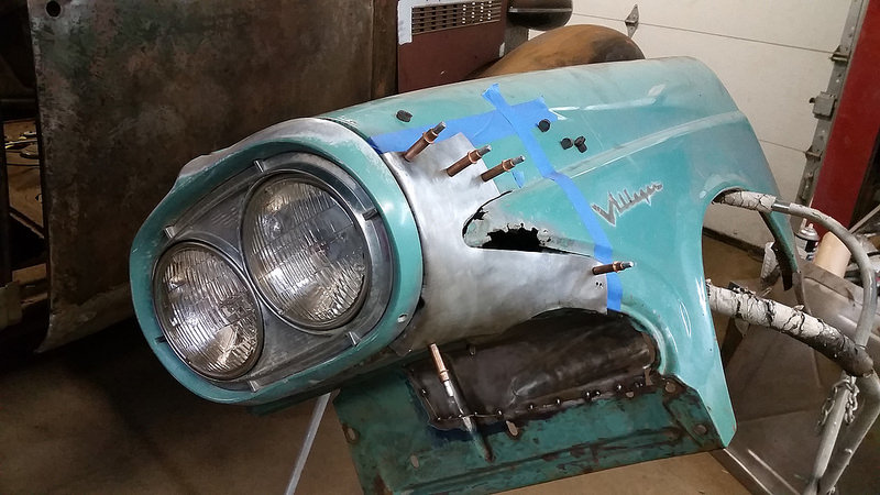

    And a little work on the edsel fender im still working on here and there, but started to fill up the large hole around the headlight bucket. Decided to make the raised body line in a separate piece of material to make it a bit more manageable for myself, but still need to make a wooden hammer form for it
    Don't mind the all over the place cleco clamps, the original metal in this area is pretty soft and I was having a time trying to find spots that they would actually hold. This new piece is further along than what I have pictures of, refined a bit of the shape and added a nice bead/ flange around the edge that goes to the other new piece to mimic the factory shape where the driver side grille seats up against that flange.

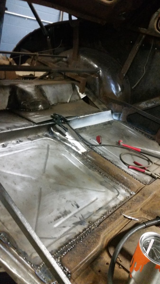

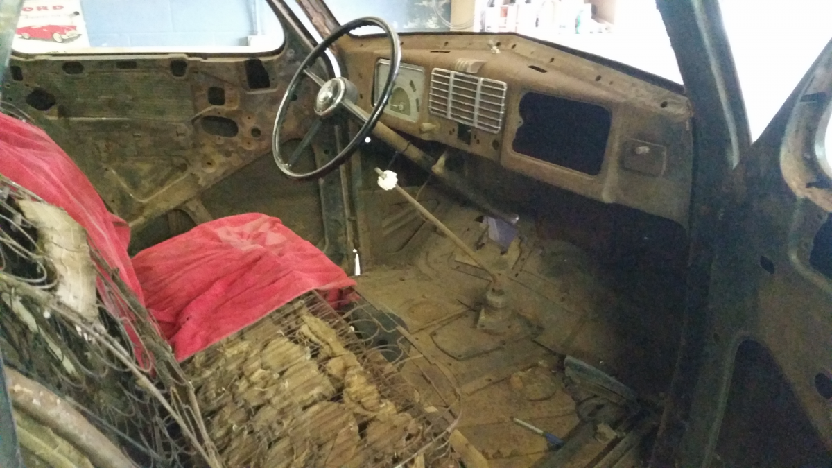

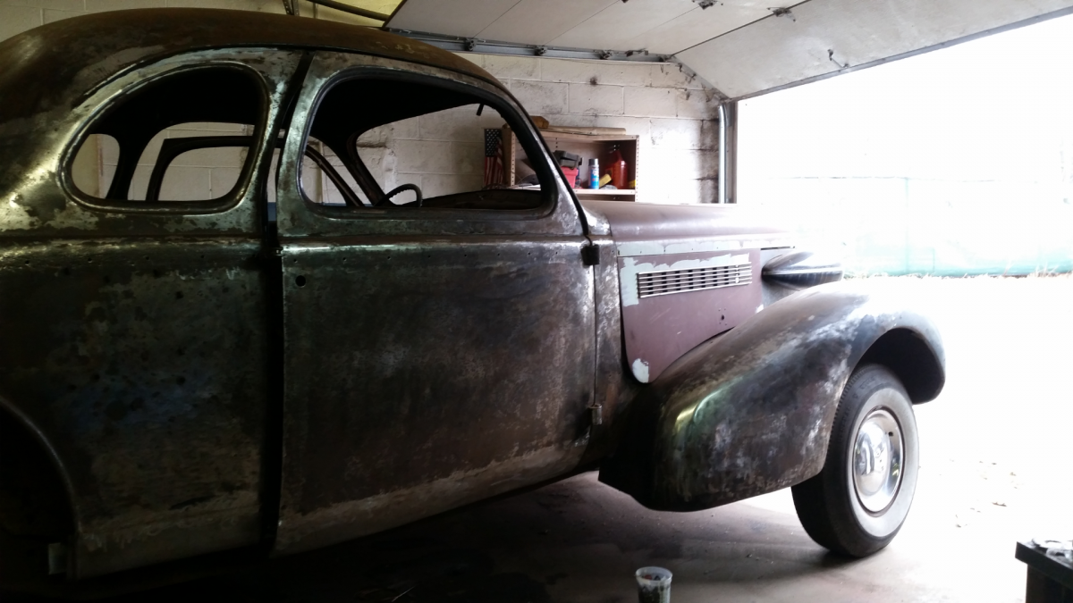

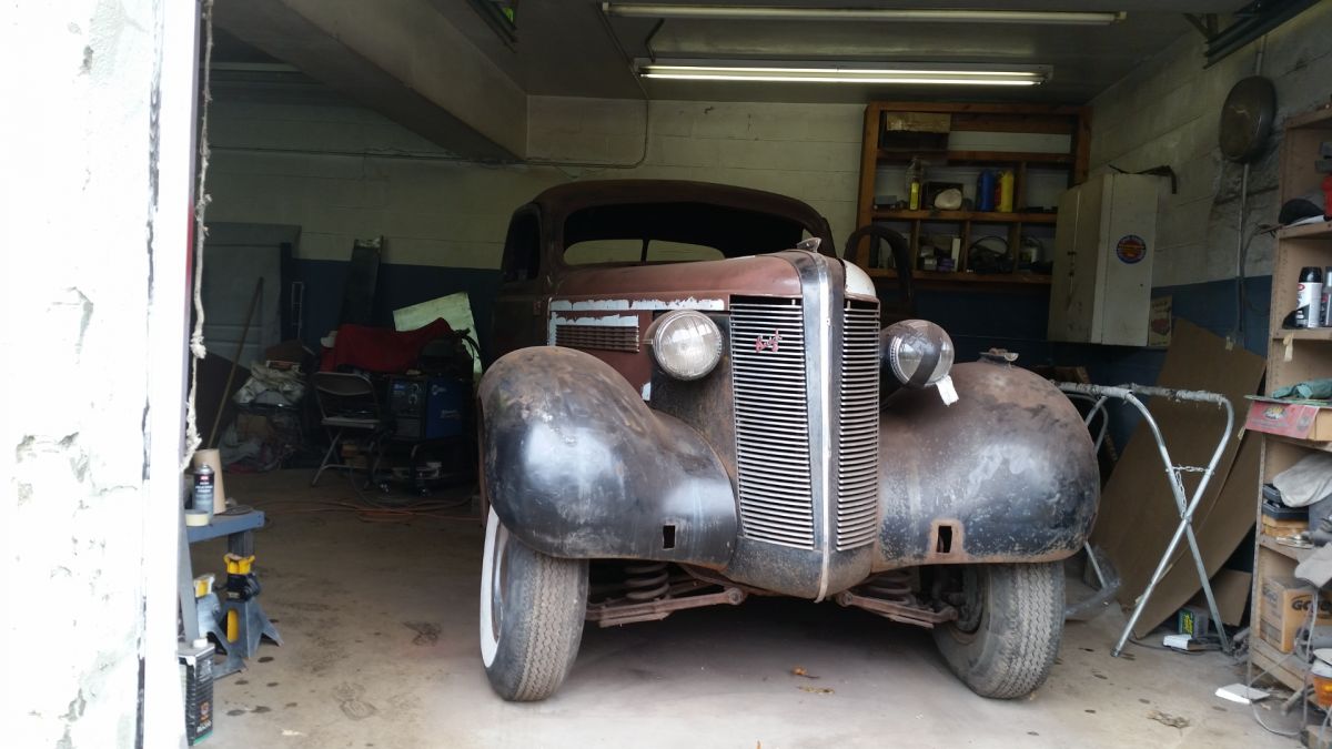

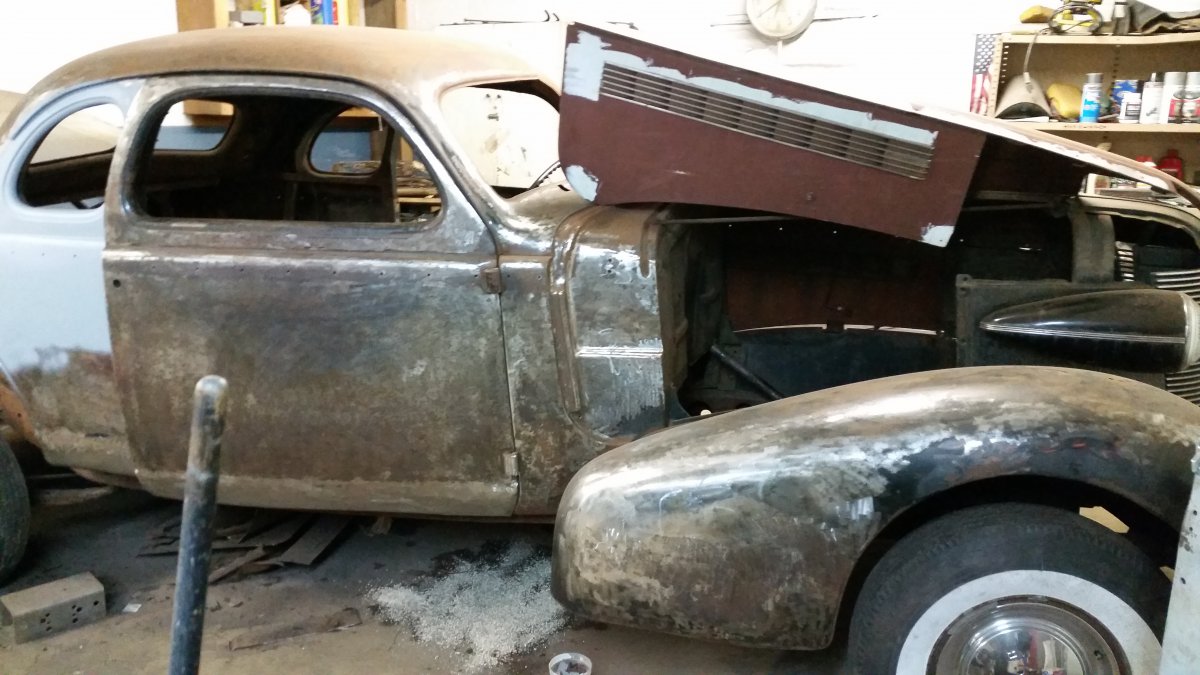

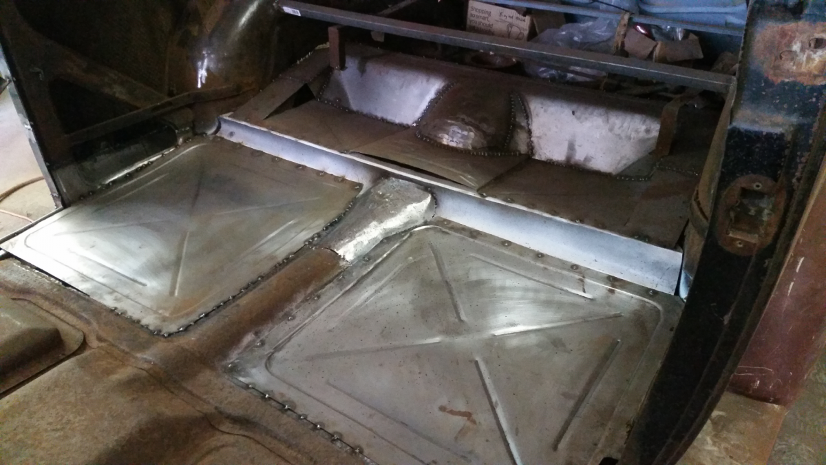

    Well after over a year of ownership, and 8 or 9 months of slowly plugging away at the Buick, I finally got to actually sit in it! It may not sound like a big accomplishment, but it was certainly a nice feeling, and all I had to do was rebuild most of the floors, rebuild the rockers on both sides, rebuild the door sills, rebuild the inner and outer sections of both doors, make some running boards from scratch, find an engine and transmission, find a steering column and steering box, and find some seats. Also had a few of my most used tools break on me the last few weeks, so I was on hold for a bit while I upgraded some tooling.
    First few pictures are of getting the last big piece of the floor in, using a method I affectionately refer to as a poor mans spot weld/ plug weld, but for an area that's fairly obstructed for a spot welder to get in to, it made the most sense to go this route. Both the under lapped piece and the over lapping piece that will be sandwiched, are both painted, (I chose white for ease of marking), cleco clamped in place, and the upper piece is marked off where the plug welds will be . These marks are then drilled, the piece put back into position, and the lower piece is marked off to the accompanying holes, and the upper is removed again. Then I kissed the new marks on the lower with a carbide bit to remove the paint, upper piece is repositioned and clamped, and plug welded. the rest of the perimeter of the new piece is **** welded, but is just tacked in place for the time being until I go back in and finish welding the rest of the floor. Im not a fan of weld-thru primers, they seem to have very bad adhesion and poor conductivity so you get a lot of spatter, which can create a dangerous fire hazard when there is still some insulation in the car body....I've also lit a pair of pants or 2 on fire thanks to weld through primer spatter

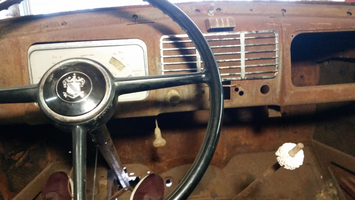

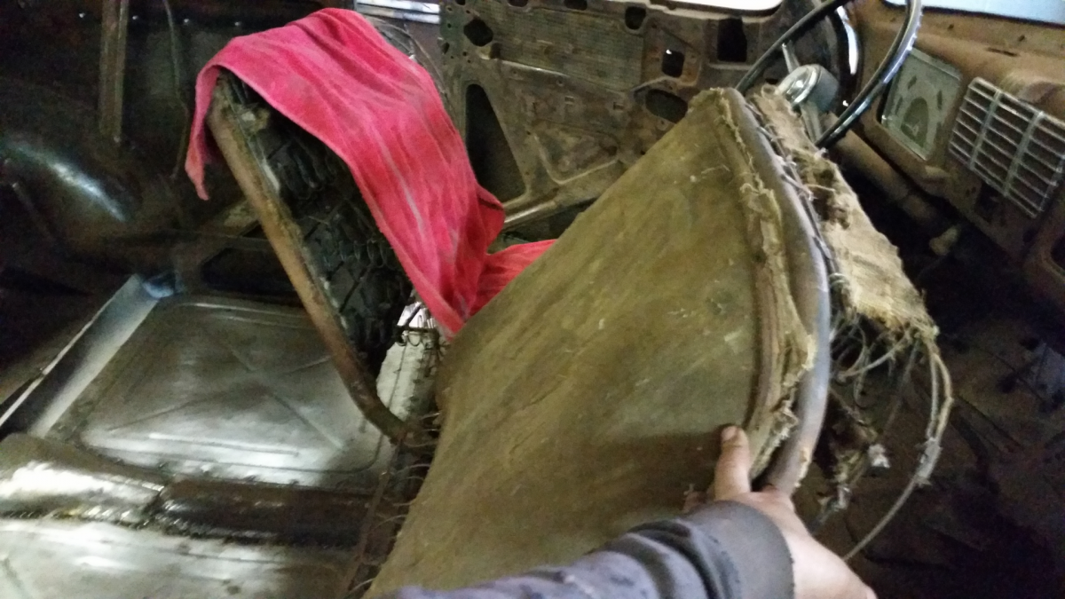

    Also found the "Standard" non-optioned, banjo style Buick steering wheel. it was cheap, saves me the big expense of getting the buick banjo wheel I have getting recast since all of the grip was gone, and fits the "theme" of the car pretty well I think. Exterior of the car will be black, black steel wheels with a small center cap and black wall bias ply tires. interior for the time being will, be just getting the seat covered, and spraying the inside black after getting rid of the surface rust.

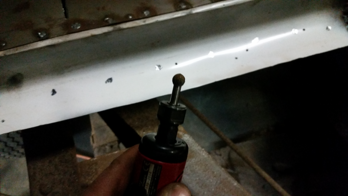

    Miller makes a Spot Welder for their MIG it a small printed circuit board that goes in your welder, and a special nozzle. You don't have to drill any holes , just have properly prepared metal and hold the nozzle down tight and square and pull the trigger. The welder burns thru the first panel and welds the second panel to it. I have used one for years with good results. Frank.
    Stooge and Hnstray like this.

    I took a look on the Miller website, but didn't see it. The company I work for is owned by the same company that owns Miller, (ITW), and I might still have a contact over there to ask about it, though its been a few yrs since I've been to their plant. Fortunately, I don't often have too much of a need to do plug/ spot welds, and it really didn't take too long, just a handful of times taking the big floor pan in and out and making sure everything was lined up.
    Thanks! im glad I went with the big straight 8 too, and I think im a lot happier than I would be if I had went the nailhead/ muncie route, even just from a 'not having to re-engineer everything' route to fit it along with changing the rear end and suspension if I got rid of the torque tube rear. This is supposed to be my easier car after my last off topic 'change every piece of the puzzle' truck. Plus a giant, 4ft long, 900lb engine is just damn cool!

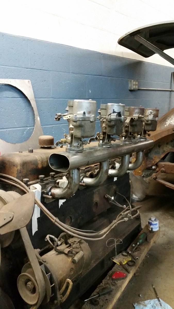

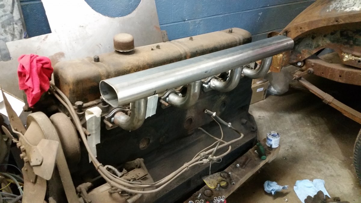

    Still alive, having fun working through a sciatica issue so work's been a little slow but still plugging away. The floor is "done", but still need to finish cleaning up some of the surface rust on the inside of the roof and inner walls before i can just paint the whole inside. Outside has been ground and cleaned up, few little spots to finish up the metal work ruust repairs then i can start on body work.
    Welding on the floor have since been finished, ground down, cleaned up, but still want to put down a seam sealer in the corners

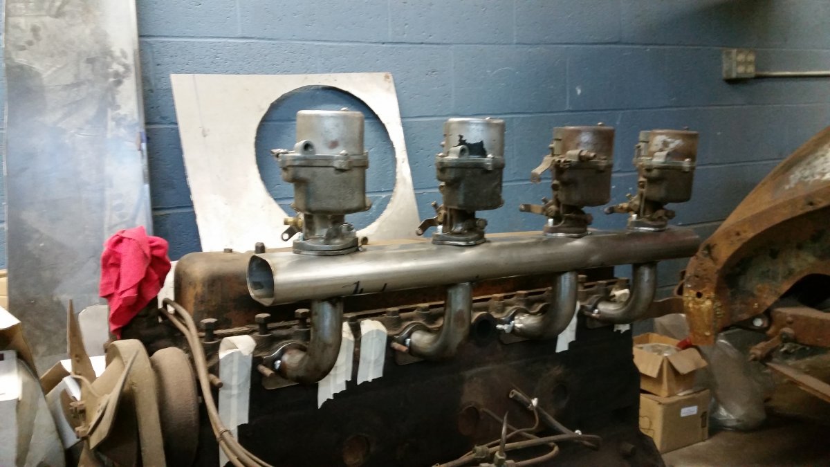

    Also started collecting parts for making up the throttle and choke linkages, and fuel lines and redid how i had the carburetors lined up and added a log style intake with a piece of oval tubing. A little pricy but looks a little better than rectangular tubing or standard round tubing. Mocked it up yesterday and the ends are still open, but should make things a bit easier, plus it just looks cool

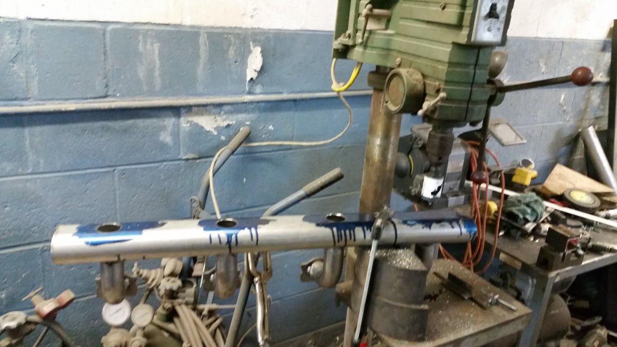

    Cliff Ramsdell
    Great idea on the oval tubing for the intake, that really looks great. Keep on keepin on.
