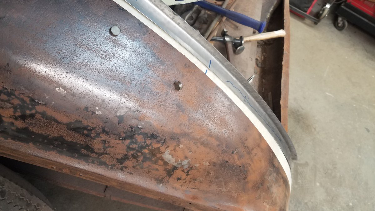

    its not much of an update, but after many hours or cleaning up the bare metal trying to get the pitting, rust, old paint cleaned up, some dents knocked out, fixing some old repairs from a previous owner in the front fender, it got a skim coat of filler in a few spots and a some high build primer on the p***enger side. Good to see it looking a little more whole for the first time, but it was sort of an experiment to see what I could get away with in regards to some of the blemished/ pitted sheet metal. few people suggested just covering it all in filler, but I wasn't too keen on that since I would drive myself crazy with sanding it all down and getting it straight, and for the most part, wasn't really necessary. The U-Pol high build covered most of it, with the exception of a few areas where the body trim was that was a little heavier pitted, but overall, im pretty pleased with it.
    was mostly experimenting and just wanted to do the door and fenders, but did the cowl and door jambs as well. still a lot of body work to do, but atleast I have a better idea of the course to go now. next will be the roof, and rear qtrs. before spinning it around for the driver side, (shop is full right now and space is at a premium so I have to work with that for the time being)
