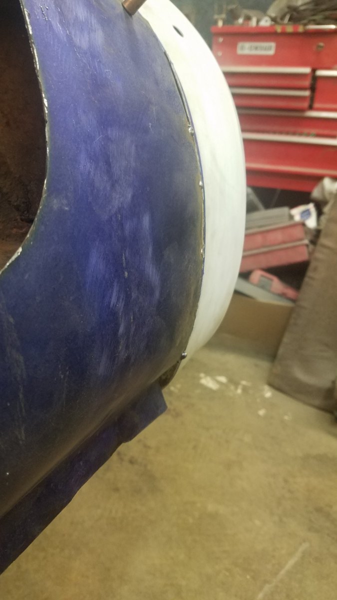

    Now most of the puzzle pieces are made, I still have to make the side 'profile' corners pieces that the fender mounts to and add the weldnuts to them so theres something to actually bolt to, (i'll also be replacing some of the other threaded inserts with new weldnuts as a few of them are rotted away). Also need to add a bit of shape to the big lower lip section where it meets the side channels, not a lot but just to make it line up nice. i'll pull the trunk lid off this week, brace it all up and start cutting out the old this week and hope it will all fit together
    if you see on the left side, my measurements where I started to make the curves were off by an inch :confused: There are some old trunk repairs that ive been humming and hawing over, part of me wants to just go replace everything, but they are mostly clean and well done for the period I suspect they were done in, so I think it would be cool to keep them as a little history of the car.......but mostly im lazy and cutting out the trunk will be another can of worms
    Even had some time to play with the Edsel over the long weekend and start tearing apart the steering and suspension, not many pictures of that since it was pretty grimy and didn't want to keep reaching in my pocket to grab my phone. It wasn't as bad as I was expecting for being off the road since '68, some stuff was stuck pretty good but I remembered to bring home a small 3" cutting wheel to zip some of the bolts off. I need to go through and compare what came with the rebuild kit and what will still need to be bought. Not sure if we will be reusing the springs or getting a new pair, but leaning towards new from Eaton for the price. The 460 big block that's going in and the old E400 that was in there before were roughly the same weight so we don't have to do much figuring out with that, and the shocks reference as being the same for some flavor of tri-five chevy so we should be spoiled for choice of what to use there. Some of his intention is to use the station wagon as a family hauler and as a dog hauler for his dog walking business in the city, so we might do some brake updating and maybe a Scarebird kit while we have it apart for a little piece of mind

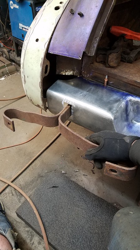

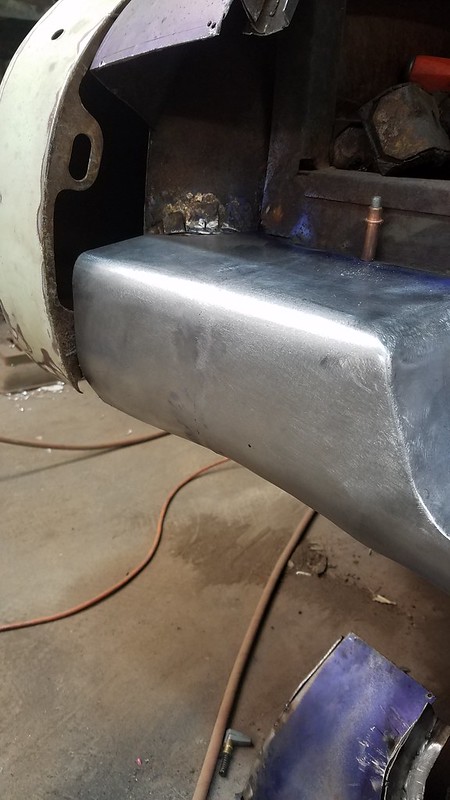

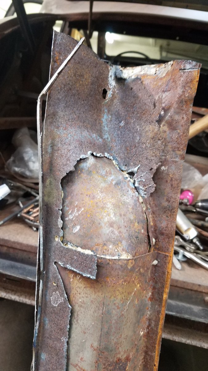

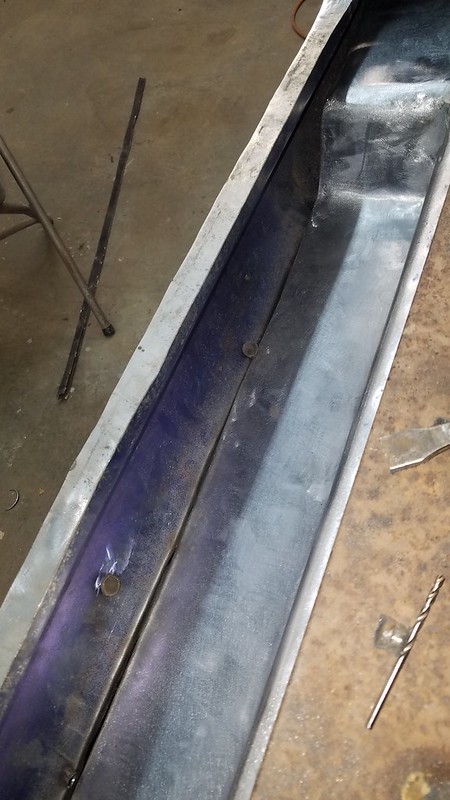

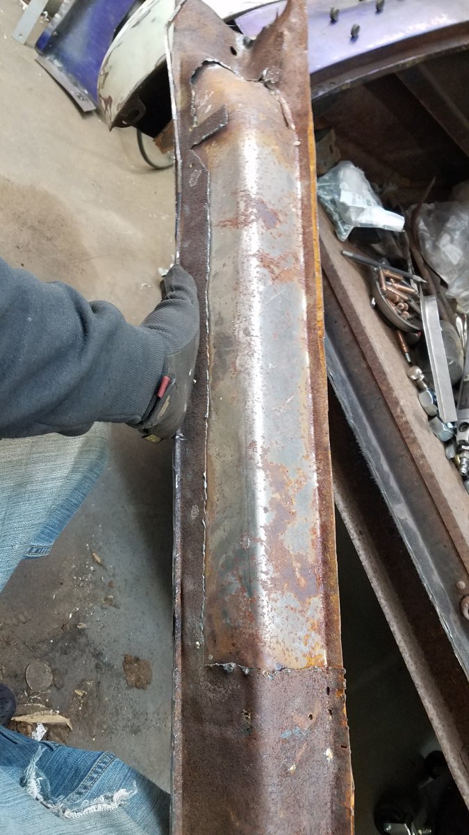

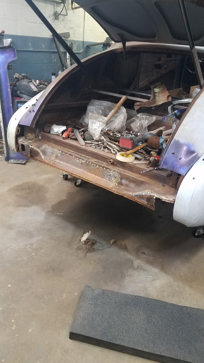

    Looks like I have a bit more work ahead of me than I was expecting in the form of some trunk floor/ corners/ inner structure after a somewhat unexpected fight cutting out the old tail panel. Some real ****ty old repairs stacked on top of old rotted metal and brazed together made for some irritating surprises. I cant complain too much, it served its purpose and atleast gave me an idea and some measurements to go off of to make the new one. Glad to have it cut out though and that I didn't try and chase my tail on cleaning this up
    First making some side profile/ rear fender mount sections with a threaded inserts for the rear most bolts on the fenders to mount to
    tacked onto the edges of the new tail panel, ( the inside lip of the panel wasn't trimmed back yet)
    Started cutting/ started finding surprises
    Old repairs brazed onto old rotted paper thin metal
    i'll start cutting out some more trunk floor this week, bolt the fenders back up and use the new threaded inserts/ plate weld nuts to hold the new panel in place and figure out exact placement and make some new pieces to fill in the new voids.
    hard to see, but I hammered/ rolled the edges of the side profile pieces to make it look a little more finished and not have a hard edge where the sides meet back
    backside of the old tail panel where the old repairs met the original metal.

    Thanks fellas! I knew there was some brazing around the floor where that recessed section in the trunk is, but it looked to be fairly clean so I might have been a little optimistic. When I started making cuts that should have been releasing it and letting it go and I started prying at it a bit more, and I could see into the hidden crevices, it made a bit more sense. I was a little bummed, mostly because I wanted to atleast get something tacked into place over the weekend but no sense in trying to rush it now. really making the pieces for the floor shouldn't be too bad, they don't have to be too aesthetically pleasing since its all just flat areas that are mostly hidden, im just not sure yet how much i'll be cutting out. Im thinking of cutting out just after the recess so I don't have to really deal with the old brazed metal after what a pain it was working around it on the GTO. It will be stored inside, but I'd really like to keep it a driver and take it on some road trips, so maybe i'll try and incorporate some sort of drainage hole to keep water from possibly collecting. @vtwhead I hadn't even really thought about trying to use an aftermarket patch panel, they have been pretty hit or miss, favoring the miss when I have used them before, and figured there was a good chance there would be some aspect of it that would be wrong, and I would be out the money and time rather than just the money. im fine wasting my time, but wasting money always hurts a bit more! ...that and honestly I didn't think it through enough to consider what a big project the tail pan was going to become :rolleyes:

    Decided to just go ahead and cut out the end of the trunk floor rather than **** around trying to patch it here and there, and after seeing it cut out, it was a mess and this will just be easier. I'll probably try and make it a similar shape though im not so sure of the reason for the recess in the middle. Spent some time lining up the fenders, and used the new threaded inserts/ weld nut plates to hold the new pan in place. Lined up pretty well with the fender, but I ended up moving the threaded holes out a little bit to pull the pan in and give me a little more window of adjustment for when theres fillers, primers and paint on there. Then when I was happy with that, slowly started t******* back the opening to get the trunk lid to line up with the opening. theres still a bit of a crown I need to add to the center of the pan to line up with the trunk, and the opening will get trimmed a bit more when the bottom trunk channel is in place. Still a lot of work to do, but nice to see the trunk basically closed with the fenders on and nice new clean metal instead of rotted old junk.

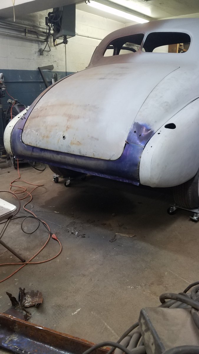

    A bit of a lazy weekend since I have the week off and figured I would be at my shop enough, but got a few steps closer to everything fitting right and started planning out how i'll do the trunk floor/ recess. While im in the trunk, I think im also going to make a battery tray/ box somewhere back here rather than under the p***enger seat and recessed in the floor just to make it more accessible, I just want to track down an old 6v battery to use to figure out a position for it. Probably just on the trunk floor somewhere, maybe flush with the trunk tray that stores the spare tire so it doesn't look too out of place.
    Some more t******* on the opening of the tail panel, a little shape added to match the trunk lid and got the lower channel tacked in place. Lines up pretty good, with some room left for adjustment afterwards. The blue ****m spray and the overhang of the channel makes it look dented in but it will look fine when its trimmed back and sanded.

    Its nice to see it looking like something and to see the trunk lid closing and lining up as it should, and especially nice to think, (outside of a new sill for the driver side door) this is basically the last big project before I can start bodywork I think. I have a pretty good idea what im doing for the end of the trunk floor, and I want to make the cut outs for the bumper brackets have a finished look so im thinking of folding the edges over, either onto the trunk floor section that will **** up against the tail pan, (kind of crimping them together) or just over onto itself on the backside so its not just a straight cut out edge. I think next is to pull the front sheet metal off so I can do the repair rockers that are covered by the front fenders and modify the front engine mount ears to fit the earlier frame. I lucked out and found a couple of the stock mounts with some pretty decrepit rubber in my pile of stuff but atleast i'll have a better idea what im looking for as far as fitment without having to cough up the $100 or so for new re-vulcanized mounts just yet.

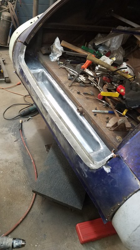

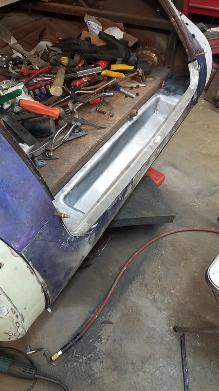

    Spent some time starting the new trunk floor edge section. I wasnt so worried about it matching the stock one exactly, i just didnt want it to look blaringly obvious that it wasnt what is supposed to be there. I had a sort of plan, and im sure there would have been a better way to do it, or if i had a radius brake. Still needs to be trimmed, some side pieces to make it a bit more rigid, and fully welded but its enough to get an idea
    52" long, marked out and a "flap" cut out. Infront of the flap gets folded down, i used a steel rod to bend it as i wanted to keep the transitions and edges curved like as if it was stamped
    Rounded 1 side of the new recessed piece over a T dolly
    Front section rough cut out
    And a few more cuts and tacks and cleaned up a bit. To get the back "flap" section to fit nice and tight, i cleco'd the curved edge of the recessed piece to the back section and cut along the edge with an air saw, tacking the new edges together as i went. When i rolled the edges of the recess piece, it wasnt a uniform straight edge anymore so this just ensured a mated edge.
    Still rough, i need to trim it back to fit around a few areas where it will get welded to the old floor, bumper bracket holes need to be cut, fully welded, etc

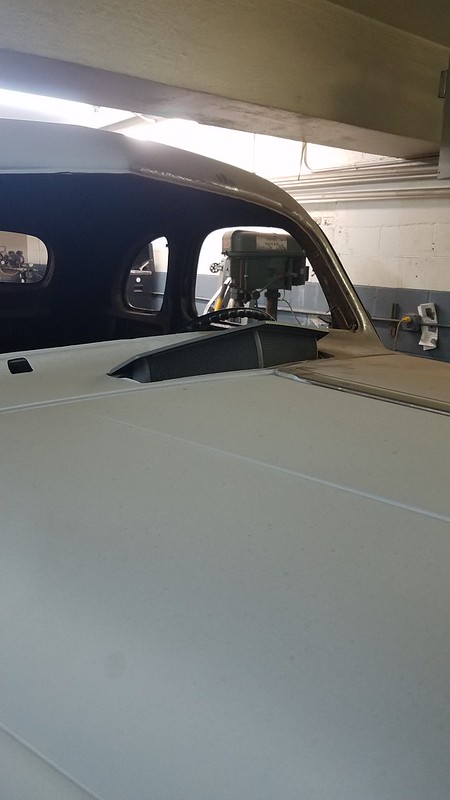

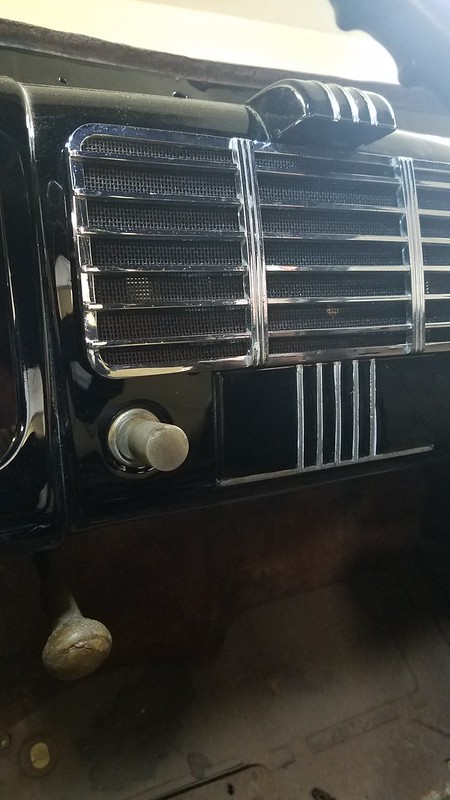

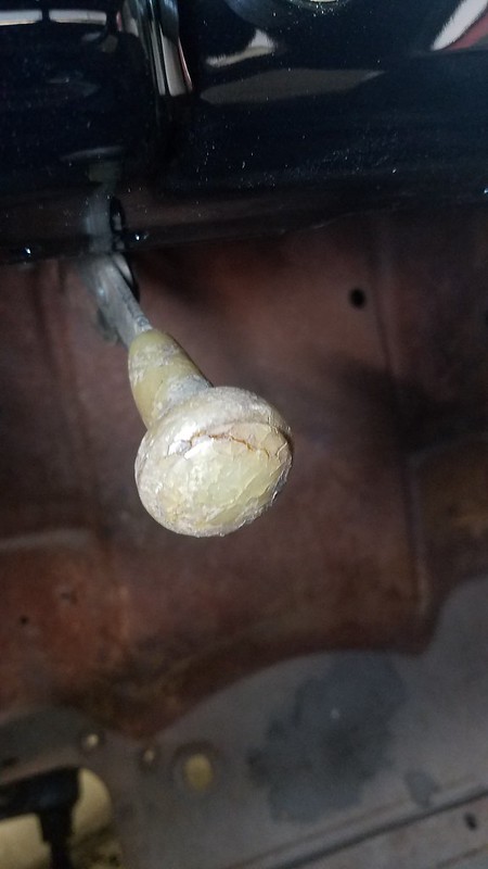

    Also, picked up a cowl vent that i saw pop up, probably not the most pressing thing I needed to buy, but with so much of this car missing, I need to grab stuff when it comes up. i had already had a vent cowl, but in the history of the car being parted out, someone probably offered him $5 for the bracket off of the vent because i was missing the main bracket.
    i did still have the original knob and some of the linkage. Planning on reusing the original dash knobs where i can. The lower under dash knob that controls the vent looks a lot worse in the picture and is actually pretty smooth and not crunchy.

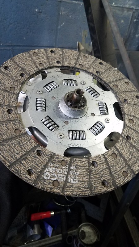

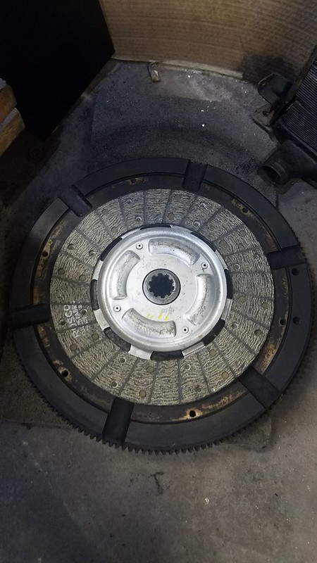

    And im trying to put together a clutch for this thing. i have the rear flywheel for the back of the 320 straight 8, the bellhousing, and transmission and pedals that hang off the side of the transmission. I missed out on a take off one a few weeks ago when it got a little too spendy, but i did manage to find a rebuilt 11" disk to atleast fit the spline and start collecting parts. i can buy the throwout bearing new, but im trying to find an off the shelf pressure plate that will work. Supposedly for the smaller engines, mid '90s jeep stuff works, but not for the bigger ones. So far, fullsize 70's ford stuff and early 80s jeep v8 that used an 11" pressure plate are looking the most promising.

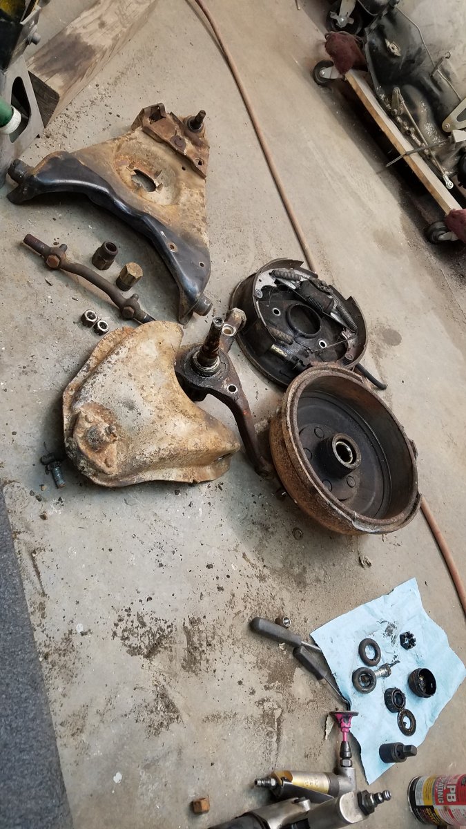

    And while I was working on another car, I also tore apart the front end of the '58 Edsel wagon. Bought the rebuild stuff from Kanter's and with the exception of the sway bar links, it all looks like it should work. I was really expecting something to not be right just because of what the car is and how uncommon they are. We were thinking of going disc up front because its getting a 460 big block ford, but he wants to use the stock wheels, caps and he has new tires on them, but they are only a 14" wheel which wont fit any of the kits in the budget, so just rebuild the drums. The stock drums were pretty crumbly, but most of it wasn't in bad shape for being off the road since 1968

    Check out Bob's Automobilia he has the knobs pretty reasonably priced. https://bobsautomobilia.com/

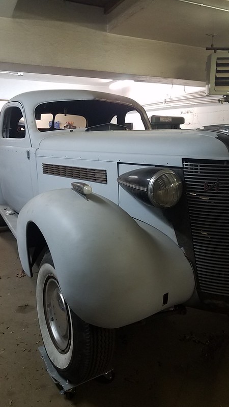

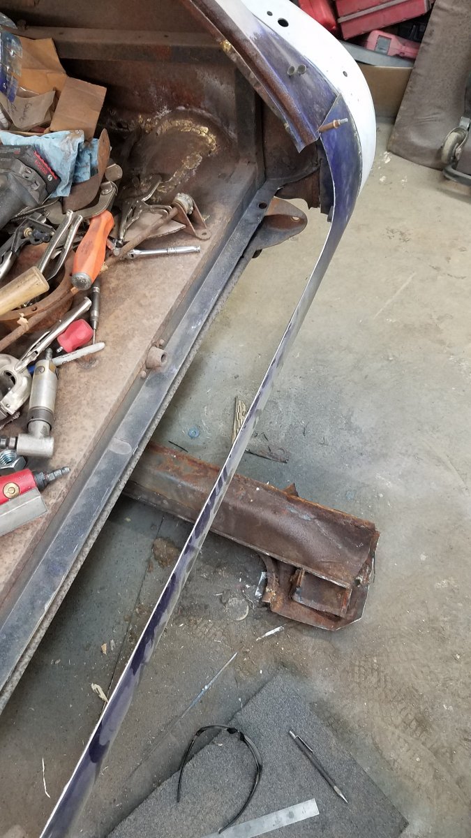

    Finally stopped dragging my feet, made a few little tweaks and got the fitment of the new tail pan where I was happy with it and started burning it in. The outside edges still need to be welded up, but im going to do that as part of some small repairs/ cleanups to the wheel tubs, and I cut out the tacked in lower trunk channel to accommodate the changes so the inner area looks a little messy here, but it will get cleaned up. also started cutting out the old rotten channel and test fitting the new ones I made.
    Nice to have it look a little normal again

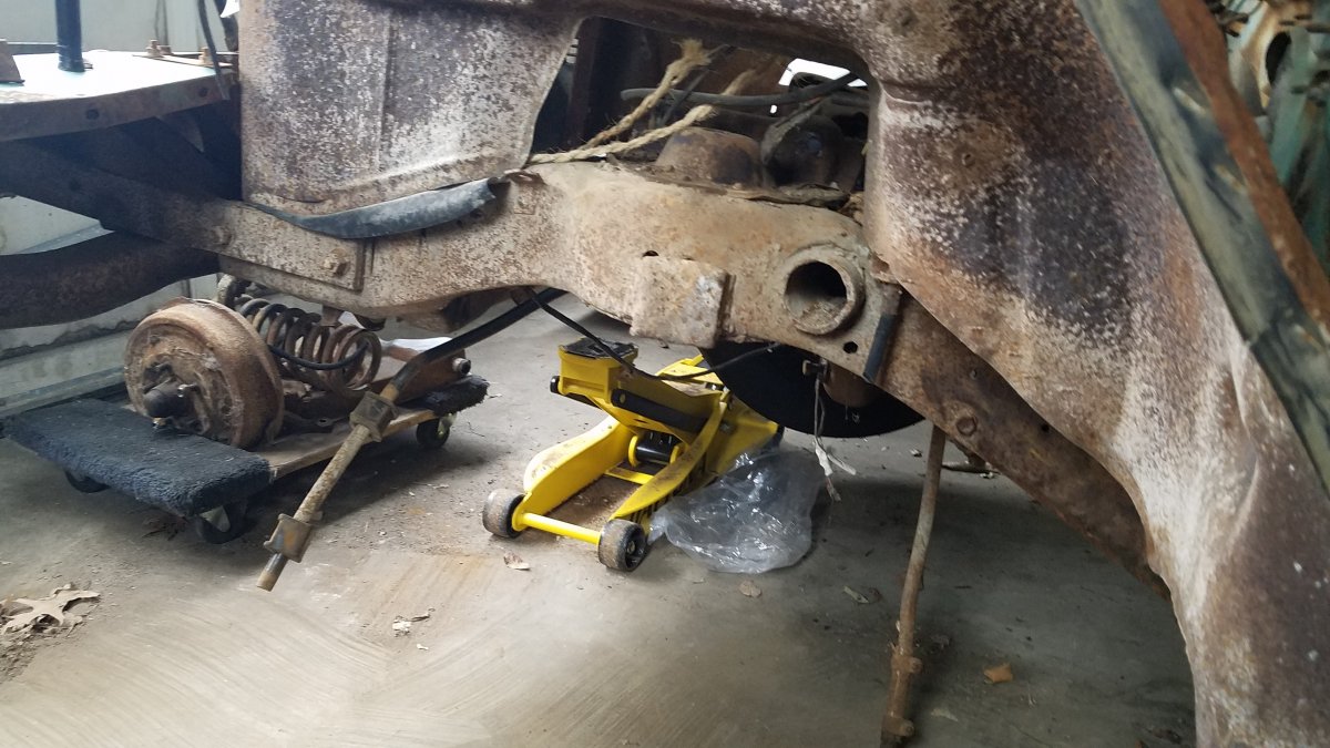

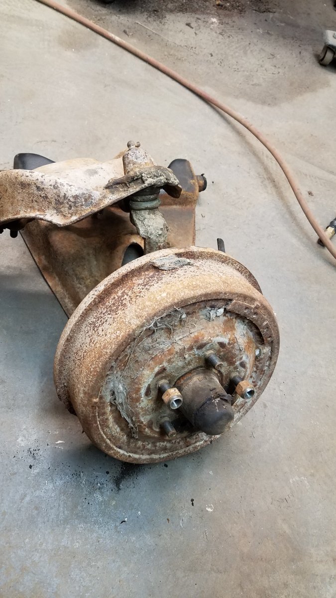

    Since I was pulling the rear fenders off to finish welding up the tail pan, I figured I should probably, finally blow the rest of the body apart Saturday. I have a bit of a plan to have it in paint this summer, though I originally had plans for paint this spring, but I underestimated the trunk project and its just a little easy to get a little lazy in the winter months here
    I already knew that the bottom cowl areas were going to need work, but the fenders were obstructing them and the driver side had a rough patch screwed in place over it, so I couldn't see it much. Driver side is obviously looking a little worse and I'm probably going to make one big piece that includes so of the door sill/ corner, but I think with all of the brazing on the p***enger side, its going to be a bigger pain since the other side was just left alone but covered.
    before I started pulling anything off, I was a little worried about the condition of the frame since it looked pretty crusty and a little rough, and that I would have to have it sandblasted, and have some repairs to it. Hit it with a wire wheel on the crossmember just out of curiosity, looked promising, and spent maybe an hour or so going over it and Im astonished how well and easy its cleaning up, so I think, wire wheel, some air sanders, etc, I should be all right when I pull the body off in the next few weeks and can get to the rest of the frame.
    Also have to say that im pretty impressed/ more surprises how good of condition the inner areas of the front sheet metal is

    - clutch fork, I think I've found an off the shelf pressure plate im going to test out, but I haven't run across the bent fork with a through hole for the pedal side, but theres a good chance I'll just modify one
