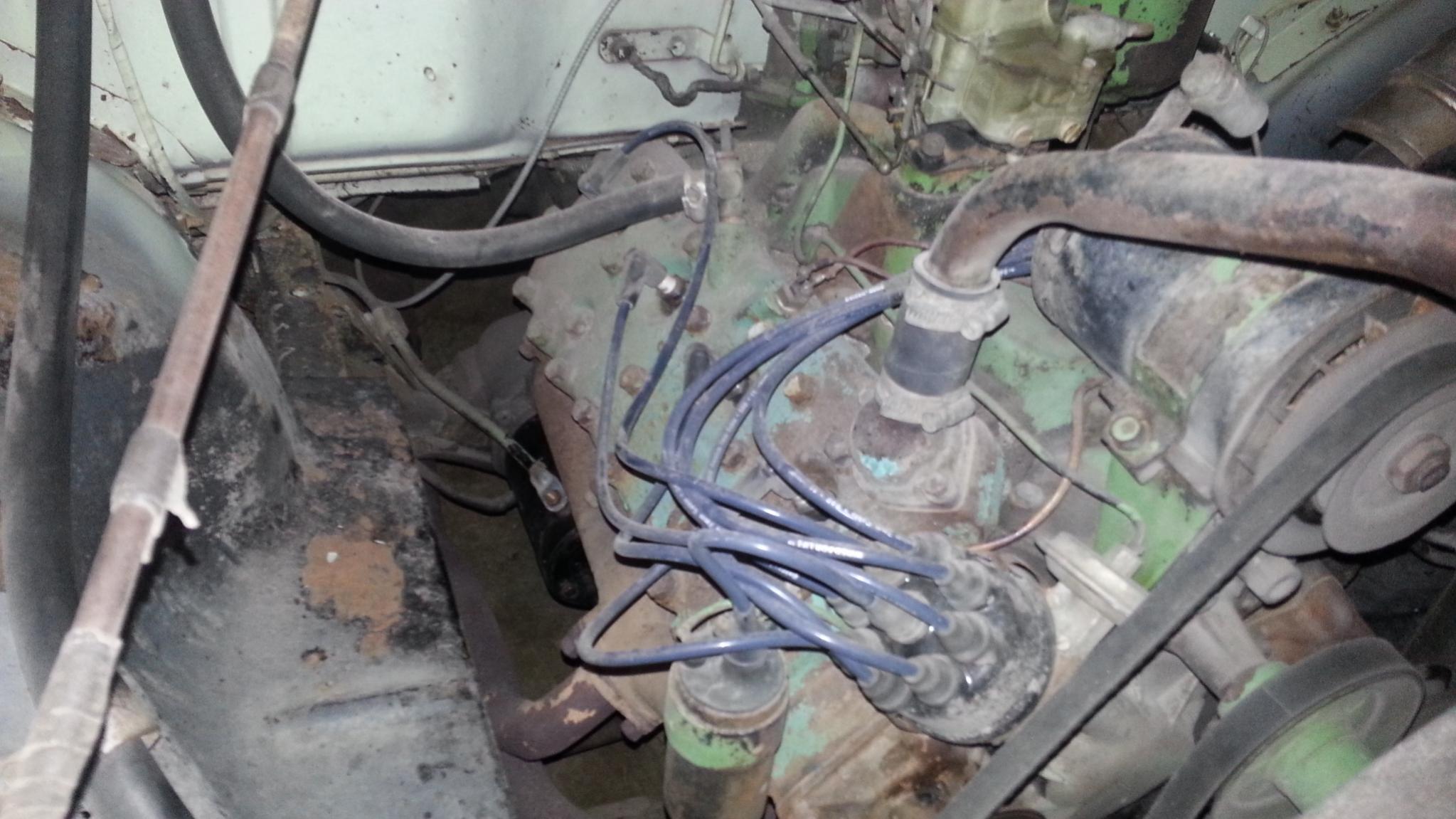

    I just bought a 53 F100 with the original flathead V-8 and it still has the 6 volt system in it.
    It is turning over very slowly and will not start? It has a new battery and starter on it?
    Any suggestions?
    Thanks

    I don't know anything about 6 volt engines. I do know some about 12 volt engines. I have cleaned and bought one new battery cable. It looks like the battery is putting out 6 volt? The starter is new. The battery is new. It runs like a champ when running. This is the first time I have had an issue with it not starting?
    Can I try to recharge the battery with a normal 12 volt charger? Can I connect a 12 volt battery in some why that won't mess anything up?

    Thanks for the info. One other question. The positive goes to the frame and the negative goes to the starter motor. If I hood up a 12 volt to try to turn it over faster, do I put positive to positive and neg to neg?
    I will check the ground for the engine when I go back out. I do know the battery is ground to the frame.

    I will check on the thickness of the wires for the ground and starter. It looks like the ground from the engine goes to the body of the truck, should I put a new ground down to the frame?
    Also, if checking with the 12v battery, do I hook it up positive to positive or like it is with the current 6v battery in it? Thanks

    Well I changed over all the cables and well just as things work out, the battery is low now lol I stopped by and picked up my friends 6v charger and put it on. I will let it charge overnight and see what happens in the morning.

    Thanks for all the advice on getting the engine going. I changed out about $50 in cables and recharged the battery and it fired right up this morning........then I turned it off and then flooded it lol STILL Thanks, it's up and running!

    Also, make sure you have a proper sized battery. When I blew up your picture, it looks like that is a Group 1. Most flathead Fords had Group 2 batteries which are larger. Years ago, when I needed a battery, I couldn't get a Group 2 battery, so I settled for a Group 1. The car started and ran fine except when it was hot. Chased all the usual gremlins, and changing to the proper battery solved the problem. It also looks like your battery is 640 CCA. The last time I looked at a group 2 at Fleet Farm, they were 775 CCA. Ford put the larger batteries in for a reason. A group 1 is fine for Plymouths, Chevrolets, and tractors, but not a V8.
