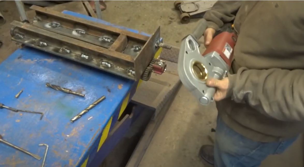

    Here is a pic a snipped from my video on youtube. The set up works very well. I added a foot control that I can "pump" to gain a little more control, but was hoping that the little Speed Control would slow it down a bit more.

    I see. I had not seen a pic of the threader. Figured it was some kind of floor machine. Best of luck!
