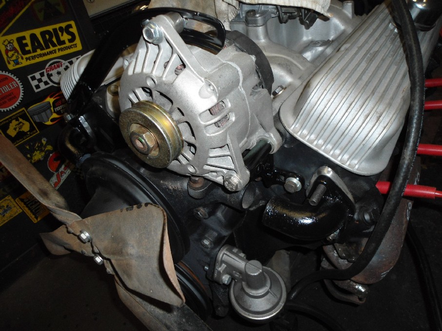

  18. I'm using one from a 90s GM car...wiring diagram for it can be found online.. Don't know if it will fit on 10SI mounts or not but it was easy to fab up mounts for it. Pully is a direct fit from a 70s GM 10SI alternator...5/8ths I believe. 370altbrackets.jpg
