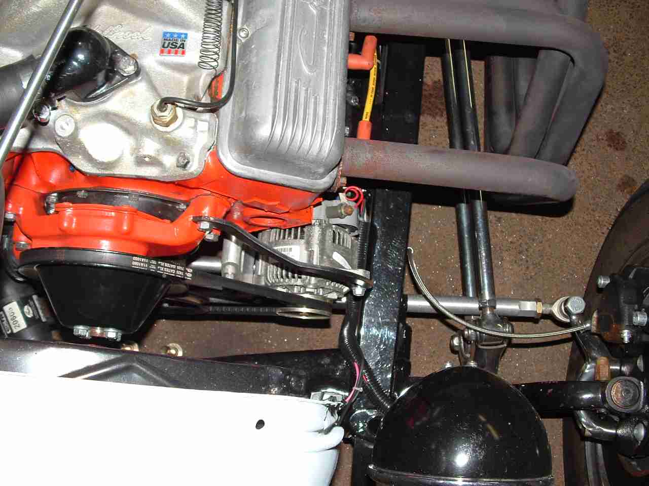

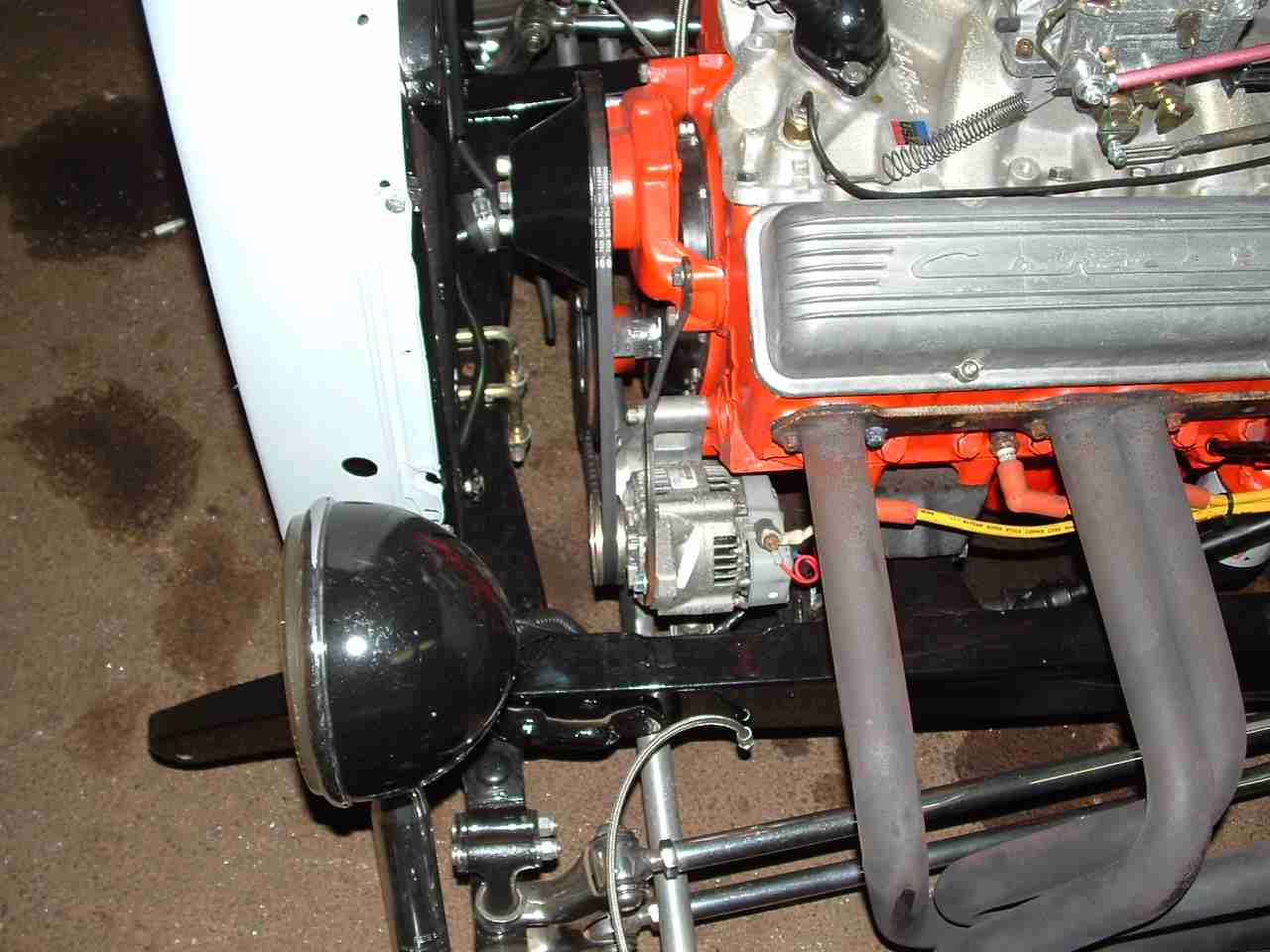

    nrfleming
    PPR precision parts and remanufactuering co. part number SKA826
    pics on the way
  21. nrfleming
    Joined: Nov 17, 2005
    Posts: 387
    nrfleming
    holy cow, i got one of those import ****ers on my ford/chevy. oh well....
      70.3 KB
      146
      71.1 KB
      129
