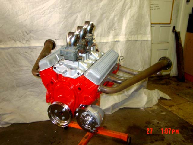

    Here's mine. Honda Nippondenso and homemade brackets. Made to fit inside a hood that I never got built.
