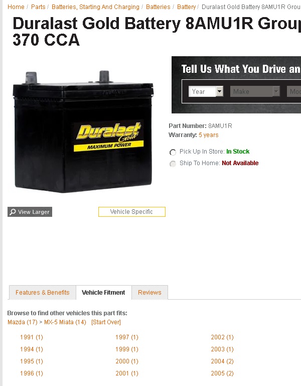

  21. squirrel
    Joined: Sep 23, 2004
    Posts: 60,076
    squirrel
    in case anyone thinks he's joking...they actually use lawnmower batteries in older Miatas. It sits in the trunk.
    Tickety Boo and RICH B like this.

  23. Budget36
    Joined: Nov 29, 2014
    Posts: 15,390
    Budget36
    Take a look into a Mazda Miata battery, I've one here it's about 4.5 inches 6 inches and about 7 inches tall. Unsure of the CCA, the label has weathered off.
    Edit:
    Guess I should have read through all the replies.
