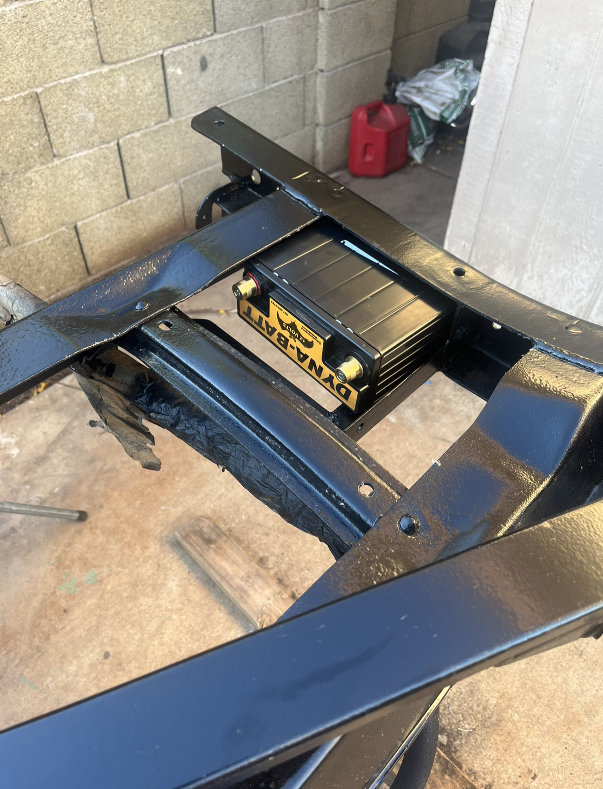

    I used a lithium battery in my truck. Weighs like 8lbs, 4ish inches thick, can be mounted at any angle, starts my 241 hemi like a dream, 10.5:1 IMG_0052.jpeg

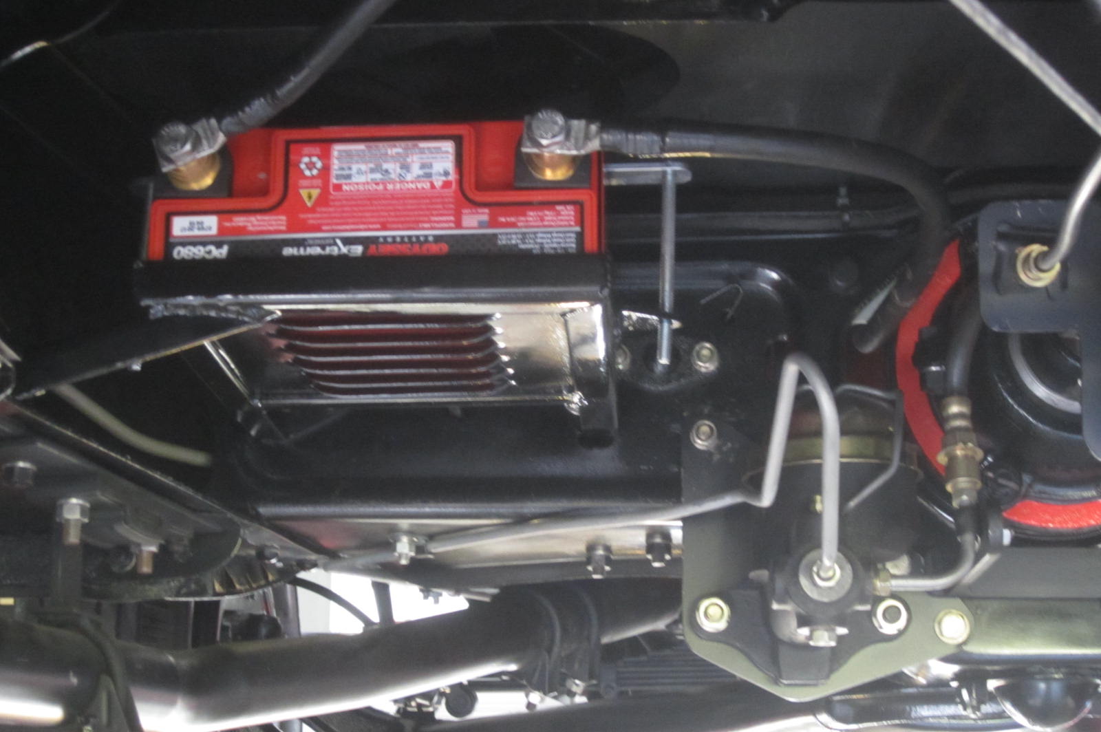

  13. ydopen
    Joined: Mar 14, 2010
    Posts: 256
    ydopen

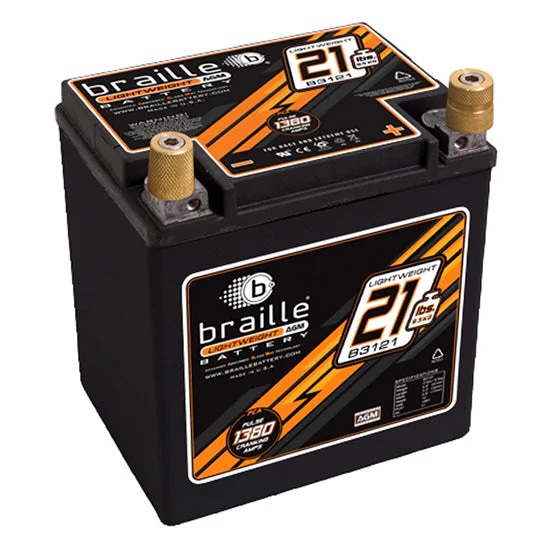

  17. ClarkH
    Joined: Jul 21, 2010
    Posts: 1,586
    ClarkH
    Braille B 3121. AGM battery measuring 6.6 in. L x 5.2 in. W x 6.8 in. H. Available from Speedway, Jeggs, Summit, etc.

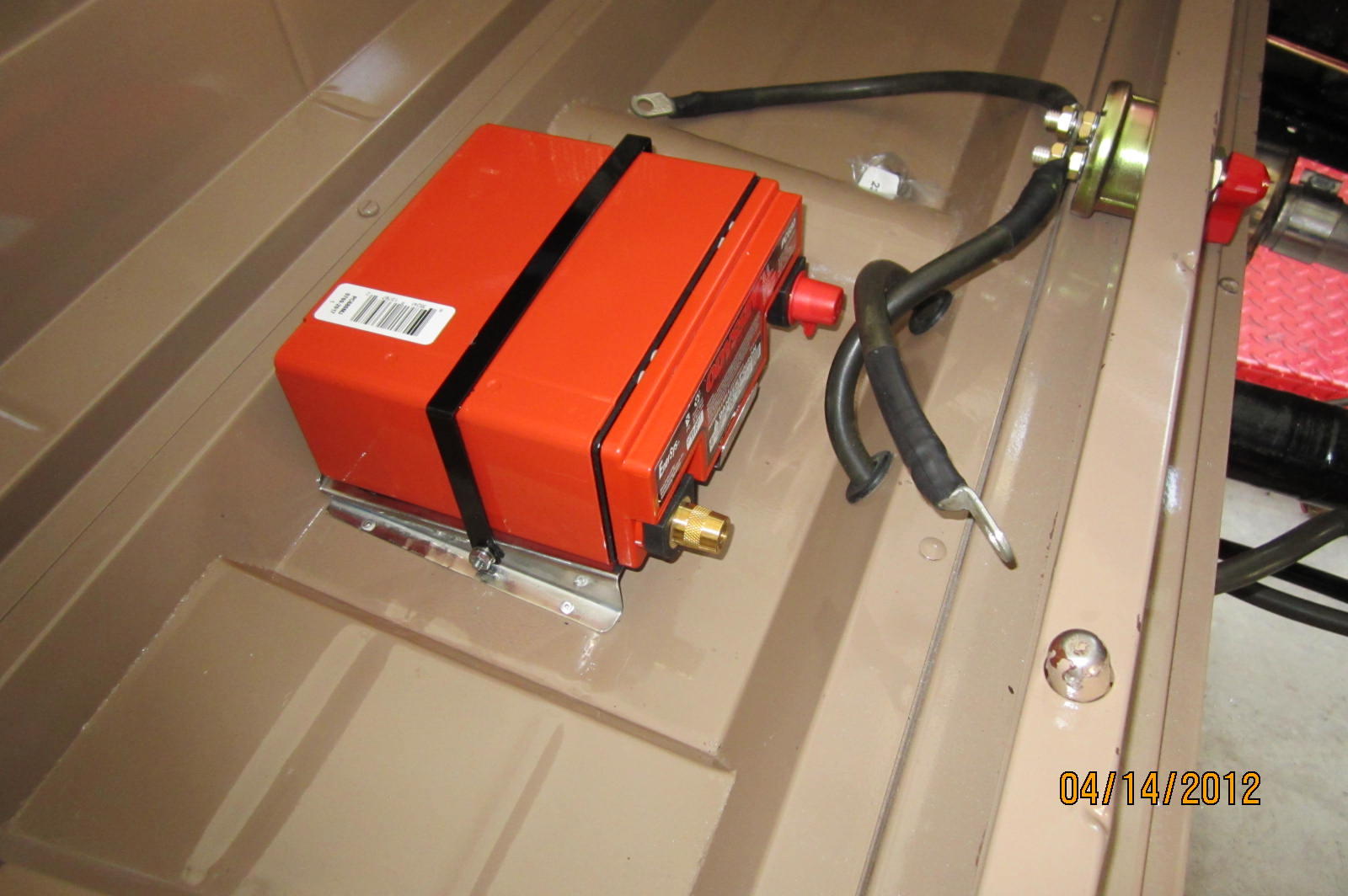

    I've been running the Odyssey PC 680 in my Roadster with built v8 flathead for 14 years. I finally replaced it after 10 years, just because. Then used it in my tractor for a couple of years. Also running one in my 32 Coupe with built 53 Merc engine. Never an issue. 006.JPG

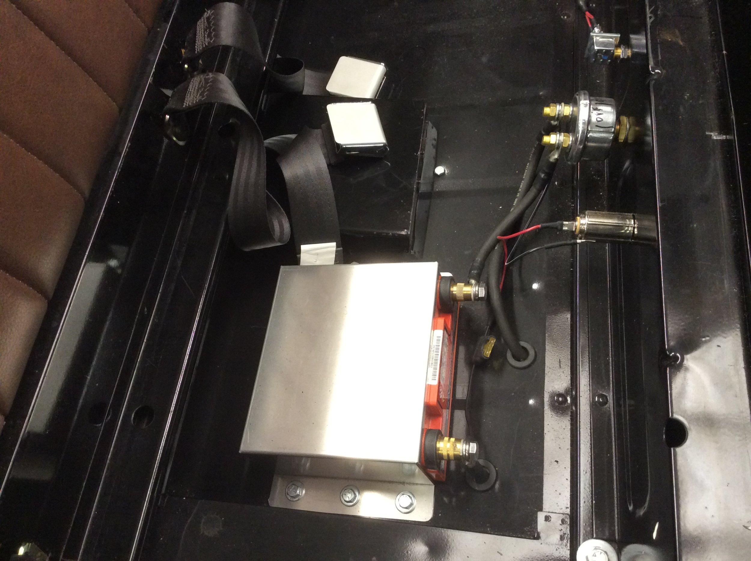

  24. Just Gary
    Joined: Oct 9, 2002
    Posts: 5,850
    Just Gary
    An Odyssey PC680 under the floor of my '28 A sedan is strong enough to crank over the 10:1 354 Hemi.

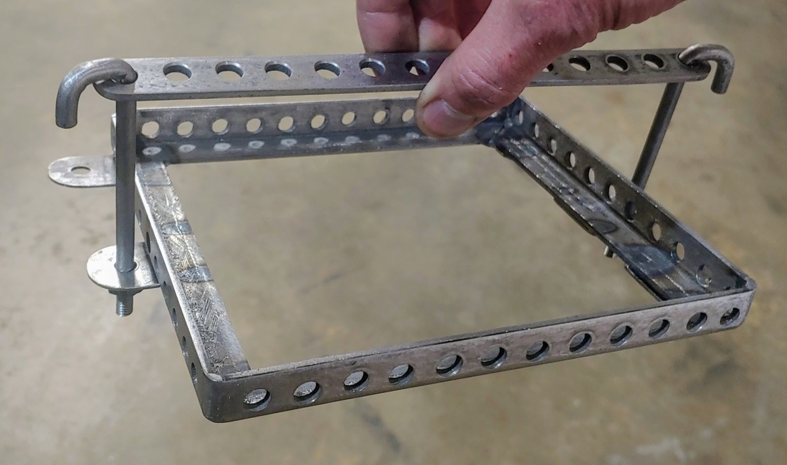

  28. hotrodA
    Joined: Sep 12, 2002
    Posts: 7,448
    hotrodA

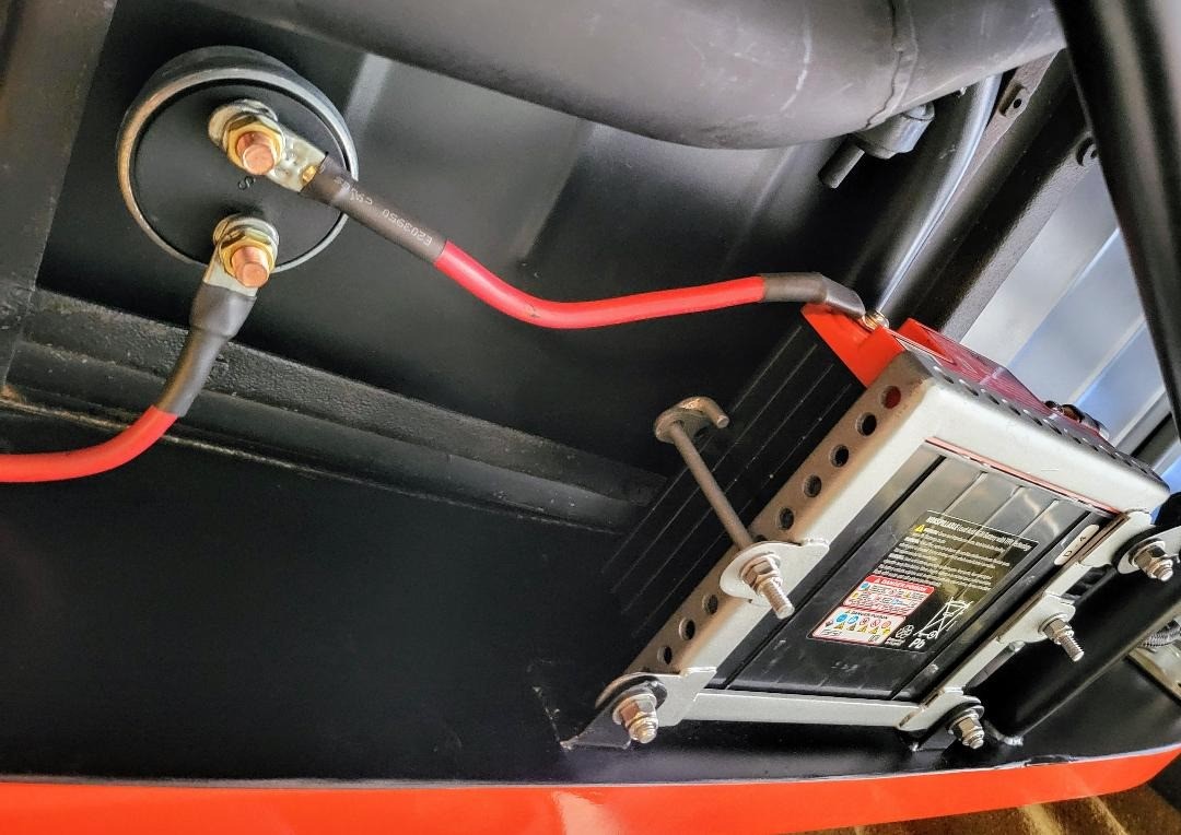

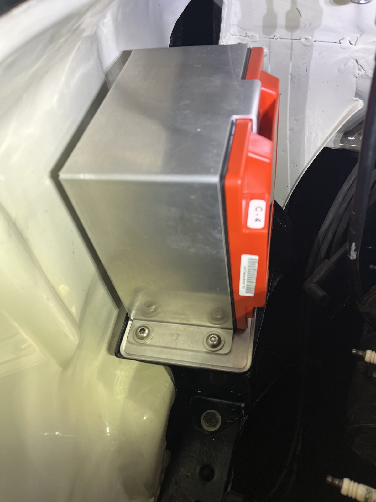

    Odyssey for me in my 40, in the stock location. BIG improvement!
    I sliced and diced the stock tray and reused the OE stands. Tucked it further outboard in the stock inner fender panel recess. Sits in an aluminum tray that I had laying around and fits it, amazingly!
    Gave lots of needed room for the SBC rams horns and heater fittings and hoses.
    Cover/hold down is aluminum. Cheap on EBay.
    Yeah, the bright red is too much.
