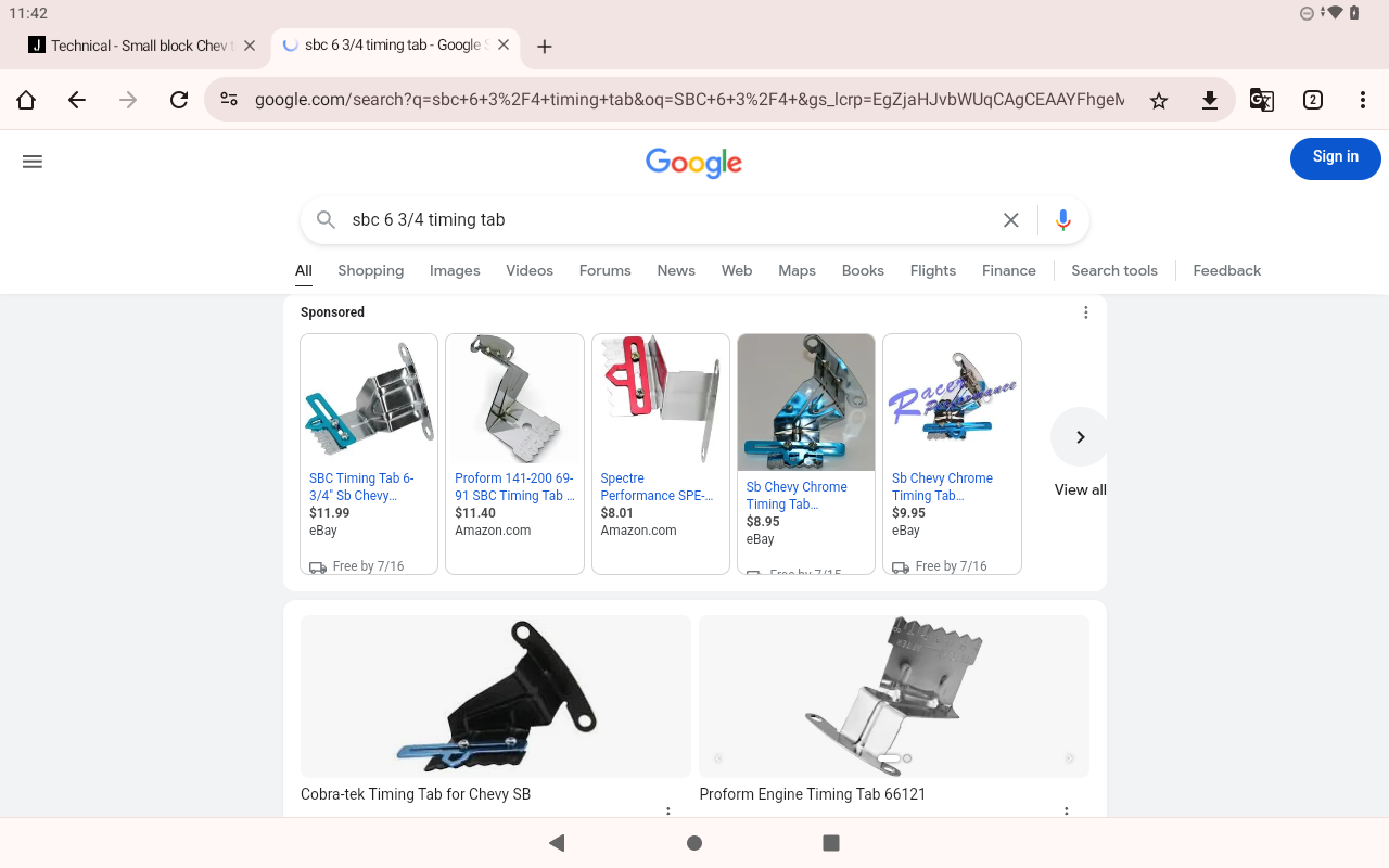

    Screenshot_20240708-114233.png Google: SBC 6 3/4 timing tab , bunch of them .

    Ordered 2 of these, including GM part #3991435 (which is supposed to fit a 6 .75" balancer), and both don't fit - diameter too large & sticks out too far.

    Forget about using the factory balancer with a bolt on tab, it won't work. The factory balancer is 6" in diameter with the outer ring being about 9/16" thick, only the short welded on tab will work with this. You're going to have to either use the stock timing cover with the stock balancer or get a later model balancer with the bolt on tab to match it.
