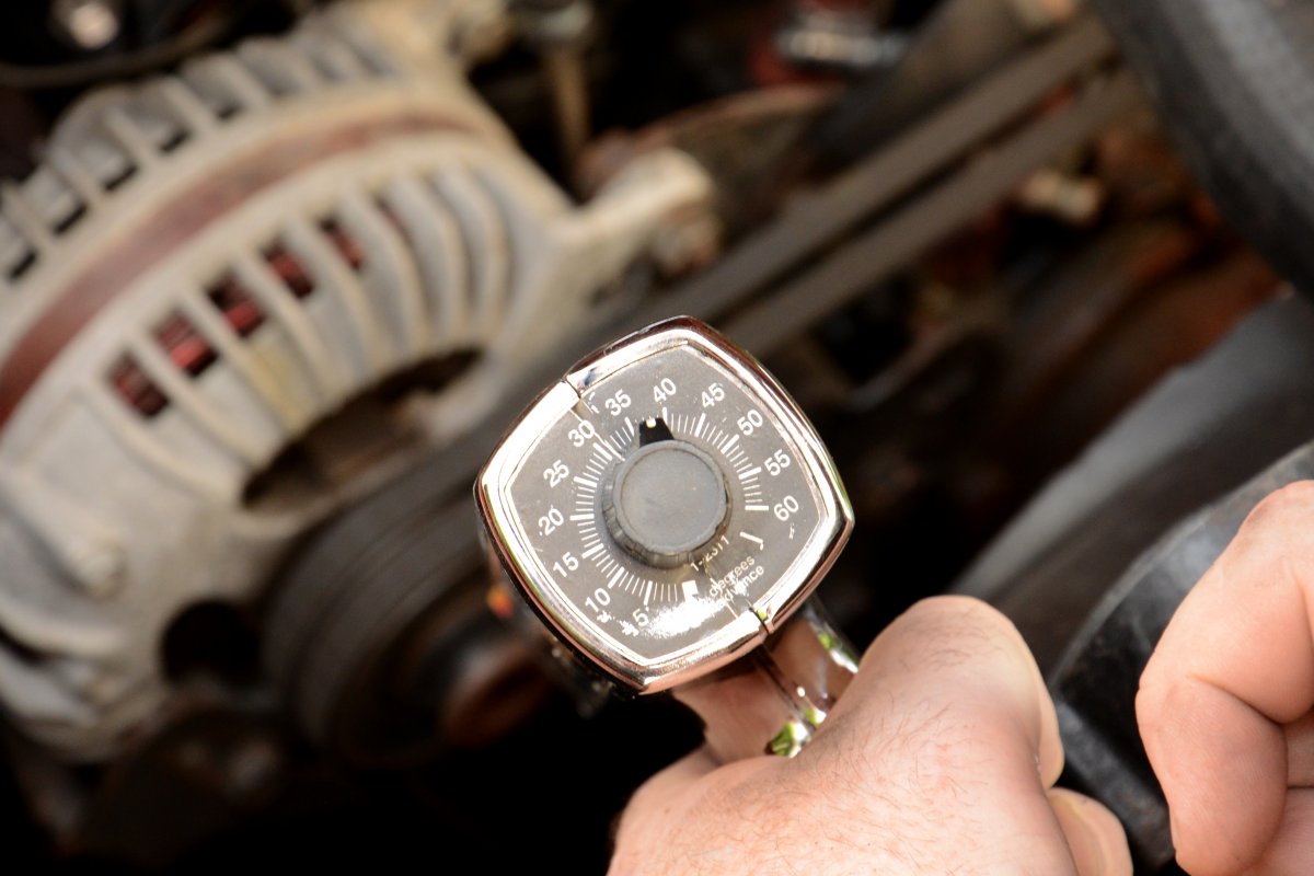

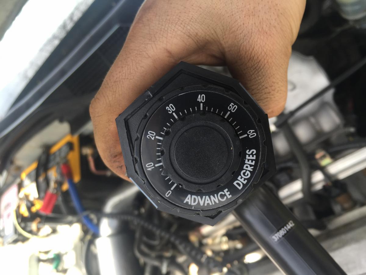

  26. DIYGUY
    Joined: Sep 8, 2015
    Posts: 883
    DIYGUY
    from West, TX
    Pork, use the knob on the light to zero the tab and pointer. Read what your knob is pointing to on your light. It might very well be 15 degrees
  27. porkchop4464
    Joined: Jan 20, 2009
    Posts: 880
    porkchop4464
    Sh@#T, now I am even more confused. I know it is simple, what is being explained, cause several people have mentioned something similar, but I am still not getting true TDC with this? I must be and am thick headed, I just am not understanding, guys. Sorry, really. Please, in baby steps and words.
  28. DIYGUY
    Joined: Sep 8, 2015
    Posts: 883
    DIYGUY
    from West, TX
    Not being a smart *** I promise. Do you know the flashing light will “move” when you adjust the knob on the light while engine is running?
  29. You can not find TRUE Top Dead Center with a timing light.
    Do you even have a dial back timing light???
    3F5997FF-E6E7-4847-8AD7-92A00E6E5FBB.jpeg EEC48B09-8501-49AB-898B-B94CBBEA98DF.jpeg
