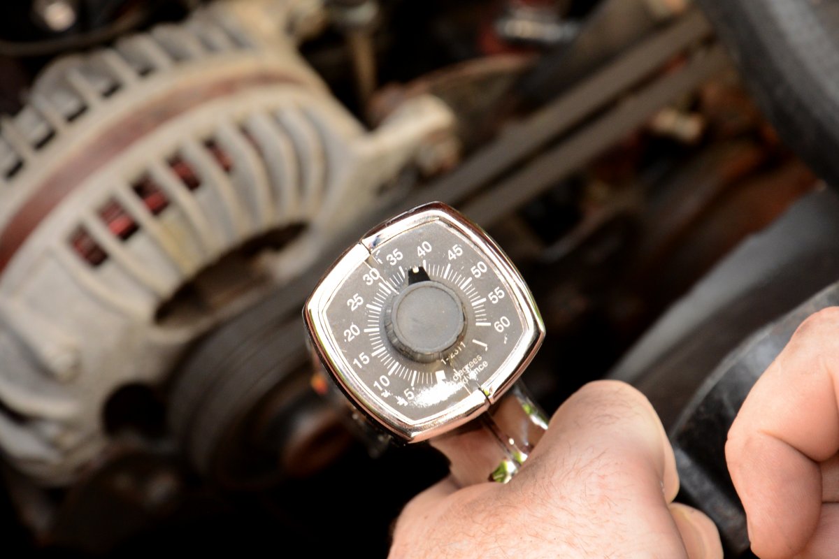

    Yes, I have a "dial back" Snap-on light, but how am I going to find TDC regardless of where I place the knob if I don't accurately know where my dist is currently sitting? That is what I am asking.
    I think what is being said here is if my marks are at zero on block and tab when I start the engine, and I dial back say 15 degrees to get the light on zero position on the tab, then 15 degrees back on the light knob is my actual engine's 0? Is that what is being explained?

    With the engine not running, you find TDC with the piston stop. That lines up the line on your damper with 0 on your timing tab.
    With the engine running, your timing light shows when the distributor is firing #1. With the vacuum advance disconnected, and the engine idle speed below where the mechanical advance starts, you’re now reading the timing advance set by turning the distributor.
    On a stock SBC, the base advance is usually going to be around 10-15 degrees BTDC. Your timing light will show this by lighting the line on the damper while it is in line with a mark on the timing tab.
    You can use the dial back feature of the light to bring the damper line back to the 0 mark on the tab. Then read the dial to get the actual advance set at the distributor.
    Your engine is not stock, so stock timing specs like 15* BTDC don’t do you any good. But your timing light light works the same.
    So establish TDC. Then start the engine and let it warm up. At idle, point your light at the tab, and turn the dial until the damper line is at the 0 mark on the tab. Read the dial, that’s your static advance at the distributor.

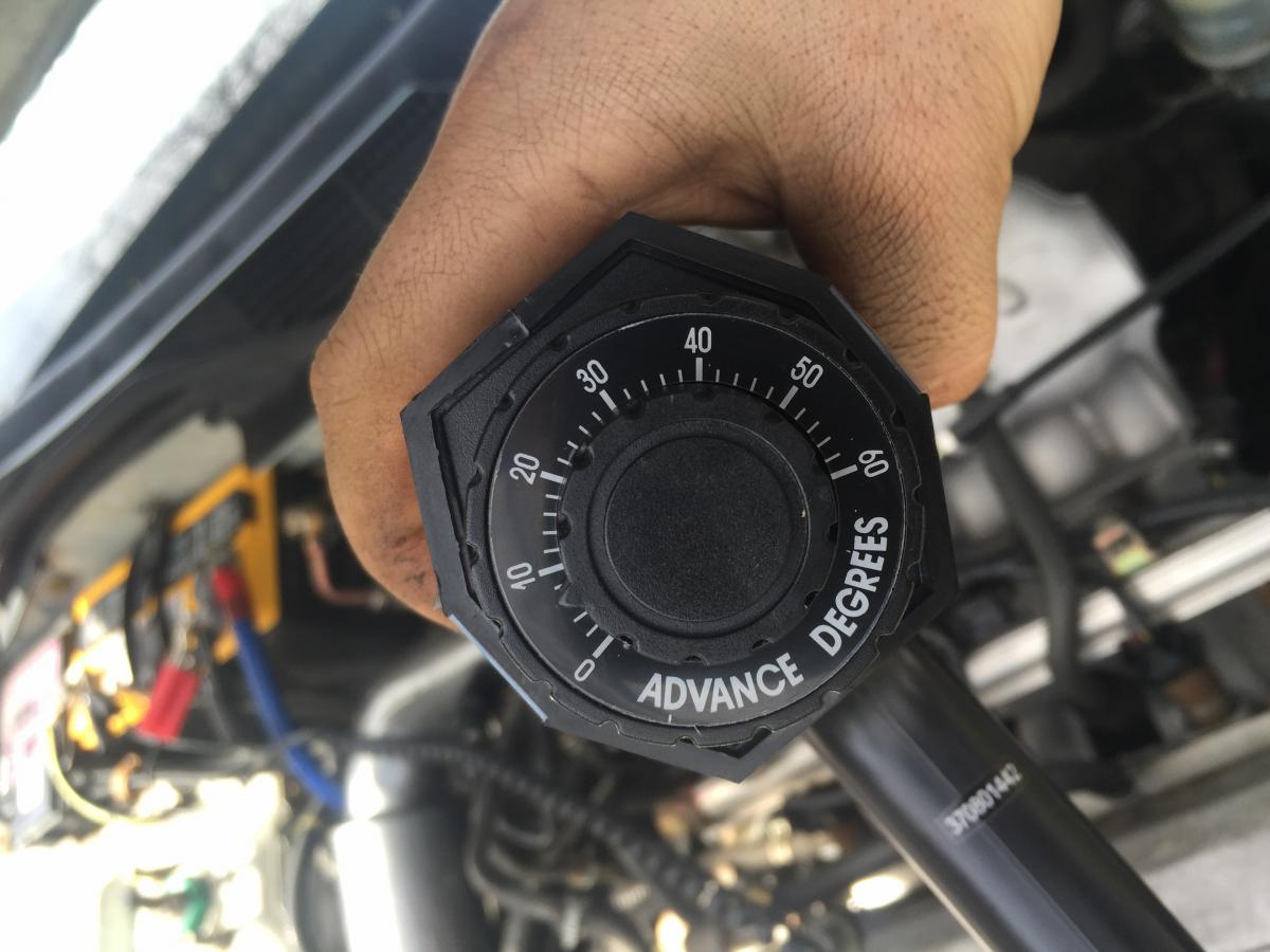

  13. Porkchops,
    With a dial back timing light you will always see the mark at zero
    IF
    And when You Adjust the lights name sake.
    Then look at the light's adjustment to know your timing setting.
    Just be sure the vacuum to distributor is disconnected and plugged on engine side,
    As you adjust the light the mark on the dampener will move. That's the cool part about a dial back timing light and You should never have to guess at marks other than zero.
    When it's all said and done you're looking for is hard acceleration and no pinging on acceleration and no hard hot starts. What the timing ends up being to get that doesn't really mean anything nor will you find it in a book

  15. theHIGHLANDER
    Joined: Jun 3, 2005
    Posts: 11,070
    theHIGHLANDER
  16. Suggest you shouldn't need a degreed damper or timing tape on a street rod or cruiser.
    Just use you timing tab. Carefully add 3 marks @ 10, 20 and 30 before.
    Use you dial back light at advance, set at zero, then run it back to 0 on the tab, to check it.
    Been using a Snap Out light for almost 40 years, and it still zeroes out.

    Am I the only one that read that when th O.P. put the distributor in and big heavy wheel looking thingy on, the timing marks lined up perfectly and the engine fired right up? He checked the timing with a light and found the timing Mark @ 12 o'clock. Then he, again, checked for tdc on #1 compression and found everything was where it was supposed to be. My question is this, how could everything line up statically, yet when checked with a light, with the engine running, be off by 20 degrees or more? To me it seems, that either his dial back timing light is ****ed up or the advance plate is stuck in the distributor. Regardless of piston dwell at tdc, it seems like a very excessive amount of advance to be running properly with no hard, hot start issues. Let alone be running smoothly. I know I'm pretty dense sometimes, but I just don't get it. Could someone please explain? I'm confused. I'm not being a smart *** either, I really don't get the extremity of this! [emoji54]
