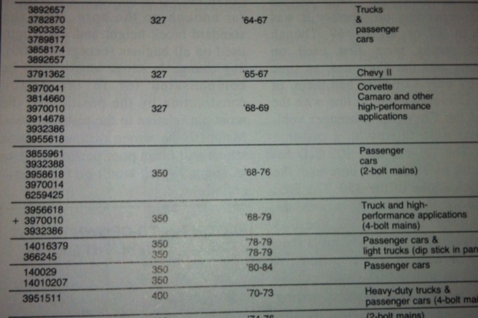

    The number just behind left cylinder bank (as asked for) is:
    18 GM
    3970010
  15. Looks like an early 350. First installed in Camaros during 1967, which IIRC, would make it a small journal, and rare. All others would be large journal (natch).

  18. '68-'79 350. 4 bolt main.
    Score.
    *edit, sometimes 2 bolt main*

  22. [​IMG] I didn't catch that! :eek:

    Well....I have never had the pan off, so it might be worth while to get her out of the crate and have a look...
  26. That little (+) beside the number is a notation that says some of the blocks were only machined for two???
    I'll put my money on 4. Good luck!

    Well judging by the 010 I would say that it is a 4 bolt main 350 with 202 heads from a 327 and I'm betting that it has the 151 cam in it to. Nice engine for sure....

    That I don't know without dropping the pan. Good find though Cactus!
