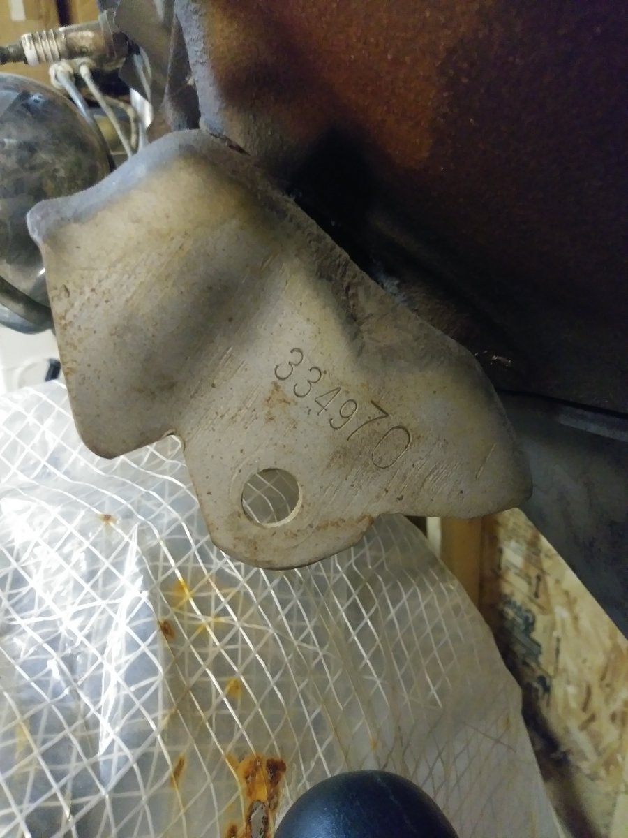

    What does the 18GM stand for

    Thx you but I only found 6 numbers and a giant 11

    Looks like those are 400 sbc heads on a 350.... And not angle plug.... Sorry dude!:(

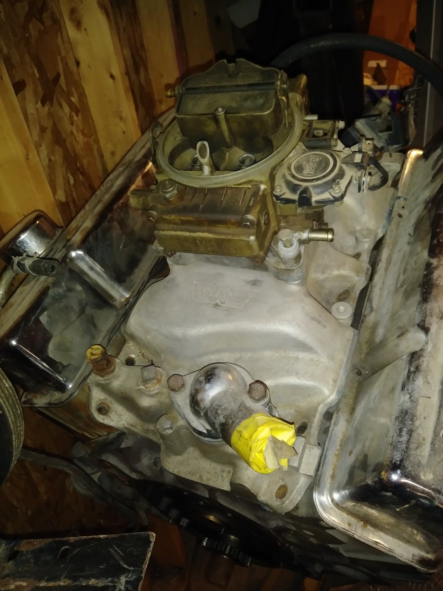

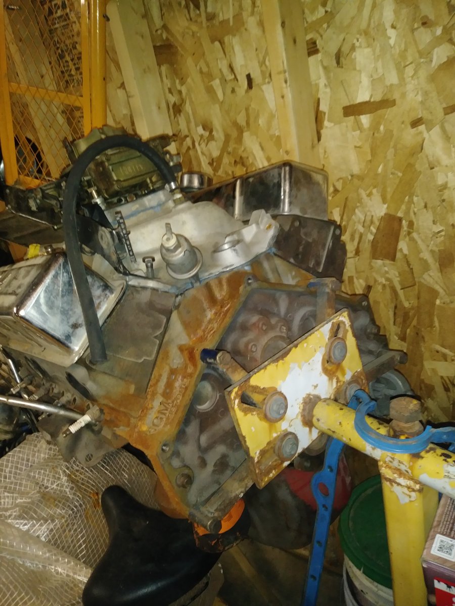

    Heres a picture of the whole motor I'm just wandering a value of the motor so we can sell it 1531024108550638252060.jpg 15310241562641392323659.jpg 153102421072283532941.jpg 1531024236783847144392.jpg 15310242653531049242590.jpg 15310243774231575806044.jpg 1531024407740209559993.jpg 1531024458952935986886.jpg 15310245064751945992305.jpg

    Not the best head for performance, small intake runners and prone for cracking.

    Looks like the pan bolts are mostly missing, just thrown together? The block has the 010 020 under the cam gear, that's a good sign. Most guys wont offer too much without knowing if it p***es a crack test though.

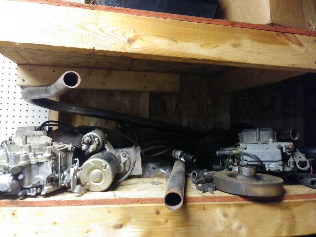

    I also have these parts that go with the motor all the nuts and bolts are in seperated baggys 15310248693571147826095.jpg 15310247788191721198925.jpg

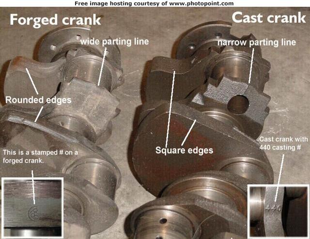

    That would be a good block to work with if its good, check casting # on crank to see if its forged or not.

    Take the pan off, and look near one of the main saddles, may have to rotate the crank to see it.
    https://www.enginerepairshop.com/chevy-casting-numbers.html
    Also, the wide and narrow parting line is an easy way to tell if forged or not. This pic may not be for GM as for the rounded counter weights, but for sure for the parting lines. crankshaftid.jpg

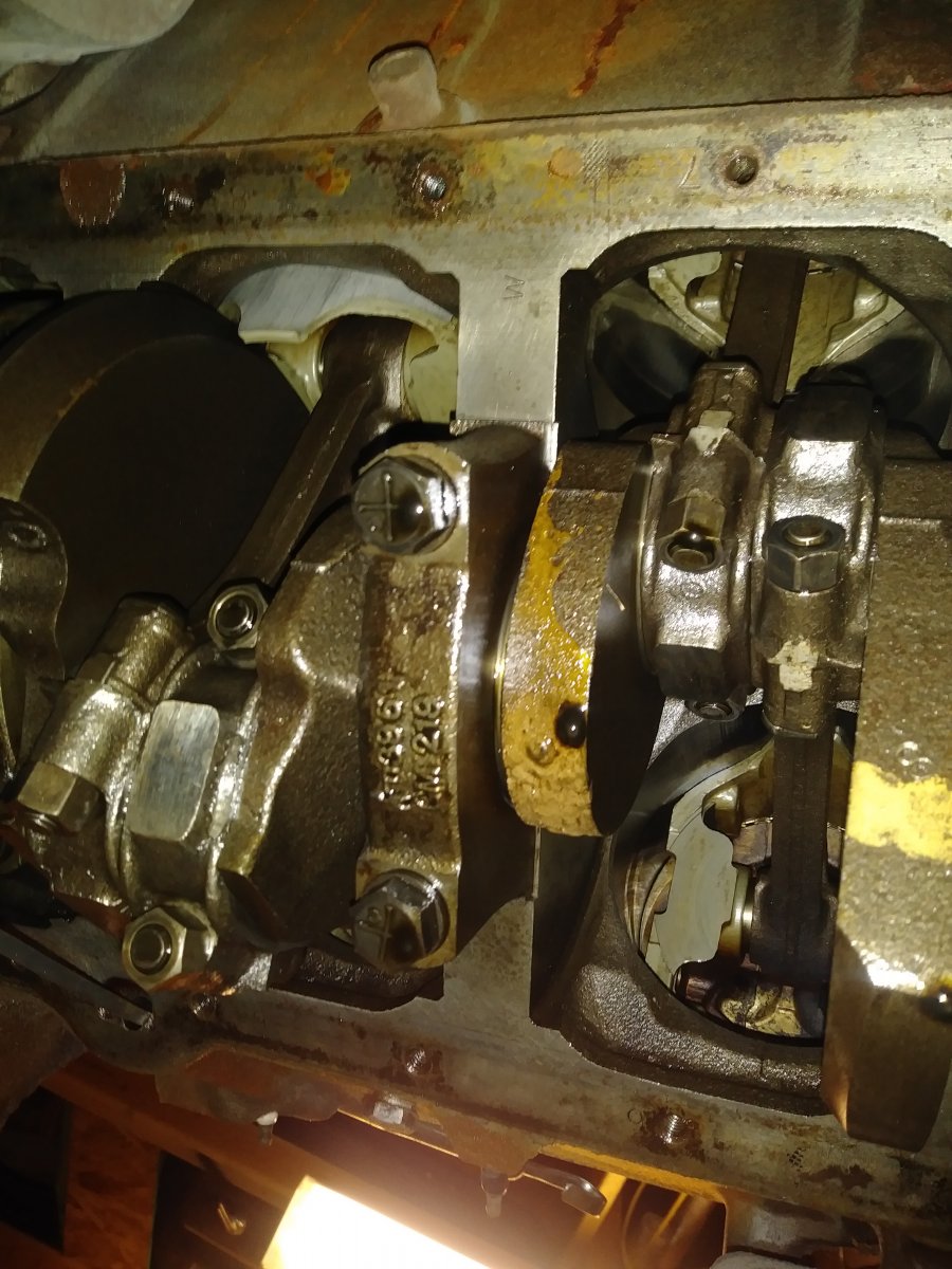

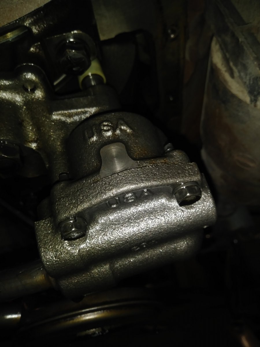

    Idk if I'm in the right spot but I took the oil pan off the bottom 1531026225545184259109.jpg 1531026261201118673488.jpg 1531026309952290186190.jpg

    Yes, right area. The crank might have to be rotated if you can not see any numbers on it in the current position. The main caps are cast with the 3951# , the #2482 main caps are the cats meow as they are nodular.

    I believe the front two main caps are installed backwards, the arrow should point to the front of the engine.

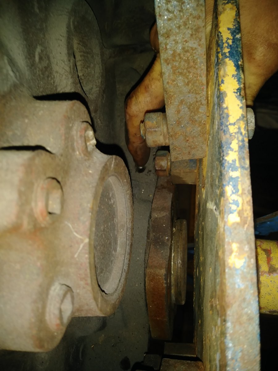

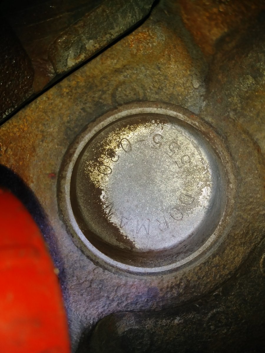

    10j177666 v1205cnv and the last pic is the reason why I cant turn anything the bolt for the motor stand is in the way 1531029843424694456414.jpg 153102999375342881995.jpg 15310300451332108172318.jpg 1531030081435586902259.jpg 15310303362701502213596.jpg

    CNV and the partial VIN 10J... means it's a 2bbl 350 from a 1970 full size Chevy car. Nothing to write home about, and would explain the 2 bolt mains (truck 350s with the 010 block almost always had 4 bolt mains).
    The 010 020 thing on the front of the block is simply the last three digits of the block casting numbers that used that particular mold pattern for the end of the block. Has nothing at all to do with what type of iron was used in the casting.

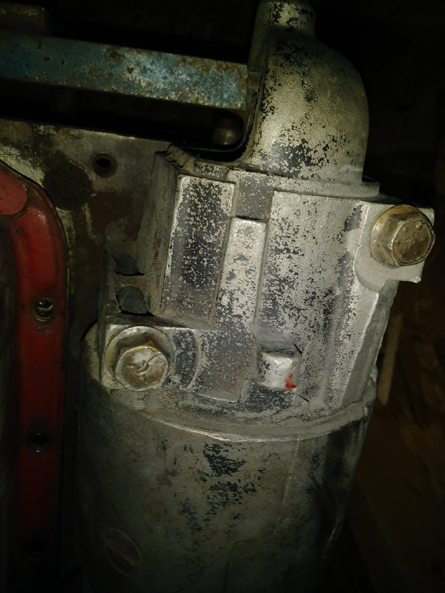

    Ok so basicly saying I gotta put it together to test it lol ok I got it my father in-law also bought this idk if it goes to it 15311080128881675313374.jpg 1531108120809656501684.jpg 1531108197319952263807.jpg 15311082614551074172196.jpg 1531108306077603864934.jpg

    He was either putting it together to put in our 76 chevy Malibu or this other monster of a jeep he had or his chevy pickup truck but we didnt talk to much about it before he past.
