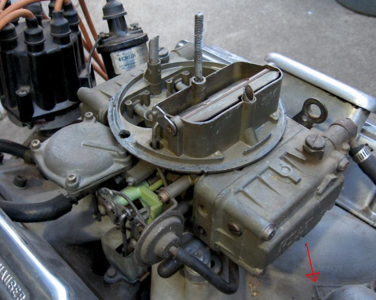

    I posted earlier about the rectangle cast into the intake in the photo of the carb but deleted it, as I had some incorrect info in there. The early tarantulas I saw didnt have the rectangle, but I have since found photos of tarantulas with the "TM-1" cast inside a raised rectangle just like the Torkers. However, on the Tarantulas I saw with a rectangle, theres a fair bit of space between the edge of the rectangle and the T. You can just barely see it in this photo, so I am kind of winging it here, but the proximity of the T to the edge of the rectangle makes me think that might be a Torker.
    And I agree 100% about this being a great piece. Looks like a really nicely built high end 70s small block

    I could be wrong but I think that the Tarantula had an air gap below the runners. The Torker did not.

    Nice motor... looks like a well built early 350. Motor was more and likely decked (shaved) for the oring install thats why no numbers are on the pad. I would put money on it that the heads are shaved also. If so Compression ratio is going to be a up there for pump gas. If the heads are milled your compression will be more 11 to 1... how much depends on how much meat the heads had taken off them.
    Would like to see head/crank/main cap casting #s...

    Thank you both for the Info! The manifold is clean, but I will have to look at it to confirm exactly what it is.

    The Scorpion is a higher rise intake design (& the little figure in it too).
