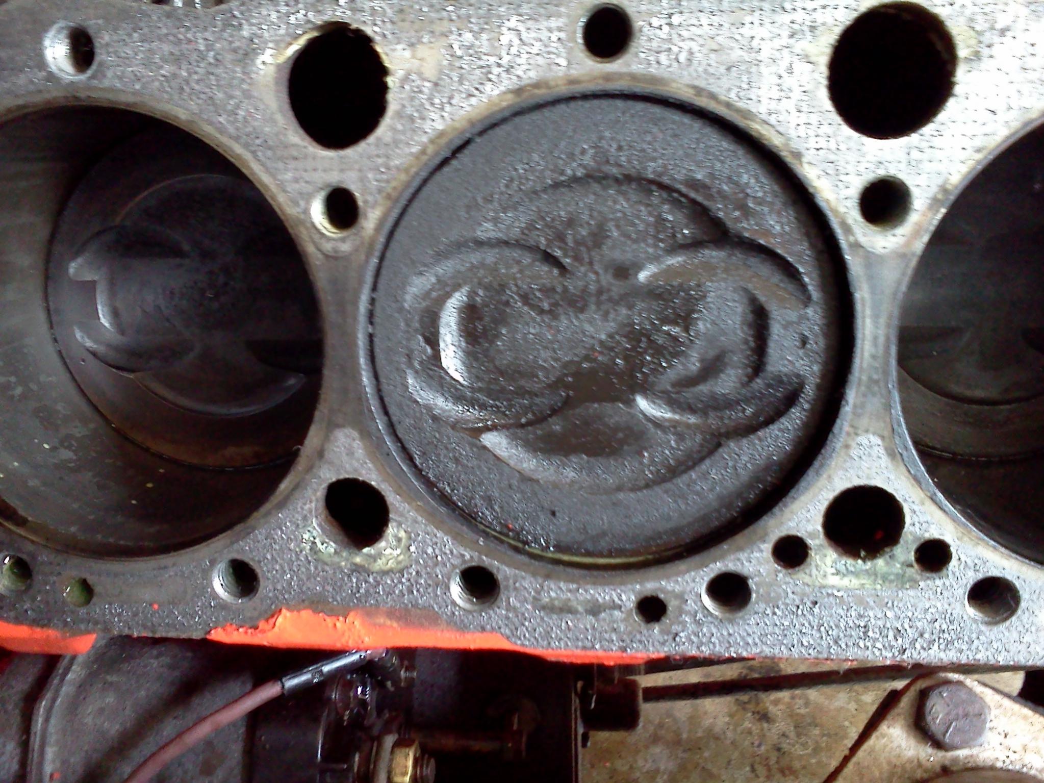

    I am gonna try to upload some valve and head pics
  21. mustang6147
    Joined: Feb 26, 2010
    Posts: 1,847
    mustang6147
    from Kent, Ohio
    The one pic is with a LED flash light in the intake runner and the valve closed with before taking them out. Spring pressure is 85lbs at seat and that much light is coming out.
    The other pics are right after I took the head off. No sign of bad head gasket.

    Where did everyone go? I post pics of no blown head gasket, and everyone ****ters?

  25. Id have them pressure tested , fixed , fluxed and decked call me crazy but a very slight warp will start to blow a head gasket the minute you start it .

    If you look between the two cylinders in the picture there looks to be carbon buildup between the cylinders. I also dont see a nice clear ring around the cylinders you should see if it was sealed well. This is a sign of a blown head gasket. The gasket does not have to have a hole to be blown.
    Definately, got valve problems too....overreved and bent valves?...looks like a wreck all together.
    I guess with a 1/16th inch gap on one valve and the other one open you might get some air flow, but it would be howling in the intake if it was taking that route....
    If it was mine and had that much problem I would pull it out and check everything. If all is good you are just out time and gaskets.

    you have leaking head gaskets, depending how long it has been like this it might fire slot the block and head. when you fill a cylinder with pressure it will help seal the valves, and then push the air threw the gasket where its been leaking.
    From that picture those look like some proline or engine quest stock replacement heads, they either had junk valves or to strong of springs to mushroom the valves.

    Not to sound like an echo, but yup...me too. However, headgaskets still look to be leaking.

    I agree with turbo s10 thats a blown head gasket. People have mentioned checking the mating surfaces of the block and heads. Have you done that? Without these surfaces perfectly flat, you will blow another head gasket long before its time. Its obvious that the valves are bad,so fix them but if it were me I would deck the block and heads before re***embly to avoid a tear down in 6 months when the head gasket gives up again.
    Besides when milled down you increase the comp ratio increasing the power out put.
