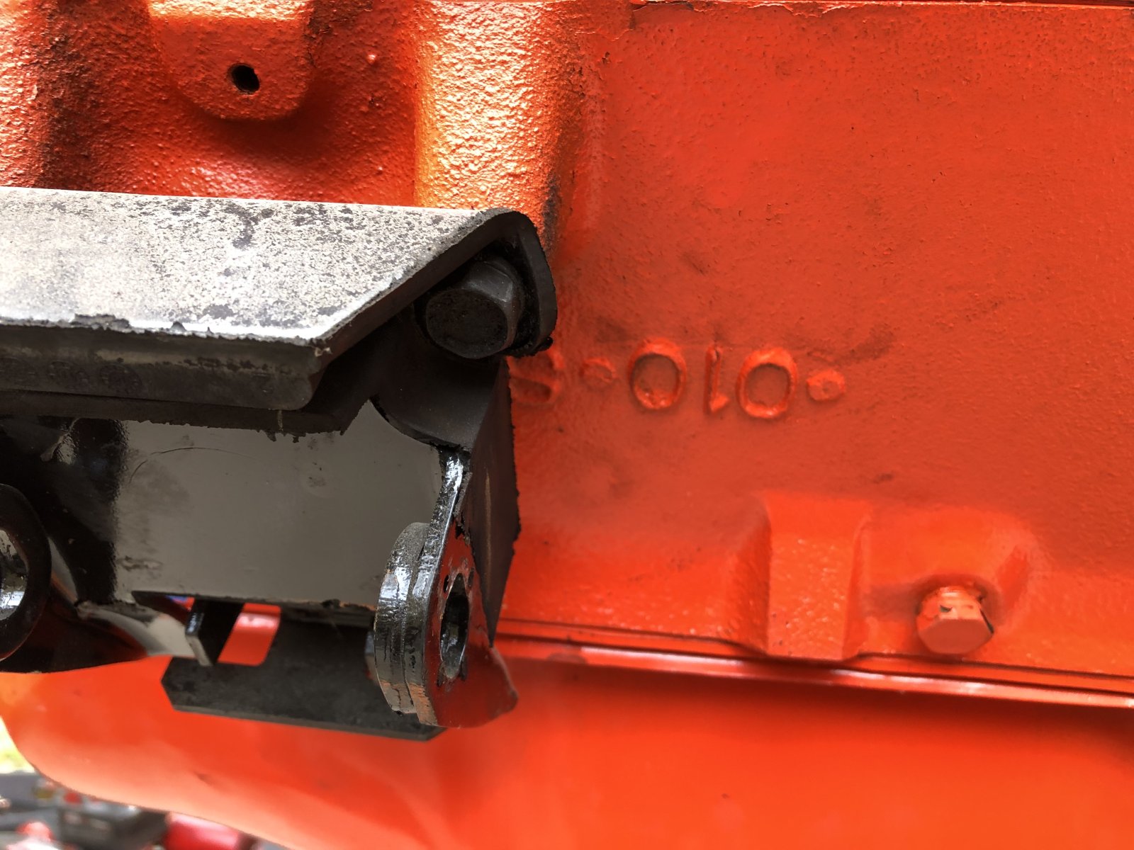

    Jim beat me to it. To be fair I'd be cheating cuz I got one handy, same casting. I'ma guess there's an "010" on the side of the block too, yes? Lotsa urban legends abound about that.

    But in reality, having the 010 on the side of the block just means it's a later 70s casting, as Chevy started adding the last 3 of the casting number to the side of the block in the later 70s, most likely to make it easier to spot which block is which, on the line.

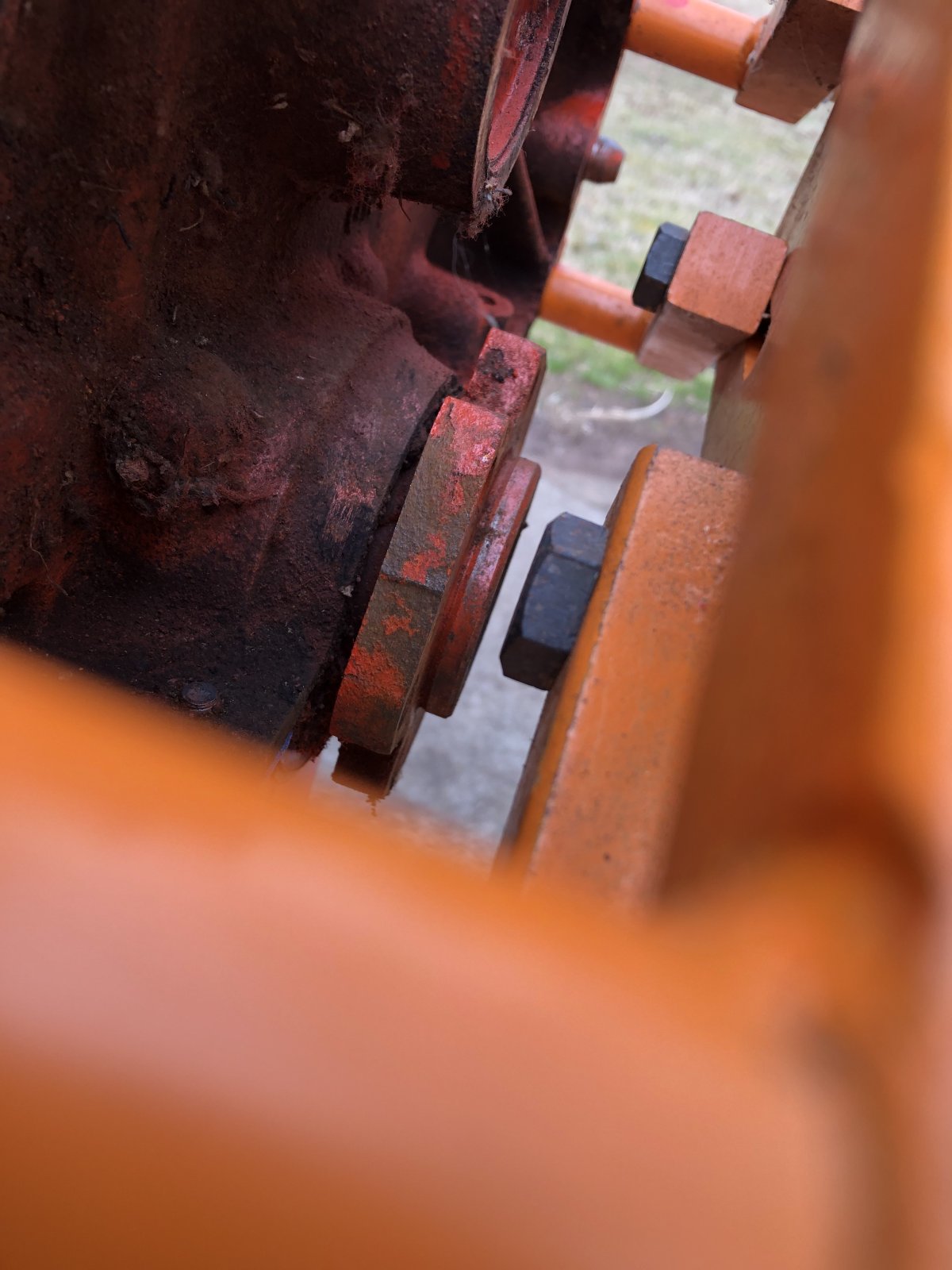

    Well, I just got it rolled outside and ready and things got interesting real quick. I suspect some of y'all know why...

    Well, it's in a Corvette frame, so that makes it a Corvette engine! But aren't they all?

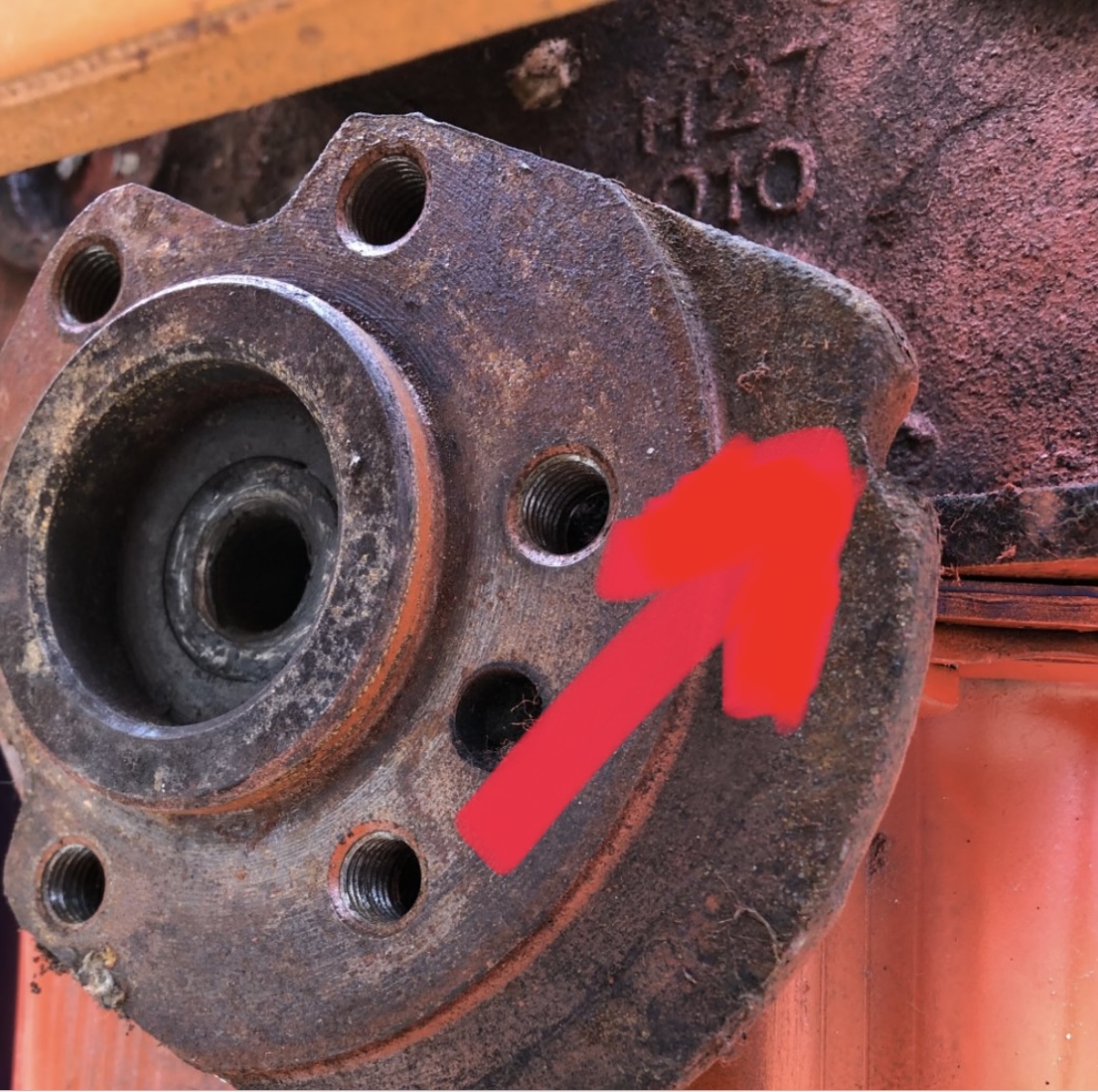

    Here's the hint again...

    010 on both sides of the block.

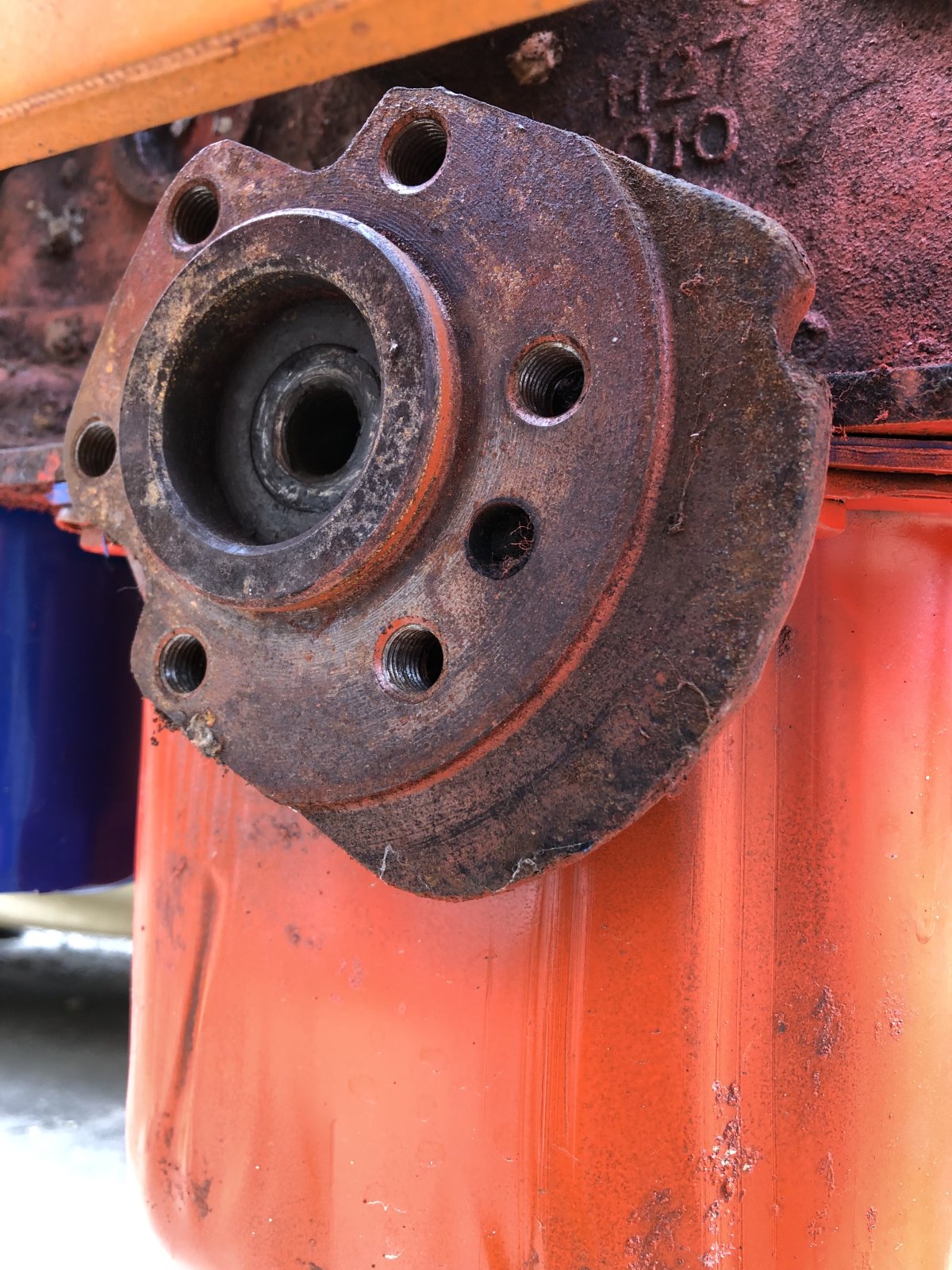

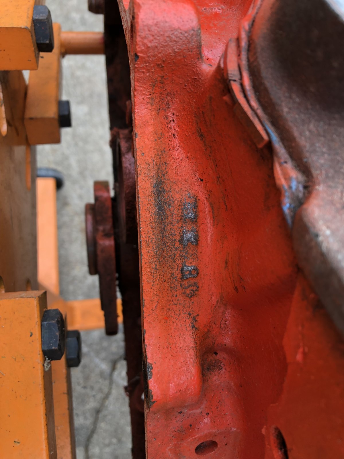

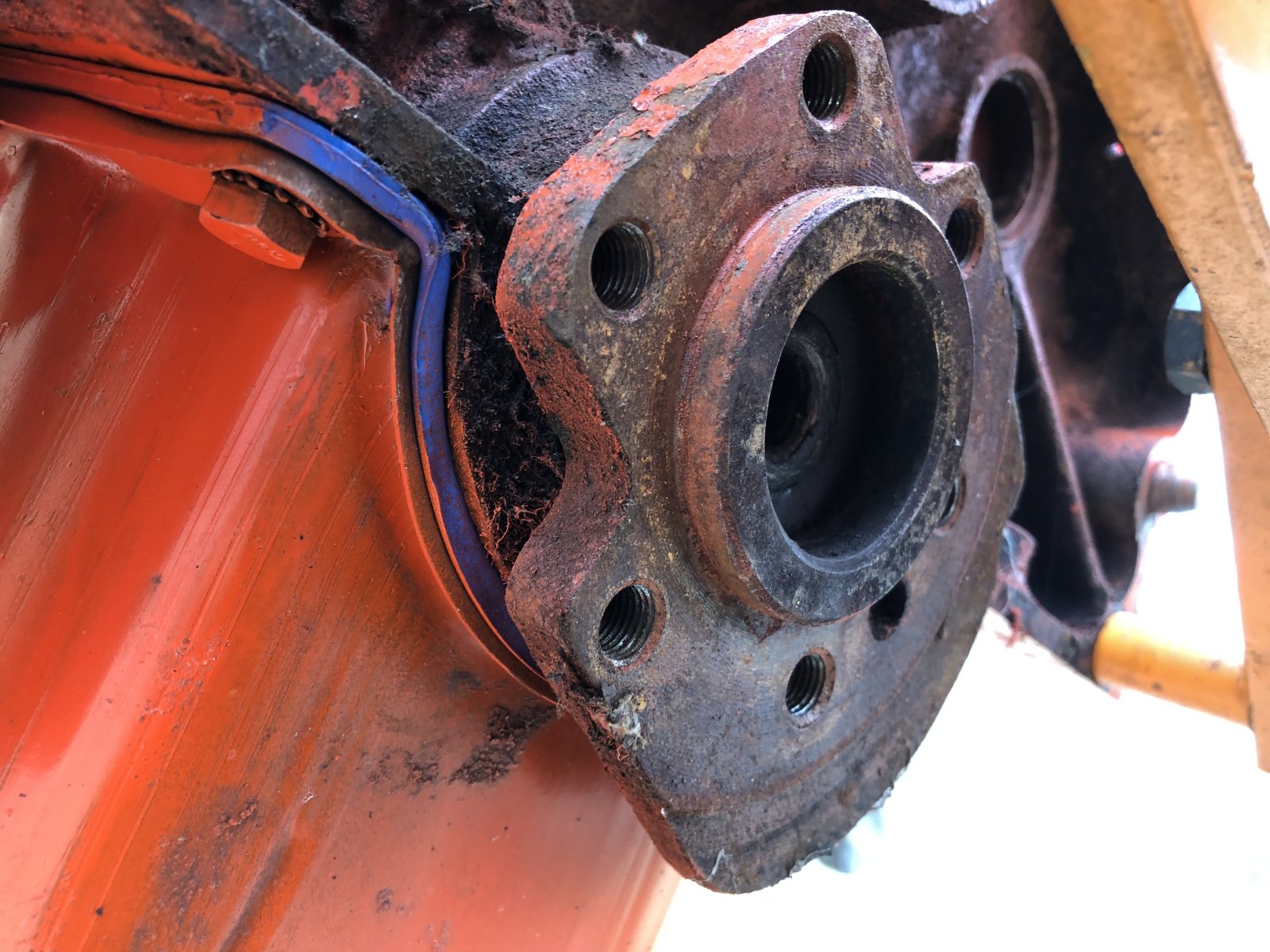

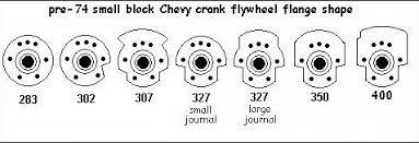

    Looks like a cast iron crank... You can tell by the thin parting line on the flywheel flange...

  14. Deuces
    Joined: Nov 3, 2009
    Posts: 26,973
    Deuces
    Is that a 400 sbc crank???...:confused:
    Duh, just answered my own question...

    010 block casting is 4" bore
    Crank flange is 3.75 stroke
    Manual trans pilot bushing
    Can have stock short 400 rods and stock 350 pistons. I have built several that way.

    1978 truck 350, built June 3rd, 1978. And it's a used engine, not rebuilt.

    I agree with Jim, TDS is 350 truck engine block. Lippy

    that's a 350 crank, isn't it? The 400 is more squared off.

    I agree on it being a 400 crank, that extra little notch in the casting says that.

    Yep, 400 crank. I was pleased as punch when I saw that about an hour ago. The notch is a giveaway, and it's also wider at the end where the notch is.
