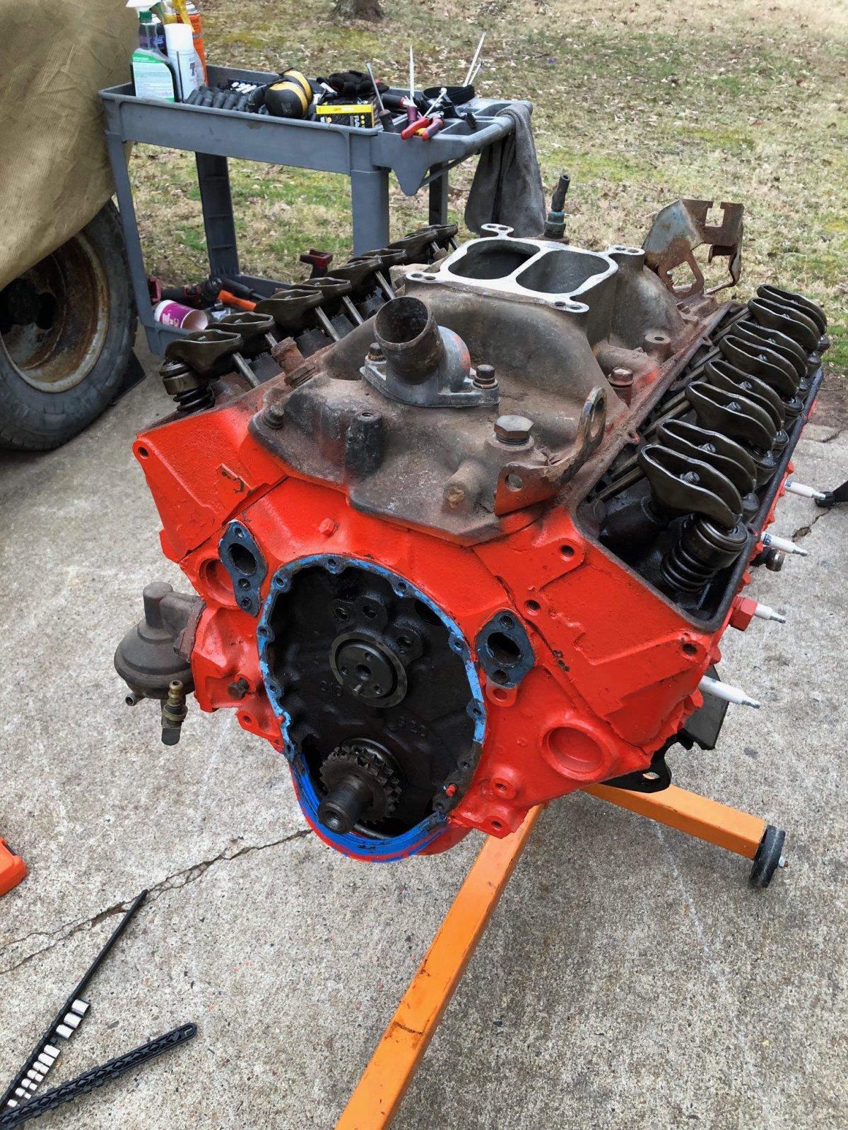

    Heads are 487's (not 487X) - good smog era open chamber heads with 76cc chambers, 1.94/1.50 valves, H141 date code - that's August (H), 14th, 1971. I believe these heads got hardened seats after 1971, but I'm not sure if that's model year or calendar year. Anyway, it appears that these heads are not original to the block, which appears to be a 1978 casting.
    Deuces, winduptoy and guthriesmith like this.

  8. Pull a sparkplug and scope the piston top to get an additional clue on compression. Measure the cam lift, maybe?

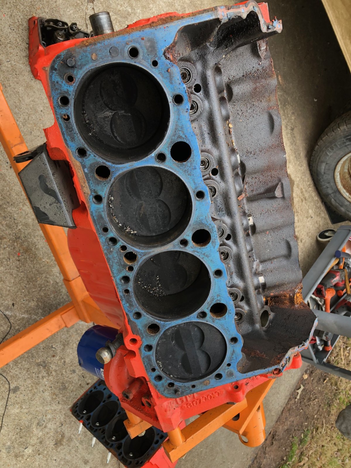

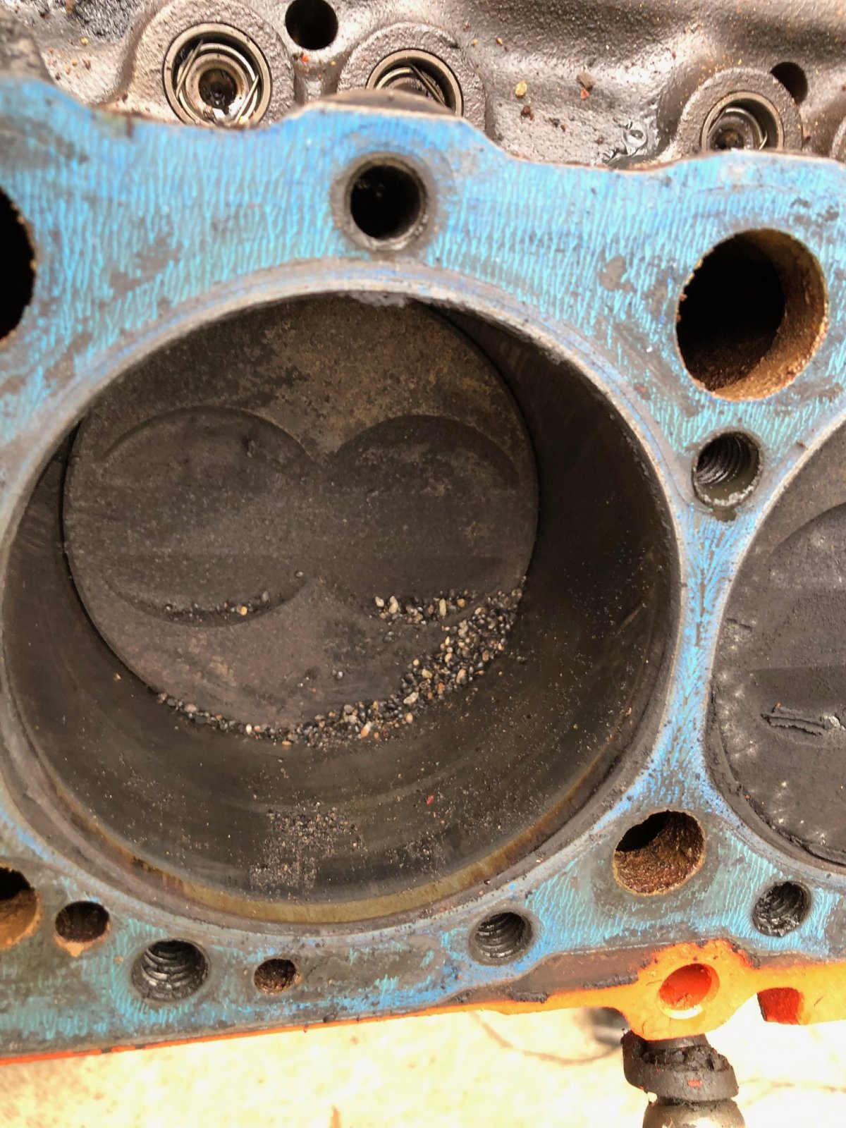

  14. bulletpruf
    Joined: Apr 15, 2012
    Posts: 242
    bulletpruf
    Heads are off. Doesn't look terrible inside, but definitely needs disassembled and cleaned before it's put back together and run.
    Bore is 4.030" so it's been bored .030" at some point. Cylinders don't have a ridge, but not a lot of crosshatch evident.
    I hit the pistons/rings with some Kroil then Marvel Mystery Oil and let it sit for a bit and then turned it over easily.
    guthriesmith, squirrel and Deuces like this.

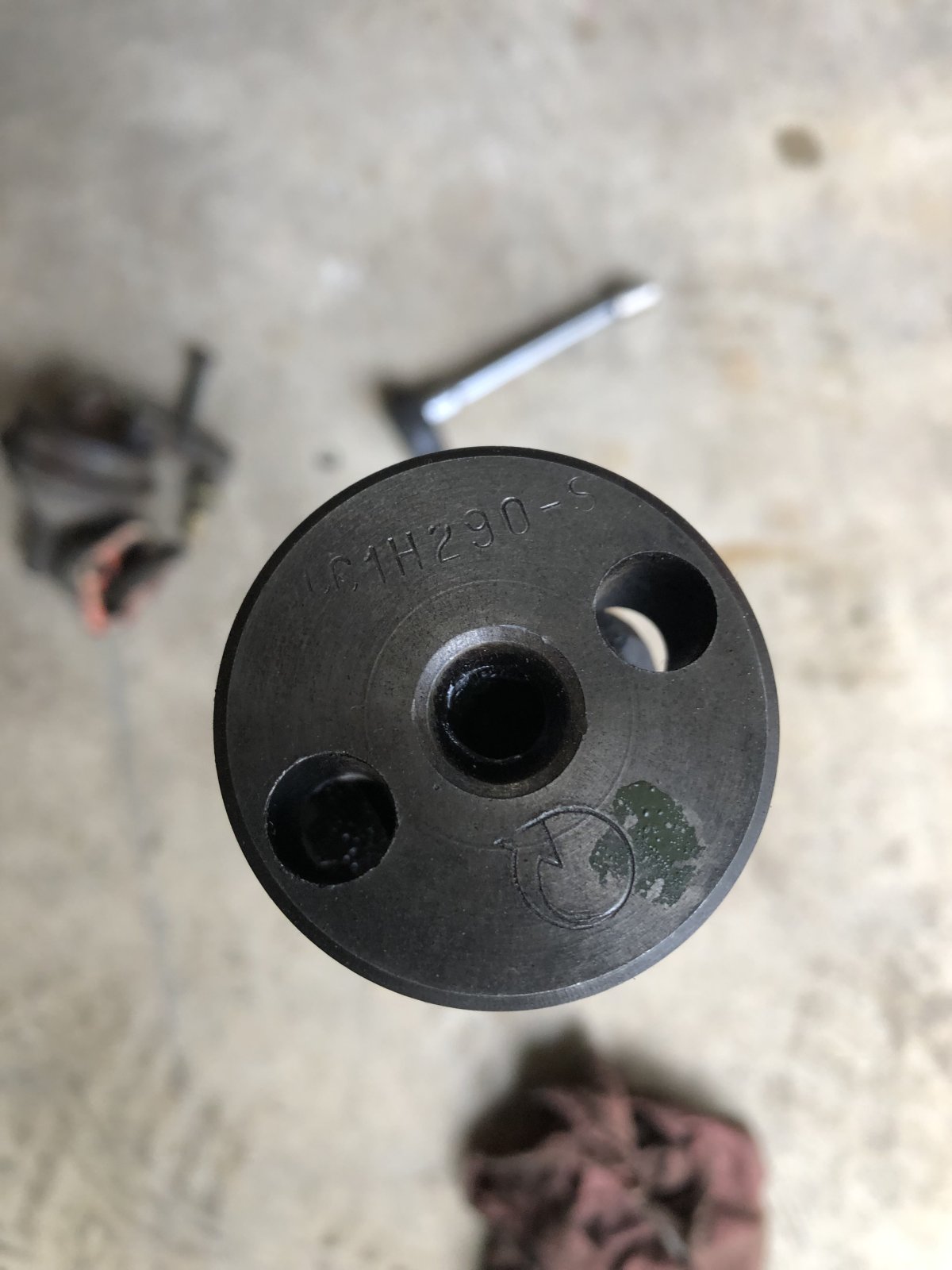

  16. bulletpruf
    Posts: 242
    bulletpruf
    Cam is a flat tappet C1H290-S - pretty sure that's a General Kinetics hydraulic cam, 290/300 advertised, 112'ish LSA, around .450" lift.

  18. 350 truck engines had a fat torque curve down low which made them very flexible for cruising. A cam upgrade could wake them up a little more in the higher RPMs that this one seems to have. It can be a comfortable driver and still very sporty in a lightweight car.

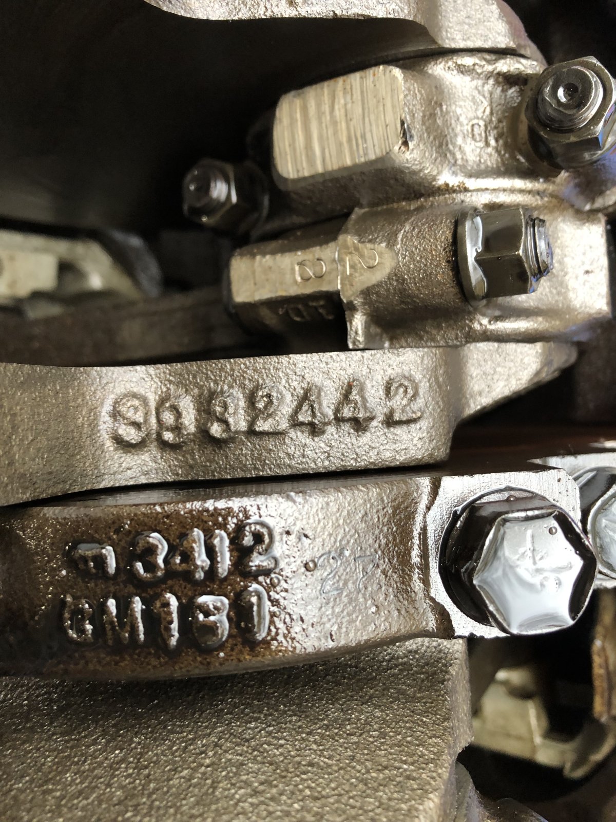

  19. bulletpruf
    Posts: 242
    bulletpruf
    Bottom end looks fine. Crank is a 3932442, confirmed as a 350 crank. Damn. Should have known better than to rely on shape of the crank flange.

  20. squirrel
    Joined: Sep 23, 2004
    Posts: 58,052
    squirrel
    Bores look nice from what we can see, not a whole lot of miles. Looks like you got a good one.
    The crank looks just like I figured. Rods...hmmm....restamped and funky nuts..but they seem to be holding together just fine.
  21. theHIGHLANDER
    Joined: Jun 3, 2005
    Posts: 10,408
    theHIGHLANDER
    I'd keep that cam. Seems a step up from what we used to call an "RV cam" so it should be a fun little 3 fiddy.

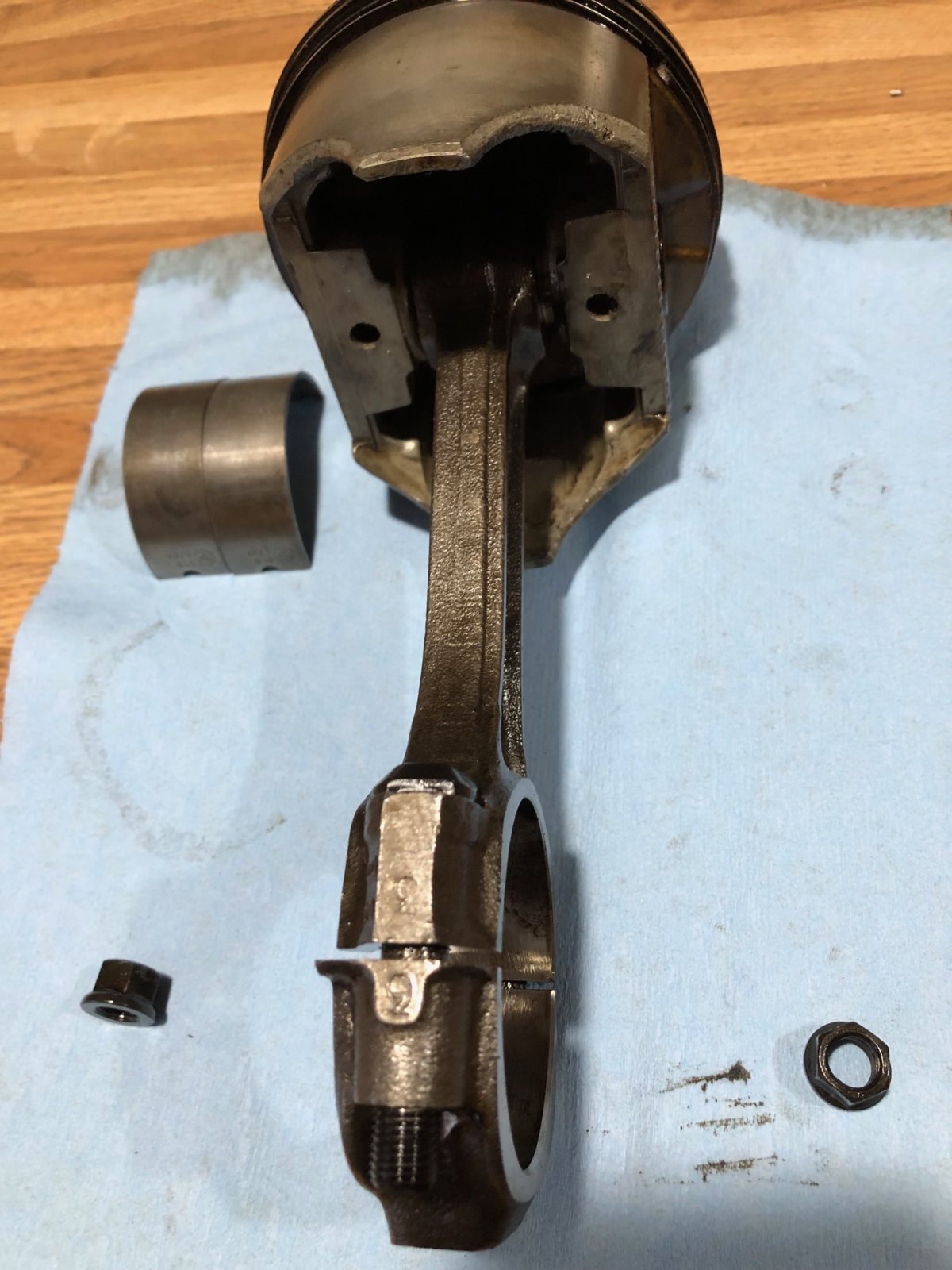

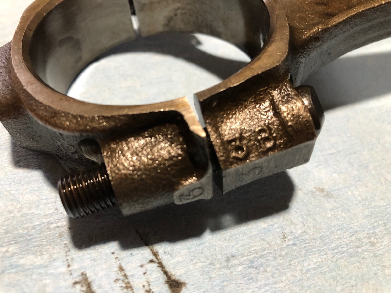

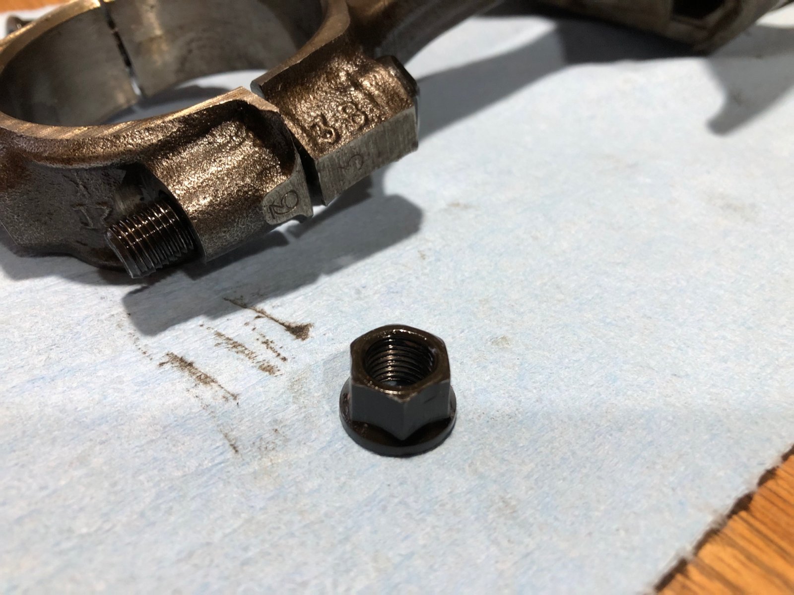

  23. bulletpruf
    Posts: 242
    bulletpruf
    Ok, now I'm confused. Engine was said to have aftermarket rods (Manley?) but I'm not seeing any indication of who manufactured these. There are a few letters and numbers cast into the rods, including a GHK. The rod bolts also appear to be aftermarket.
    Any ideas?

  24. bulletpruf
    Posts: 242
    bulletpruf
    I think it's GMK, not GHK. Factory rods with aftermarket bolts.
