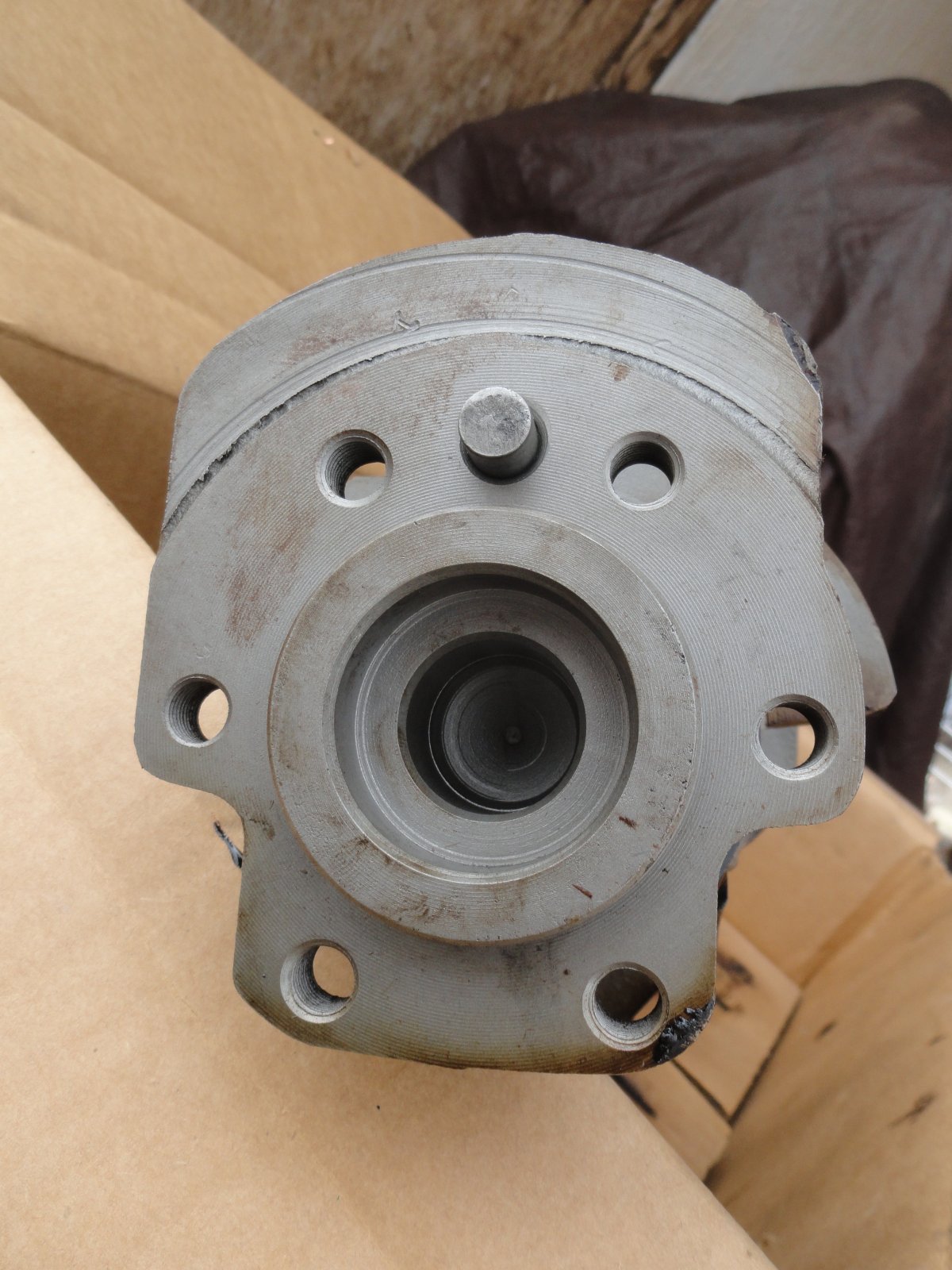

    Jeff Osstyn
    400 chevy crank flange
    Deuces, bulletpruf and Desoto291Hemi like this.

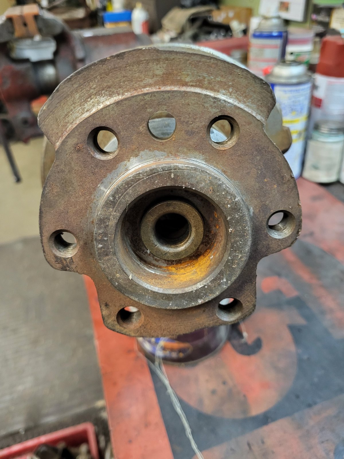

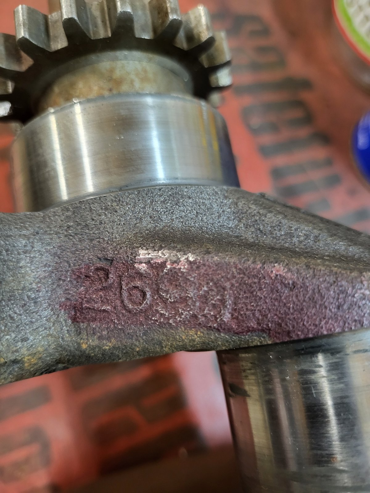

  27. Here's one I ended up with that thru me. 350 stroke, 307 flange. Seems to be '67 only. 2690 forging. Gene. Resized_20230223_181700.jpeg Resized_20230223_181751.jpeg
    bulletpruf and Deuces like this.
