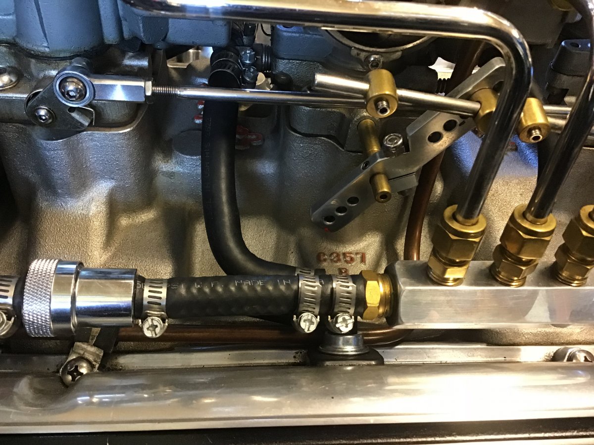

    These OMC valve covers are corvette valve covers with out the corvette letters in the center section . I hid the pcv along the intake side of the valve cover. There is a baffle on the inside of the valve cover and it works like it should.
