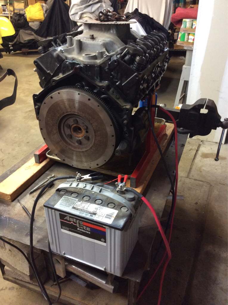

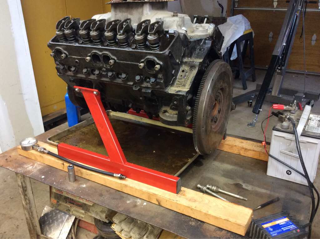

    Hello all , I have a 69 sbc that has been sitting 30 years inside ..
    It's stock with a small cam ..
    I had it up side down and oiled up all the journals ..and have been turning it over by hand .
    So I put the fly wheel on and starter to do a compression test .
    The passenger side is high over 215 to 240 was the highest .
    the driver side was lower 170 to 200 ..
    I'm not sure what's going on lol a any help would be great !!!!
    ImageUploadedByH.A.M.B.1412645055.305268.jpg ImageUploadedByH.A.M.B.1412645106.109073.jpg
    kidcampbell71 likes this.
  2. Did you have that plate bolted over the intake when you did the comp test?

  5. Don't mean to sound critical, but I don't see an oil filter which leads me to believe that all the cranking for the compression test is pretty much dry. Also, in order to get compression you have to suck air in somewhere and it looks like the intake is blocked. Straighten me out if I'm wrong.

    Did you oil the bores. Maybe engine was tilted to one side and got more oil when you put it on the journals. Squirt oil equally in the holes, rotate it and try again.

    Either break it down and inspect the entire thing, or put a pump, pickup, pan and filter on it, and prime it. Then put in a distributor before trying again.
    You are going to wipe the bearings doing this.
    And no plate or carburetor on the manifold when you do this. How do you expect that the air is going to get in there to compress?

    Thanks everyone , yes I had the plate on there when I turned it over ...Dooow !
    it had a larger cam last time it ran then took out of the car to put a smaller cam work was done and never made it back to the car .
    i turned it over minimum , an squirted oil down the push rods when i did , im a Newbe so taking apart might be above my skills without help ..
    yes i oiled everything when it was upside down could be one side got more ...I wanted to do it dry then if something was up i was going to put oil through the spark plug hole but didnt get that far ..
    I didnt want to spin it too much .
    and yes the oil pan and filter were not on , friend said it might be ok to do ?
    sounds like its not ..
