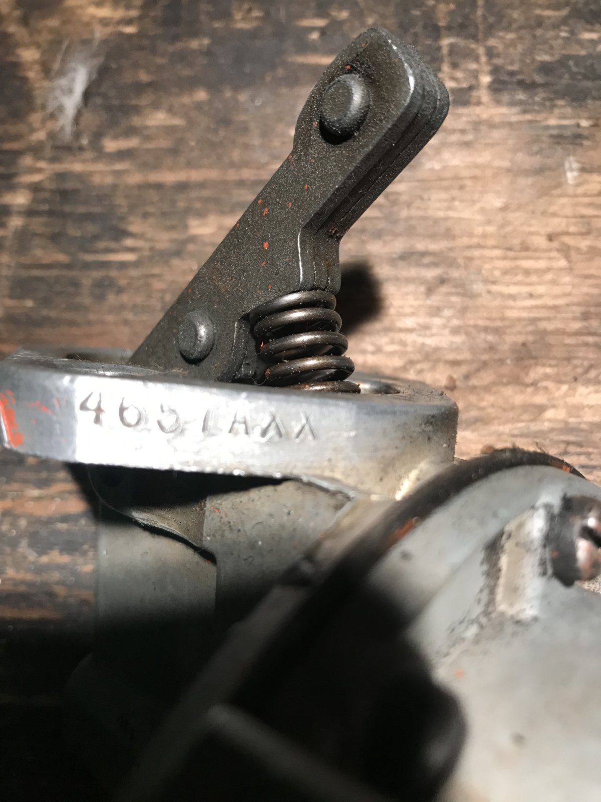

    Here’s a picture of the fuel pump numbers .
    I was able to find rebuild kit on the web so it’s seat and wait for mail man .

    If we saw the whole fuel pump, perhaps we could figure out what application it's for, and help you find a replacement...if the rebuild kit doesn't work out for some reason....
    Desoto291Hemi likes this.
