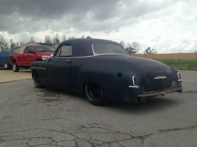

    Here's a pic of my 50 Dodge heap and Harry's 48 Plymouth
