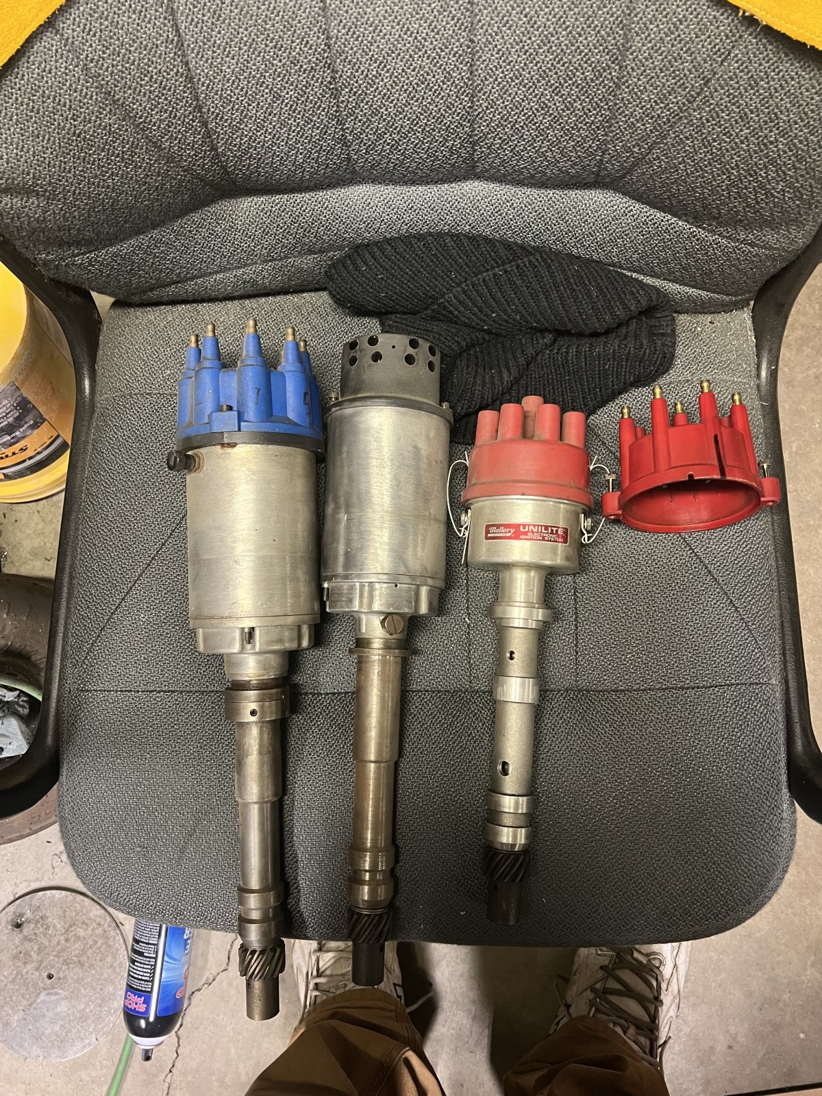

  7. Here’s the difference between early and later sbc points caps

    Msd 85701 for sbc/bbc is smallest round cap made , smaller round then Vertex Mag , unless you make your own , distributor top with cap witch requires cutting off above clamp welding & fabrication thinking outside the box,!!!!!
    There is a small 2 wire china knock off for $50ish The module that is in the blue circle can be cut off and relocated wherever you want by extending the wires, MSD $400
    Just cap on right is cap for 85701 MSD
