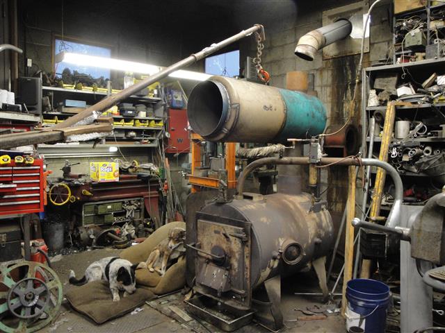

    Here's my wood stove. Bigger than it looks, stove is about 150 gallons. Was building a new stack robber in this picture. Had a waste oil drip with fan forced air at that time, didn't work too well. Shop is 30 x 50, concrete blocks, mostly below ground with 2 inches of sprayed on urethane foam on the outside. Been a good place to work since 1981.

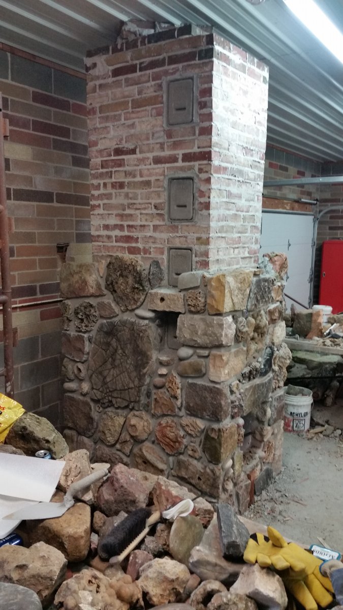

    Here's his masonry wood stove.
    He just builds one hot fire and lets the heat radiate off of it.
    You don't want to leave your hand on the clean out caps when its up to temp,
