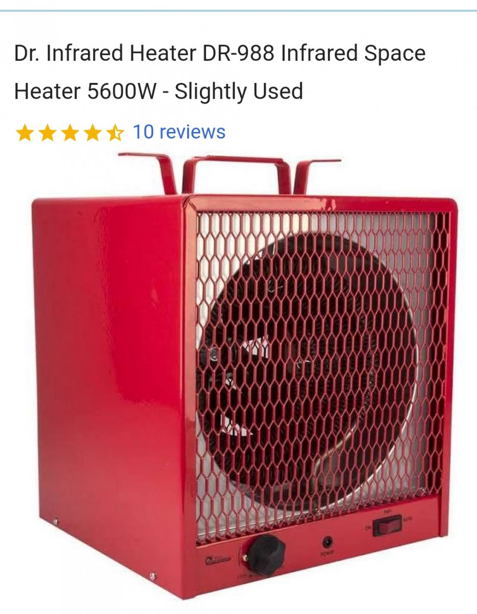

    It's March now, and I getting towards the end of my unintentional winter stay in Minnesota. My shop is 40X30 with 14 ft ceilings and is insulated. I don't have permanent heat in it so I had to improvise. I do have a 70,000 BTU propane heater on the wall for fall and spring use, but that doesn't quite cut it. What saved my bacon this winter was a 5800 (17000 BTU) watt electric heater that I could plug into my welder outlet and let run. It kept the shop above freezing all winter (remember, I'm in North Central Minnesota), and when I wanted to work, I'd turn it up and fire up the propane unit. There was not a day I couldn't get it up to a reasonable temperature.
    Since this is a thread about small garages and auxiliary heat, I submit that this is the winner. If I had an insulated two car garage with 220 service, this would be all I'd need. Since it is an infrared heater (it move large volumes of warm air instead of small volumes of very hot air), it is about as safe as it can get. I bought a 30 ft welder extension cable that allows me to move it around to where I need it. Both the heater and the cable were about $100, the cable a bit more. Strongly recommended.

  20. continentaljohn
    Joined: Jul 24, 2002
    Posts: 5,867
    continentaljohn
    I believe insulation is much more important then a heat source and money should be spent on R-value vapor sealing the air space. I had the same 5500watt heater in my old garage and couldn't keep up with the cold drafts and never really got warm. We foamed the garage and now a 1500watt heater is Too Much for it I know it's crazy what insulation will do.
    I use this heater DR-988 dr inferred when it's below freezing and keeps the garage at 65-70. I use a 1500 watt heater when it's a but warmer and is only 110v in my 25x34 garage ..

  23. bobss396
    Joined: Aug 27, 2008
    Posts: 18,739
    bobss396
    Genius to wire the heater to use the same plug as the welder, so I have to kill the heat if I want to fire up the Lincoln. I'm doing my garage over and this looks like a good safe heater. My buddy has a similar one in his garage, but his place is well insulated.
    Bowtie Coupe likes this.

  25. NashRodMan
    Joined: Jul 8, 2004
    Posts: 1,989
    NashRodMan
    I just looked at these an Amazon and saw this note...."Requires a 220V plug in and not for general residential or household use, cannot be mounted on the ceiling"
    Why cant you mount it on the ceiling???

  27. indyjps
    Joined: Feb 21, 2007
    Posts: 5,396
    indyjps
    I dont see any reason you couldnt, likely liability disclaimer. You get a 4 ft warm zone around it, until it heats the area up. For the price and ease of use, it works well. If you need to heat a large garage or maintain temp for long periods, theres better options.
    I run it off my welder 220 plug, may need the end swapped to match your outlet.
