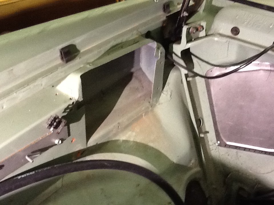

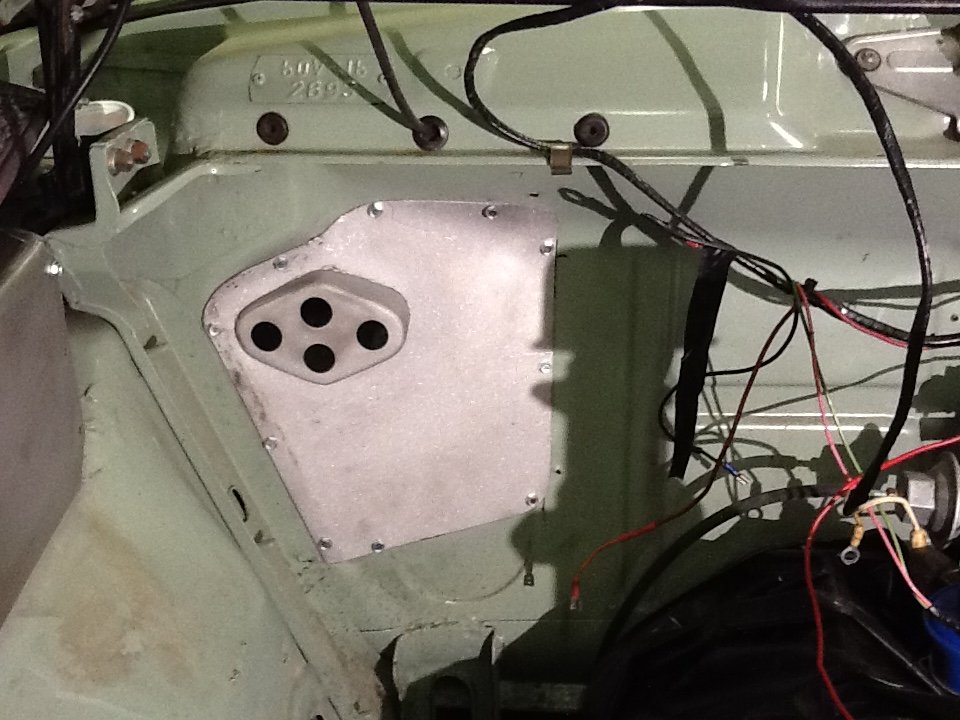

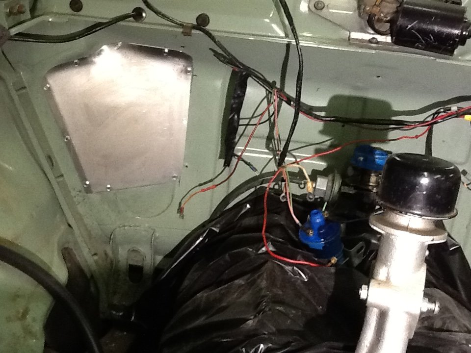

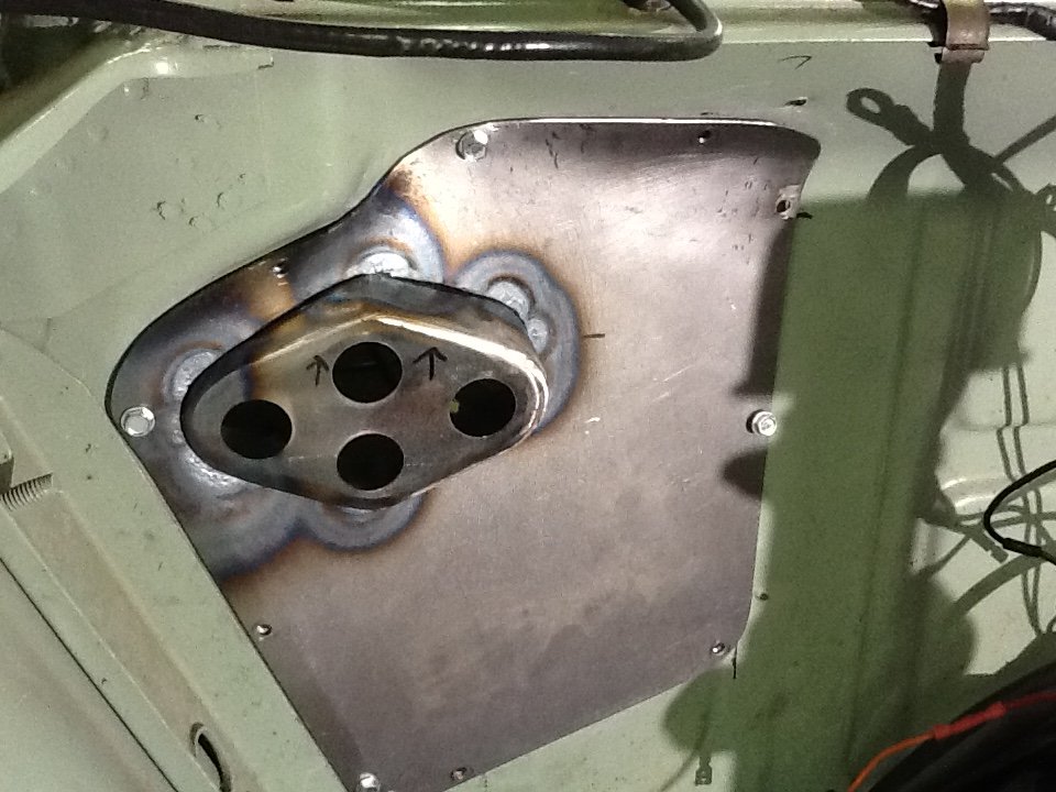

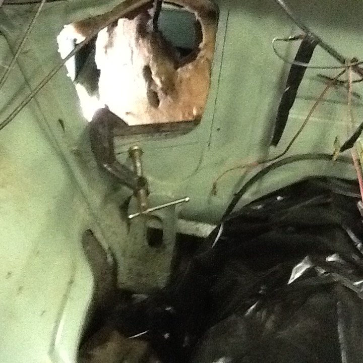

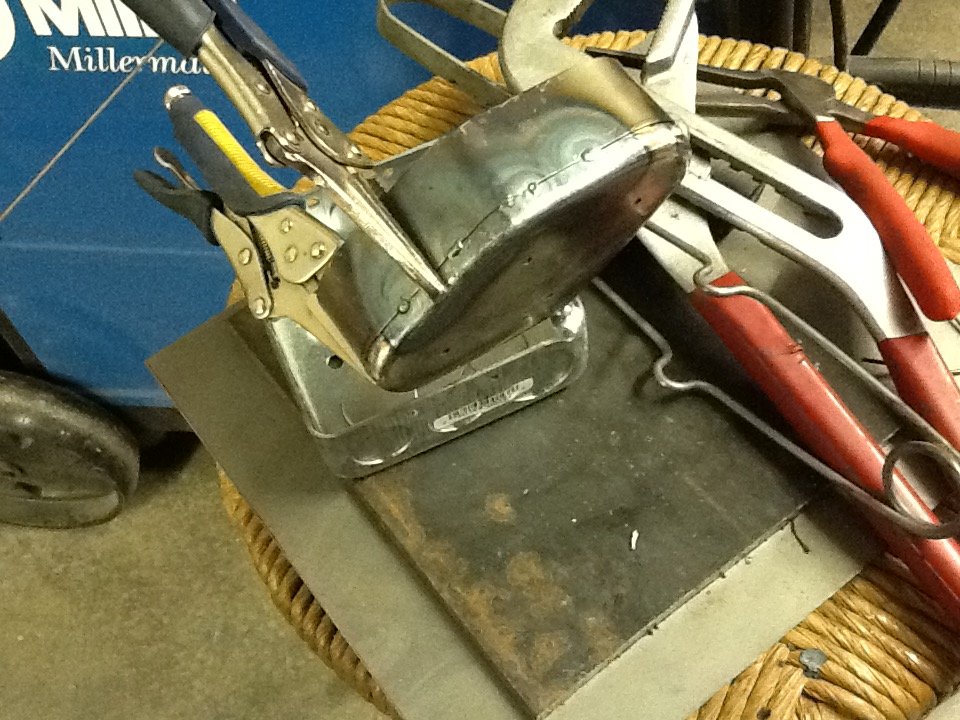

    image.jpeg image.jpeg image.jpeg image.jpeg image.jpeg image.jpeg image.jpeg image.jpeg image.jpeg image.jpeg Having just posted on a thread about A/C, it prompted me to think about a little part I made this week to facilitate an A/C install in my '60 Studebaker Lark.

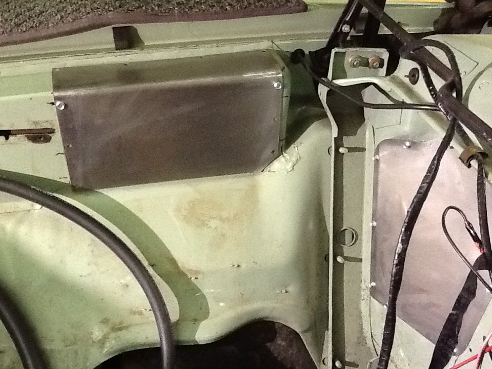

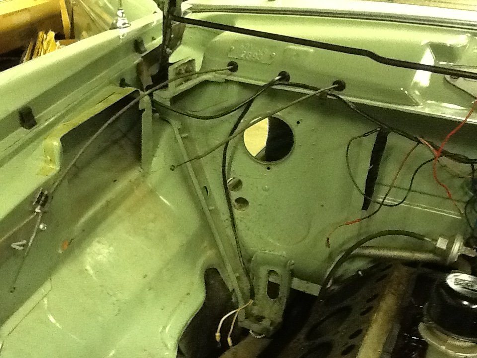

    The Stude had a period underdash 'box' that was well past functional and the original heater core was leaking and bypassed. The Stude heater unit is in the right fender well and hot air is piped from it through the firewall. You will see from the photos that follow that the firewall had several holes that were not needed. I cut out a section and made a cover plate.

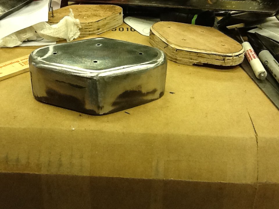

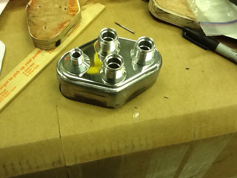

    But the firewall contour in that area angles rearward in the horizontal plane and is not quite perpendicular in the vertical plane either. That meant the bulkhead fittings/hoses would come through the firewall at an unsatisfactory angle. So, I decided to make a mount for the bulkhead fitting that corrected that problem. It was made from 19ga AKDQ steel and hammer formed over a buck made from a piece of plywood I had in the shop.
    When the firewall plate is installed permanently, the sheet metal screws will be replaced by small carriage head bolts that look like rivets. On a total build I would weld in the plate, but for this job that would be beyond necessary.

  2. Nice workmanship. Looks like it came that way from the factory.

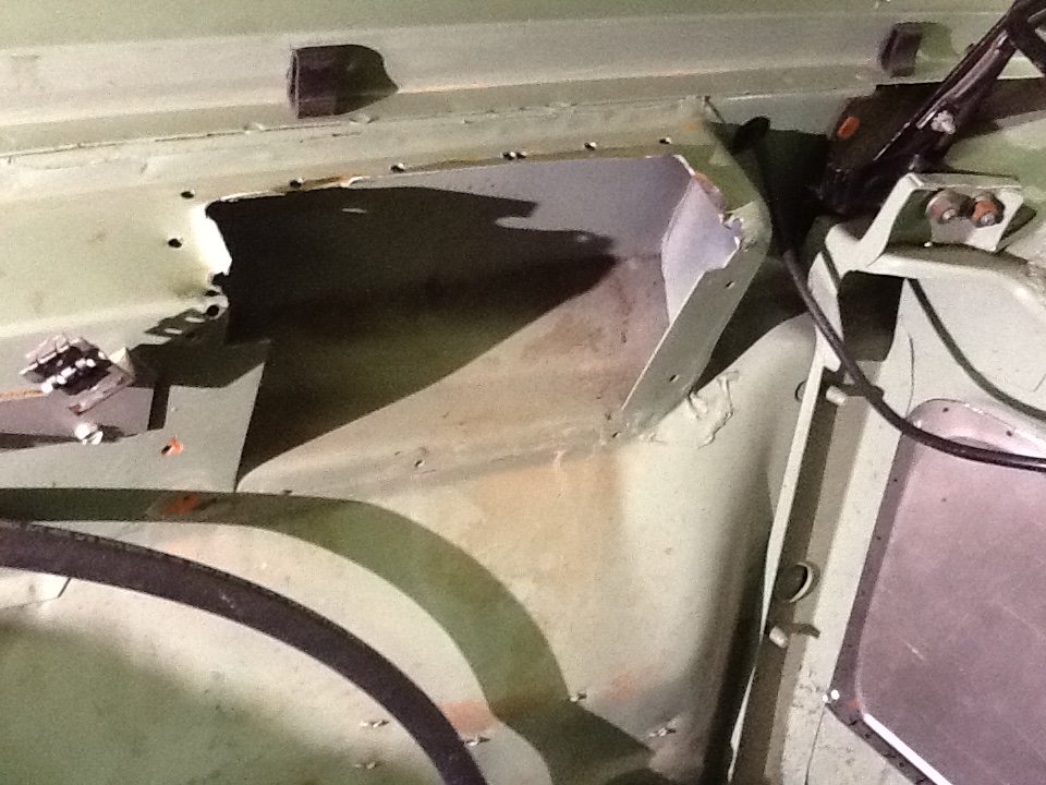

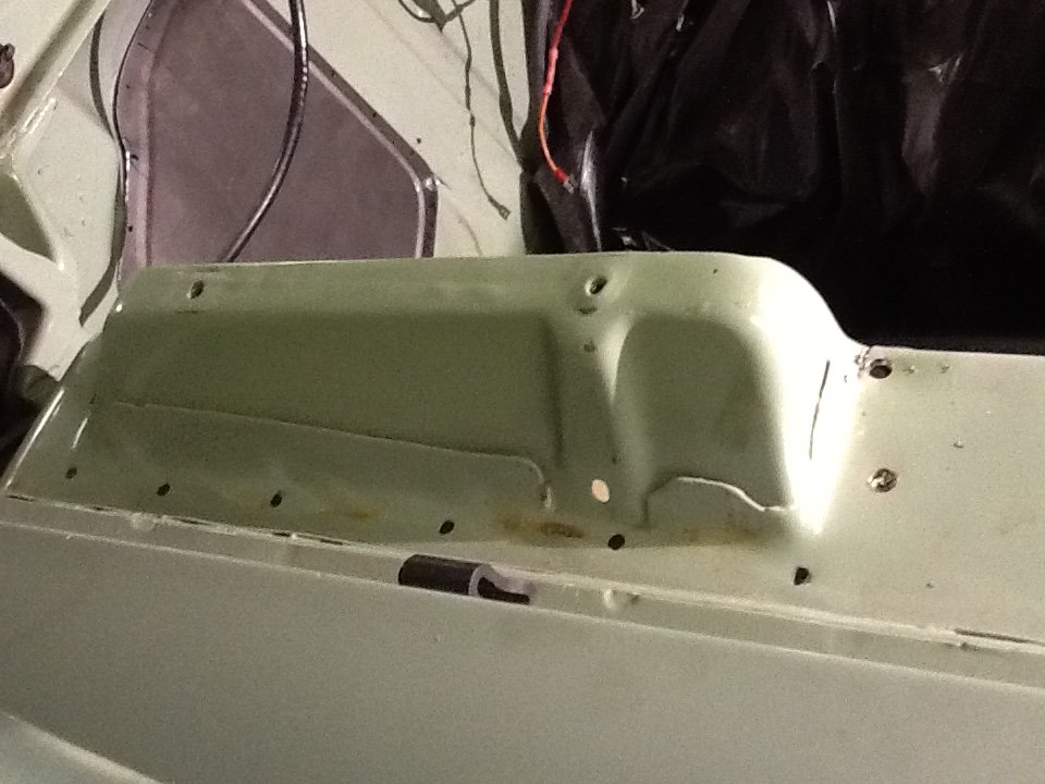

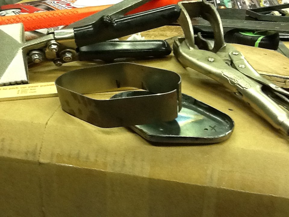

    Also made a cover plate for the cavity where the heater core had been located. It is a fresh air plenum fed from an inlet next to the headlight. Later, I think I will rework this area into a low buck "ram air" supply to the Stude....may not help much, but can't hurt either.
    The original heater mount was bulky and intrusive so I first removed the lumps, then made a simple cover. The rear portion does have a different radius on the bend and a slight compound curve.
    Ray

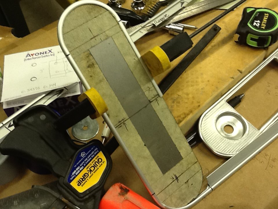

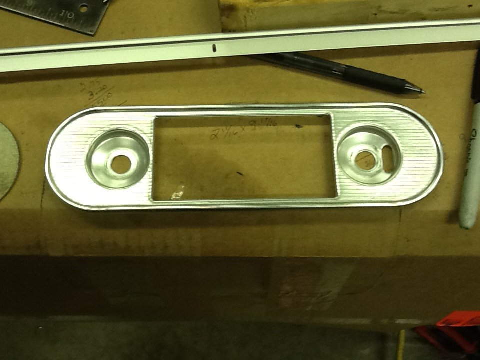

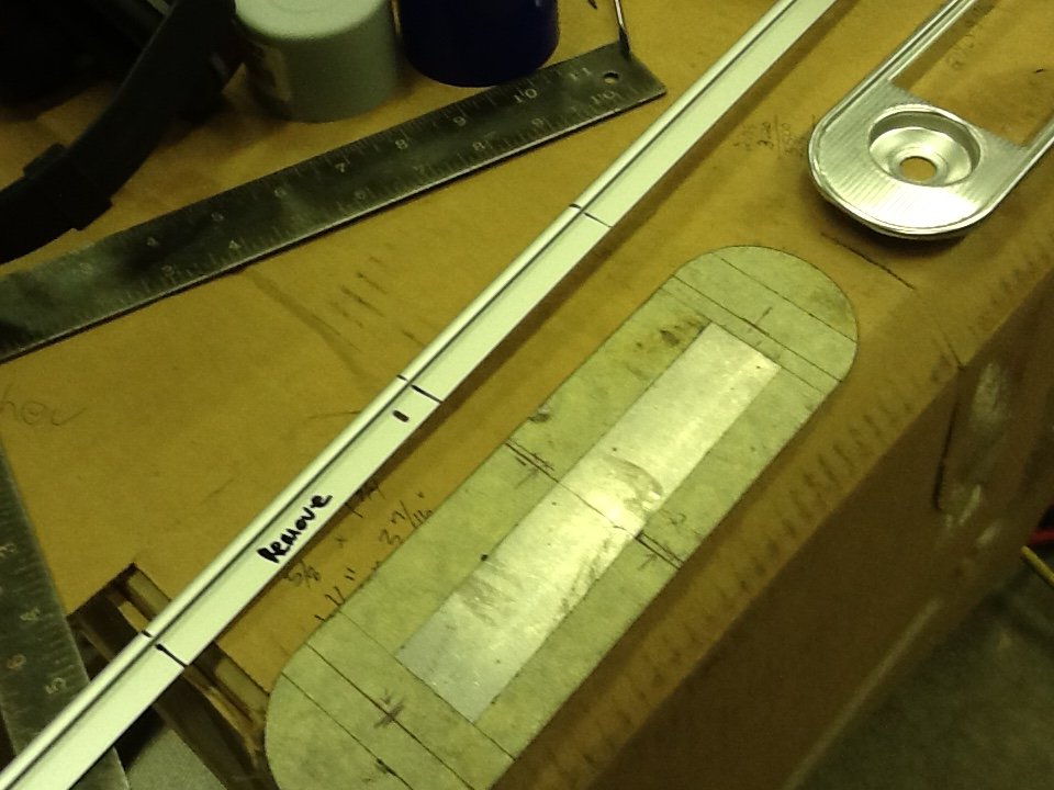

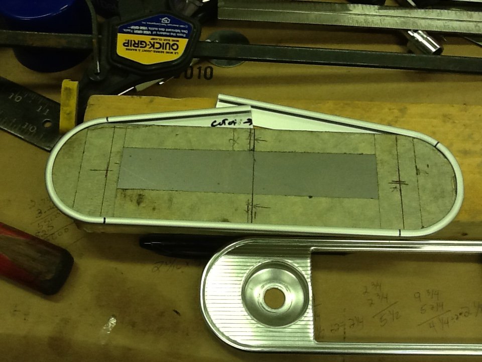

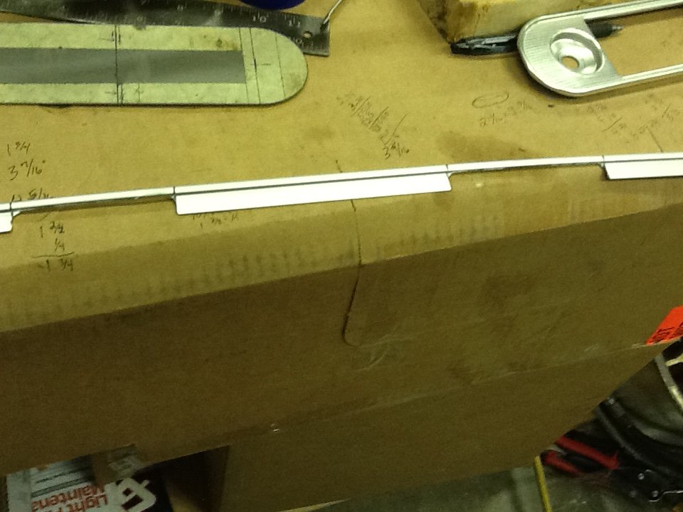

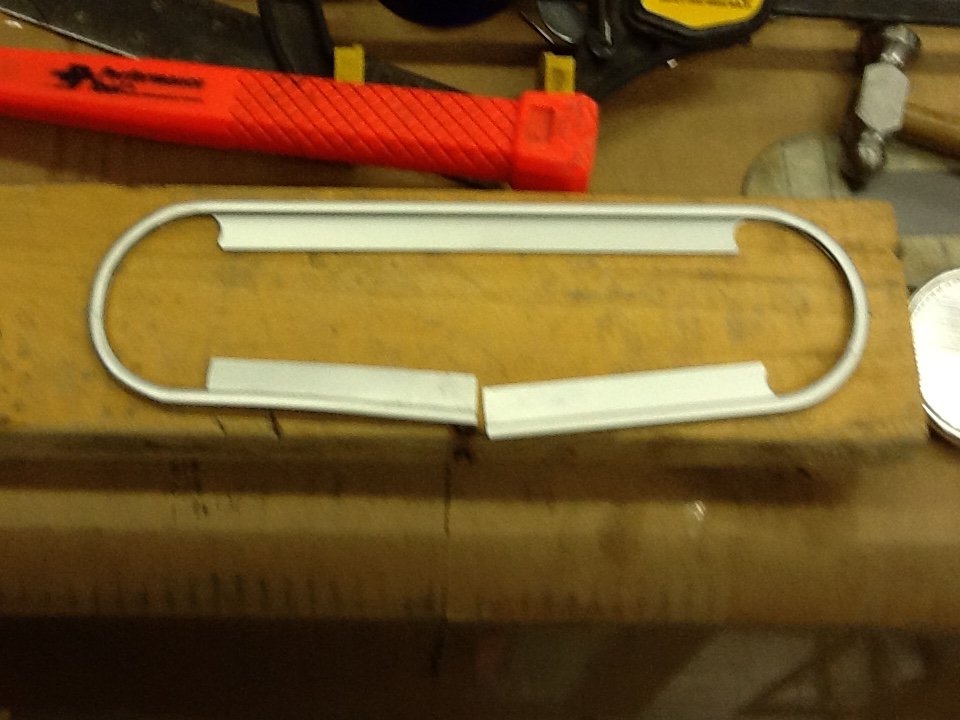

    image.jpeg image.jpeg image.jpeg image.jpeg image.jpeg image.jpeg image.jpeg Next up.......installing the A/C unit in the dash was a tight fit and the best location for the center outlet was the radio mount area. The existing radio faceplate wasn't useful as is, but I wanted to maintain an appearance closer to original than just a smooth faceplate. Studebaker in this era, like AMC, used inexpensive aluminum stampings for trim bits.
    Being a pack rat, I remembered having saved some aluminum cabinet pieces from an obsolete piece of shop equipment. Those panels have a stamped/embossed surface very similar to the original Studie part. Also, I had squirreled away some aluminum edging strips. Combining the two materials is producing a 'sort of' original appearance face plate.
    As you will see in the photos, I made a 16ga steel pattern around which to form the the perimeter from the edging strips. It required removing much of flange in the area of the tight radius ends, but no matter, as the remaining slot will contain the faceplate nicely.
    The new faceplate will contain the A/C outlet and be flanked by the mode and blower switches, mimicking the original radio layout. Temp controls will be located elsewhere in easy reach.

    Worked on the faceplate for the center A/C vent some more today. Ended up remaking the insert as I discovered a measurement error in the vent cutout location.
    Made the new insert and attached the surround permanently with some small aircraft aluminum rivets. The holes are drilled for the switches, but they are not installed yet because the insert plate is grooved and the 'function' decals will not lay nicely on that surface. So, I am going to find or make a couple of thin "washer" like discs to be held on by the switch retaining nut onto which the decals can be applied.
