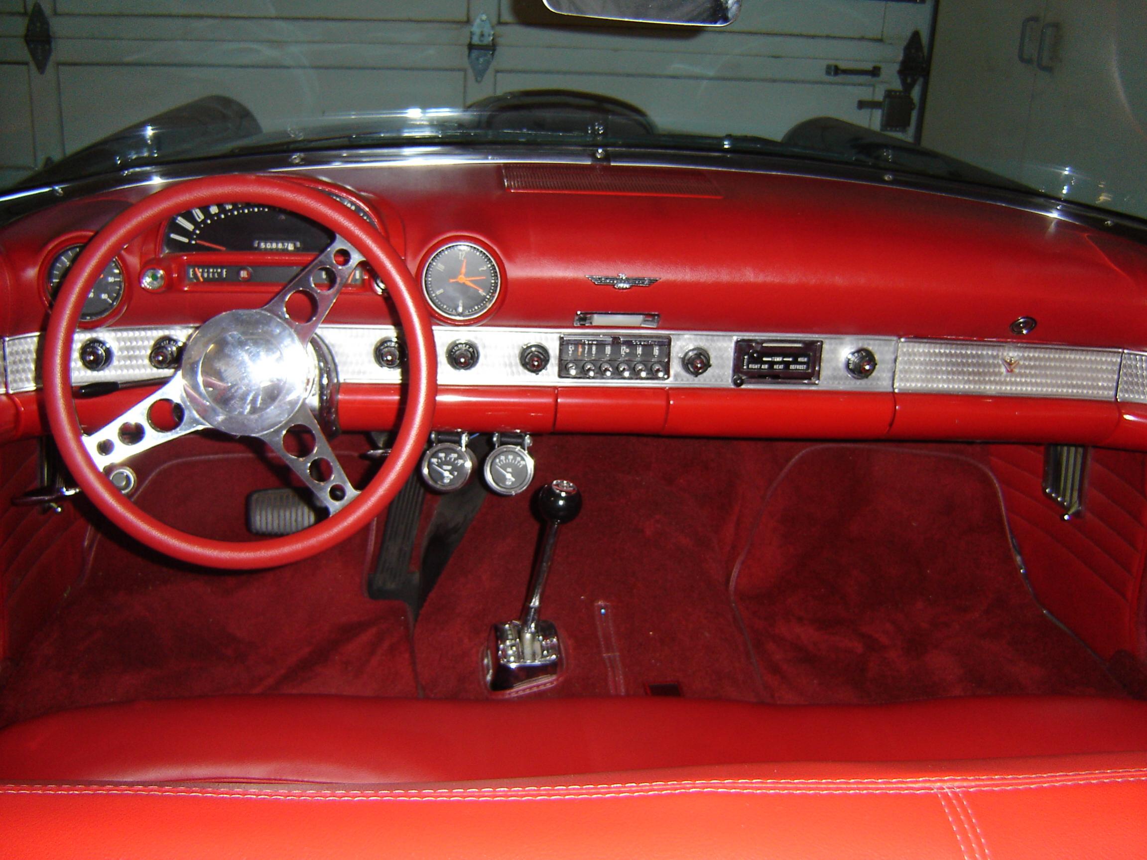

  3. Here's the only picture I have handy of my '56 (pre-clean up):
    They are a little smaller than a factory passenger car wheel also...

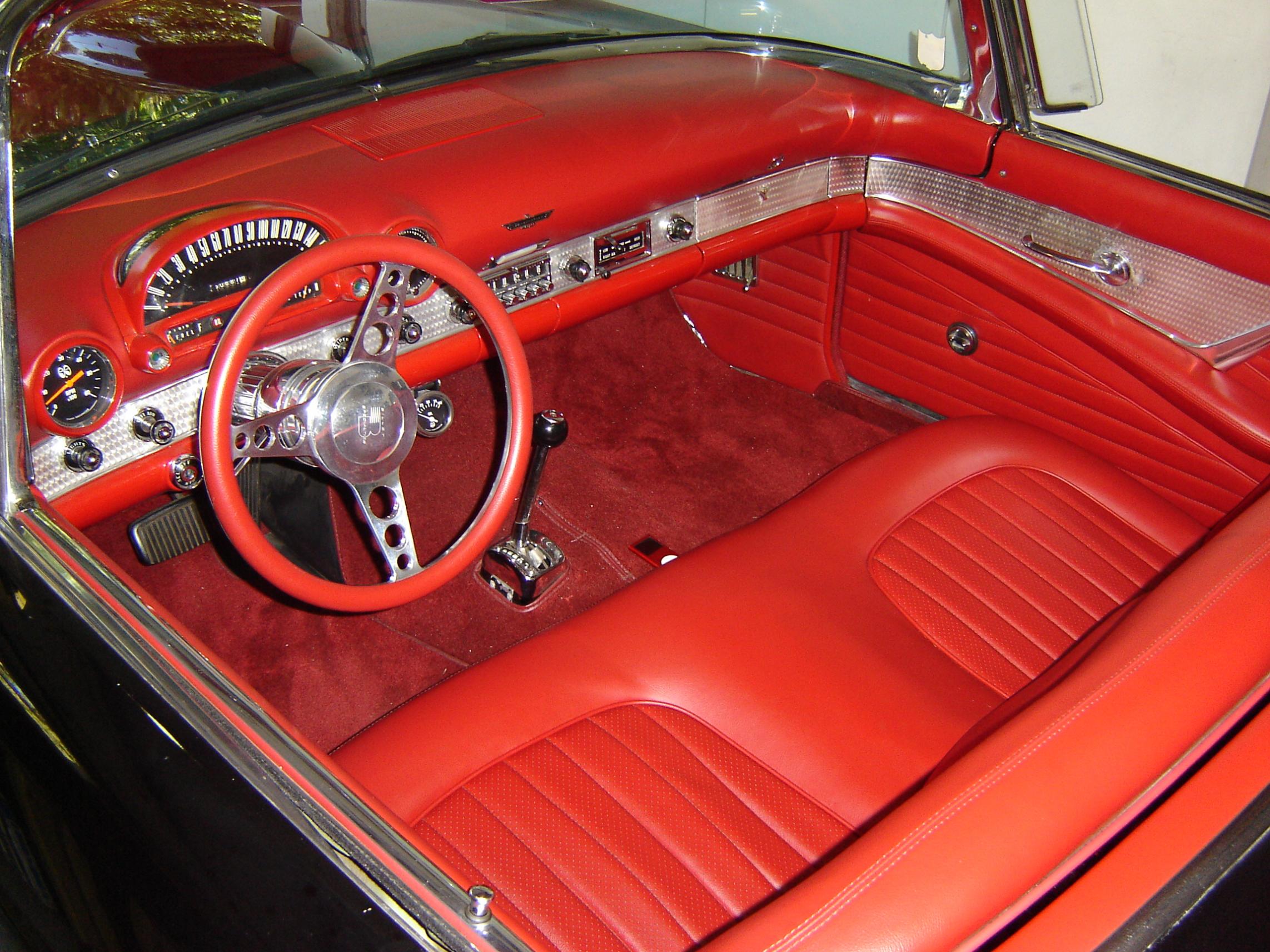

  4. I want to eventually get a wheel like M_S has on his '56. Pricey, but it has the right look:

    I don't know the diameter of the '55, but the '56 can't be much smaller. Even with the seat all the way back it almost rubs.
    You can use any of the later aftermarket wheels with the LeCarra/Billet Specialties bolt pattern, but LeCarra is the only company I know of that makes an adapter. Mine fits great and the telescope still works. I chopped about 1-1.5" off of my turn signal lever and re-tapped it so it fit the smaller wheel better.
