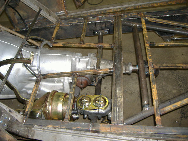

    I got the booster, brake pedal, and master cylinder. For a little over $200.00 The booster is a dual style about 7 inches around. Or they have a single booster that is a little smaller if you like. I believe the company name is gearhead industries out of iowa. They advertise the setup as a 32 ford style, but it is mostly universal and mounts under the floor board...ghost

  10. Be careful if you mount any booster under the floor on a Merc. I had mine mounted there for a while and it hung down below the frame. I got close to tearing off more than once. You could also use the right angle pedal and booster setup and mount all of that under the dash.

    If you are going to run a serious drop in your ride, just make sure that if you do use a floor mounted booster (which is the most straightforward to install), there are plenty of other things that will hit the road besides the booster housing, or you will tear the thing off (seen it before on a psycho-bagged 47 ford).

    Don't need plenty of other things to hit the road. Just have to fabricate a bash or skid plate under the booster as I did even before I took it on the road.:)

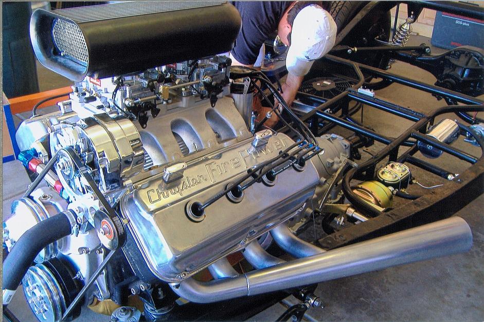

    The smallest and cheapest would be a factory Mercury Hydroboost setup that was found on the boats of the seventies. Cheap and made for a Mercury and they work great.
    Here's what it looks like in an old Bronco, pretty compact unit-
    Here's a pretty good writeup on the install-
