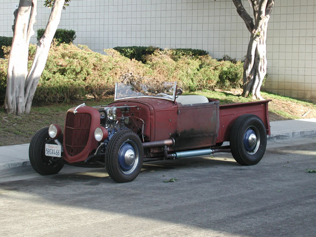

    The little mufflers I have on my truck with a 59ab sound awesome.......sorry, I dont know who made them. If you are interested I can dig out the guys contact info for you and you can order a set.

    YEP I have heard Muttley's flathead pickup and it couldn't sound better. Plenty Loud with awesome tone. I think they are resonators.
    For a stock flatty use 2" exhaust.
