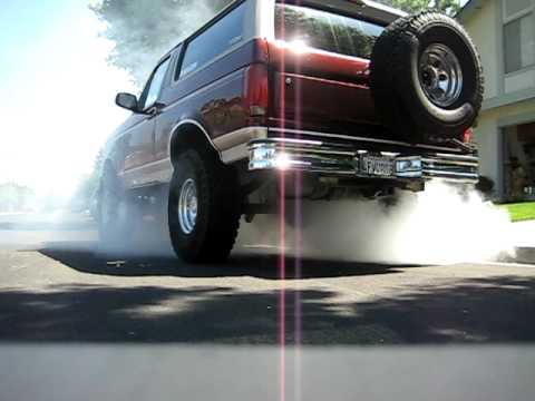

    Man, it's hard to help you diagnose anything when we're not getting a complete picture. And then your "drive it til it breaks" comment makes us think you're not going to bother fixing any problems that get identified. Spend an hour with it in the driveway and tell us:
    - at this point, is it still smoking?
    - what is the oil level?
    - what is the coolant level?
    - what do all 8 spark plugs look like? (and refer to them by "#1, #2", etc)
    - what is the cylinder pressure reading for all 8?
    - do you still have Seafoam in the tank? (it burns white, like this)

  7. Before you panic too much....
    Seafoam at high doses WILL produce white smoke exhaust with no lasting harmful effects.
    You could hook up the engine to a no-additive fuel source and see if the white smoke goes away.
    The very first time I high-dosed a motorcycle with sea foam, I thought I ruined it.
    Then I discovered it's just the natural color of the exhaust from a high concentration of additive.
    Don't panic yet :)
