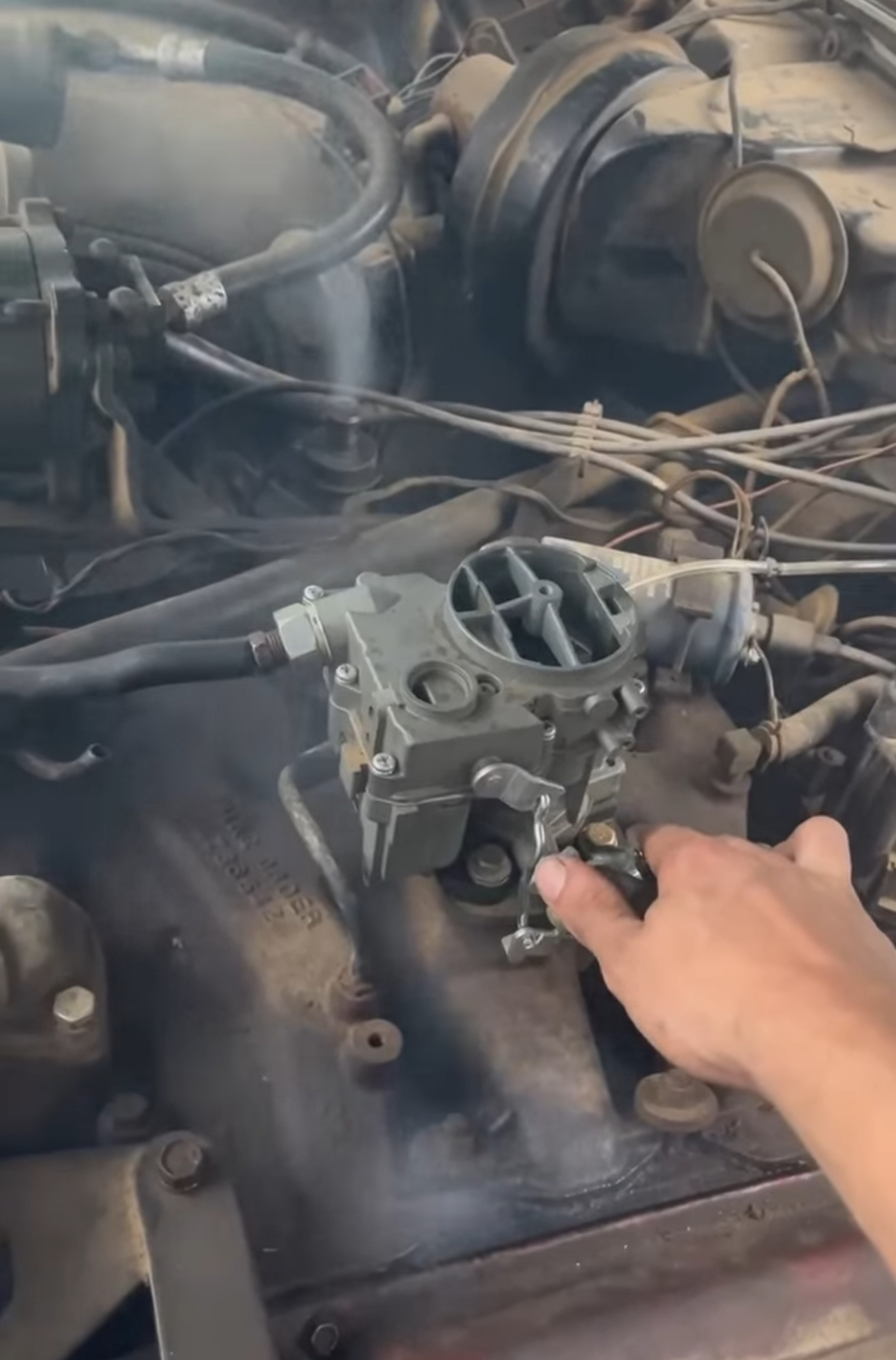

    Well, I’m glad I searched for this thread. I’ve got my eye on a running 394 Olds engine that smokes like crazy out of the valve covers. I had always thought it was the other way around, that the valve seals caused the pressure in the valve covers and bad rings sent oil out the tailpipe. That’s what I thought for many years so how about a little more discussion on this Here’s a photo, but it’s pretty hard to actually get a good shot of the smoke coming out of each side IMG_2175.jpeg

    OK, cool, this is a complete running Olds. I’ve decided that’s the only way I’m going to buy an engine from now on, even if it needs new rings. I know it’s running, transmission goes forward and reversed and the rear end isn’t burnt out. That’s the way it was done in the olden days. Take a running car and strip out as much as possible

    The area between the valve stem and the valve guide is VERY small, and would have to be severely worn in order for the valve seals to be the cause of smoke/vapor coming out of the valve covers. The "path" of smoke/vapor from the valve covers is the many different openings in the head that are exposed to crankcase pressure. These openings are the pushrod holes, oil drain back holes, etc. Bad compression rings and the accompanying "blow by" is going to be the primary reason for all that fun stuff puffing out of the valve cover vents, oil fill tube breather and road draft tube.
    Rand Man likes this.

    This seems like perfect reason to pull the plugs and get a borescope down the cylinders to check for cylinder wear or possible damage to the top of the pistons.
    If this is a 50 year old engine and hasn't been run frequently or regularly for an extended period it may have some rings sticking in the pistons. Some extended running with a fresh oil change may cure some or most of your problem. Might also add some Marvel Mystery Oil or similar "ring free" additive with the oil change. Rigging up a working PCV system will also make a big improvement.
    Dan Hay and Rand Man like this.

    @Rand Man, even if the guides were loose and had no seals, there is ambient air or vacuum in the intake ports, and exhaust pressure on the exhaust guides. The big pressures are in the combustion chambers pushing the car down the road. It getting past the rings into the interior of the engine is what you are seeing.
    If you think about very early engines or large powerplants, they have exposed valvetrains, but the crankcase is sealed. You wouldn't see puffs of smoke from the guides.
