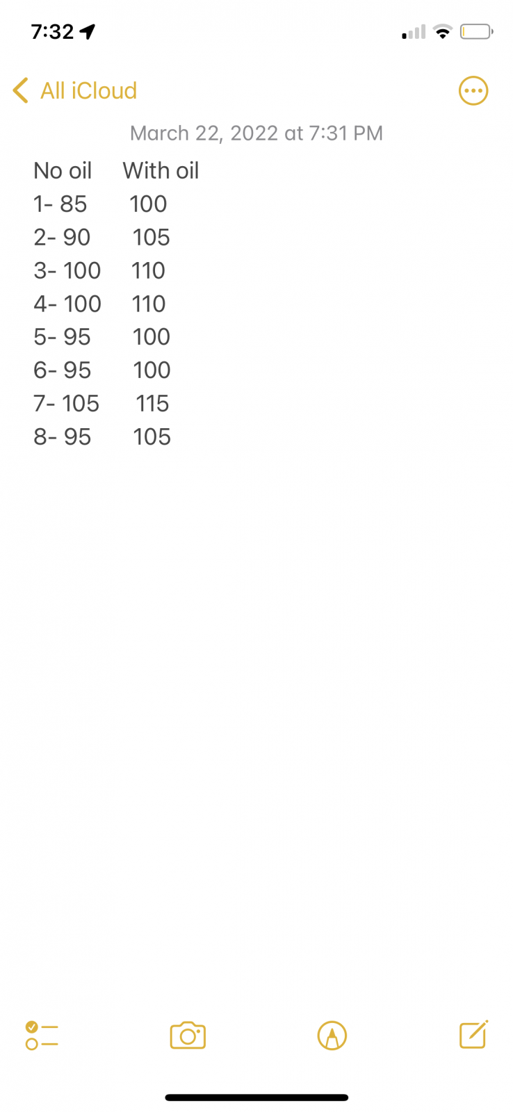

    Well, I tried my best to figure this one out on my own but with no luck I turn to the experts of the HAMB. The original flathead is smoking so bad from the breather tube that it is constantly filling up the car with smoke and is burning oil at a rate faster than I care to continue with. Exactly 1 qt every 40-50 miles to be exact. Im sure the motor is wore out but I am really trying to get a summer out of this motor before swapping it out. I’ve ran seafoam in the oil and in the fuel with no luck. This last week I let the cylinders soak in some seafoam and that brought my compression numbers up to what I consider acceptable for an 82 year old motor, see below. Anyways, last night I changed the oil and filled it up full with some 20w50 and it seems like it is smoking even more now than before the seafoam. I am at a loss, and after reading all of the threads on this I wanted to get opinions on my specific situation.

    Have you ever had the heads off of it? Did the engine sit for a very long period of time? Rings stuck? How bad a ridge ring do you have at the top of the cylinder? Need more information than just a compression test.

    Without pulling the heads and looking at the cylinders for wear or a ridge, valve guides, and just the general condition, everyone is just spitballing on what is wrong with your flathead.

    Compression test don’t make me think of a worn out, dead engine.

    I agree ^^^^ those compression numbers aren't great, but not terrible either. Could the breather be plugged up in the oil pan?

    Well, the smoke got a little better but it is still there as well as the oil consumption. I plan to pull the intake and then probably the drivers side head. I plan to check for the obvious, bad gaskets and such, but is there anything else I need to check specifically under the intake? In my opinion there has got to be a very direct source of oil making it into the cylinders to burn a qt every 50 miles and I don’t believe it to be the rings of compression is 90+.
