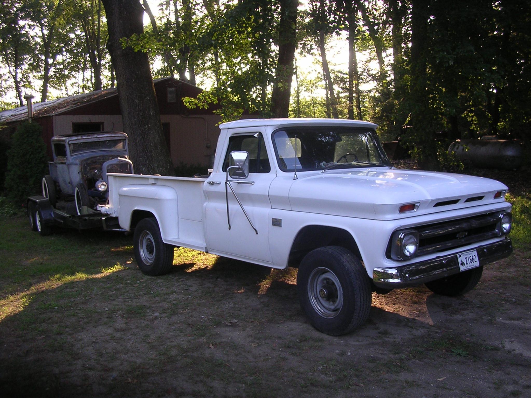

    See the truck below; it was restored in 1995. That was before the optional deluxe body side chrome was repro'd. I wanted the chrome but did not have enough good pieces, but decided I wanted to finish the truck and put the chrome on later.
    So, I did not want to weld up the cherry western doors, and then have to drill the holes back out later.
    I sandblasted around each hole from the inside/backside when I blasted the cab and doors.
    I then just held a large drill bit in my hand to lightly countersink the sharp edge on each hole from the front side.
    Then I loosely fit a piece of masking tape on the backside of each hole., and used body filler from the front side.
    After I pulled the tape off when it set up, the filler was like a nickle size and thickness on the back. Painted over the backside with enamel rustoleum.
    I never did put the chrome on...so..
    Fast forward to last year, and I hooked the p***enger mirror on the garage door opening. It hooked so hard the lower rear mirror bracket leg caved the whole lower door in. I had to pull hard on the lower mirror leg to pop most of the dent out. Take a good look at the huge pic in full expand... You can see the "smile" shaped dent with cracked paint halfway between the door handle and the lower rear mirror leg. That smile dent is right in the chrome trim line. There are no failures of any of these body filler trim holes! ...........Don't say it won't work... here's the pic
    For larger holes, I'd cut a sanded piece of fresh sheetmetal and ****er both the patch and the backside of the hole with filler. It will work. ;) (...but not on structural cracked areas)

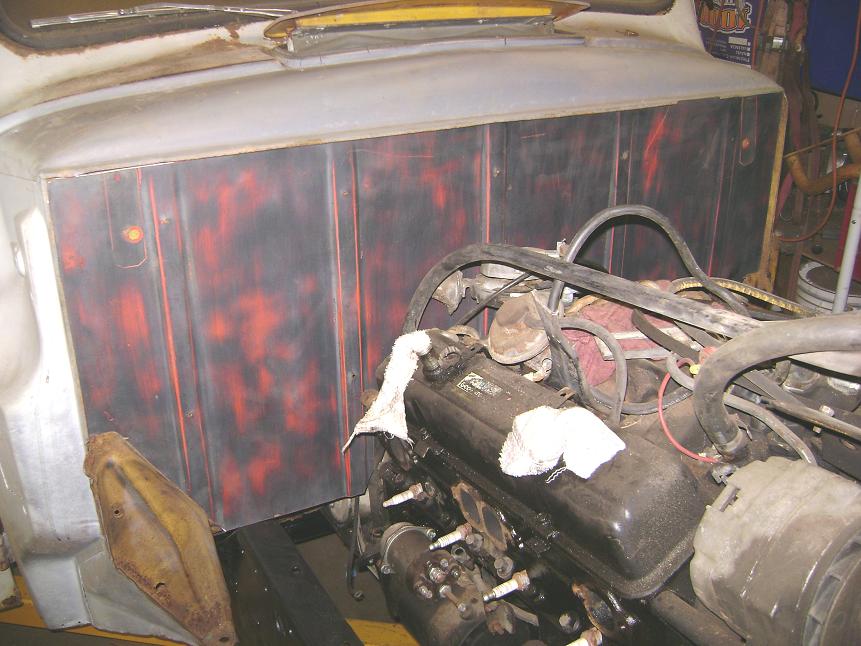

  19. Da Tinman
    Joined: Dec 29, 2005
    Posts: 4,222
    Da Tinman
    not exactly smooth, but you get the picture, it all screws in.

  21. FLATROCKER
    Joined: Jun 26, 2007
    Posts: 89
    FLATROCKER
    from nw ohio
    I give Da Tinman the " Best fire wall " Award!!! Truly a work of art.

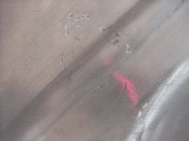

  24. Time to grow up and get a welder, you'll be glad you did. It's the type of investment that you wont ever regret. In my garage, the welder is just as important as a Phillips screwdriver.
    During the SBC swap I smoothed the firewall start to finish in our '53 in maybe 4 hours of actual labor. More time was spent sanding than welding. A pair of tin snips and a small sheet of 18ga sheet metal was all it took to weld up the holes. I wasnt going for a show car look, just smoothing it up without going overboard. This is all painted with spray bombs and cleared. This was all done 3 yrs ago, still looks fresh today.
    Stock firewall
    Welded up holes, Skim coat of filler, primer & gloss black
