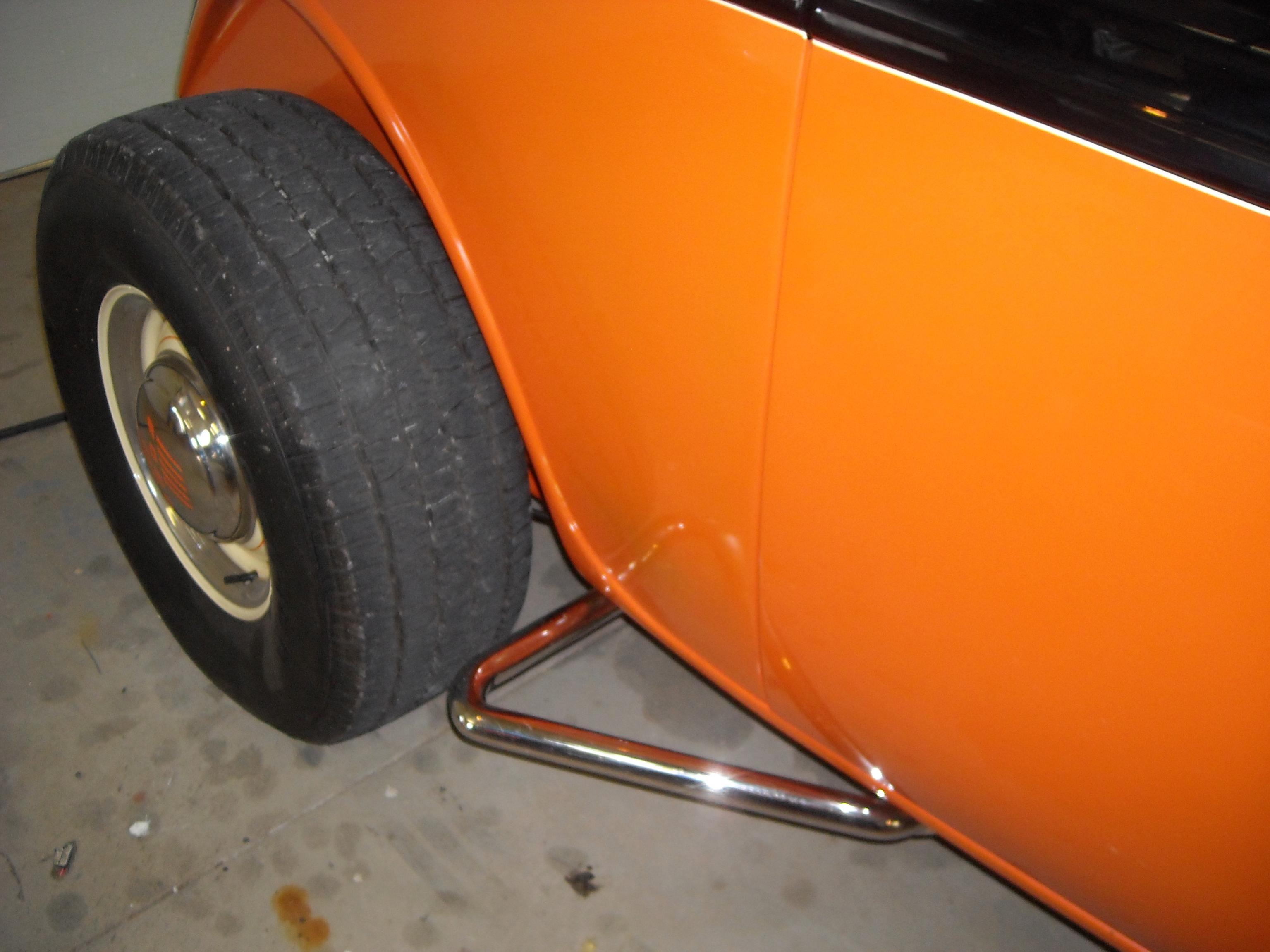

    I think 12 inch rims are too wide too. Here's mine on 8" rims.

    Judging by the picture it does look like the 8" wide rims have the right rim width for that tire. I sure wouldn't go to a 12" wide rim for tires that size.
