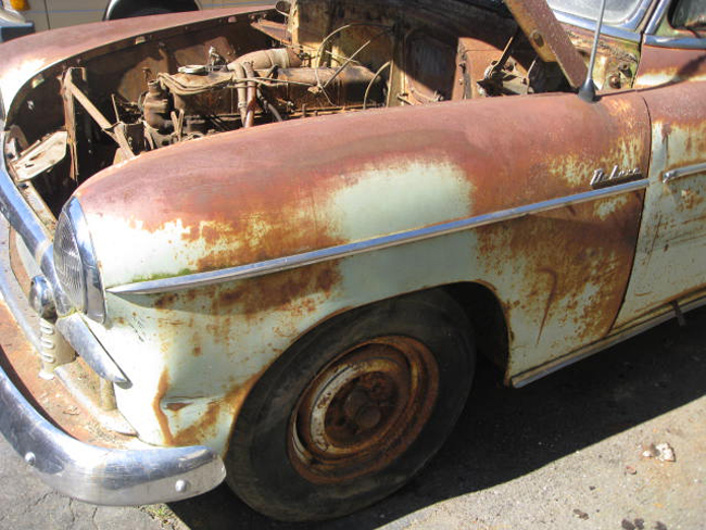

    I was thinking about throwing a "wet sand" party this weekend to wet sand this car down. Of course I'm not looking to try to restore this original paint job, just want to smooth it out. I think the look will be pretty cool, but then on the other hand, maybe I should leave it alone? Any thoughts? Any pics of cars this has been done to?:confused:

    Wipe it down with WD-40 and enjoy the comments!
  3. I've used Scotchbrite pads (with the sponge on the other side) and Ajax powder on cars with paint like that, and had pretty decent results. After you hit it with that, rinse the car down well, then wash it normally. Dry it well, then spray with WD40, and wipe down. You'll be amazed at how much more presentable your car will be.

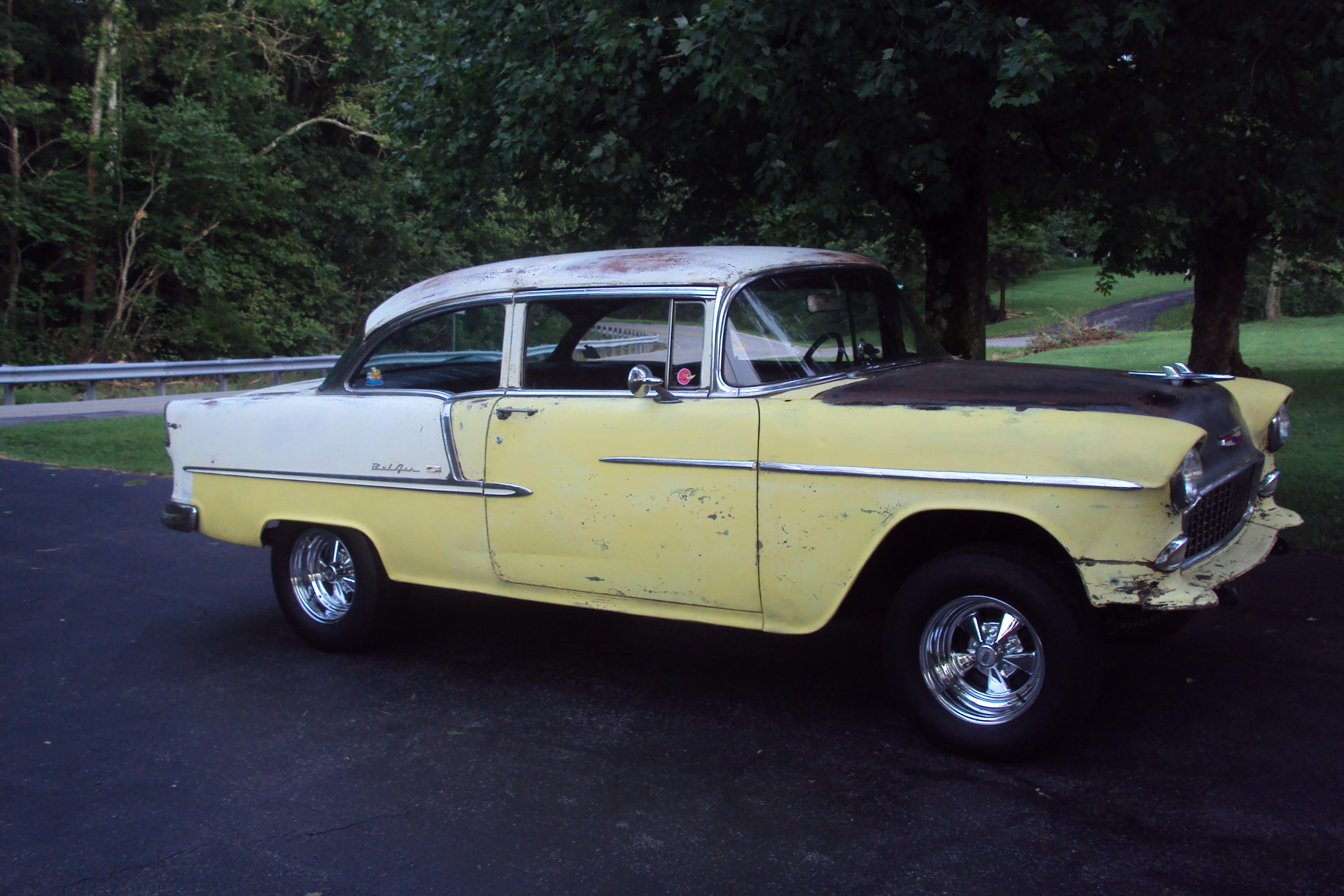

    Well I am partial to the patina, However I think a repair to freshen it is all it needs, Heres mine, before and after.. ps I never worry about doordings or rock chips!!

    ABSOLUTELY BEAUTIFUL CAR! Yes, I love the patina on my car too. I don't want to change that at all. Just smooth it down like it looks like on the body of your car.

    Mine had been painted black with a brush years ago, so after fixing a few places and hitting them with some touchup paint that had been mixed to match my paint and put in a spray can at the local autopaint store, I went over mine wet sanding with 180 using more elbow grease in some areas.
    I also went over the new paint spot ins to dull it back down to match better.
    When I washed it the first time this summer, I went over it all again lightly with some 400.
