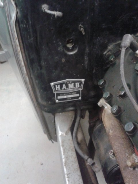

  4. There will be very few "additions" to Snewpee, but I think this is a positive one, have to admit I took a deep breath before drilling the mounting holes...

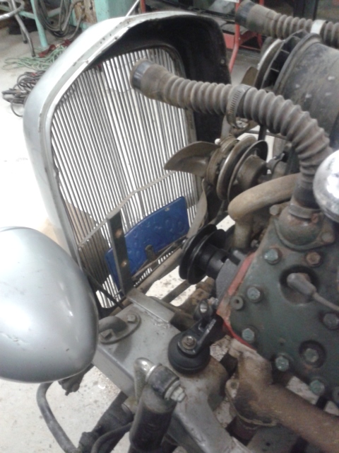

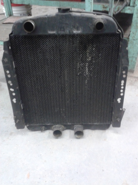

  15. Not very exciting photos, but kind of humerous, Here is the rad after I removed it... look along the side flanges - looks like they had some trial & error when first mounting it !, there are more holes than metal ! You don't see the holes once it's mounted because of the upright posts that it bolts to as shown in second photo (with rad removed)
    Also noticed that the upper ports are different sizes !, haven't measured yet but I think one is 1.25 " & the other must be a little bigger, as typical they used what they had available back then ! - ha ha I know both of the upper rad hoses are 1.25", guess I will have to "m***age" the one new rad hose onto the fitting.
