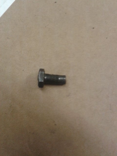

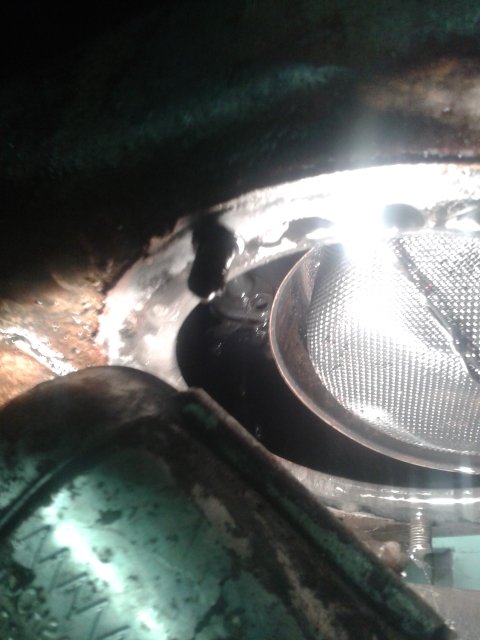

  16. An update, but not the kind we like...So after dinner I run Snewpee up on the hoist, drain the rear end oil first, no issue, looks like it was the old "600" oil in there... then I move onto the tranny, which previous owners commented that it was noisey which was blamed on being from a 1935 with "square cut" gears... but that only applies to 1st & reverse (2nd & 3rd are syncro), also one of my co worker's father rode in Snewpee back in the day & thought that 3rd gear was "stubborn" from what he could remember... I remove the drain plug from tranny & the oil is coming out really slow, I push my finger into the drain & I feel metal pieces... this is what I removed, looks like a detonated syncro etc... guess I get to make use of that early ford gearbox book that I ordered :)
    Then finally onto the motor, remove oil pan plug, oil drains out fine, no surprises, because Snewpee has a truck pan I remove the cleanout plate, heavy sludge on the plate, but no chunks, nothing to scary considering... then I bump the oil pump pickup with my hand & it moves... strange... I shine work light into the pan & notice that one of the oil pump pick up bolts is missing !
    So I fish around in the sludge in bottom of the pan & find the bolt...
    I guess I could be pissed off, but I'm not because bought the car expecting to have to rebuild everything mechanical & anything I didn't have to rebuild would be a bonus, having said that I don't have an unlimited bank account, so now to weigh the options...
    Tranny
    1) Rebuild to stock 1935 specs.
    2) Retro fit later full syncro (Lincoln/Zepher) gear set into 1935 gear box - I believe this can be done with minimal mods...
    Engine
    1) Drop pan, remount pump pick up & then check oil pressure, if it runs okay just drive as is, knowing that engine has been comprimised as the oil supply to pump would have been reduced with a loose pickup & save the rebuild for another year or 2...
    2) Screw it & get the engine rebuilt right away, keeping it the same as it was (basically stock except for overbore)
    Time for a drink !

  17. jimcolwell
    Joined: Oct 4, 2009
    Posts: 474
    jimcolwell
    from Amarillo
    Go with plan "A". Fix the transmission and secure the oil pick up. Tear down the brakes as this will be a trip.

  21. Some bad luck but nothing terrible!
    My humble recomendations.
    1. Tranny, whinney gears is part of the fun.
    Lots of guys on here are still taking out 36-37 transmissions
    and replacing them with 39's
    I just did one myself for my kids 40 coupe.
    The 37 was fine except he wanted "Better" 39 that I found. ($300).
    Now he has quieter, slightly easier to shift, 39.
    I sold the perfectly good 37 for $125.
    Point is you dont need Lincoln gears
    unless you need braggin rights cause
    they are gonna cost a bundle.
    Fix what is there or put an add on
    Here and ask for one to replace yours.
    2. Engine, these flatheads ran for years with low
    oil pressure.
    If your engine was running before it was laid
    up and it was running now, (I heard it yesterday!)
    chances are that screw was out for a long time
    and the engine ran. If not it would have seazed up long ago.
    Clean the sludge, bolt it back up, check the pressure
    Forget about it.
    The worst thing you could do is start tearing things
    apart. then the car sits again instead of what it wants
    to do, RUN!
    The car tells you what it needs, you just have to listen!
    Just my humble opinion.
    God luck again!
    Tony
    pineknot4, WC145, brad2v and 6 others like this.
  22. That's all I need to hear ! Thankyou, I am the young Jedi, many of you are the "Yoda's" & I just needed the blessing !
    Repair Tranny & Repair Oil pick up it is !
    WC145, oldnuts, Robert Crosse and 3 others like this.
