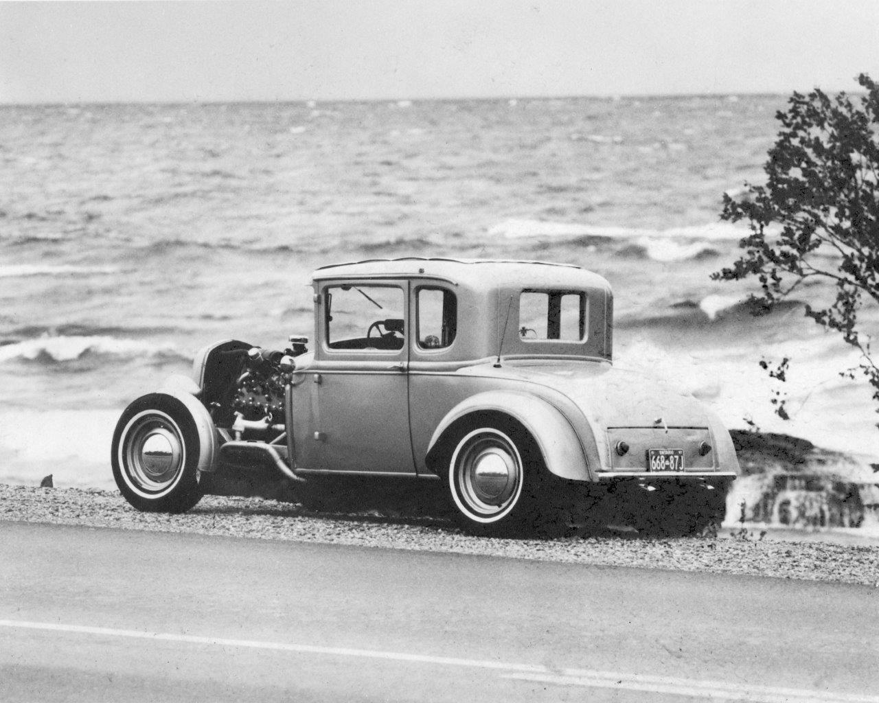

  5. Picked up the "restored" picture & signboard digital copy's this week, I think they turned out really nice, I did like the "yellow" of the original photo but the guy at the photo shop said that's it's difficult to clean the photo up & save the "yellow"... hoping to pick up tires today, old tires are off the rims (I saved them-even thought tire shop guy looked at me like I had 2 heads...) & fortunately the rims were not rusted inside, I was kinda worried about that. Was able to get the front brake drums turned, shop couldn't chuck the rears up, I will talk to my machinist friend soon :)

    your digital copy looks real nice. do you have any idea where that picture was taken? also how much was the car driven before being put in storage? thanx tom

  8. Well the widow said it was taken on lake superior, so this summer I plan on scouting a few of the stops north of town.. hope to do a recreation! I know it wasn't taken in 1970 or 1969, because I know the plate #'s for those years... and I believe he bought in 1968 (because the 2nd owner bought in 1966 & said he sold " a couple years later"... so most likely taken in 1968, so it was driven only 2 years after this photo before being parked, and around here the most it would have been driven is 6 months out of a year... and that would be a stretch.

  29. Jer,
    I have been trying to think wher that picture was taken, as there aren't any places that I know of that paved highway is that close to the water edge. Might even be at Gros Cap,??
  30. GrosCap was my first thought, the widow was certain it wasn't taken there, going to check out the "angles" there next spring, also wondering about the road at Harmony beach ?
